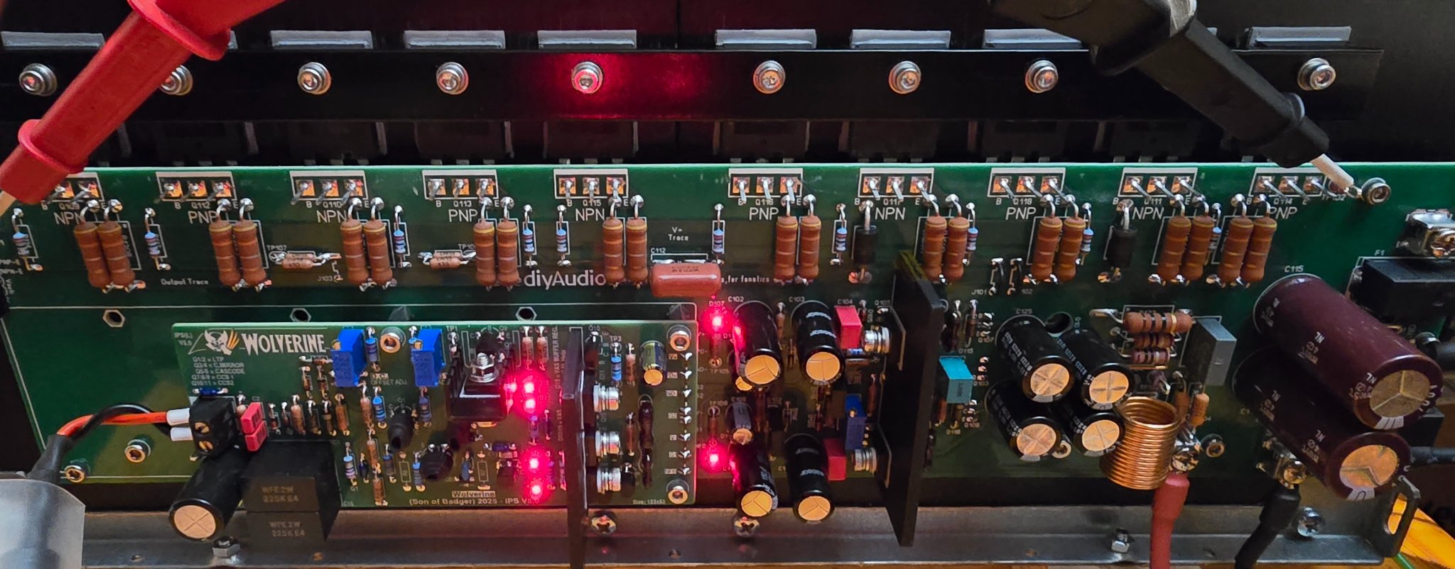

Since some people are gearing up to build a V5 Wolverine I wanted to share some information which might be beneficial as you gather parts to build your amplifier.
During some testing which pushed the thermal limits a lot harder than usual, I had a batch of silicon insulator pads which were not very good and I lost a couple of output devices so I asked around and did a few searches of what might be a better option for the insulator pads on the ouput devices.
Initially I moved to Kapton (0.06mm) and ordinary (Unick) white thermal grease with an aluminium spreader bar.
This made a big improvement.
However through some discussions I found out Alumina (Aluminium Oxide) pads are much more thermally conductive Kapton tape despite being 0.6mm or 1mm thick Alumina is a far superior thermal conductor compared to Silicon or Kapton.
Over time, I have tried mica, silicon sheet, silicon pads, adhesive silicon pads of varying types, Kapton and Alumina.
More recently I have tried Aluminium Nitride and I would say it is definitely worth checking out.
Aluminium Nitride has considerably higher thermal conductivity than Alumina.
I have in the last few days changed over my EF3-5 test build to Aluminium Nitride insulator pads and Maxtor CTG8 thermal paste. I also use controlled torque for the fasteners. So far so good
Hope this is useful info
- Dan

I am using some which I bought to try from Aliexpress. I normally use Mouser, Digikey, RS and Element14 for parts but in this case I didn't.
Make sure you find some which are the right size for your ouput transistors and have a mounting hole.
Also thicker I.e. 1mm wil be fine for up to EF3-4 and will have less capacitance to the heatsink.
For EF3-5 I would suggest to use 0.6mm AlN for thermal performance reasons.

Hi Bmsluite,
That paste looks ok but at 1.85 W/mK it will not compare well to the Maxtor CTG8 at 3.85W/mK. (Manufacturer claims 12.8 but it is hype)
I did try some even higher performing paste than this but it was not really suitable for this application since it was.too putty like to spread thinly enough, even after warming it up substantially with a heat gun.
Fyi both will likely be completely fine in this application.
Also some people go this way with copper but it is unnecessary and adds another thermal interface between the heatsink and the transistors. What it will give you is a more even heat distribution, which is why in some high powered applications (i.e. 2kW linear smplifiers) people go this way because the devices contact area is realtively small compared to the heatsink amongst other reasons, "Heat spreader"
I am sure you know all of this any how but I thought it worth mentioning.

Thanks for the links Mainframe both of these sources have some excellent data.
Basically just reinforces the boron nitride paste we already use and the viability of the copper pull/push setup though his copper heat pipe setup was pretty flawed and not optimal. You need a plate that has a much large surface area of contact between the copper and the aluminum.include the document with the Wolverine documentation.
I'm glad to see that aluminum oxide insulators with paste are being discussed here. I started to use them for my class A builds, which subject the OS transistors to much higher abuse levels than Wolverine ever would, several years ago and never turned back to mica or Keratherm.
All my builds use them now, 0.6mm thickness provides enough durability and fantastic heat transfer.
The only issue with using rigid insulators is they will crack if the heatsink is wonky.
