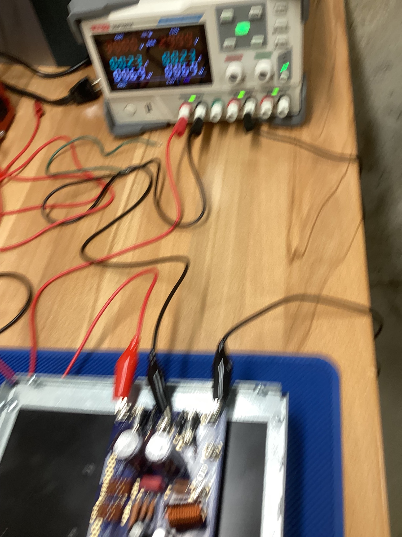

When I raise the voltage starting from 0, where exactly should I be observing about 26 mA.....between TP107 and TP108? And should that be 26 mA or mV as the Build Guide test procedure appears to measure mV everywhere?
Also, R109 controls the output bias, correct? So if the resistance at R109 is set to maximum, there should be no output bias. Do I have that right?
John
Hi John,
I was referring to the current that will be displayed on your power supply with no output stage bias.
Your power supply itself should read 0.020A to 0.030A on its display before you set the bias.
Yes R109 sets bias, refer to the build guide as a reference but yes the pot needs to be set to its maximum resistance of 500 ohms between pins 1 and 2 before power up.
When you first turn your power supply on bring the voltage up slowly so you can make sure there is no major issue which may show up at low voltages.
I hope this is helpful
- Dan

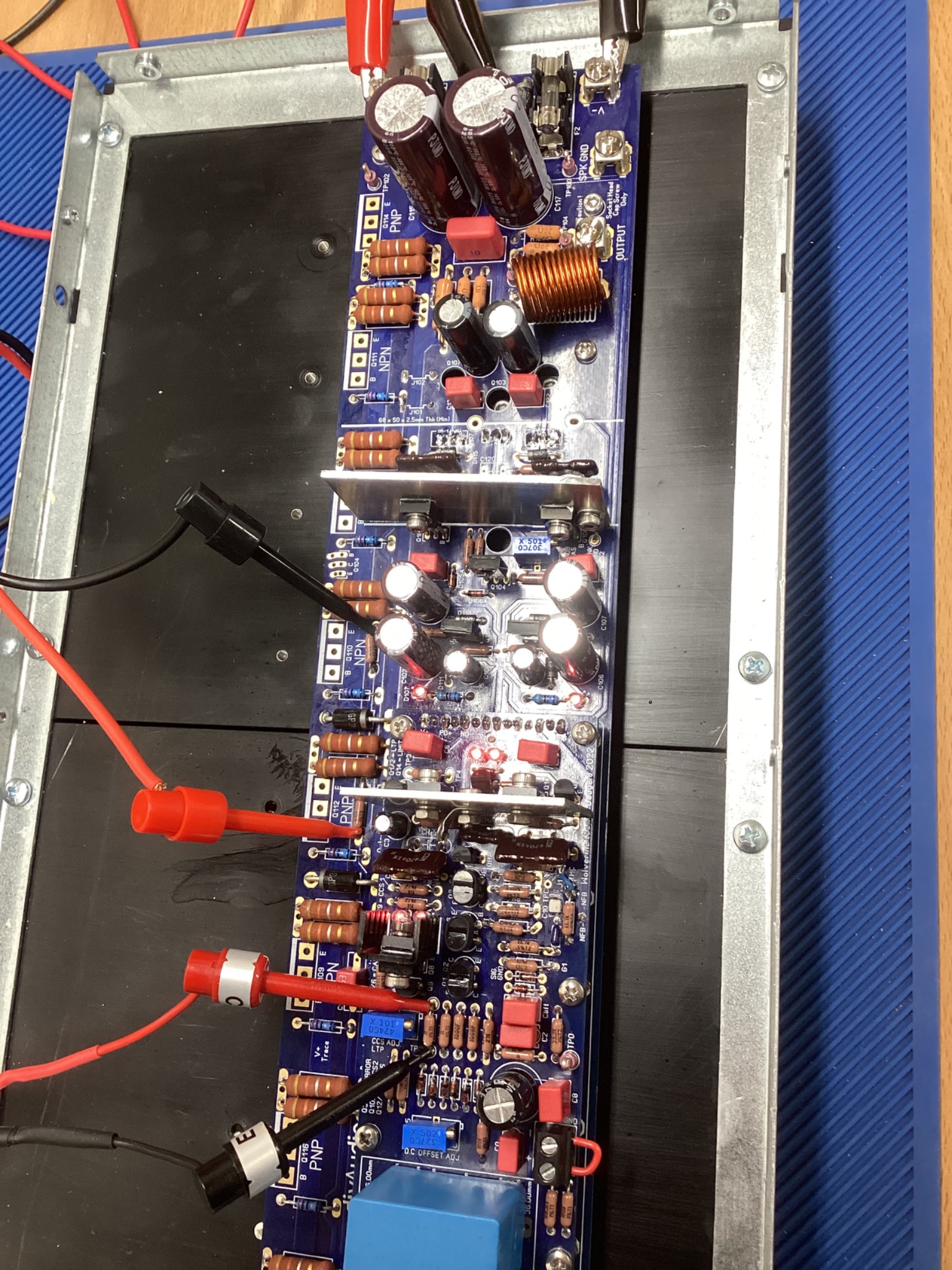

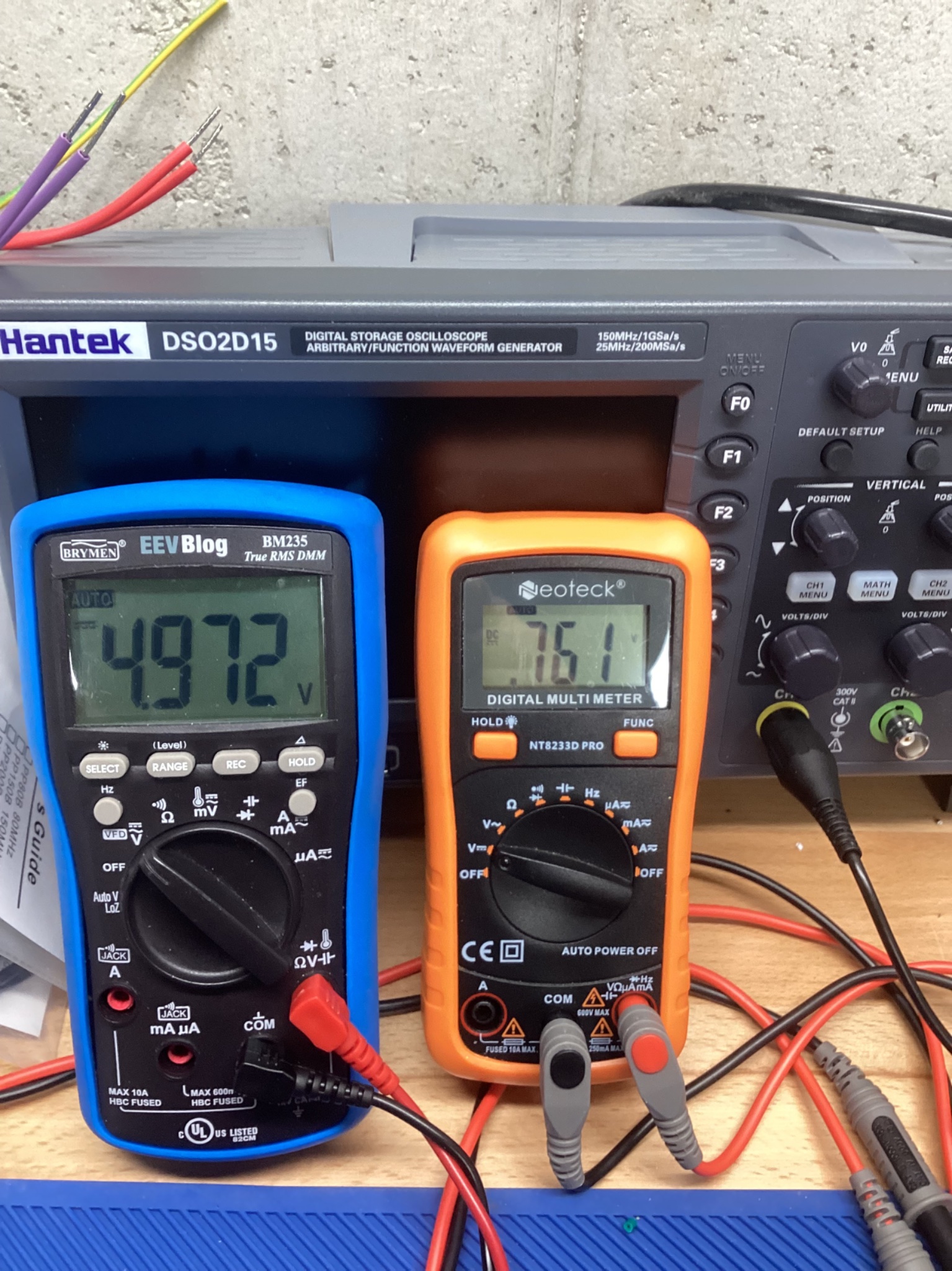

I just completed my test of one Wolverine channel (EF3-4 v. 4.0). To my great surprise nothing blew up and all the LEDs lit up when I reached 30 V. I wanted to run my readings past the team.
First, the output voltage settled at 758 mV and stayed there.
I was able to adjust R11 to achiev 5.0 V between TP-1 and TP-2.
I measured 591-593 mV between TP-3 and TP-4 which is bit lower than the 600-630. Is this ok?
Between TP-105 and the positive rail I measured 1.471 V. Between TP-106 and the negative rail I got 1.532 V. These measurements bother me because I used KSC3503 and KSA1381 for Q101 and Q102.....so I expected about 1.7 V. Is this ok?
DC offset was easily zeroed out. I could not measure AC voltage across TP100 and TP 104.
I was able adjust R109 to achieve output bias of 1.41 V. When I was done I returned R109 to maximum resistance.
I've tried to be as careful as I can with this build as I am a mere implementor. I could not have gotten this far without the help I've received from this build thread. I do appreciate it.
Let me know what you think about the couple of questionable readings.

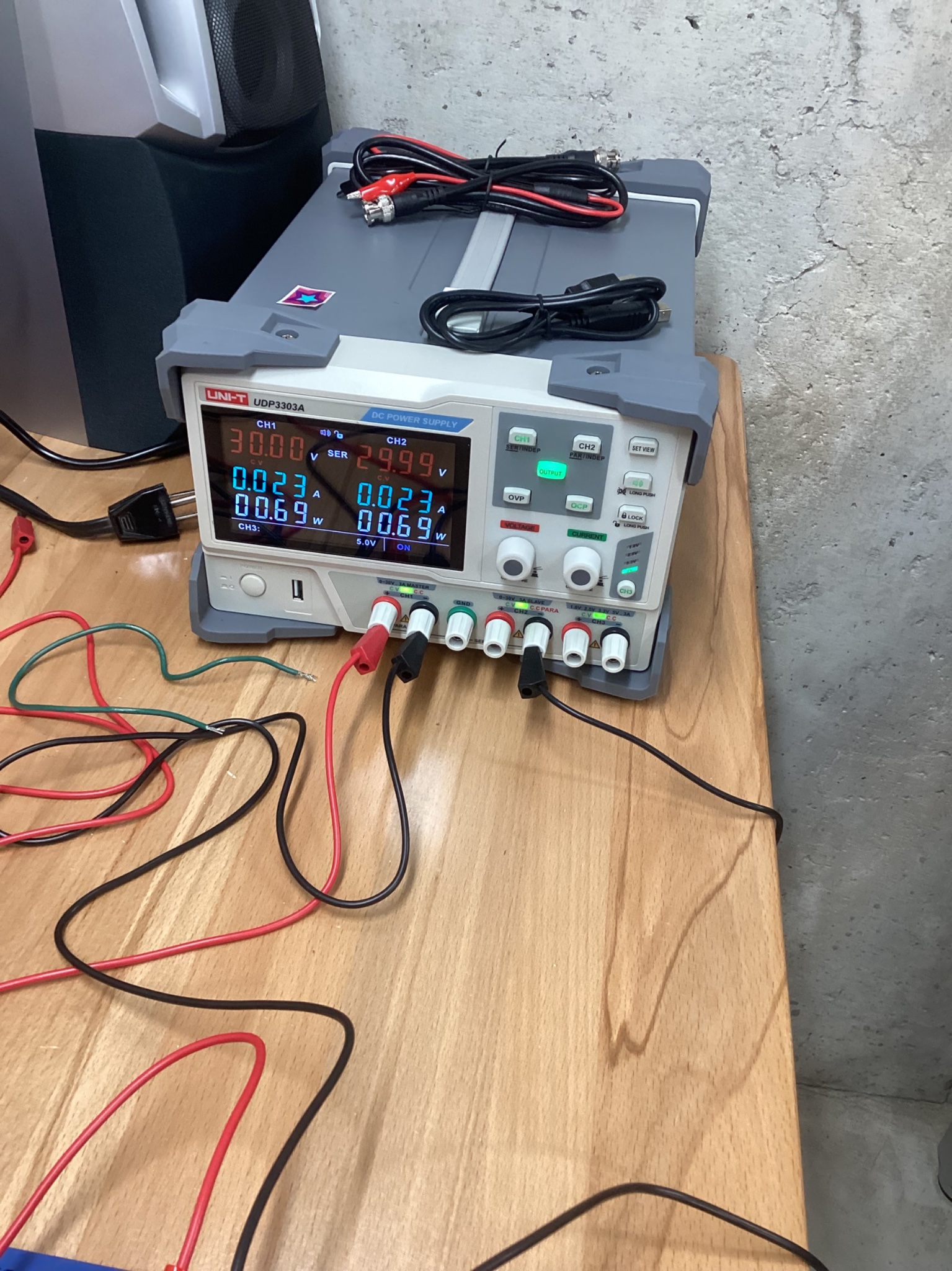

If everything is within tolerance, can I proceed to install the output transistors? J103 must be removed at this point. Does the 9.1K resistor in parallel with R17 stay in place while testing with the output transistors installed? Fuses go up to 2.0 A I suppose because of the larger current draw with the outputs installed. But we are stlll testing at 30 V per rail, right? What should current be limited to?
Thanks,
John
Hi John,
The rail fuses can stay at 2A for now, after power down and caps are discharged (see the rail leds extinguish slowly) J103 comes out and it is easy to remove by cutting each side with side cutters or desoldering.
The 9.1 kOhm resistor can stay for testing at low rails voltages with 30V rails.
Once your output transistors are in do your pre flight checks again, check slowly using the build guide.
Also once the output transistors are in make sure there is no electrical connection for the transistors metal back to the heatsink with the continuity beep function on your digital multimeter. Do not skip this step or else you will blow up your output transistors.
If in doubt post a question and I will do my best to help during these crucial steps.
Once you get to the biasing step you will slowly increase bias to 44mV using R109. Use a positive DMM probe clip on TP101 and negative dmm probe clip on on TP102. DMM set to mV
Expect about 400mA to 500mA on your power supply which will likely read very approximately 0.440A per channel. Expect your heatsink to slowly warm up. Take some time for it to be stable and re-adjust tp 44mV in small increments.
Please only make connections with you amp powered down and caps discharged for your safety.
Once again use the build guide and take your time to check off the steps, you are very close to success.
- Dan
I think you mean the bias voltage across TP107 and TP108, all good.
yep 👍 This may get closer when at full rail voltage, not the 30V we testing with
All good to install output transistors as per Daniels instruction.
Yup, current limit at 600mA (0.6A) as we expect 350-500mA being drawn per channel when the bias is pulled up by turning R109 (not at first power up, because R109 is at max resistance and little to no current flows)
One other thing to note when you go to measure bias voltage (that isn't clear in the old build guide and has caught some people here before), when the output transistors are installed and J103 is removed - you are measuring bias voltage across TP101 and TP102 eyelets and NOT TP107 / TP108 which are no longer used, as they were before.
