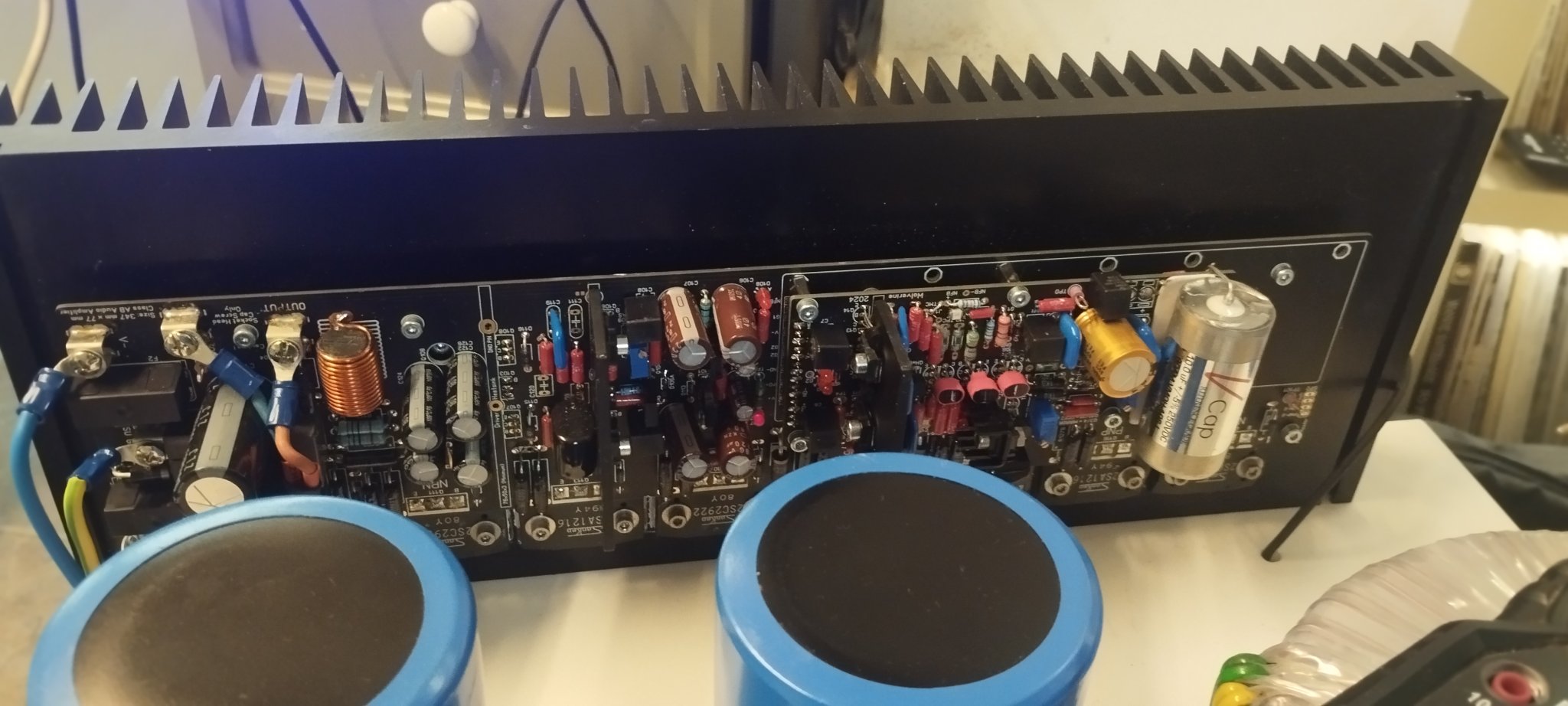

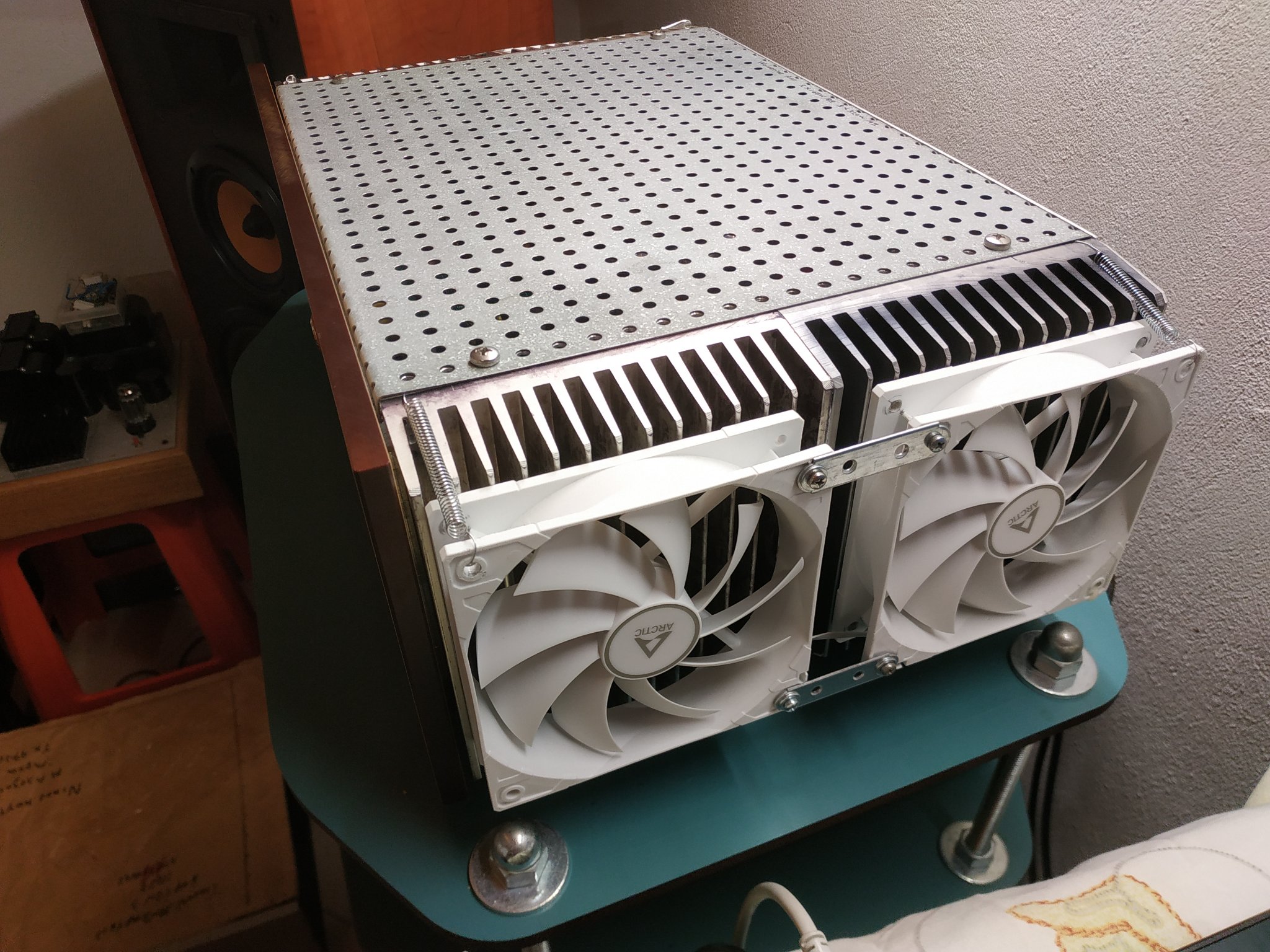

''''without coloration'''' Do you feel happy with that ?Control, range without coloration, speed, the first impressions.

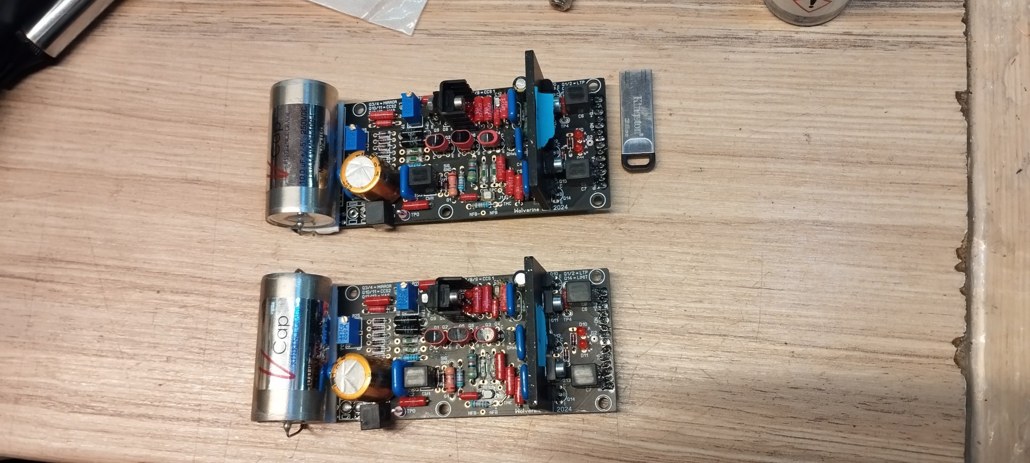

its an ""excellent amplifier, rock steady ,powerfull "" but when i change this amp in the same system with another Class A amp ( AN39 ,Hiraga le Monstre , USSA 5) i feel uncomfortable....

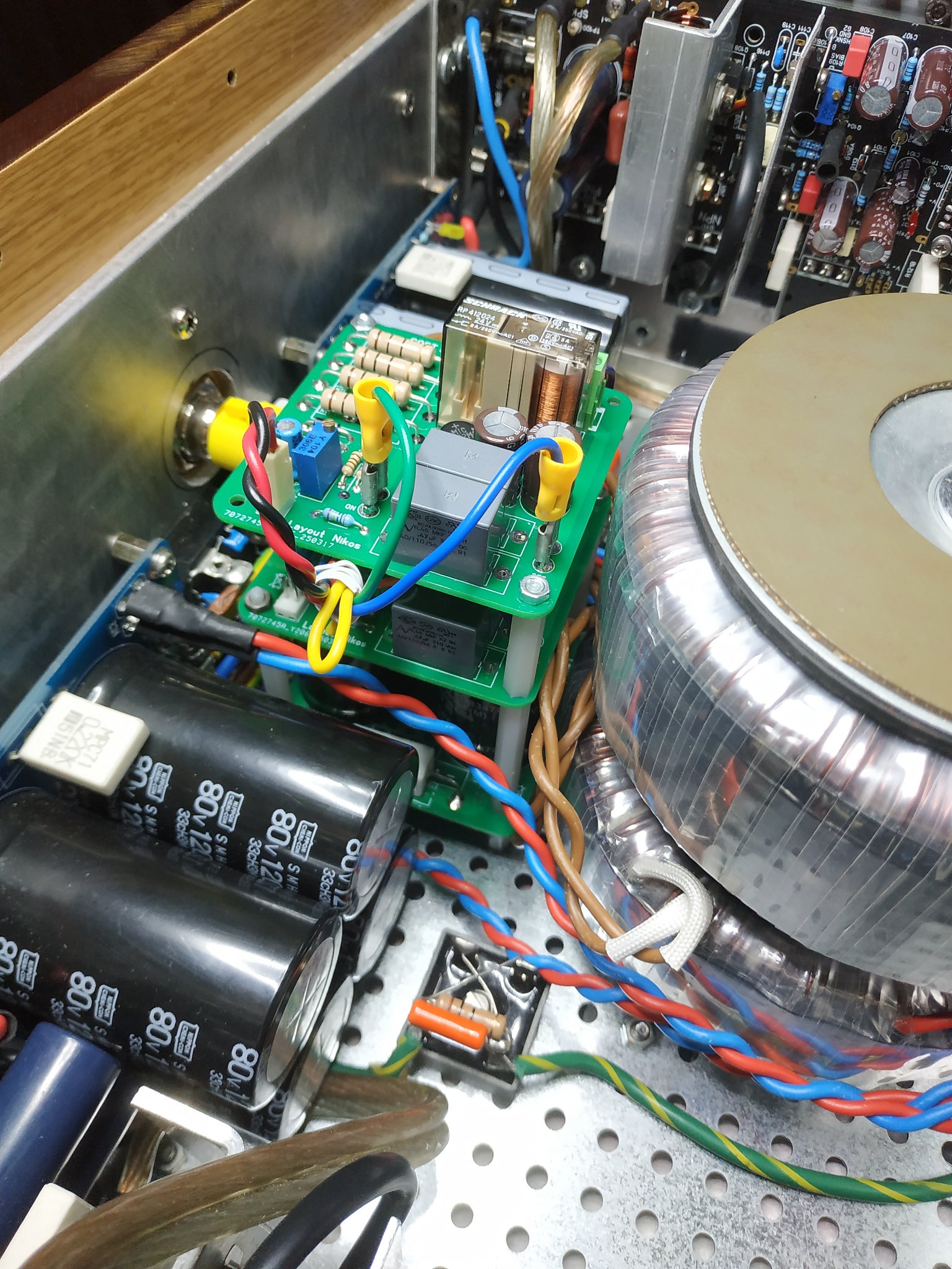

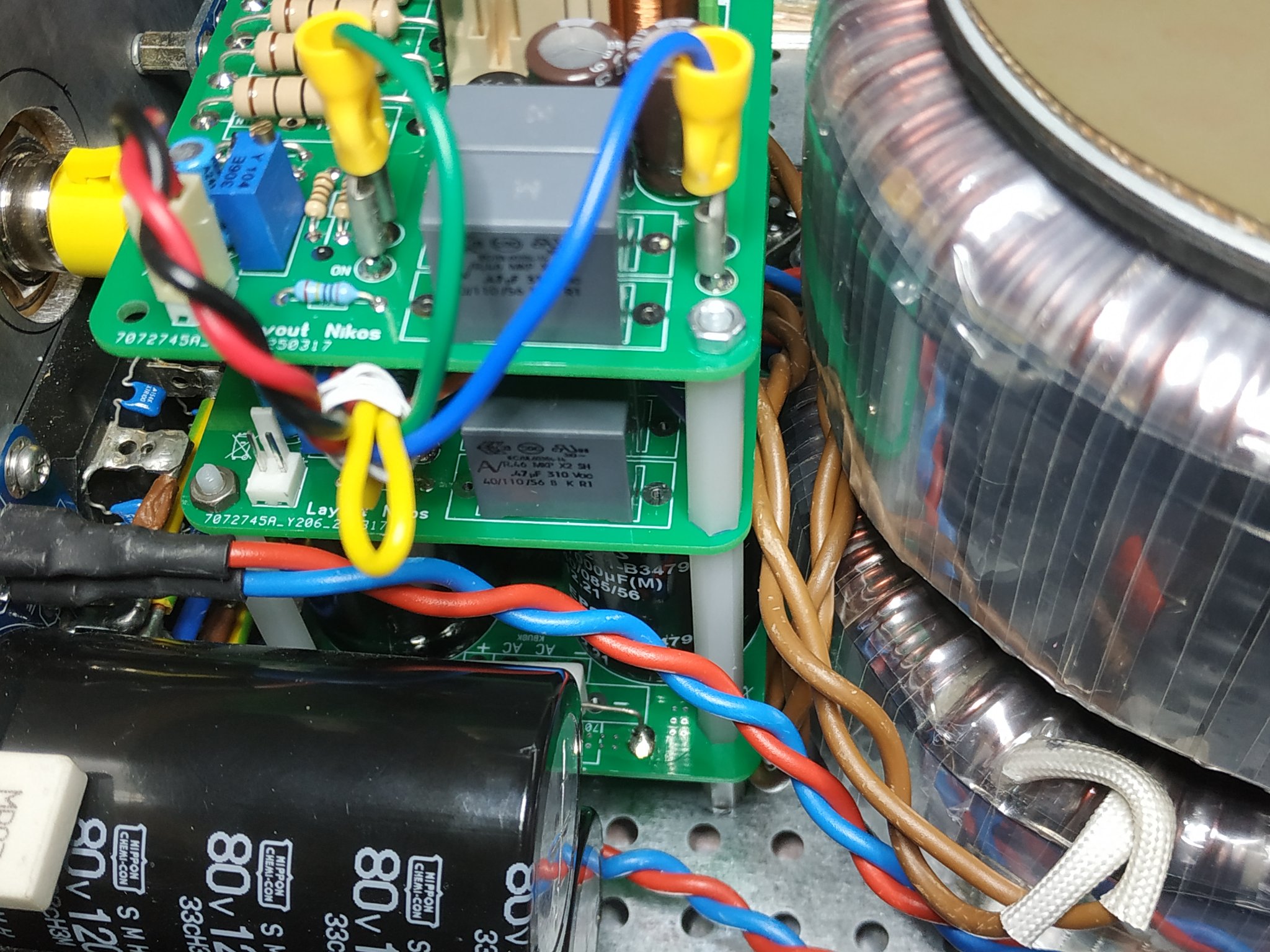

Last change i put two soft Start each one for each trafo 500VA, plus a DC Blocker.
I see a tiny part of an Analysis planar speaker on the second picture. I have never heard those, but have Apogee Duetta's myself. Your amplifier looks great!The final touches were done.
And I took it up to my living room,
For me, it is the best amplifier I have ever built.
Nikos, What makes it uncomfortable? Power surge? Or Could you elaborate?but when i change this amp in the same system with another Class A amp ( AN39 ,Hiraga le Monstre , USSA 5) i feel uncomfortable....
Do you find that the amplifier lacks some of the magic of your class A amplifiers? And that, at the same time, the Wolverine has qualities that the other amplifiers don't have?''''without coloration'''' Do you feel happy with that ?

I get two toroidal trasformers Talema 2x0-40v AC at 1000VA.
They have a mechanical noise due to wiring vibrations.
If I fill the center hole with an epoxy resin , can I lower that noise?
Yes, I had to do the same thing with my Honey badger build.They have a mechanical noise due to wiring vibrations.
Please see the last few photos in my build album for details
I also have four 600VA transformers that I don't use now because they are not quiet enough. I see in one of the pictures you used a product named KX-flex 60. This is a flexible resin and is different from the hard resin usably used by transformer manufacturers. Has it been completely effective and was there a reason for choosing 60A shore hardness?

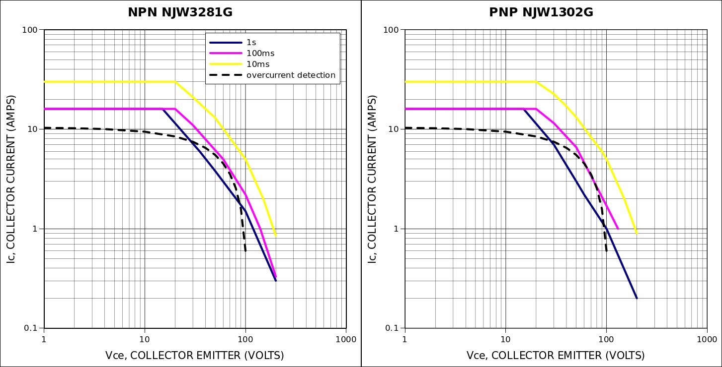

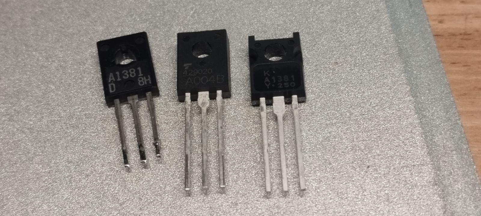

I tested the overcurrent protection circuit that I posted previously (post #5430 with R27 and R28 set to 470 ohms) on a test bench with substitute Re resistors (two 0,47ohms resistors in parallel). So I did not test this circuit in the actual amplifier yet. This is a single slope protection circuit. At Vout=0V the circuit trips at 5A, while at +/-42V maximum swing output (for a +/-55V power supply) I get 0.9A and 9.1A. I plotted my results on the SOA of output transistors NJW3281G and NJW1302G and as you can see the tripping limit is within the 100ms SOA. Can any of the experts out there tell me if this will provide an adequate protection of the output transistors?

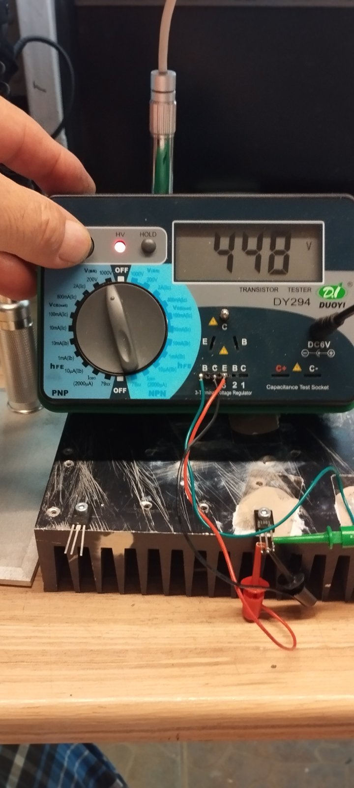

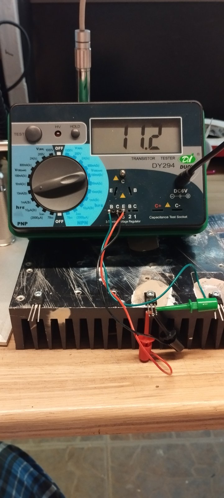

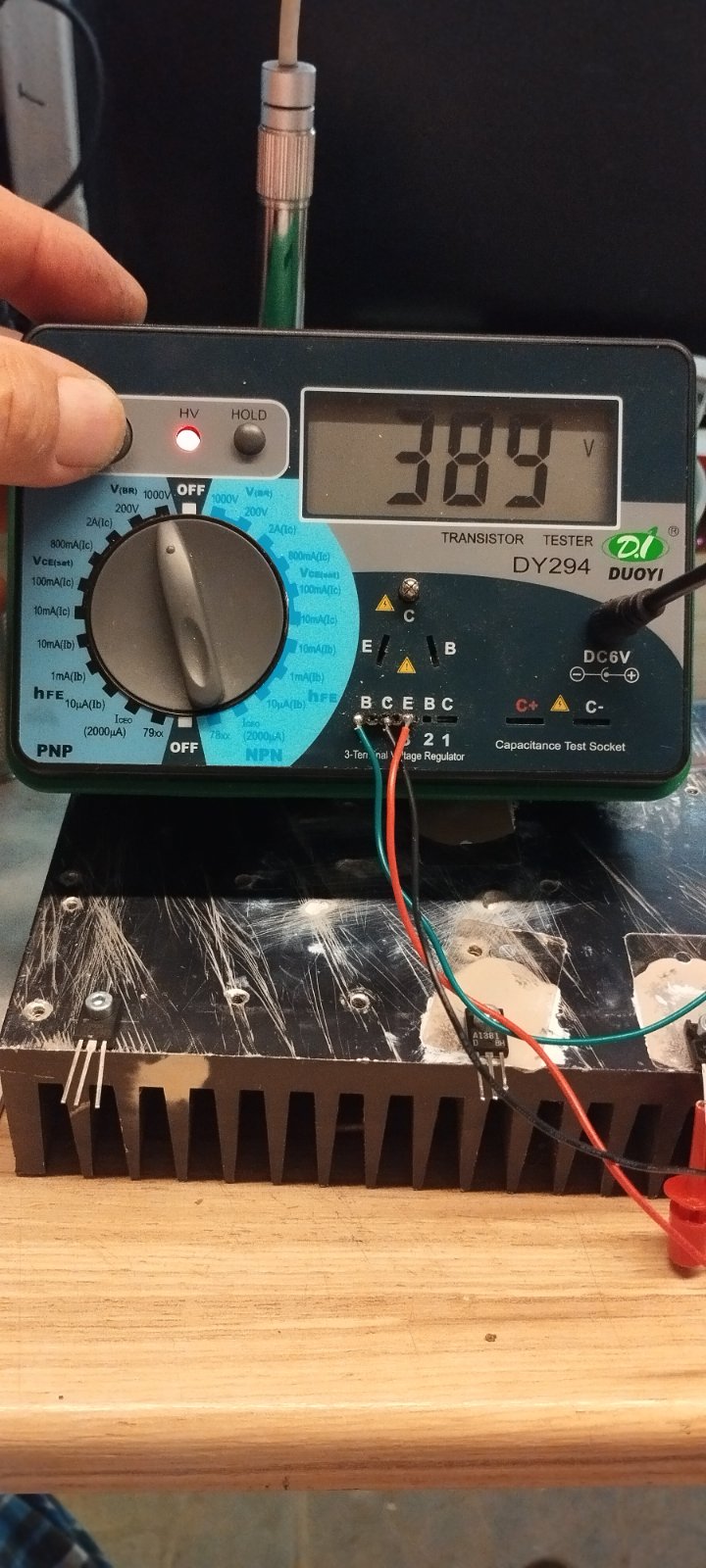

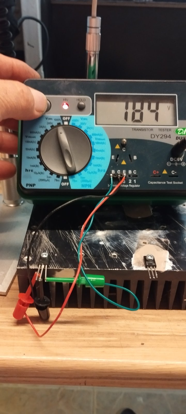

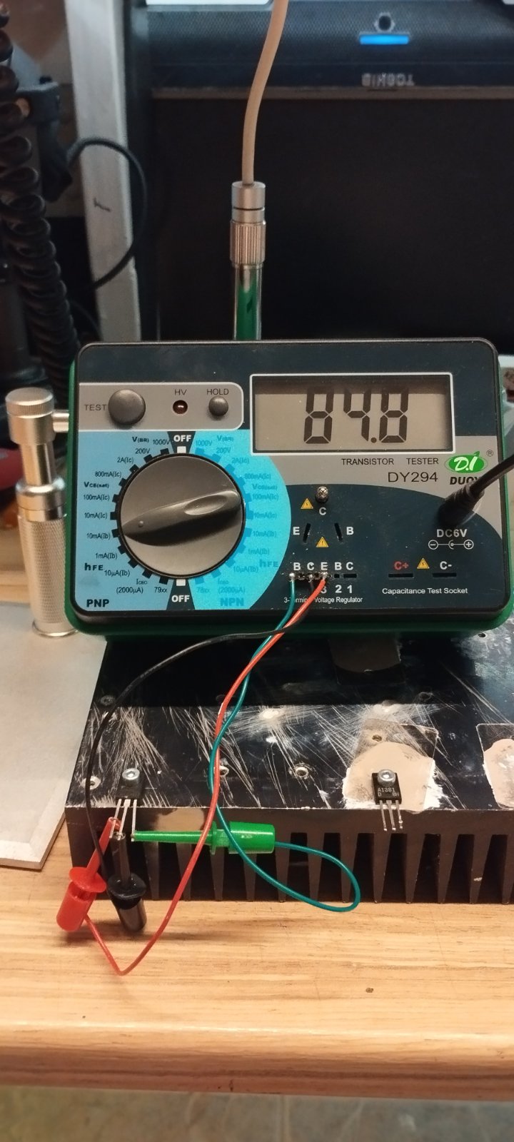

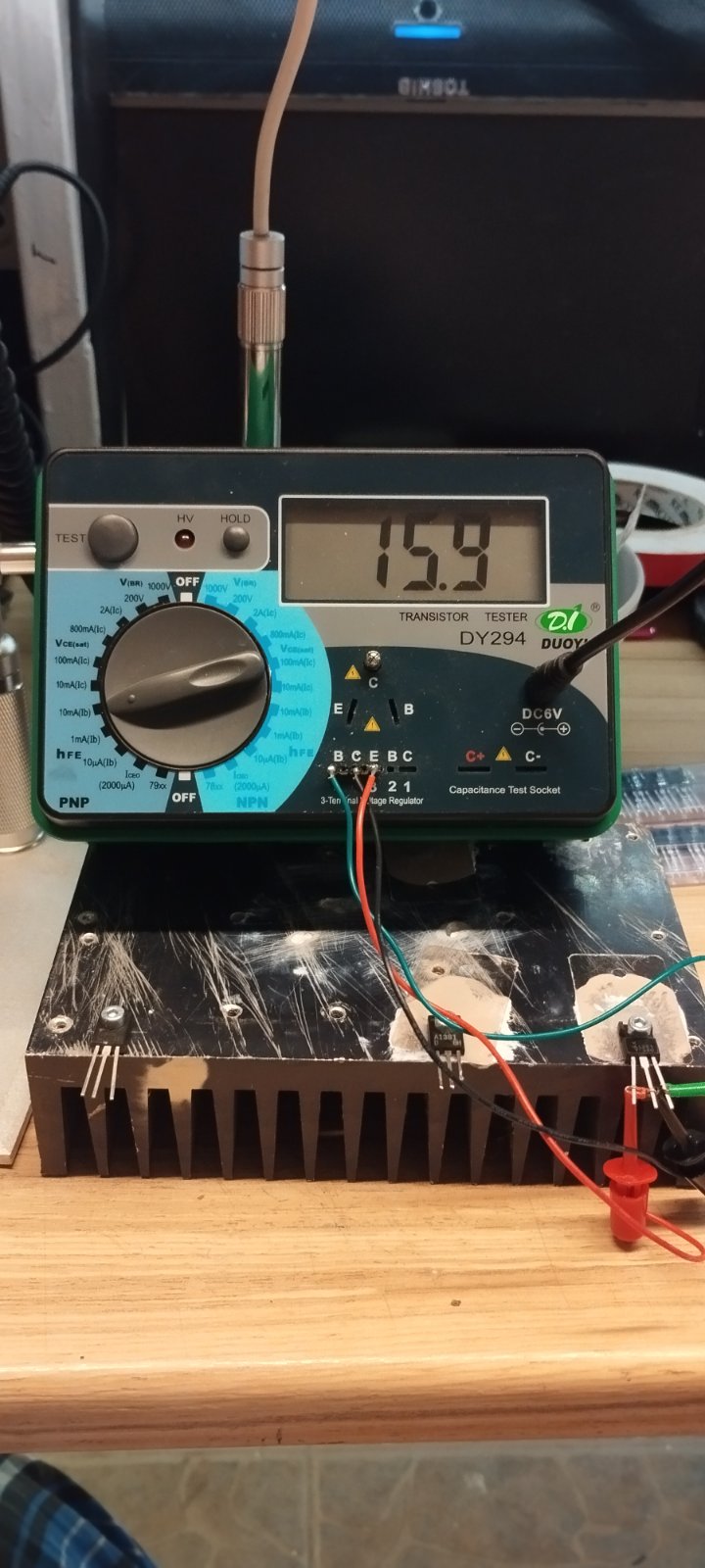

Driver VAS Stage test
TTA004B---- 84.8 ( 10ma - ic) 184 v HV test
2SA1381-----11.2 ( 10ma - ic) 448v HV test
KTA1381-----15.9 ( 10ma - ic) 389V HV test
Hi all, I try to beta match the KSC3503 with the KSA1381and it look quite challenging. have some of you choose\replace those semi with other type without any issue on matching? Thank you Mario
Don't forget the long term instability of optocouplers! That is the reason not to use them in analog circuits. (at least not without appropriate countermeasures) My circuit does not change trip level over time because of constant current on the optocoupler LED.I tested the overcurrent protection circuit that I posted previously (post #5430 with R27 and R28 set to 470 ohms) on a test bench with substitute Re resistors (two 0,47ohms resistors in parallel). So I did not test this circuit in the actual amplifier yet. This is a single slope protection circuit. At Vout=0V the circuit trips at 5A, while at +/-42V maximum swing output (for a +/-55V power supply) I get 0.9A and 9.1A. I plotted my results on the SOA of output transistors NJW3281G and NJW1302G and as you can see the tripping limit is within the 100ms SOA. Can any of the experts out there tell me if this will provide an adequate protection of the output transistors?
found the issue. ThanksHi all, I try to beta match the KSC3503 with the KSA1381and it look quite challenging. have some of you choose\replace those semi with other type without any issue on matching? Thank you Mario

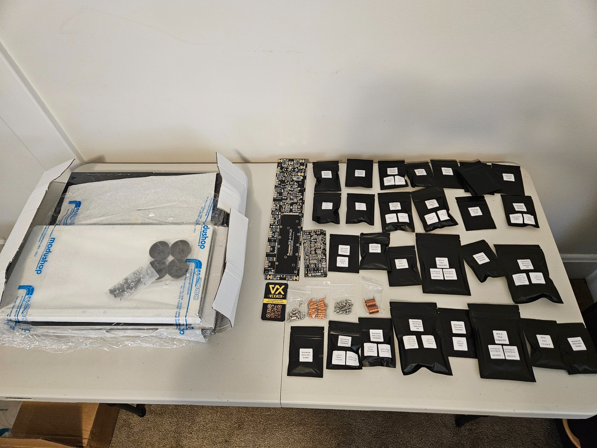

H guys, I'm new to the wolverine thread. Purchased boards and parts last November and have been (very slowly) populating the boards. They are almost ready to test. Doing 71v rails with 2SC2922 / 2SA1216, and probably will be using the Cobra SMPS. Can't wait to finish the build.

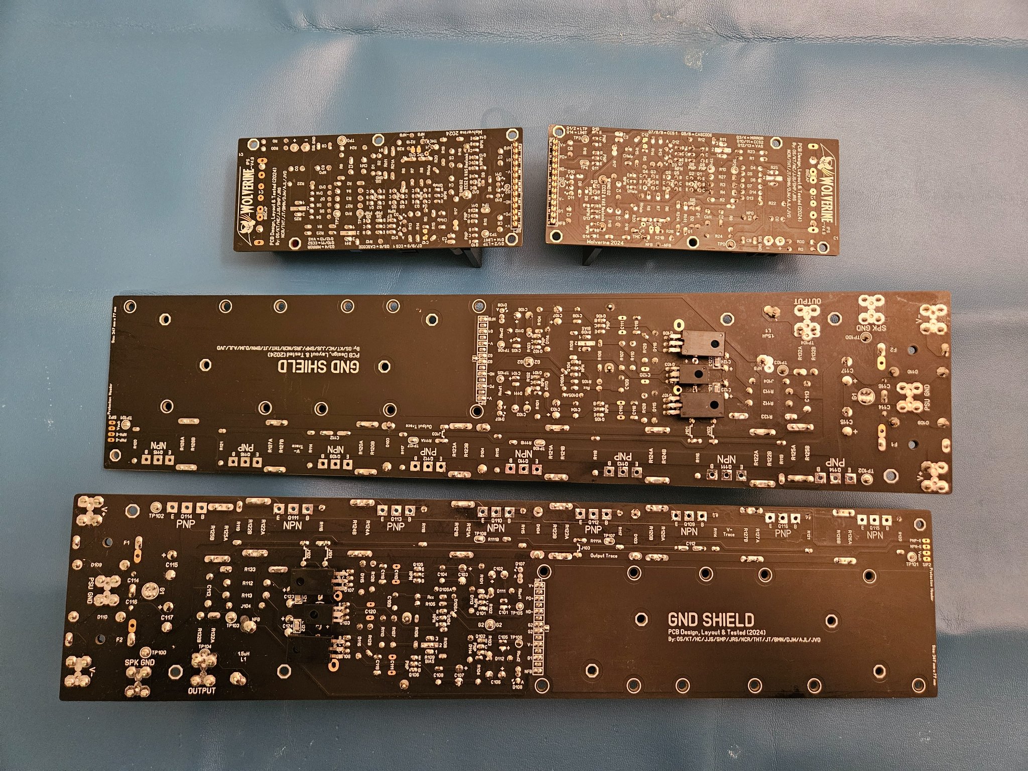

Exciting news! The Wolverine V5 boards have landed with @Mainframe! These boards are our test builds to ensure everything is 100% spot-on and verified before we place the bulk order for the 5th Group Buy. The final group buy boards will feature a premium gold ENIG finish, giving them a stunning look and enhanced durability.
A huge thank you to @Mainframe for capturing these images so promptly—check out the photos in the 1st post to see the V5 boards! Stay tuned for updates on the verification process in the Wolverine Build Thread as we confirm these boards are ready to rock.
A big thanks to the Wolverine Team and to all of you for keeping this project thriving!
