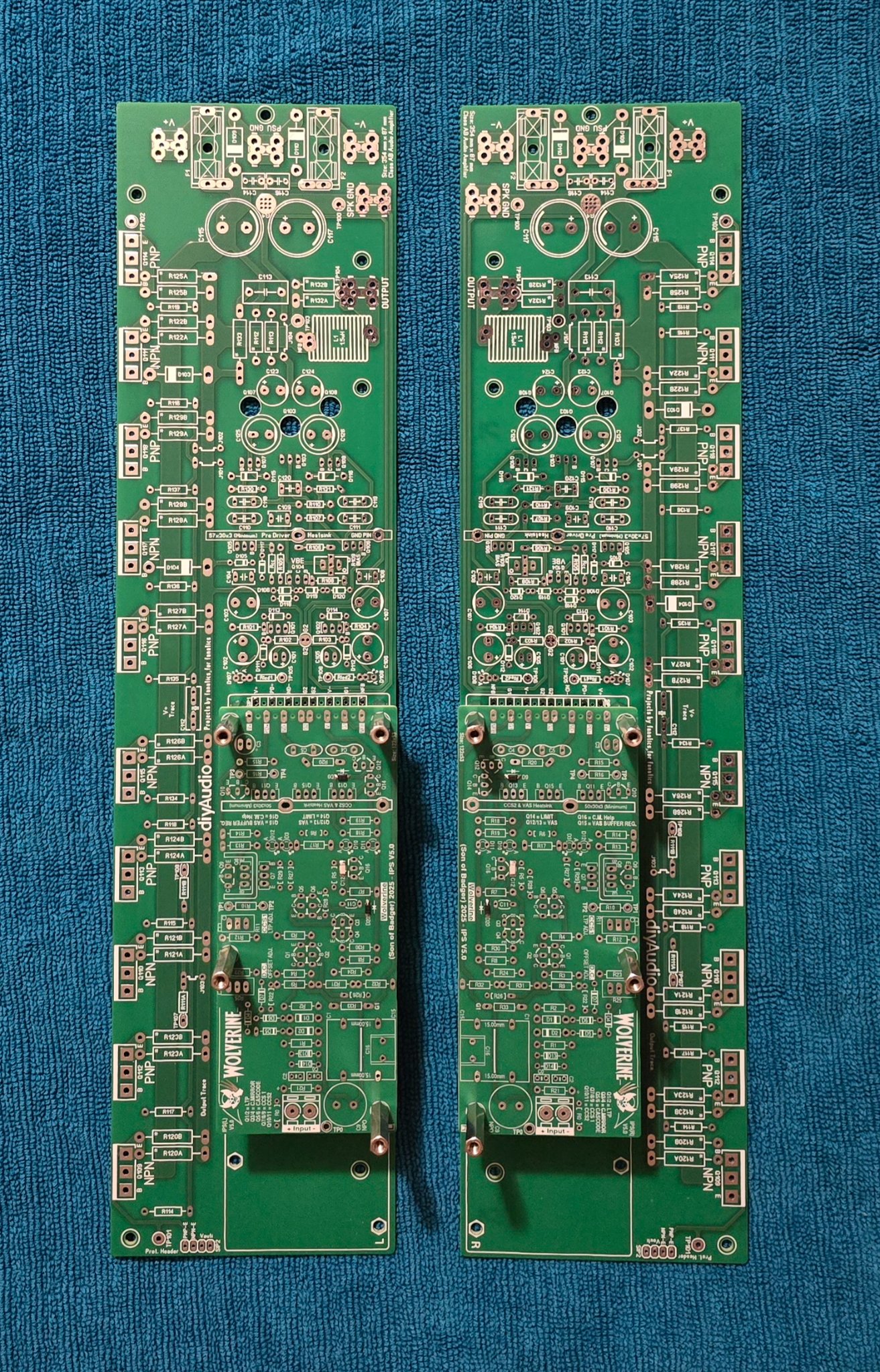

Ok guys a bit of news today.....
After alot work from the Wolverine team
I have in my hands the V5 EF3-5 pair
Mirrored boards and parts in my hands.
Special thanks to Stuart for his extra efforts to make the mirrored boards a reality.
Time to start building!
- Dan

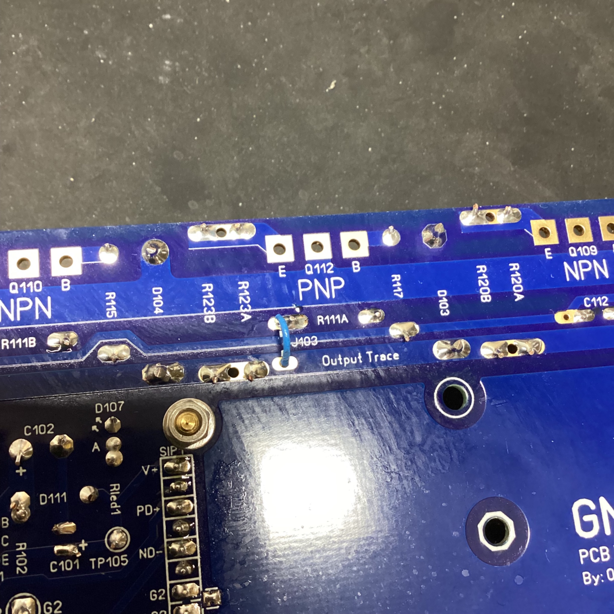

Hi Guys,
I am ready for the initial test without the output transistors installed. I am working with the EF3-4 (V. 4.0) boards. I've installed a 9.1K resistor in parallel with R17, J-103 jumper wire is in place, input is shorted, R25 and R11 are set to the midpoint of their ranges, and R109 is maxed out.
Question: I'm using the recommended 0.5 A fuses, but they are fast blo, not slow blo. Is this ok? I'll be using a bench power supply of +/-30V clamped at 0.3A
Thanks,
John
PS: I love the look of these boards.....its profile looks like a city landscape. If I survive this build, I may have to take a crack at those newly released boards; they do look delicious!

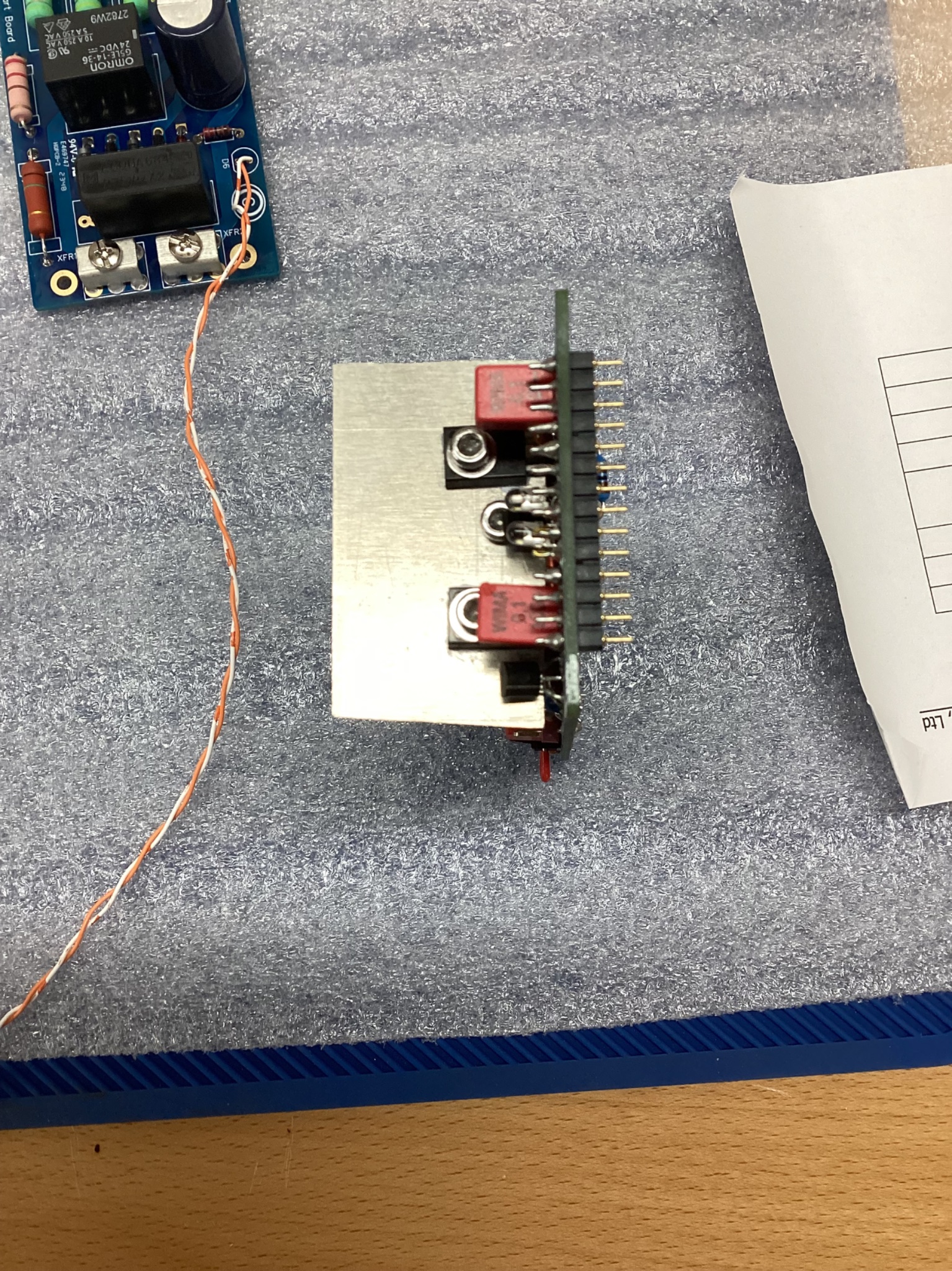

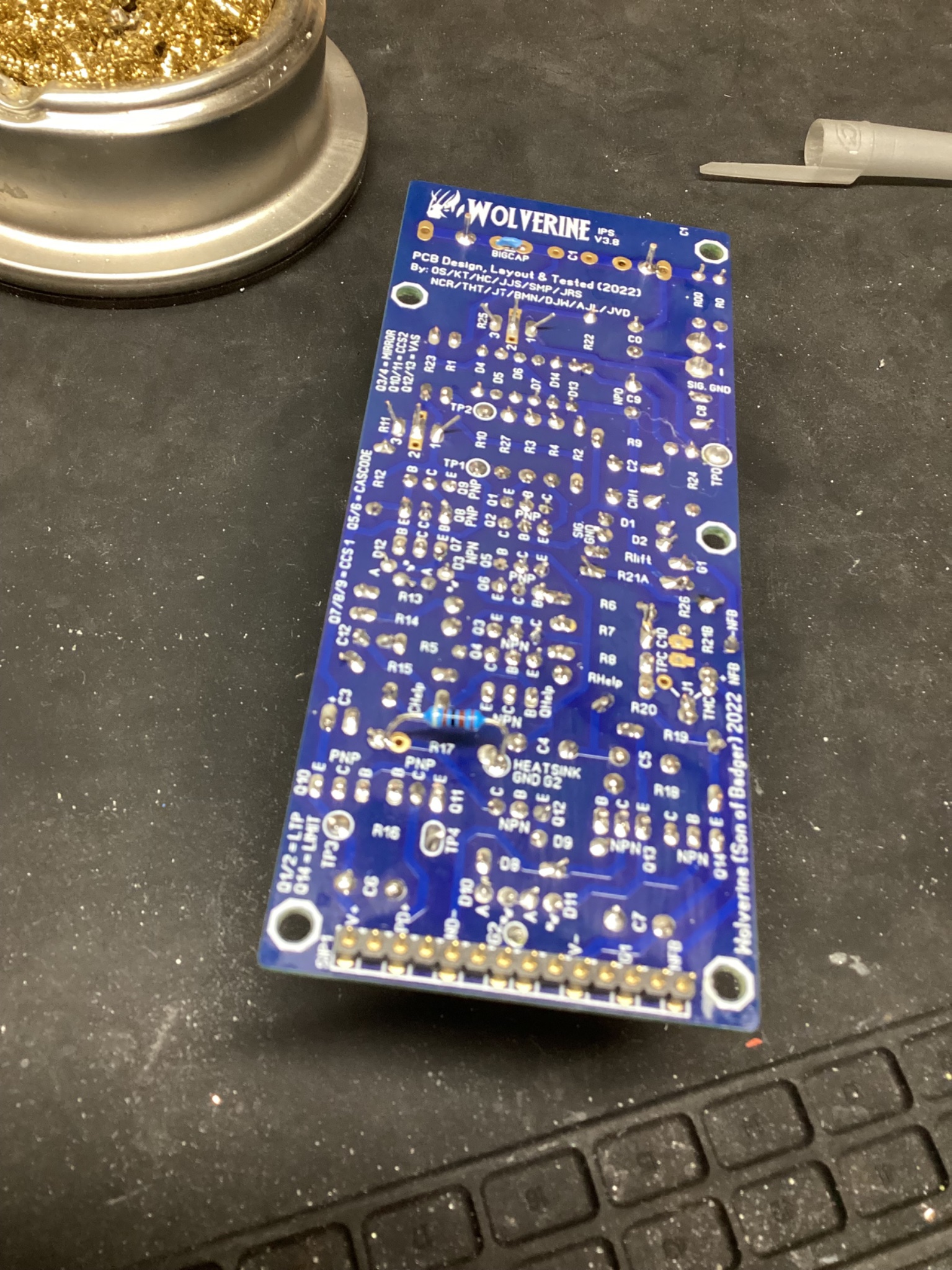

Just reaffirm your male SIP header is correct or you may have a host of issues see this pic, the smaller slimmer pins are the solder side and the longer round pins are to connect to the female

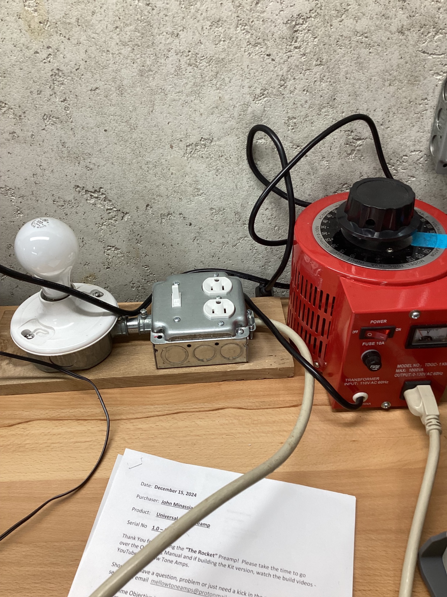

All good on 0.5A fast blow - if you have the ability to bring the rails up slowly, maintaining the current limit 200-300mA, rather than just dumping on a current limited 30V please do so. You will see any "issues" (excessive current draw) around first around 1.5V-2V, then again around 7-10V, then you should be okay to 30V and onto full rails.
The only way I know to do this is to go back to my dim bulb/variable transformer set-up. Is that what I should do....and then switch to the bench power supply when I don't see smoke?
See picture of IPS board: do I have those pins right? They seem to fit like a glove.

Ok, I have apparently flipped both 14 pin headers out of sheer ignorance. I tried to remove one with a Hakko De-soldering gun and some flux. It won't let go. Getting more physical will destroy the board. The male and female header seem to fit together well, that is, it's not loose. I did ohm out each of the pins, and I have a good connection. Unless someone has a better suggestion for removal, I am going to leave them as they are.😒
Consider ChipQuik desoldering alloy if you have it or can order it. There are various videos online detailing its use.
Don't want to destroy your pcb though so be careful.
Best,
Anand.
Reactions: jminassi
Before you used the desoldering tool did you warm the board up First?
I find if I'm doing any desoldering of a few components, I whip it in my oven at about 40 or a little higher degrees for around 10 minutes and flux top and bottom and then desoldering. Braid comes in handy too.
Tony
No, I didn't warm the board, but I did follow up with flux and braid. That thing will not budge.
