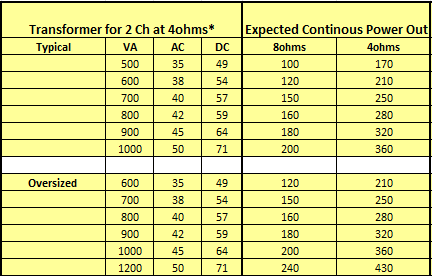

120w into 8 ohm would be fantastic.
So rail voltage is output from the rectifier correct? What needs to be the input voltage from the transformer to the rectifier? Is there a drop from the toroidal transformer input to the rectifier output?
You'd only need to target 54VDC rails as per table above, and you could save more by only needing the EF3-3. If three pair EF3-3 is used, the amp would run quite cool relatively, I would go a 4U/300mm (400mm if you want the extra room for PSU and housekeeping boards) chassis, but 3U/300mm might work but a bit hotter.
Rail voltage is after the smoothing bulk capacitors have managed the sawtooth DC from the rectifier. There are some small loses through the rectifier diodes and capacitors but very loosely the rule is AC x 1.414 to DC so dual secondary 38-39VAC transformer will get ~54VDC rails

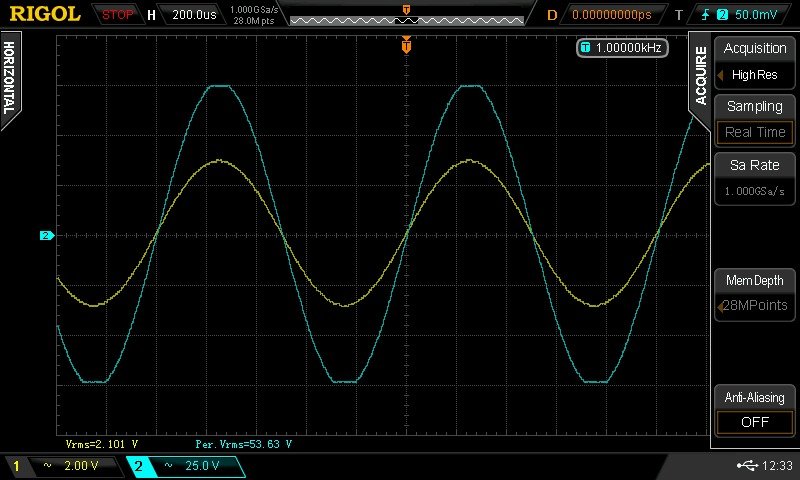

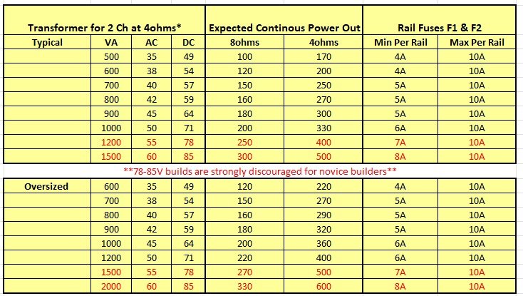

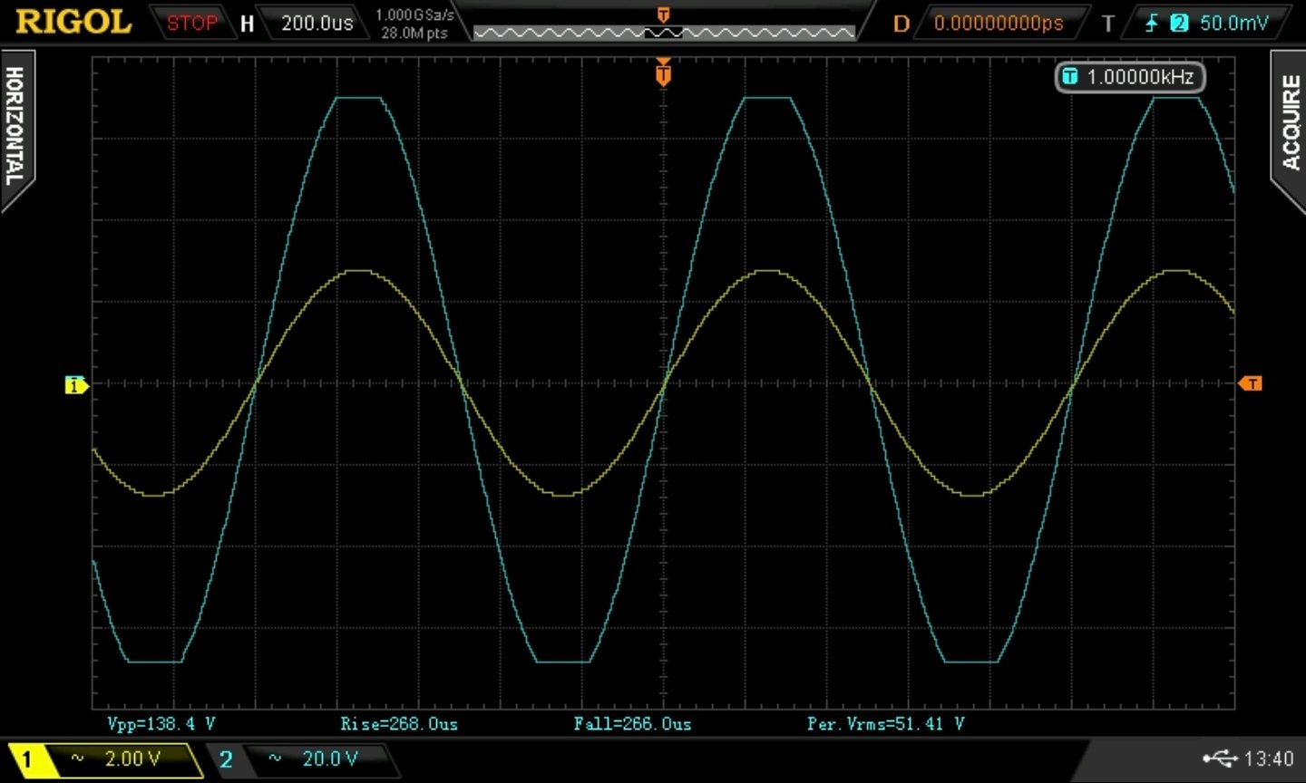

Hi Wolverine amplifier builders,
We would like to announce another option for the Wolverine Version 5.
If you are planning on getting in on the PCB group buy, the V5 EF3-5 option which has 5 pairs of ouput devices is capable of running higher supply rail voltage for some more serious output power options 🥳
Due to the voltages involved this is for experienced builders only....
Please see table attached with the various rail voltage options and a scope capture with a 4 Ohm load.
- Daniel
