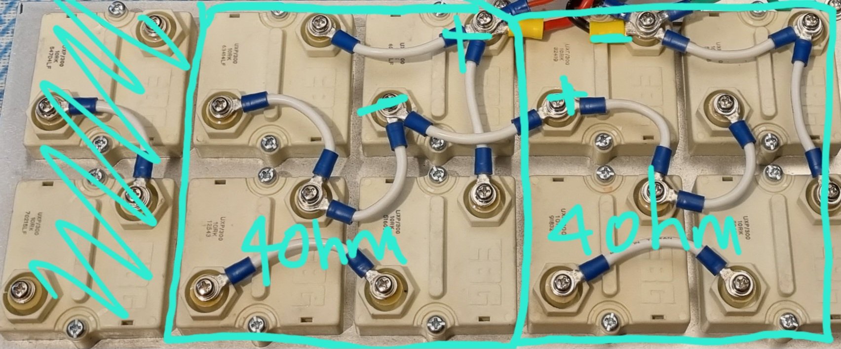

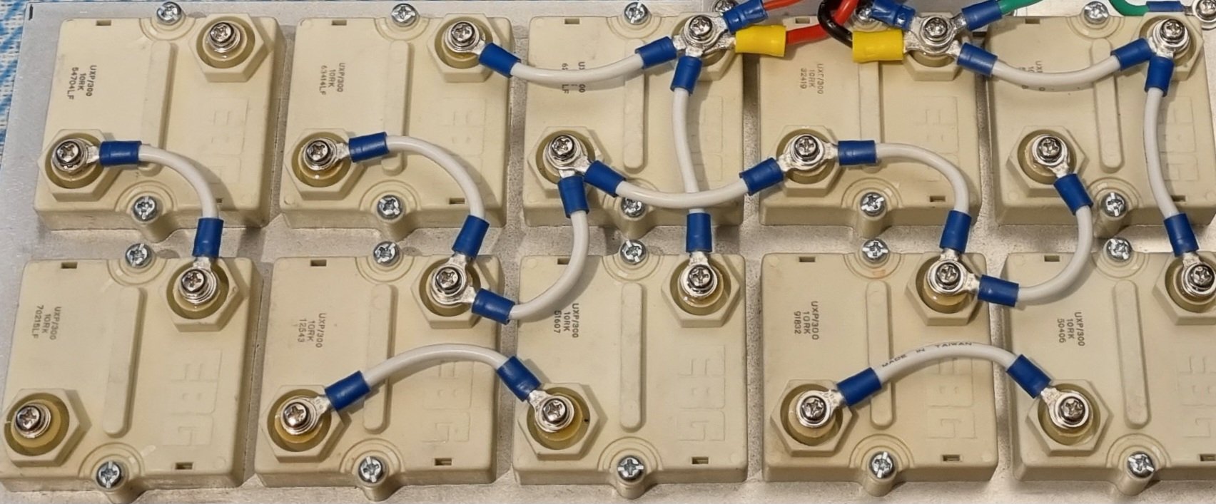

Thanks for your Wolverine videos. In one of them you beautifully showed testing configurations for 8 ohm, 4 ohm and 2 ohm loads using the 10 ohm EBG low distortion power resistors. I have the same ones and I can arrange 10 of them on a heatsink although I have only setup 4 at this time.
Can you point me to your diagram detailing the connections for the 8 ohm, 4 ohm and 2 ohm loads or post individual pictures of your setup with the 10 EBG resistors on the heatsink? I have read ESP’s Project 124 describing his method which uses 4 ohm resistors.
I want to double check since our setup uses 10 ohm resistors. It’s a fun mental exercise to do without resorting to series parallel calculators!

The forum timed out before I could finish my edits. My plan was to replace the 4 ohm resistors in figure 2 of ESP’s link above with the 10 Ω resistors, i.e. (2) 10 Ω resistors in parallel to create a 5 Ω resistor which is close enough and use the connections as detailed in the diagram. As such, the setup would use (8) 10 Ω resistors for a stereo dummy load setup. Throw the whole thing together on a 5U/400 heatsink, 4 EBG resistors per half sink; mount some brackets and be happy.

Hi Anand,The forum timed out before I could finish my edits. My plan was to replace the 4 ohm resistors in figure 2 of ESP’s link above with the 10 Ω resistors, i.e. (2) 10 Ω resistors in parallel to create a 5 Ω resistor which is close enough and use the connections as detailed in the diagram. As such, the setup would use (8) 10 Ω resistors for a stereo dummy load setup. Throw the whole thing together on a 5U/400 heatsink, 4 EBG resistors per half sink; mount some brackets and be happy.

I have two 4 ohm sections, which allows 8 Ohm using a series configuration, or 2 Ohm using a parallel configuration. For 4 Ohm I just use one section.
Thanks for your kind words about the videos.
Hope this helps
- Dan
