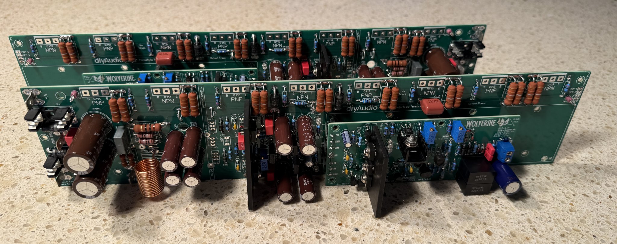

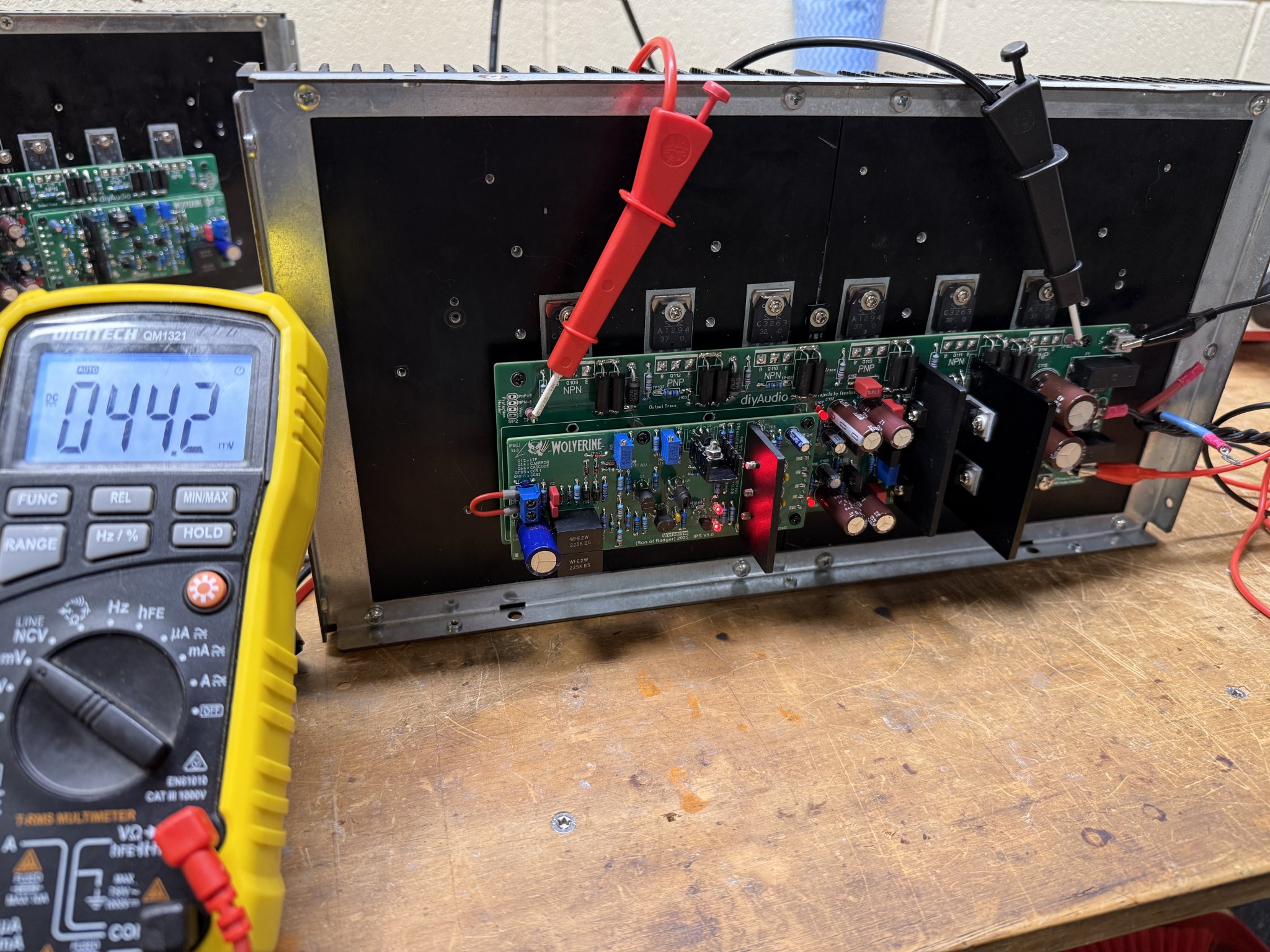

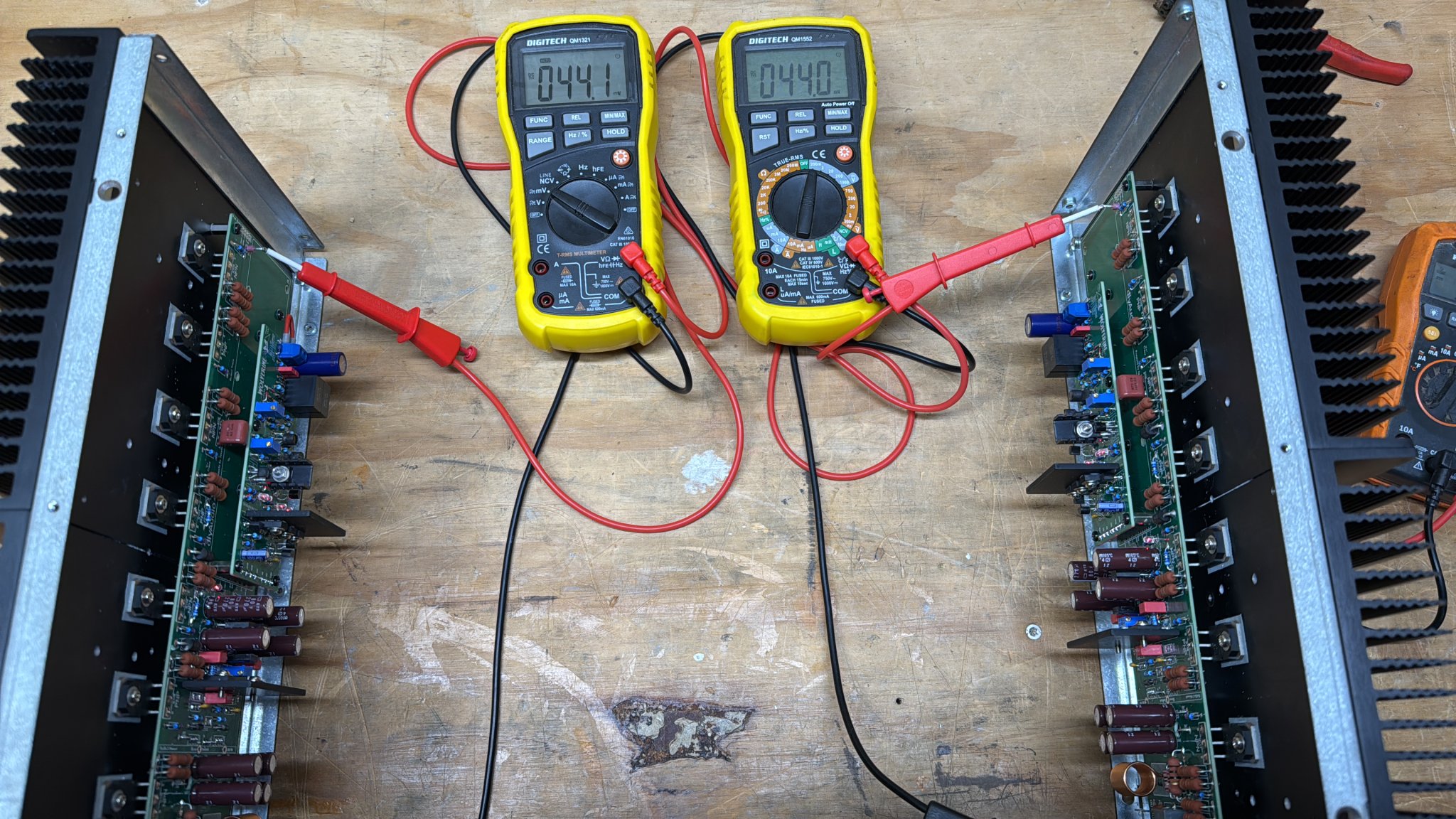

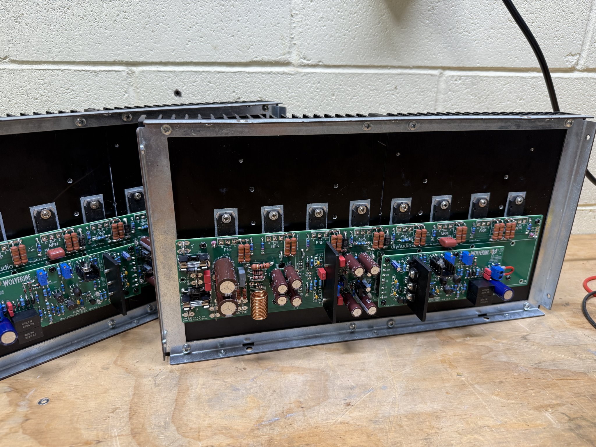

V5 is alive!
The first EF3-4 V5 mirrored stereo set has received full voltage and biased up like a dream. Excuse the workshop dust, cat hair and solder flux on the output transistors it was getting late!
Passed all initial power up and warm up tests no issues at all. Huge thanks to the team for putting together, and meticulous QA, of the schematic and PCB and BOM @stuartmp @danieljw @Harry3 @jjs so that when I powered it up (very cautiously) it didn't splode or smoke. EF3-3 and EF3-5 builds to follow.
