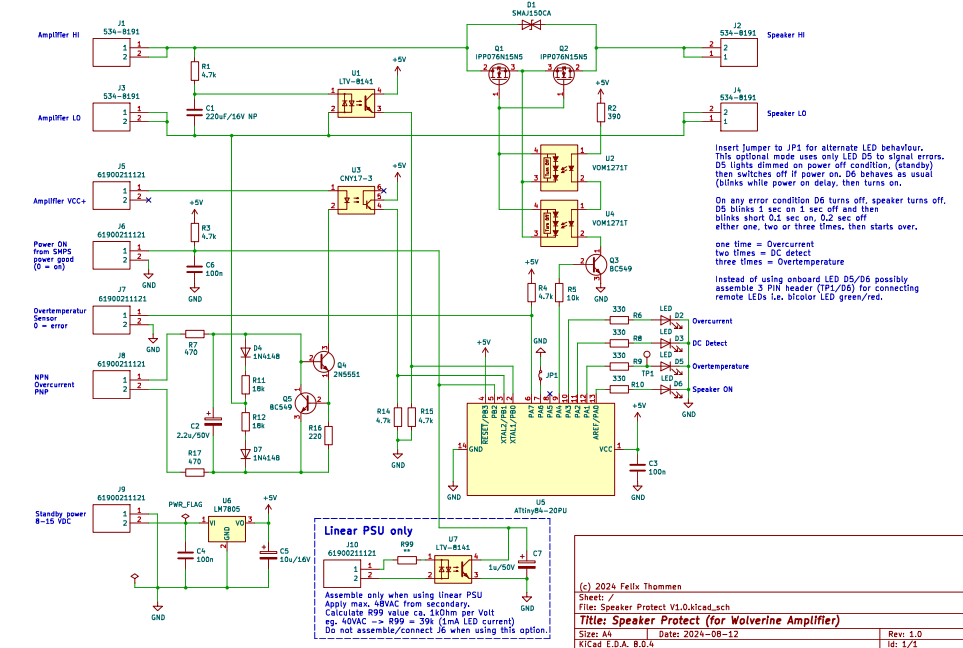

Does anyone have an amplifier output device protection design for this thing yet? I tried to come up with something, but the pin header lacks some of the signals I would want, so mine is a bit messy to install.
I went for a fairly simple current limiter (About 4A per device) with the SOA enforced by a STM32 measuring Vce, current and heat sink temperature and doing sums to ensure the junctions stay safe, seemed both easier and better then trying to tune a multi slope VI limiter.
Sometimes digital really is best.
The protection header was meant to connect to an optoisolator that's tuned to trigger at the SOA of the outputs. I prefer digital protection too.
Reactions: thimios
The protection header was meant to connect to an optoisolator that's tuned to trigger at the SOA of the outputs. I prefer digital protection too.View attachment 1446293

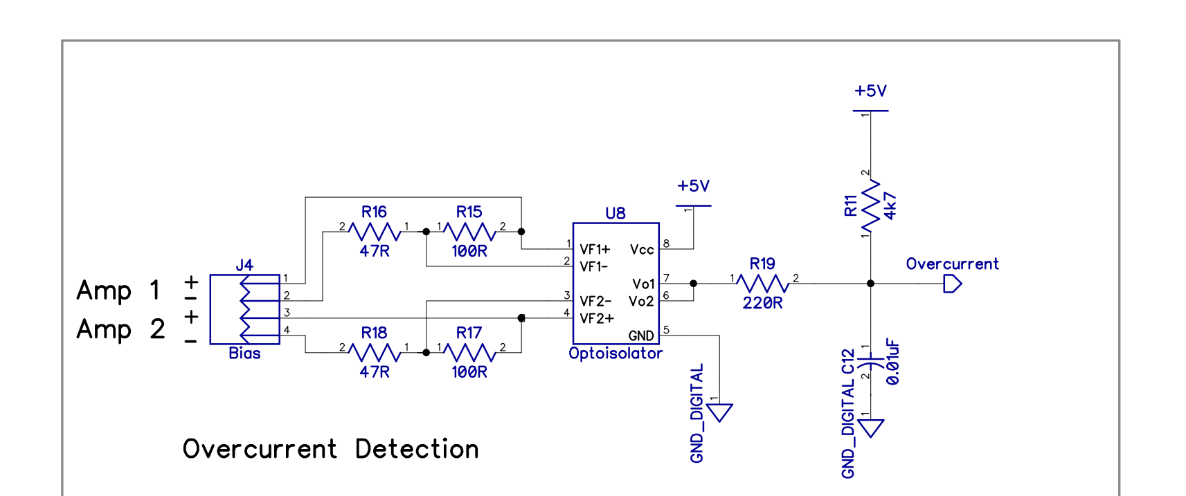

Hi Jeff,
I have used this system in my YouTube build, it works very well however I did need to add a couple of Zener diodes to each of the optocouplers on the psu board in my build which was a great suggestion from JJS in the Wolverine team.

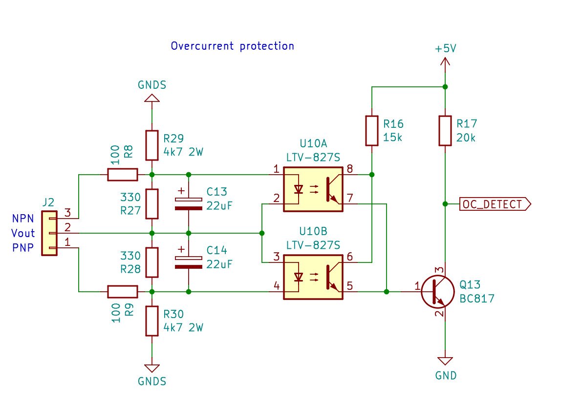

I am currently testing this circuit for overcurrent protection. The output will be coupled to a tiny processor, much like in Felix's circuit. R29 and R30 introduce a simple slope VI limiter, and Q13 increases the sensitivity of the optocoupler (with respect to a simple load resistor). I have to test this circuit yet but anyone who thinks this is a bad idea please let me know.
