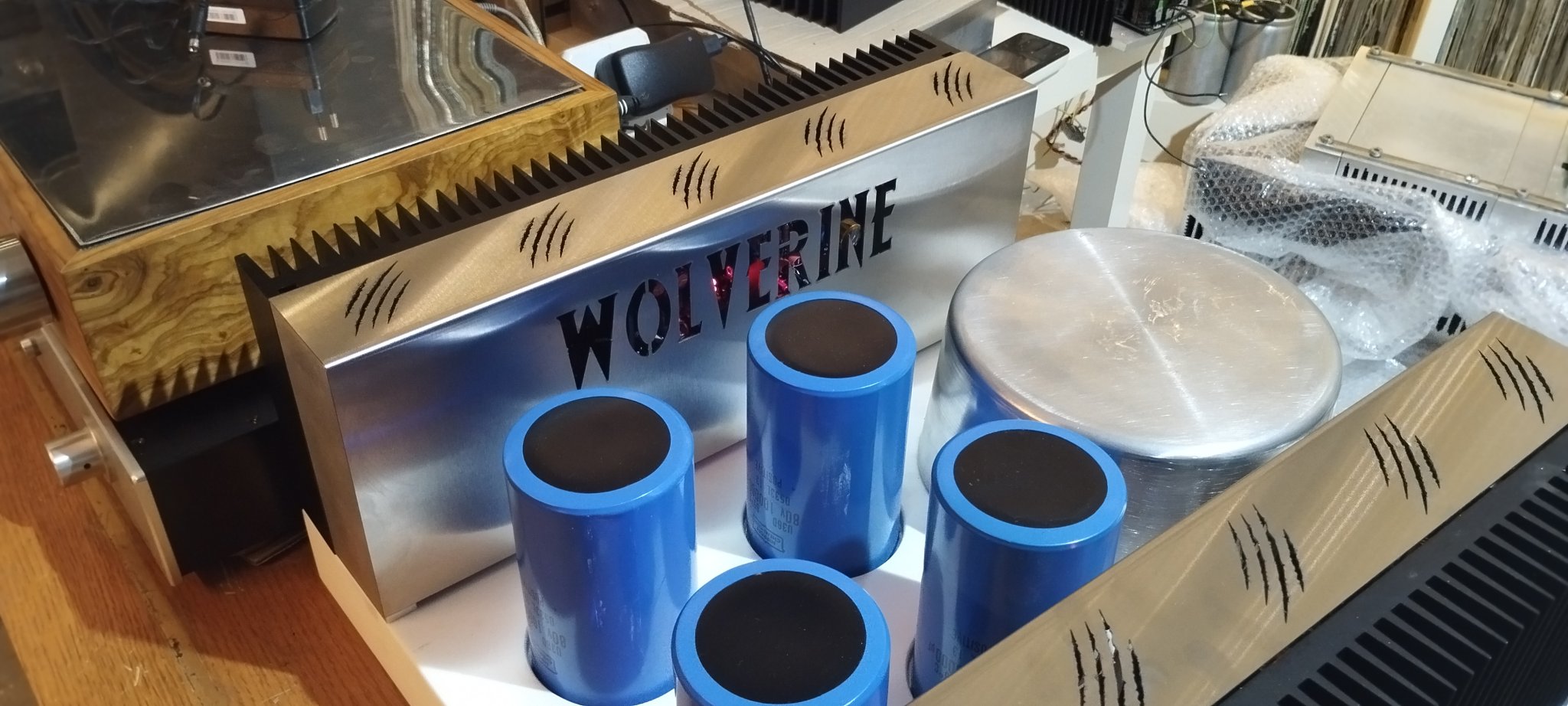

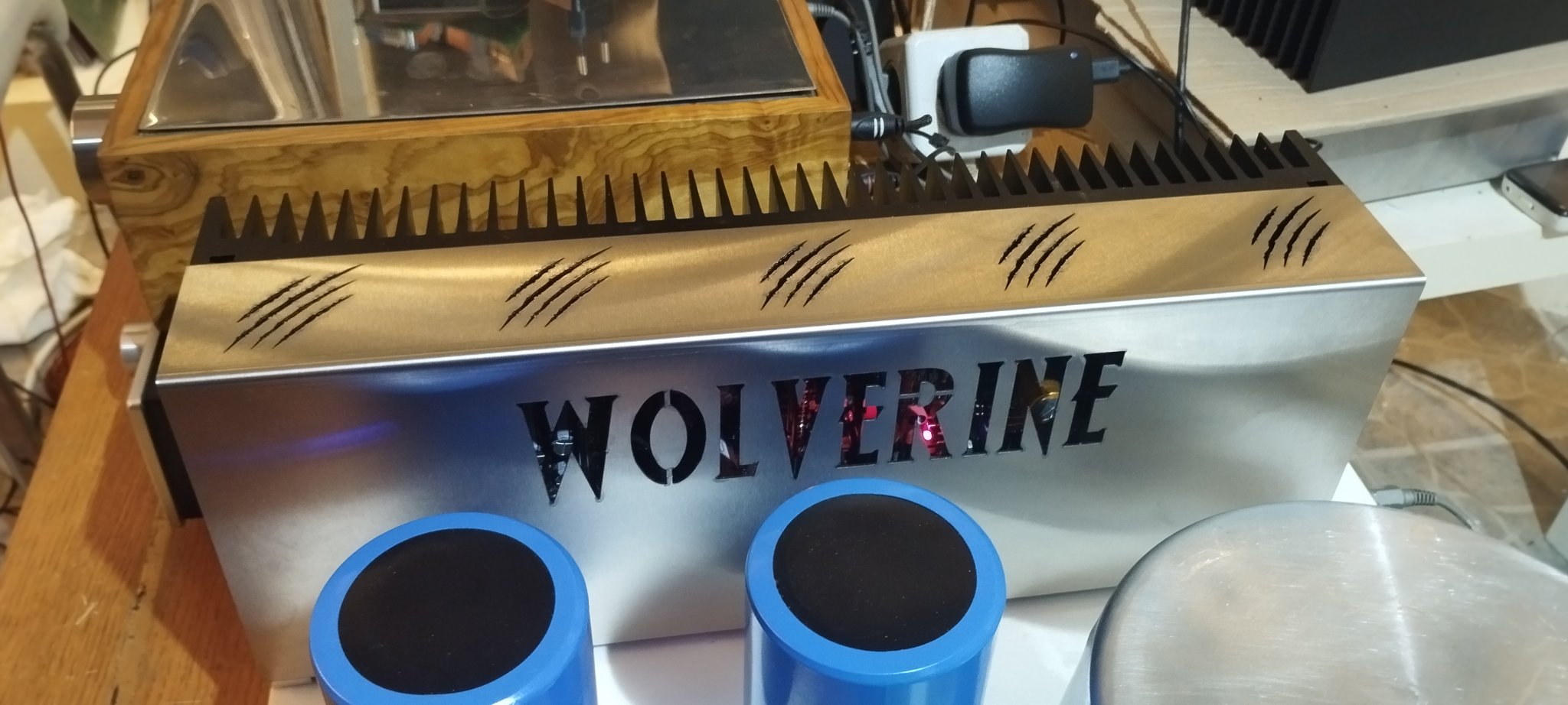

The lids are in,
The aluminum still needs to be anodized
And the base legs
And the base legs
That is SICK 😎 😎 😎. I'd be proud to have that on show in my lounge!
Awesome work!
Fantastic detailing with the jagged claw marks, Bravo.
Edit: The more I look at this amp, I don't know if I'd anodize the raw aluminum in black. I think you'd lose the Wolverine name and claw marks if all was black, maybe a clear anodize for protection? Just a thought.....

That's right, this is stainless steel, it will only be brushed for polishing, the aluminum ones are the sides and the cover of the transformerAwesome work!

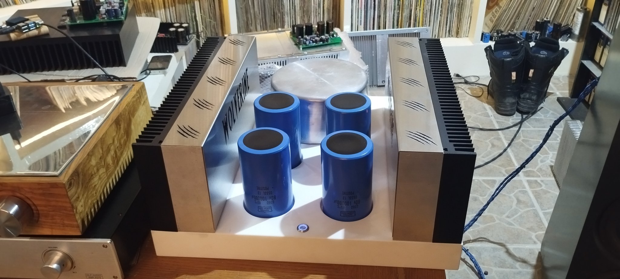

You're welcome, if so, send a message.Bravo Minoa! Excellent work.
If I go to Crete this year, I want see it.

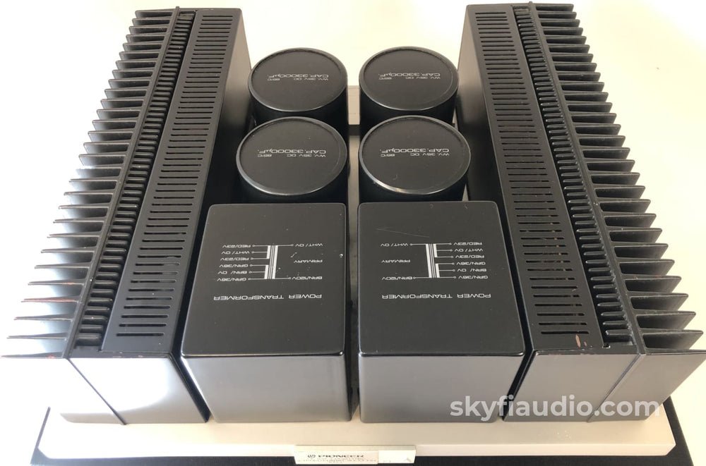

Years ago I have inspired from this Pioneer class A but no action😞
Minoas came quite close👍.

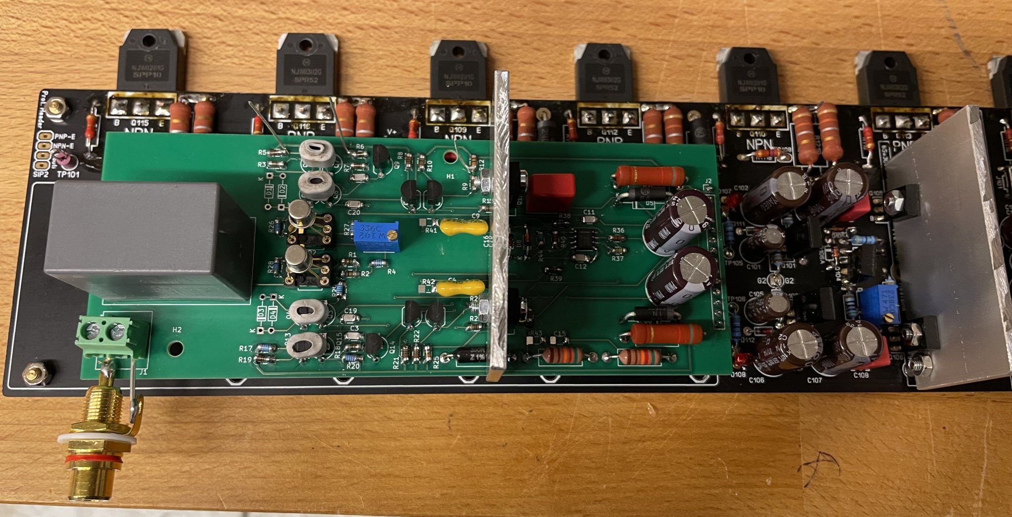

The great modular concept of the Wolverine amplifier makes it possible to test differnt IPS designs. I just finished a prototype PCB with Bob Cordells IPS for the DH-220C Mosfet Power amplifier. It is quite interesting to compare BJT with FET input stages. So far the THD numbers are similar to the original IPS. S/N is really excellent.
The only thing to be careful is the bias spreader because the VAS bias current is different.

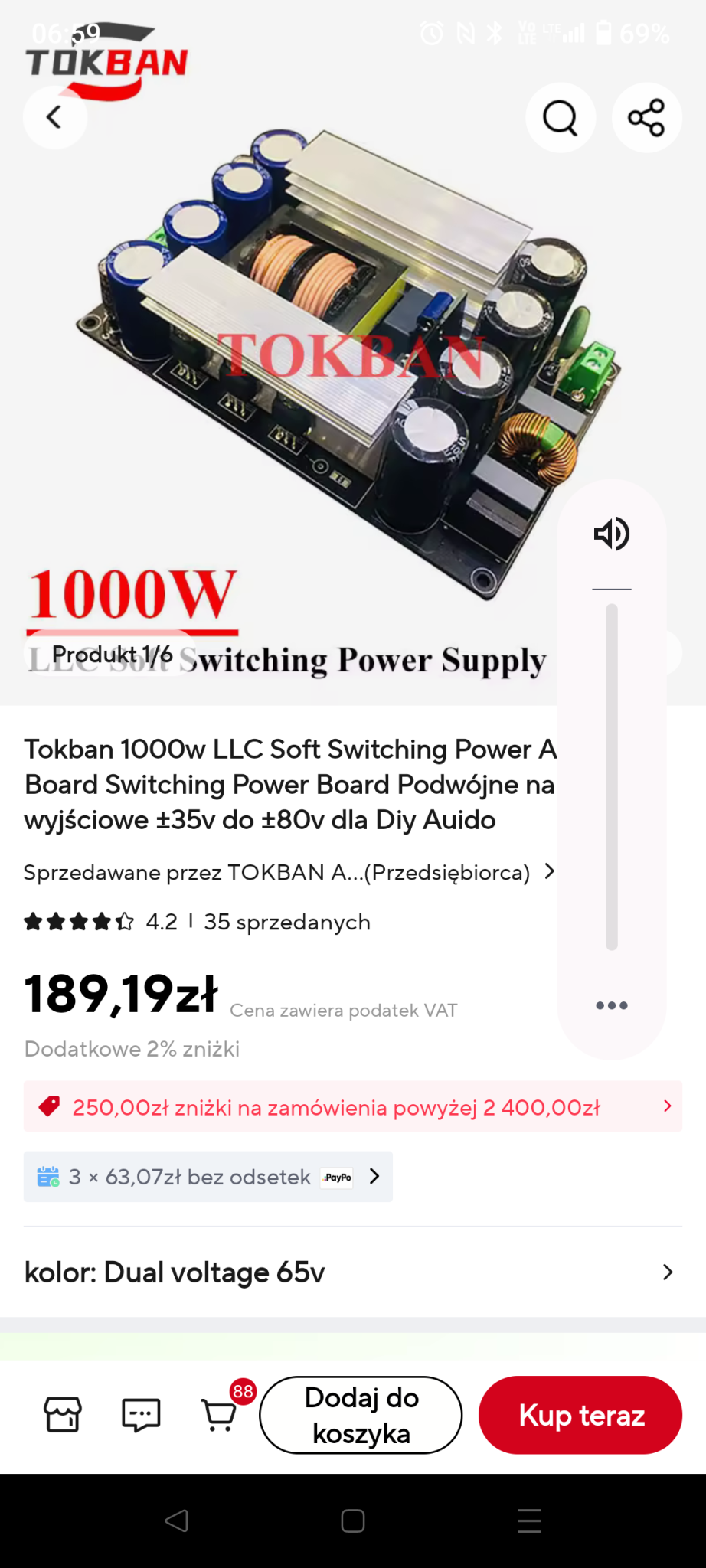

Hello. Will this power supply work with Wolwerine? Tokban 1000w llc soft switch power amplifier.
An SMPS that costs less than the Wolverine pcb’s is not a psu that would enter my home.
MicroAudio for switching supplies or build a linear power supply.
Nice Job Stani, I built Bob's DH500C a couple of years ago it is a great IPS.The great modular concept of the Wolverine amplifier makes it possible to test differnt IPS designs. I just finished a prototype PCB with Bob Cordells IPS for the DH-220C Mosfet Power amplifier. It is quite interesting to compare BJT with FET input stages. So far the THD numbers are similar to the original IPS. S/N is really excellent.
No switching power supplies in my Wolverine, no matter how much they cost!
