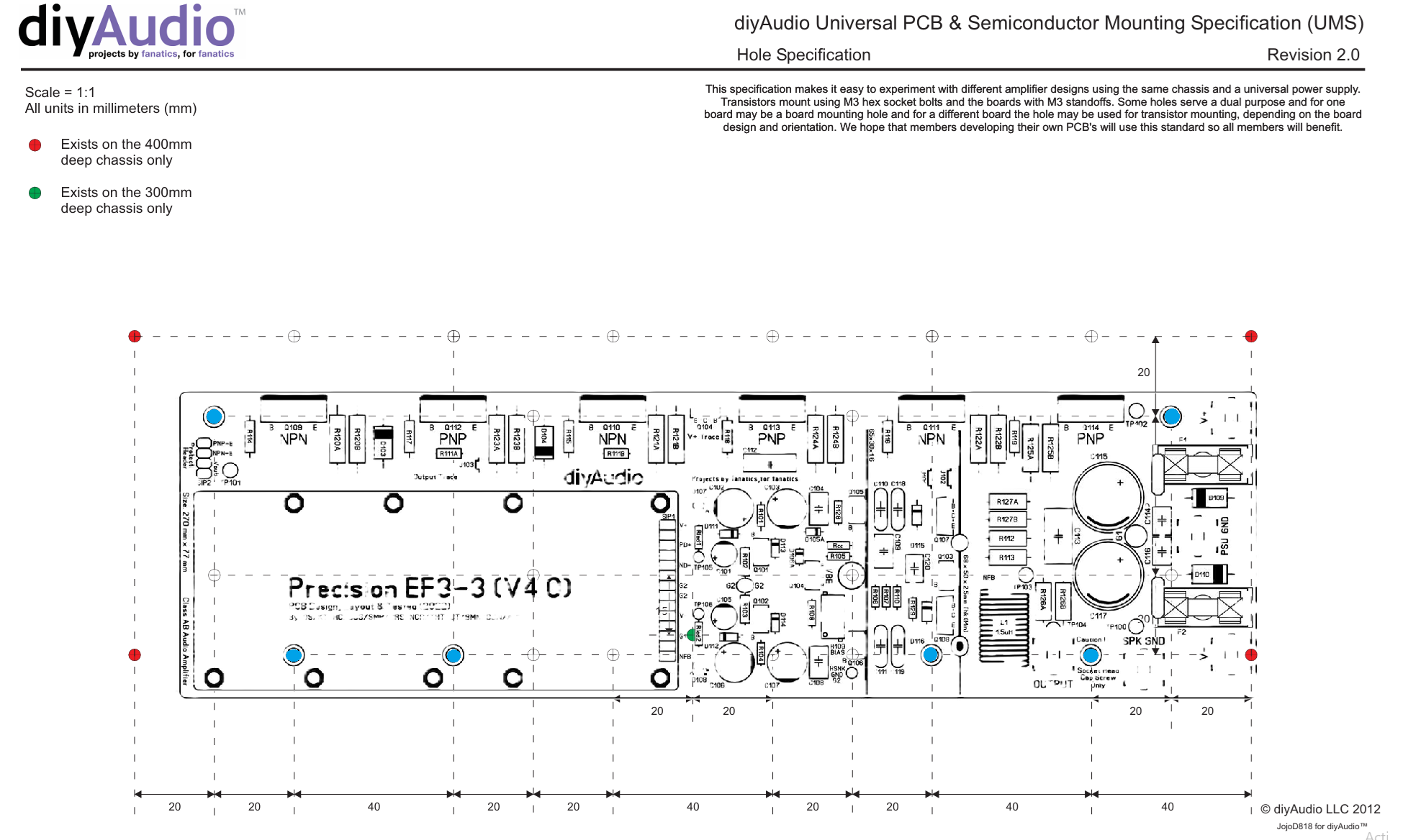

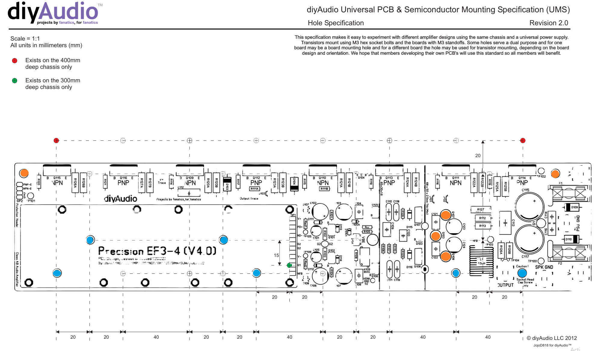

We're getting confused again (sorry I should have alluded earlier). EF3-3 need 6x heatsinks because the OPS drivers are on an auxiliary heatsink of their own (VAS, pre-driver and driver). EF3-4 need only 4x heatsinks, VAS and pre-driver, because the drivers mount on the main chassis heatsinks.
There is a version of the EF3-4 that needs 6x heatsinks, that is where you choose to mount the boards perpendicular to the main chassis heatsinks and not parallel to. Yes, it looks like there is a typo in the sheet.
Just remember that because of this, the EF3-3 doesn't require any heatsink drilling and tapping if you have a UMS 300 or 400 deep chassis. The EF3-4 will require drilling and tapping (~5x holes) in the main heatsink on the same UMS layout.
If you order a deluxe 5U -it default only has the UMS 400mm layout and will require those 5 holes added for EF3-4 (if you cannot do so yourself). Email modushop or PM @Gianluca to help with this, they can provide this service.

EF3-3 overlaid on the original UMS drill pattern - wolverine holes marked in blue - TO3-P output transistors mount to the six holes along the top.
EF3-4 overlaid on the original UMS drill pattern - holes used marked in blue - holes that require drilling marked in orange.
Stuarts board pictured above - you can just see the screwtops of the drivers and Vbe transistor through the holes. 2x auxiliary heatsinks per board.
So yeah, for no custom drilling and tapping its EF3-3 on either the 4U deluxe 300mm deep or 5U deluxe 400mm deep UMS chassis, unless you arrange otherwise with Modushop or order their heatsink substitute.

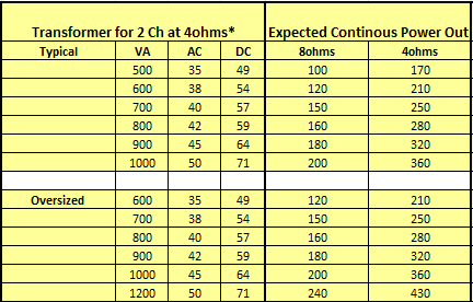

Check out this table provided by @Mainframe
Once you know your rail voltages you can pick PSU components.
Hope this helps as a starting point.

Do you know what is meant by "oversized"? Is there a common brand or model transformer being used? What is meant by a dual mono block design amplifier? Ideally I would have an amplifier that could serve my left, center, and right channels at 200W each but I haven't seen any 3 channel designs here so I may stick to a stereo or monoblock design.Yeah it's kinda "chicken and egg" problem but you need to start somewhere. Do you care about the output power? That was my starting point and I went with 2x200w@8ohm dual mono. I never had dual mono so I decided to go that route (and maybe upgrade to dedicated monoblock chassis in future). Then I was sizing everything from there.
