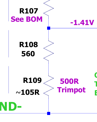

Do I still measure between location 1 and 2 printed on the board for R109. Or do I need to determine which board has the flipped resistors and measure between 2 and 3 on the board to maximize the resistance to 500 ohms? I don't want to hit the board with voltage and have the pot inadvertently turned down to zero resistance.

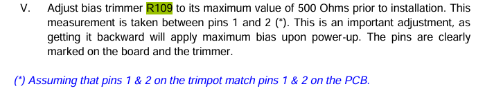

Stuart, I've read the build guide a couple of dozen times. I don't understand it. Build Guide Revision 43 (7-10-23) Section 16.2 Setup IV. says "Verify that R109 is set to its maximum resistance of ~500 Ohm as measured between pins 1 and 2." Does this mean measure between pins 1 and 2 of the pot even though it's upside down? Or does it mean measure between location 1 and 2 on the pcb? It seems to me the circuit on the pcb matters. Or am I completely off base and looking at the wrong section of the Build Guide.The build guide its very clear about these points. Please take your time to review the build guide and post back if your still having trouble

Always measure between 1 and 2 labeled on the board, the board didn't change. You are right you will twist the screws different directions on the two boards.Thanks RickRay. But didn't the orientation of the pot with reference to the pcb change? This would cause you to have to turn the adjustment screw in the opposite direction to increase resistance, wouldn't it? So to max out the resistance on the pot do you measure between pin 1 and 2 of the pot regardless of its orientation, or do you go to location 1 and 2 on the pcb and measure there?

The orientation of the board, or the Pot, doesn't change this fact.Verify that R109 is set to its maximum resistance of ~500 Ohm as measured between pins 1 and 2
You left out the important footnote in blue 😉

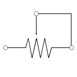

2 & 3 on the PCB are shorted together (or 3 might be a blank pad, I'd have to double check) as we are only interested in making a variable resistance across 1 & 2 i.e. using a potentiometer as a variable resistor.

Pin 1 is the furthest away from the screw and pin 2 is the middle one. Please measure it to the desired value (I guess 500 ohm). PCB orientation relative to the heat sink does not matter.

Yes pins 2 and 3 are shorted on the pcb. But if one pcb is facing up and the other down, then pins 1 and 2 of the pot are not going to be in the same location on each board. This is the source of my confusion. It seems the circuit should rule. As long as the resistance measured on the pcb locations marked 1 and 2 is 50 ohms, you should be good. You will have to turn the adjustment screw in the reverse direction to adjust it. Correct?The orientation of the board, or the Pot, doesn't change this fact.

You need to put the ohmmeter probes on pins 1 and 2, no matter of the orientation of the PCB, heat sinks or anything else. Same goes for screw turn direction, you need to turn it to 500ohm, not left or right.
