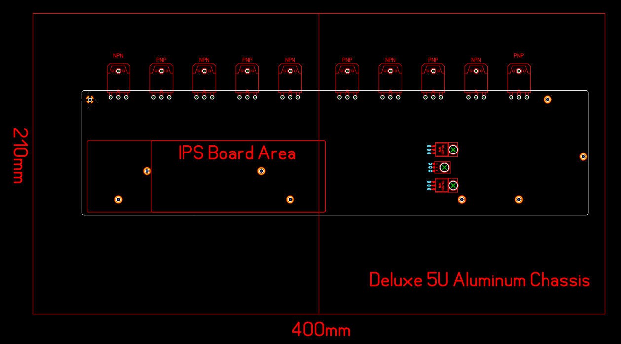

I’m excited to share a fresh development for the Wolverine family: the EF3-5 output stage board! As you know, our current lineup includes the EF3-3 (3 current gain stages, 3 output transistor pairs) and the EF3-4 (3 current gain stages, 4 output pairs).
Now, we’re taking it up a notch with the EF3-5, featuring 3 current gain stages and 5 output transistor pairs for even greater power and stability.
To top it off, I’ve mirrored the EF3-5 design—just like the EF3-3 and EF3-4 in the 5th Group Buy—offering dedicated Left and Right channel versions. This keeps the inputs at the rear and outputs low on the heatsink, maintaining that clean, symmetrical layout you’ve come to love.
The EF3-5 boards are 7 mm longer and 10 mm wider than the current EF3-4 boards. All the holes still follow the UMS, except for the two at the top where the output transistors mount—they’ve moved up 10 mm. The output transistor mounting holes have also shifted up 10 mm, so some drilling and tapping will be required if you’d like to use the EF3-5.
The EF3-5 is perfect for those pushing higher currents or lower impedances (think 2-ohm loads or beyond) with the same Wolverine Class AB finesse.
Please see the 5th Group buy thread for further details.

354mm, Its 7mm longer then the EF3-4, Yes it will fitThat's great news! Can you tell me how long the EF3-5 board will be, ...if it will fit in my 400mm long modushop chassis?

Adding extra output pairs won't increase output power for same PSU size/voltage. 64VDC power supply will still deliver up to 200WPC from a 3 pair, 4 pair and 5 pair. The ability to handle difficult loads improves with more output pairs. Each pair added increases idle current flow and heatsink temperatures.
5 pair is aimed at more experienced builders, more install complexity and heat considerations. I would advise 5 pair be used with 5U chassis. Or 4U chassis stick to 60VDC max rails to keep idle heat under control.
