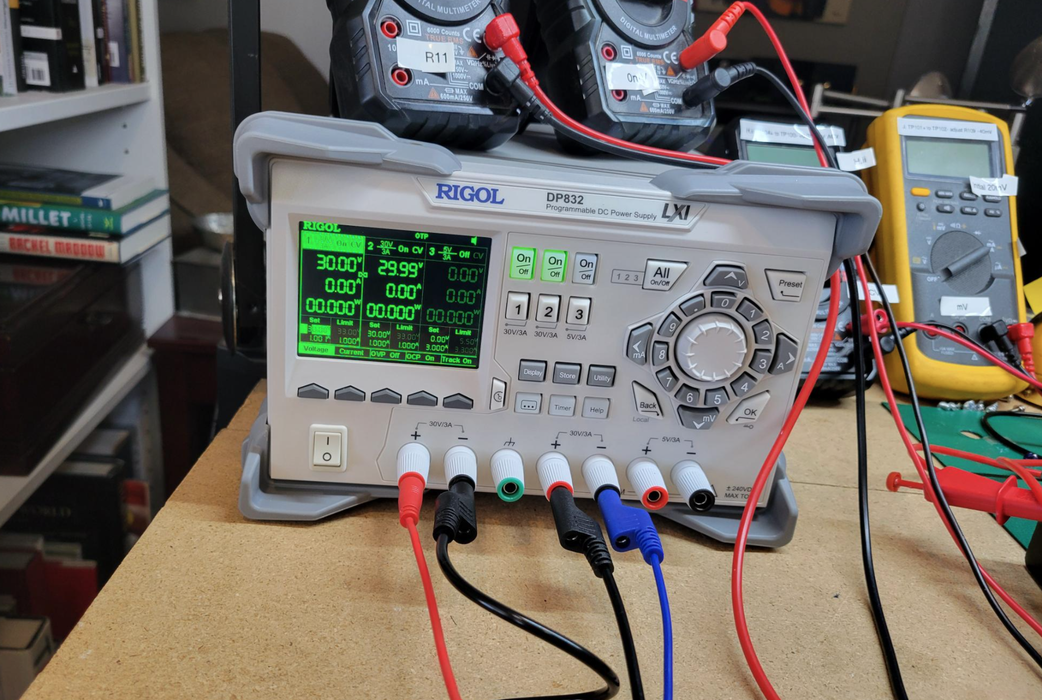

What is the amperage reported on the outputs on the Rigol? (i.e. is the supply current limiting, even with the Bias at 0?)
Your measured voltage across TP101 and TP102 is 0.00V?

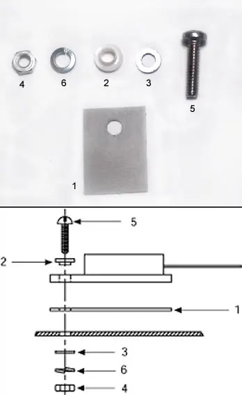

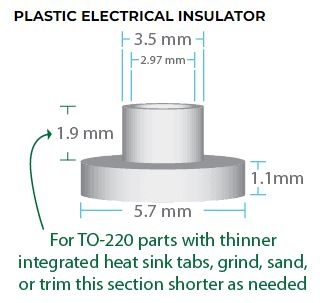

I am just completing the build of the first power board, EF3-4 V 4.0. I am mounting drivers Q107 and Q108 under the board so that they lie on the heatsink. I noticed that my MJE15032G and MJE15033G drivers have full metal backs. This means I need to source shoulder washers front and back and use thermal pads to isolate them. Those drivers are in a TO-220-3 package. Looking on Mouser it looks like you have to measure the hole in the transistor in order to source the right one, correct? Do you use two identical washers for the front and back of each transistor?

I'm not sure what the exact part numbers for the TO-220 insulator and washer are. I just used these from my local "radio shack" and they worked well. Hope you can find something local. https://www.jaycar.co.nz/to-220-silicone-rubber-insulating-kit-pack-of-4/p/HP1176
Heres an image I pulled from the web - you only use one washer so the screw holding the transistor to the pad does not contact the metal heatsink of the transistor
In this case you ignore 3, 6 and 4, because your screw (5) is going into a threaded hole in the heatsink. You just need 1x nylon shoulder washer (1), the screw (5) and the thermal pad (5)

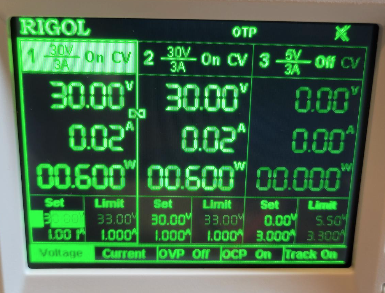

Not sure on your first question. I set the Rigol for 1A. And the limit at 1A.What is the amperage reported on the outputs on the Rigol? (i.e. is the supply current limiting, even with the Bias at 0?)
TP101 to TP102 reads 0.0mV with R109 set at max resistance.
The power supply should read 3 things per rail (I could be wrong I'm not familiar with all models) - Voltage, Current being delivered and current limit or wattage. The current may show two lines or be selectable - the actual current being delivered, and the current limit.
The current limit is not the same as the current being delivered in real time.
This is so you can see the current increase or decrease as you control a load, and then you can tell if the rail is slamming into the current limit.

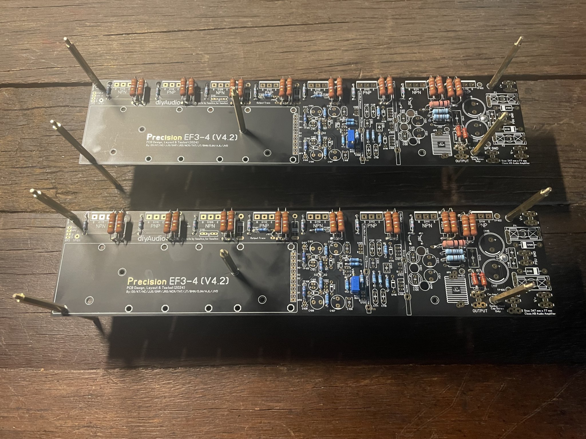

A little more progress today. Resistors in…
Okay the boards only drawing 20mA a rail, that's good. nothings shorting and slamming the PSU into the current limits. I suspect the CCS cannot get its full current at 30V rails due to the addition of the output transistors - but would need comment from more experienced builders. Is the resistor still installed parallel across R17? This should have only been removed for when you go to final rail voltage.These are the readings with R11 maxed out and getting 2.9V
R109 still set at max resistance.
I'd try turning the R109 bias circuit up and monitoring the bias voltage and the PSU current being delivered on each rail to see the bias circuit "working", then bring it back down and go to full voltage 64V test. If nothings shorting and smoking, or pulling the PSU into the current limits at 30V, 64V should be fine.
