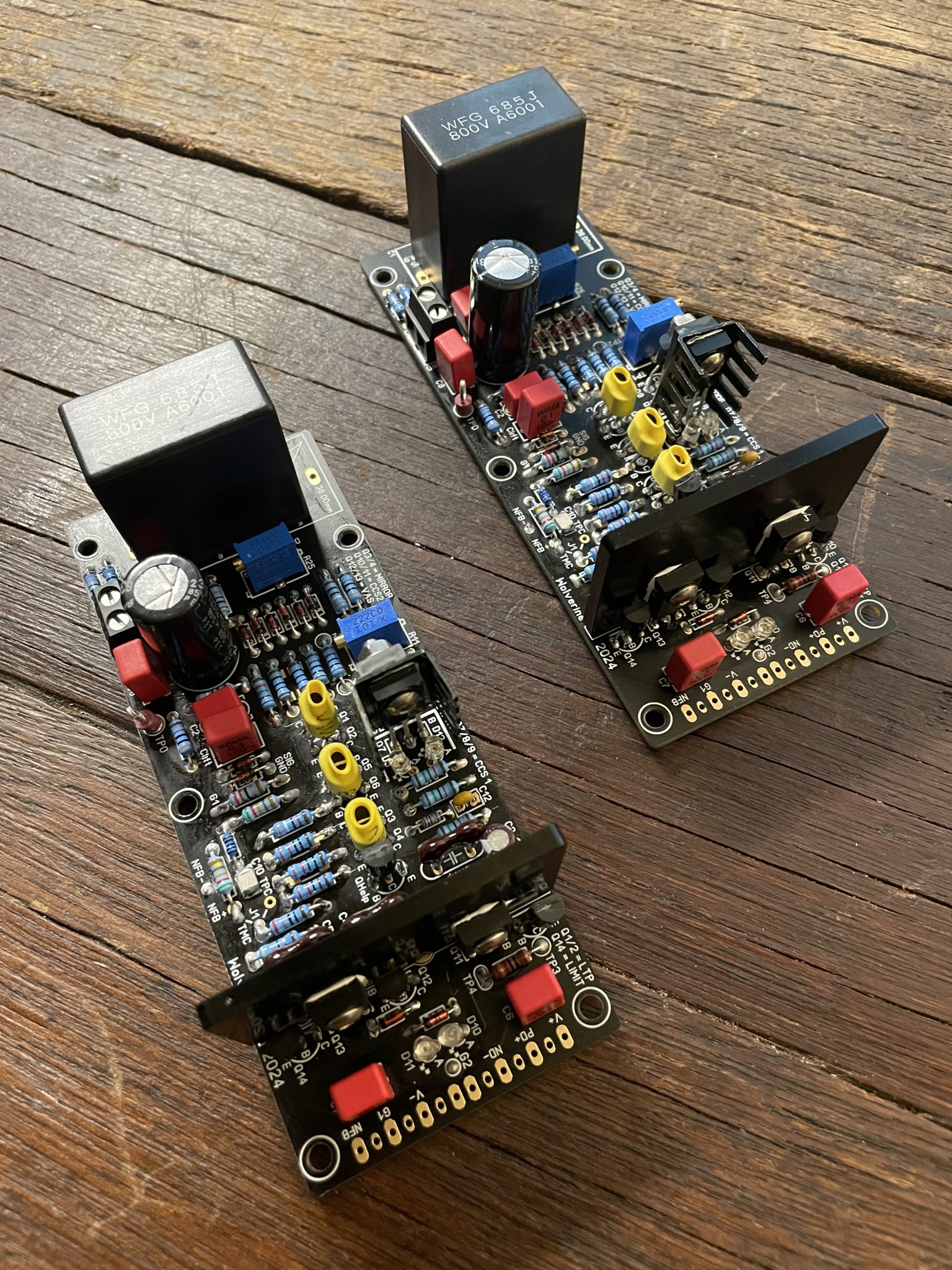

Good progress this weekend, input boards done, next up the output boards.

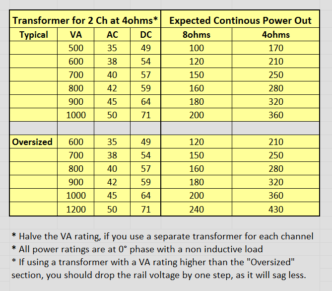

Again, it depends. But as you're not sharing any more information I would settle for a PSU of 42VAC.
Ideally. You can use larger power supplies with same voltages but you must use stronger parts as a consequence. The BOM has a column showing what parts to use with SMPS or way oversized power supplies
And to your original question, you can get the full 240W into 8 ohm with a 3 pair if you use a 50VAC power supply and the strongest drivers and outputs in the BOM

My Cobra SMPS is 64DCV out.
