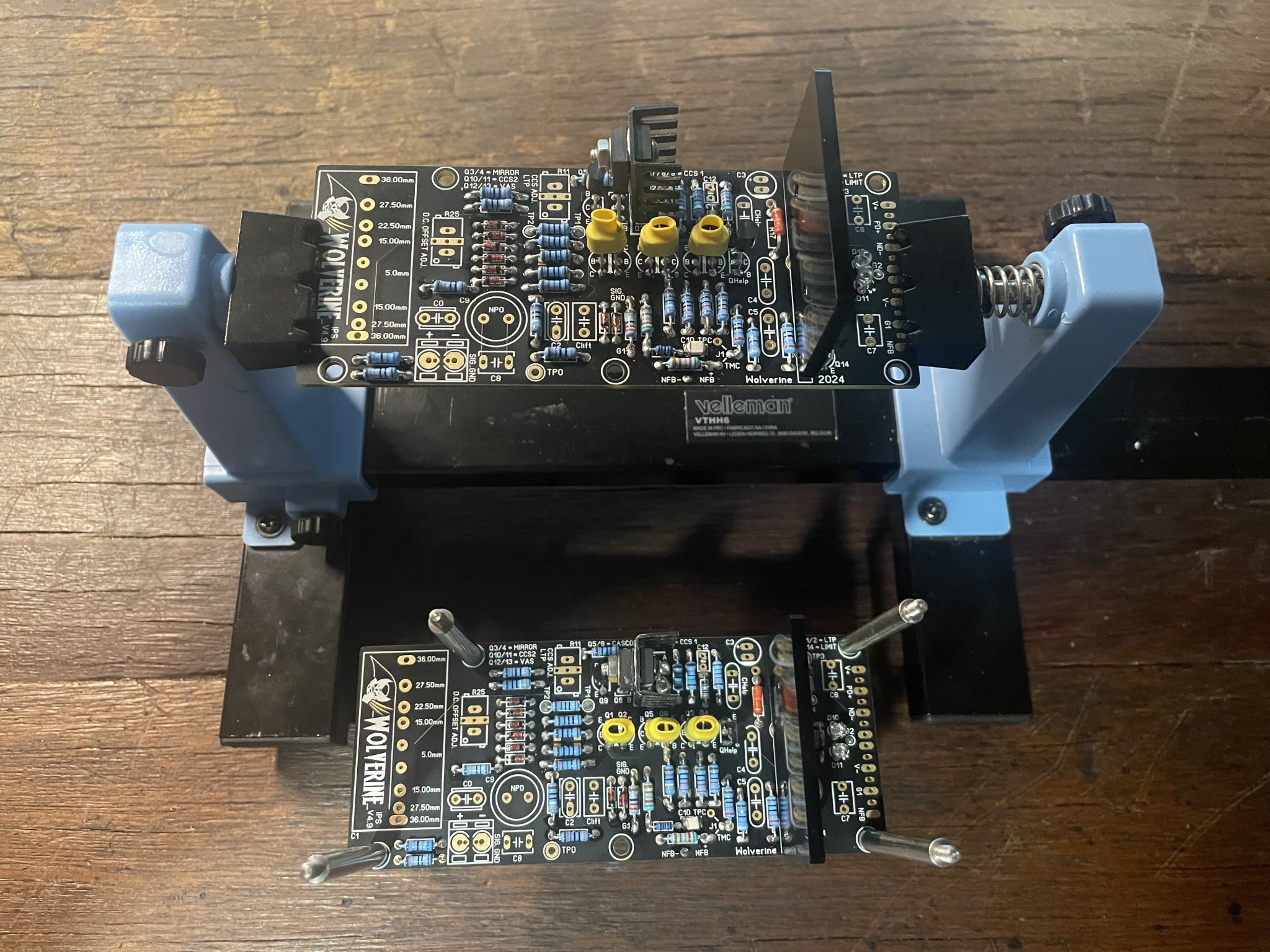

I have successfully completed Initial power up.
I adjusted R11 to 5V DC.
I adjusted TP-105 V+ and TP-106 V- to 1.5V
I adjusted R109 to 1.15V DC.
I was using a Rigol DC Reg Supply.
I have now installed the power transistors and am ready for section 20: powering up the output transistors.
Two questions. Upon completing the initial power up I turned R109 back all the way.
1. I did not reduce R11, so it is still set at 5V. Is that an error and do I need to remove the output transistors and turn down R11?
2. I am using a Cobra SMPS and my understanding it that I can't use a Variac with it. Should I proceed?
If not, if the risk is too great, my back up is to install the 64DCV regular PSU and use that to bias my amp boards.
I appreciate guidance here. I've come too far to mess it up now.

An additional thought. If I do need to dial down the R11 setting [5V DC], can I leave the output transistors in and use my DC supply to power it up enough to reduce R11, without creating any other issues? That would limit the DCV to 30DCV.
FWIW - I think you are fine. I would only suggest once you have everything connected, to check for shorts, + to GND, - to GND and all outputs to the heatsink. Then at power up, even if R11 goes over 5V, it will be a few mV, which won't blow anything, and you can dial it back, the most important is the Bias, and if you have taken the precautcion to dial it back you will be fine.
If you are super cautious, you could always put a 1r (5-10w) resistor in line from the SMPS to the amp board, which will limit the current and burn up those resistors if you do have a bad issue - again, your DMM should help you know that before power-on, so it's up to you.
I went from +/-36V on my bench to +/-68V in the chassis and turned the bias pot down 5-6 full turns and it was only a little high at start-up and the 5V was high like 6V, but a half turn and it was within spec.. Testing on the bench and moving to chassis, went uneventful, thanks to the good design.

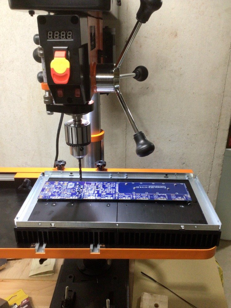

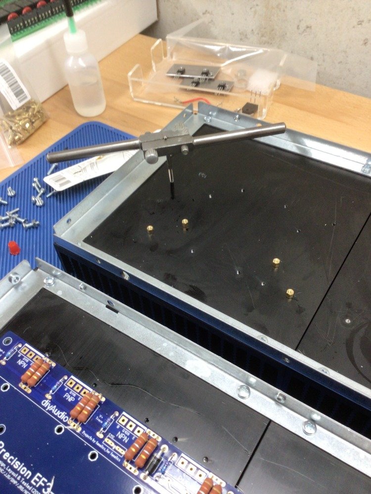

Just a progress report. Tonight was drill and tap the diyaudio 5U heatsinks for a couple of extra standoffs and for Q103, Q107 and Q108 which will go under the pcb (I have the EF3-4 V. 4.0 boards). I bought 100 brass 10mm standoffs from Amazon for less than $8, but like Daniel the 6mm threaded area was too long. So I took his advice and used my Dremel to shorten them. Threading the nut on before you do this is essential as it deburrs the cut threads. They appear to fit perfectly. Just follow Daniel's procedure for marking the position using the pcb as a template. Use Tap Magic or similar oil. Make sure to use a 2.5mm drill for a 3mm tap. Take it easy when tapping.....those standoffs are soft brass...and use oil.
Best to all,
John

You need two resistors , one resistor for each rail (1- positive (SMPS to amp) and 1-negative rail (SMPS to amp))bullittstang,

1. No, you do not need to turn down R11 after completing initial testing (step 17) without output transistors. This will remain at or around 5V (it will drift a little as temperatures change) so its fine to leave it and tweak it later. (It would have been put in the build guide if this was a requirement.)I have successfully completed Initial power up.

2. No, you should not use a Variac on the Cobra, it will cause undesirable behavior and may blow its internal fuse or output protections.
If it is your first time, step 20 must be performed with the same "TESTING" power supply you used for step 17, ideally 30V. If you have performed step 17 with full rail voltages, I hope you first removed the temporary resistor placed across R17 (or never had installed). You may be okay to go full rail voltage at step 20 if step 17 passed full rail voltage, just be sure to have the correct fuses installed as step 20 A, and you absolutely must have passed step 19, and also checked all transistor legs for no shorts to PCB ground or the heatsink.
(The cobras output SC protection is faster than the 2A fuses if there is a rail-ground or rail-rail short anyway, I've ahem tested this)
Remember, at step 20, you are measuring bias voltage at TP's 101 and 102, NOT R111A and R111B. The build guide unintentionally confuses the reader here by saying "as done in the initial test procedure", potentially leading the builder to put the probes BACK at R111A and R111B, which is incorrect.
P.S> how did you do this? these values aren't adjustable, but they do vary slightly with rail voltage, which leads me to believe you did manage to complete step 17 with full rail voltage?
This fuse is only protecting the internal AC line cable from shorts to the chassis running from the IEC socket to the cobras AC input. Your IEC socket should be a 3 pin, with the earth connected directly to the chassis.Can I ask what fuse rating you use in the IEC for the Cobra?
The cobra is capable of pulling 1900W peaks (1200W sustained), and your American sockets are capable of ~1800W sustained, so this fuse should be 10-12A (15A at the absolute maximum) - provided the cable gauge you used from IEC to cobra can sustain this also. Otherwise the fuse must be sized to protect the maximum the cable gauge can handle. The cobra has a fuse protecting anything beyond its AC inputs from shorting on its PCB, and also has protections built in for its output rails.
If, for some reason, you used skinny *** cable from the IEC socket to the cobra than can only handle 5A, you really should have this fuse at 5A. (yes i know the short distance means the skinny *** cable can probably handle more but let's keep it simple and safe)
