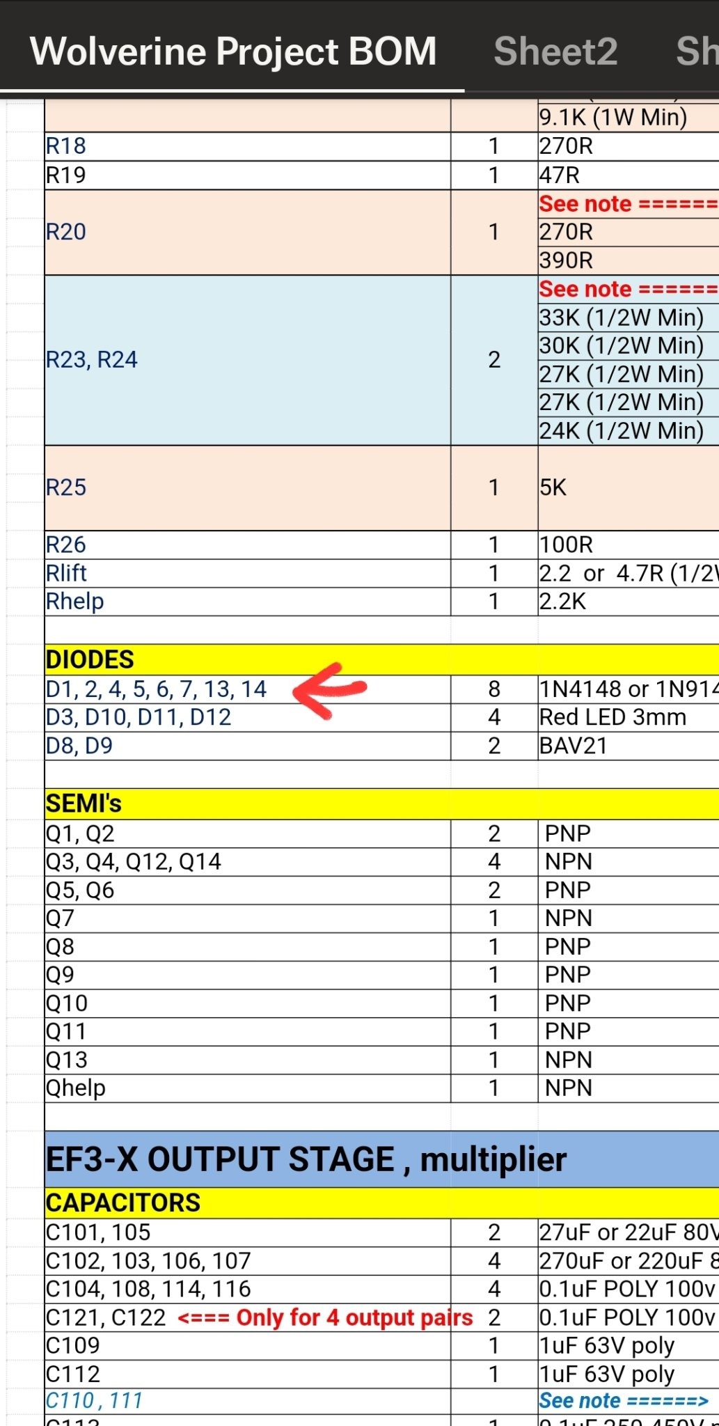

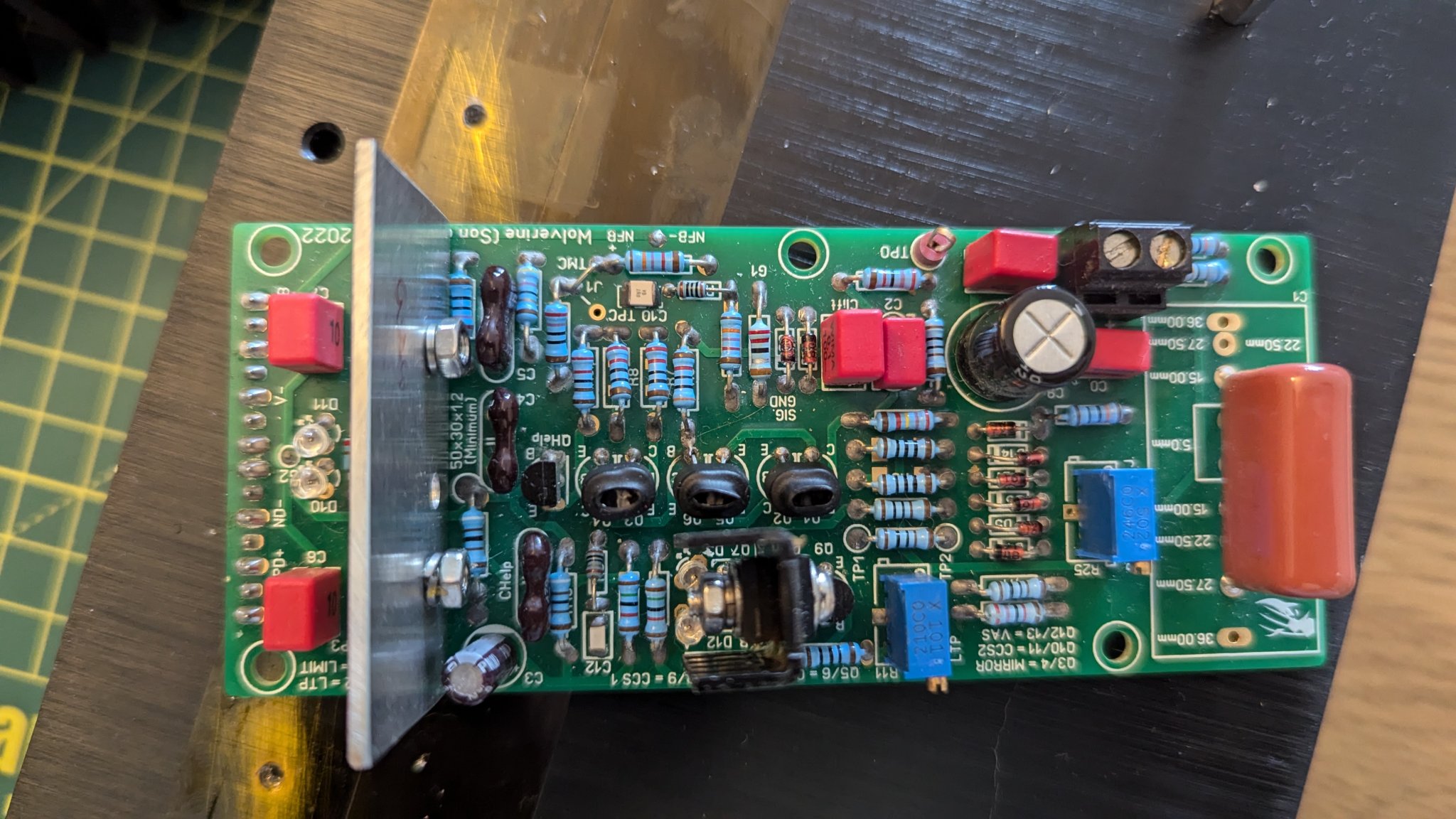

My IPS boards are version 3.8. In the notes to the BOM dated May 22, 2024 I see that diodes D13 and D14 were added. But they are not actually in
the BOM. I see where they go on the pcb. Am I correct in assuming that they are 1N4148/1N914 diodes?
I am using this BOM because it was the one closest to the release of the 3rd Group Buy boards. If I should be looking at something else that is updated please let me know.
Many thanks,,
John
I believe they are on the bom.
Is this where your looking?

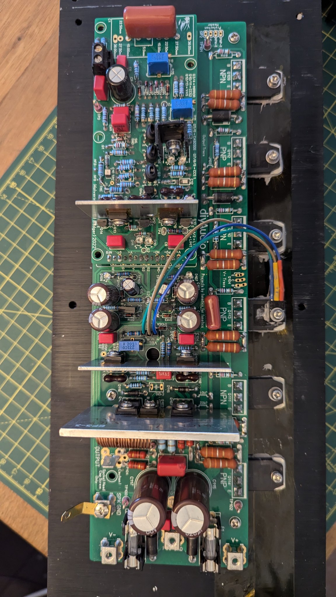

Ok so I put everything back on heatsink.
Checked output resistance of negative rail:
The fuse was blown.
After replacing it all values above required 10k ohm.
Edit: when I was working on dac I swapped signal and ground output wires by accident, could it be the cause which tipped a somewhat malfunctioning channel over the edge?
