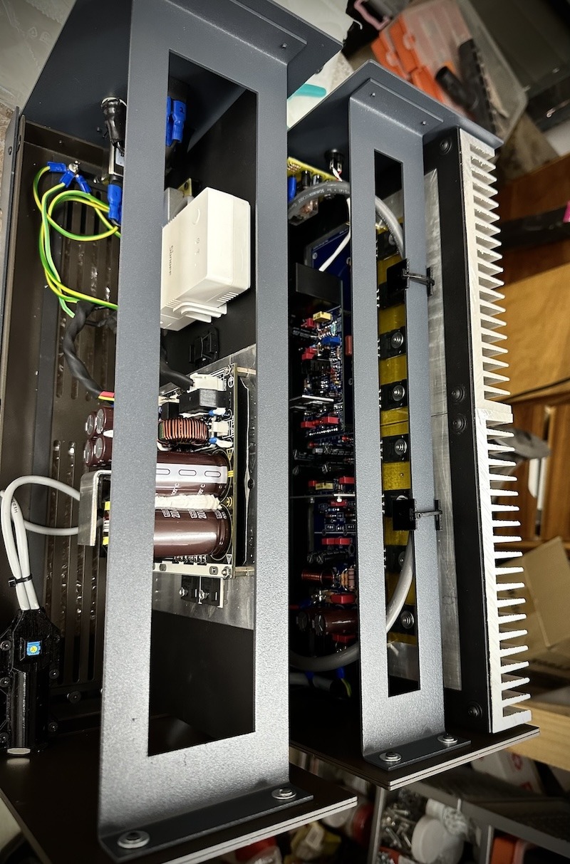

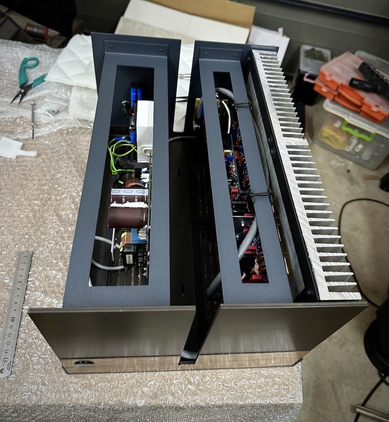

I completed my Wolverines this weekend. I am pretty happy with how they turned out. Over the years, I've incorporated a lot of my design learnings into the amp chassis. The initial design started in January. A lot of time was spent on waiting for parts from suppliers local and around the globe, but I intentionally took my time on this one.
There are two monoblocks. Power is from MicroAudio SMPSs; it's my first SMPS build. Each Monoblock also has an off-the-shelf smart controller rated at 4000W that controls remote power on/off and high/low voltage and current shut-off. This is tied to my home automation, so my audio setup can be started and shut off in a specific sequence.

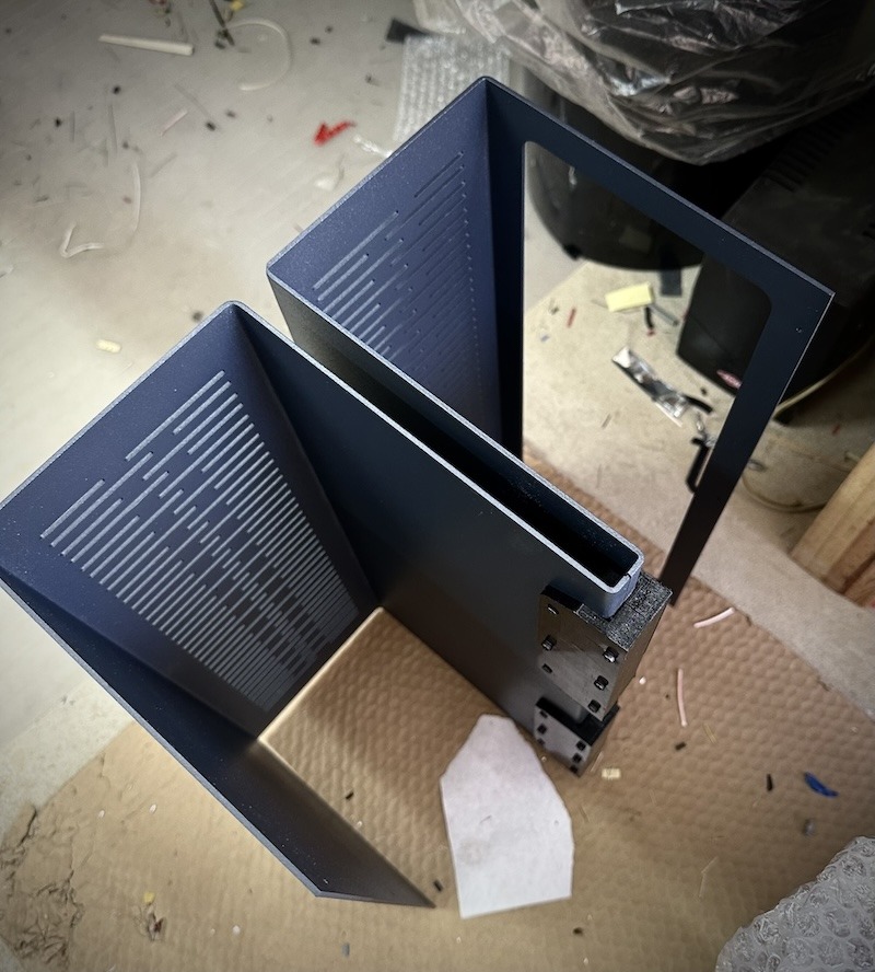

The chassis is made of 2mm steel and weighs a ton. Considering the look I was going for, I had to go with this.
The enclosure separates the power supply and amplifier sections. It is made of 6mm of steel and has a considerable air gap. The power supply and associated wiring are almost completely confined to one side, and the ventilation on both sides is exceptional.

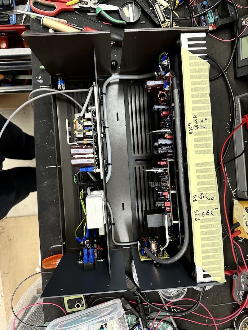

This was during testing and initial wiring clean-up. The vertical mounting offers excellent airflow. The heating and PSU are mounted on individual brackets. The PSU has enough space to accommodate a toroid, but I have to say that these MicroAudio SMPSs are sounding great.
I designed the enclosure for access, so at any point, it is pretty "easy" (a bit backbreaking with 2mm steel!) to take out an individual bracket to work on.
I've installed some horizontal supports. These assist with the rigidity of the enclosure and, on the amplifier side, are supposed to create airflow channels.
The lid was a design challenge; metal bending has limitations, so I had to design it in two parts. I also had to create a special clamping system to keep the spacing between the two parts equidistant so that they don't scrape the chassis when you put them on.

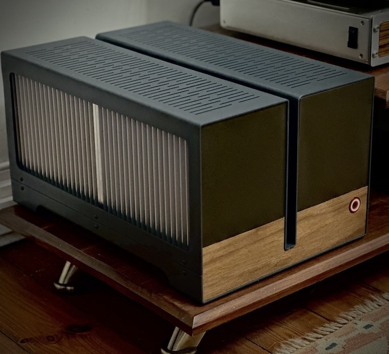

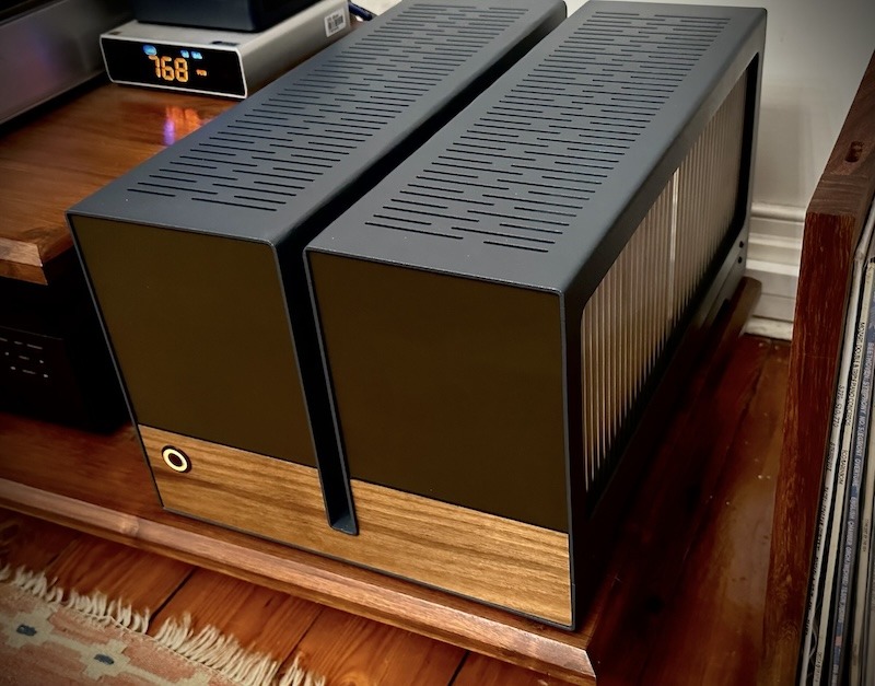

These are the final amps in place.
Monoblock A
Monoblock B
Sound is subjective, but I have to say that these are pretty incredible.
