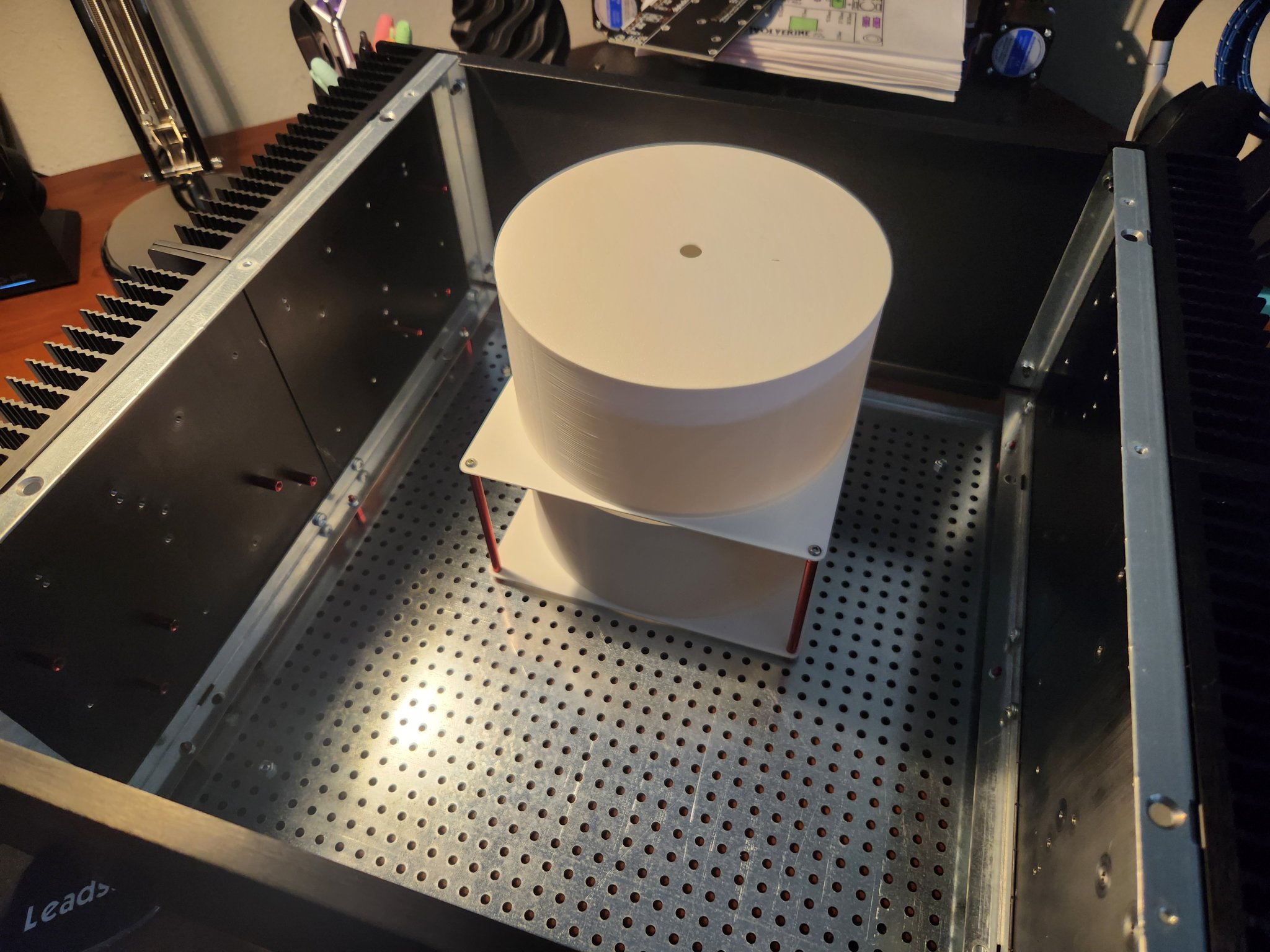

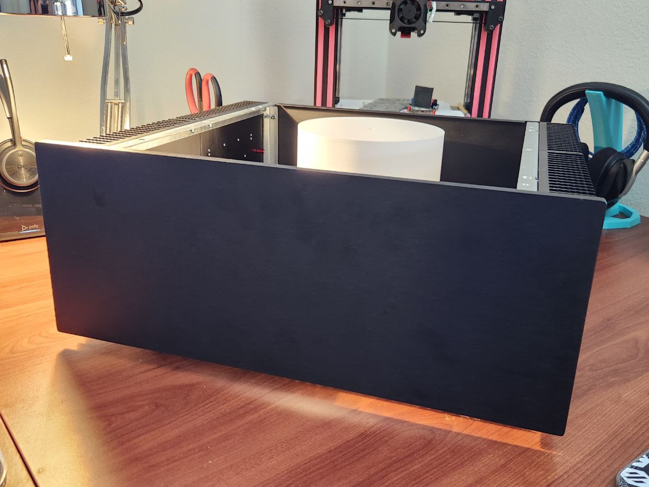

Out of morbid curiosity and the inability to leave well enough alone, I have managed to (sort of) stuff two Toroidy TTSAS0600's stacked in a 4U chassis. It's a little janky but I do have another pair of boards I'll eventually buy a 5U for and these will likely move to that and I'll buy smaller ones for this one. Any safety reason why I shouldn't do this? Is 5mm clearance beneath each transformer enough for wiring? I checked and I have enough clearance from the top of the chassis in case I need a little more room for wires. Should I just purchase two standard Audio Grade ones instead? Looking for some feedback.
Thanks, I knew I couldn't be the first to try it. I'll take a look through the thread for it now.
It may look cool with toroids mounted on top. Like in tube amps. Especially with stainless steel shine.
Plus less possibility for hum. The top cover likely needs reinforcement.
I thought about doing that, if I could sit them flush with the lid with two holes cut out I think that would look pretty cool.
