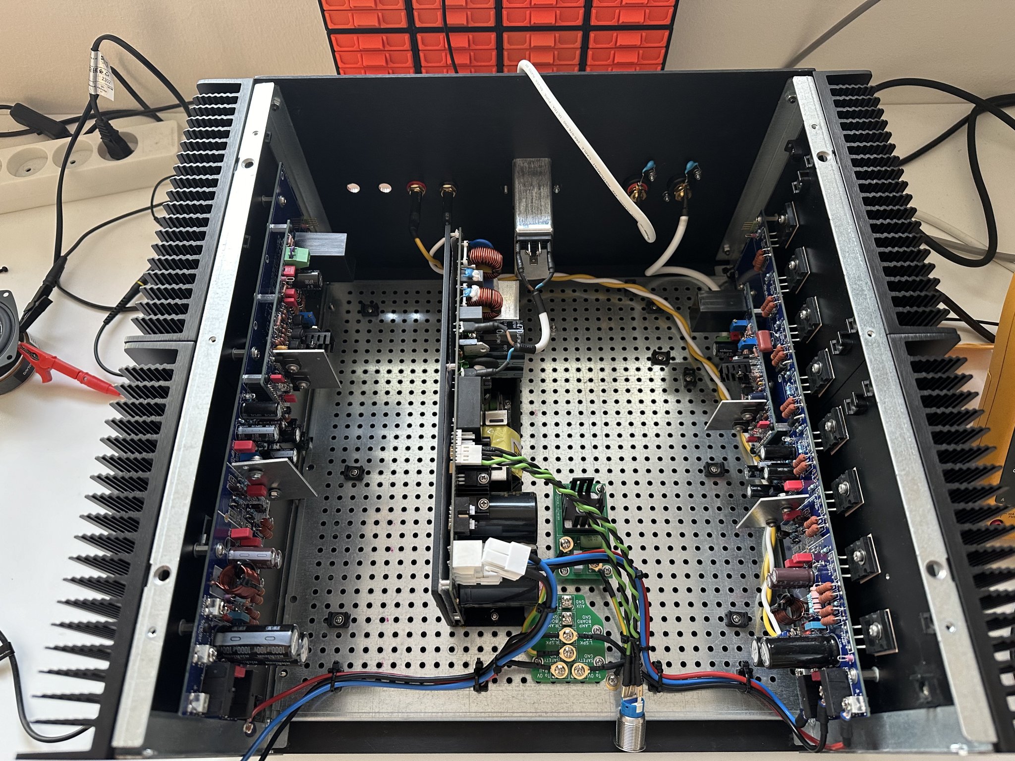

After fixing my burnt Zobel network, i assembled one channel again today.
After slowly adjusting bias and offset i decided to connect my scope, DAC and test speaker.
Unfortunately the channel is quite noisy. What i believe to be 50Hz noise is very audible from the speaker 🙁
I have a feeling that it might be due to bad wiring. Could one of you guys in here maybe confirm if my wiring scheme is bad?
Thanks a lot!
Thanks a lot!

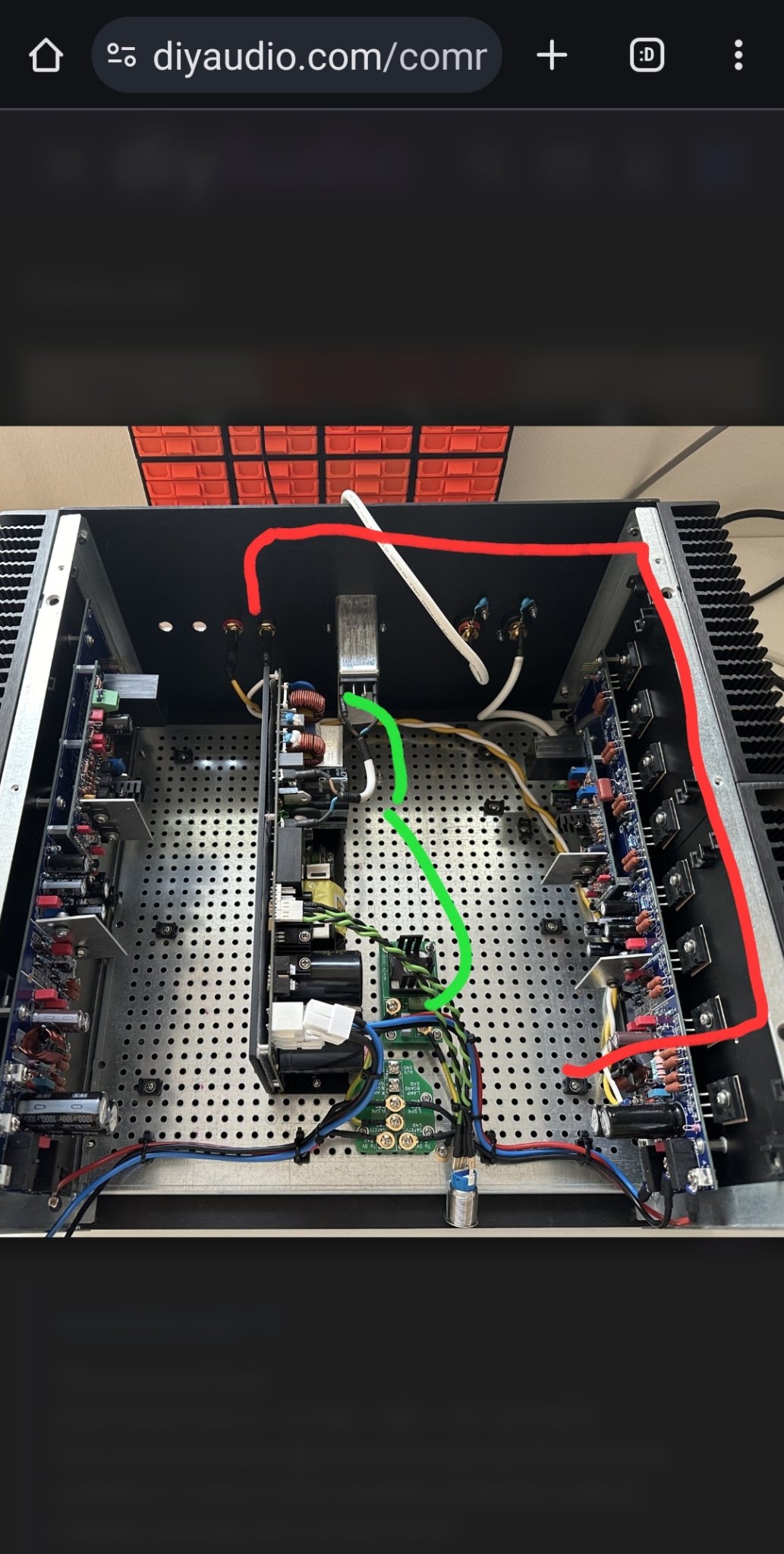

1. Watch Daniel's wiring video.I have a feeling that it might be due to bad wiring. Could one of you guys in here maybe confirm if my wiring scheme is bad?
2. You don't have the safety ground from your input module connected to the chassis. It should be right near the input module.
3. Turn the ground lift around and connect the safety ground terminal to the same point on your chassis from above.
4. Run your output wires on the other side of your board, not next to the sensitive negative feedback path.
Good luck 👍
Thanks a lot Stuart!1. Watch Daniel's wiring video.
Good luck 👍
Will try your suggestions tomorrow.
It amazes me how important good wiring actually is 🙂
