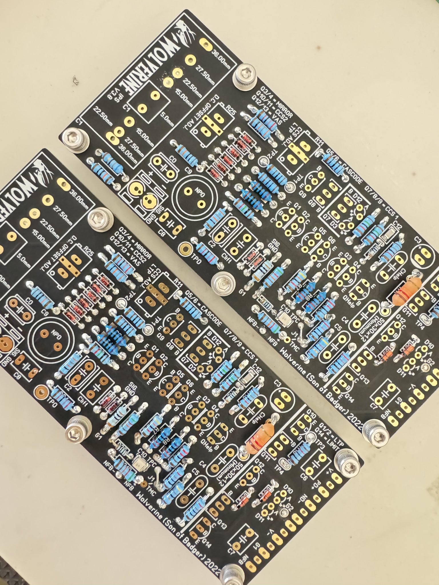

Got started on the IPS boards yesterday. The latest build guide is great. 🙂 Slow and steady…

^nice, clean.

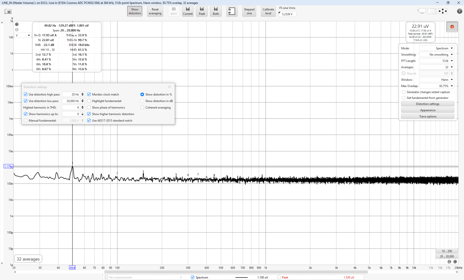

Thanks Daniel, and after aligning measurement setups, I got noise at similar levels +0/-5uV to your videos, so I know I'm objectively in on the same playing field.
It would appear to me, at least with these excellent Toroidy traffos, there is little noise penalty to having both boards with transistors facing up. In my amp the board with the IPS closest to the transformer shows about 5-7uV more noise at 50hz than the other, while the board with the IPS closer to the caps seems to have more rectifier 100/150hz switching noise and harmonics. But this is really looking down into the weeds. This could also be the lengths of the DC power cables being longer resulting in slightly more inductance between the power res caps and the rail caps - ref. Bob Cordell's Burning amp speech.
