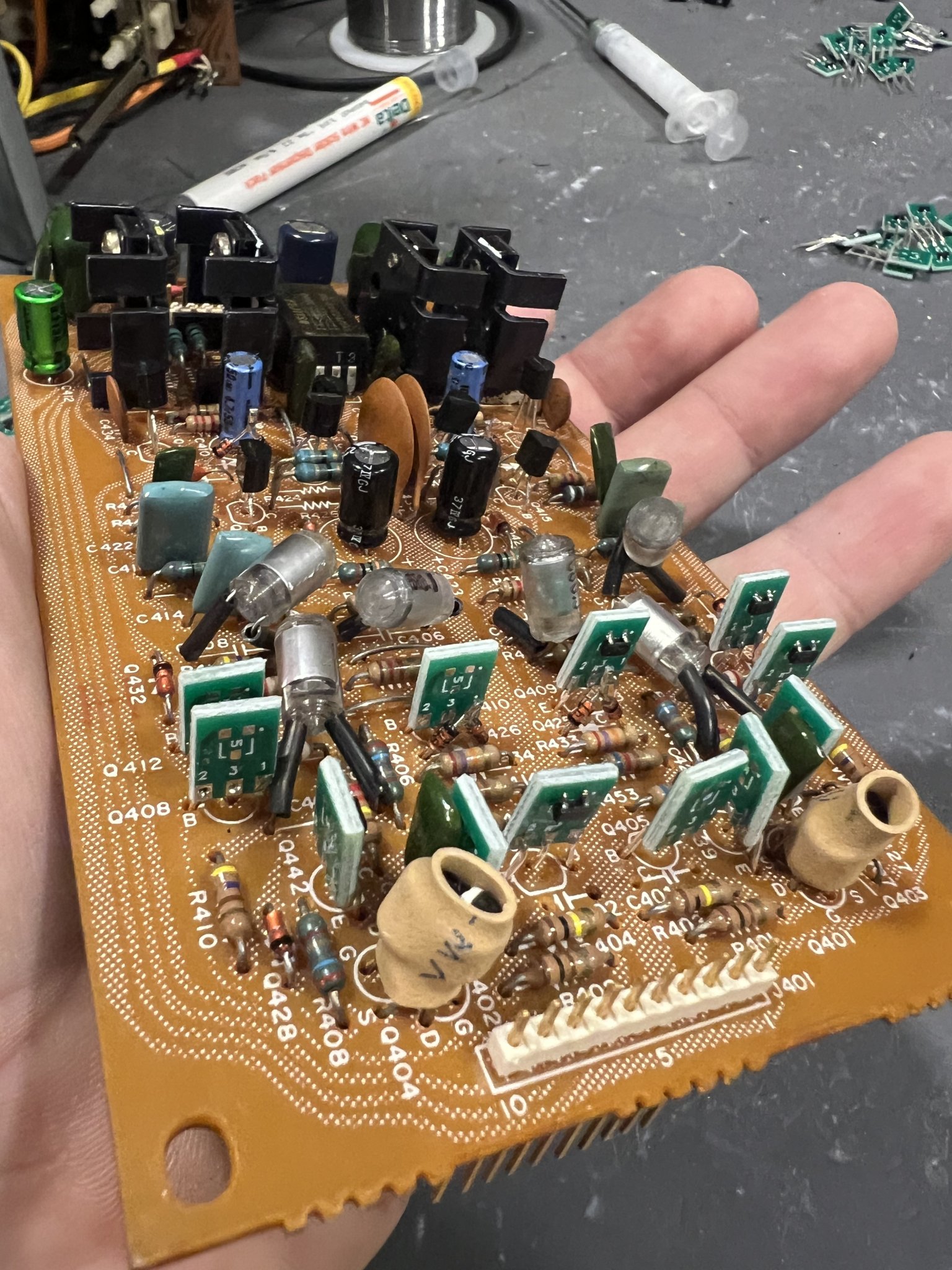

Hi Dan,
That reminds me of a Marantz 3650 phono PCB.
Any reason you replaced all the transistors?
Hi Dan,
Lol, well wouldn’t you know it, it is a 3650 phono board. Nice guess lol.
A friend of mine picked up this preamp about a week ago and he was told that a tech did some restoration work on it, so he wanted me to look through it for him. The work done was questionable, and the quality of components was not great so I just went through and did a restoration for him. But for some reason, they decided to remove every 2SC2240BL and 2SA970BL and replaced them with KSC1815 and KSA1015. Going from a low noise high gain transistor to a low gain. Not sure what they were thinking. Honestly, I should’ve just put in some KSC1845s and KSA992s, but I wanted to use something a little closer to the originals so I put in 2SC2713BL and 2SA1163BL. Though I was kind of sad to see that these parts don’t have all that high of gain, at least not as high as I had thought they would be. The 2713BL were averaging 450, some hitting 500. The KSC1845 I have measure 400-450. Going SMD I should have used FJV1845, I have E grade and get 500-600 from them. Oh well. I also have some 2SC3324BL (really wish I would have grabbed its complement), but they measured about the same as the 2SC2713BL, mostly in the 450 range. I thought the 2240 was in the 600ish range.
Dan

Hi Dan,
lol!
I was trained at Marantz (Superscope), and did warranty on these. I own a 3650 and SC-9 (same phono board). It is one of the best sounding and quiet phono preamps I have heard. I did a lot of study on these because we had some burning out. I was told about changing grounds and HF instability by the USA service department. I followed their directions and of course they were barking up the wrong tree entirely.
Clue, the SC-9 (later) is identical, but has vents in the shield for the phono. I traced the issue back to loss of output bias, the temperature sensing diodes (varistors) are located on the PCB away from the heat sinks. I use thermal epoxy and attached them to the heat sinks, problem solved. You could just position them through the fins, but movement may cause them to short.
The transistors used were among the lowest noise at the time, with consistent characteristics in production quantities. They were my favorite parts to use. Often you'll see certain part numbers singled out as "the best". But this is a Japanese design using very high quality Japanese parts known for consistency. The other critical part is, availability for production at that point in time. Also, if an engineer is comfortable with certain parts, they will use them.
Low noise. This is far more important in the first amplification stage, not so much in following stages. So could you install a "better part". Yup, but will it buy you anything at all? Probably not, certainly nothing that matters. Also consider surface noise off the LP or 45. This far outweighs what most normal phono stages have for basic noise level. This phono stage is far better than what is needed. It also has wonderful overload ability (supplies are over +/- 27 VDC). It has very low output impedance and cann drive almost anything. Remember, the tape output jacks are directly connected to the sources, also a phono preamp in almost every preamp out there. Carver buffered some.
My personal take? Install the original parts unless they were overheated. Matching complimentary beta helps distortion figures some. Look at power supply noise, it can be improved these days with minor changes. We are splitting hairs now, the design as manufactured performs extremely well. So do the following stages. Please don't mess with it.
The one biggest problem with these preamps (and the 2385, 2500, 2600) are intermittent switches. I hate them! These particular switches may not respond well to cleaning, try not to clean the slide controls.

Hey Chris, thank you for all of that info. Would be cool to be old enough to have worked on these gear back when it was being released. The entire post was regarding the 3650 correct?
You say don’t mess with it, you do know that I wasn’t messing with it correct? Someone that had their hands on it before me took out the 2240BL and 970BLs, which I agree with you were definitely some of the best available, and swapped them with low gain KSC1815 and KSA1015. So I was trying to revert it back to factory, but unfortunately I don’t have any 2SC2240 or 2SA970. So I went with something as similar as I could find, which is the surface mount version of those transistors. I wouldn’t even imagine messing with it, I know this is a very nice preamp.
And yes, these are some of the worst switches I’ve ever experienced in my life. I was tracing a channel throughout the preamp, trying to figure out where the heck I was losing it, I would get it back and then it would disappear, the entire time it was a switch.

Hi Dan,
Yes, I was talking about this phono PCB and the 3650/SC-9. We are OT for this thread though. I can answer any further questions via PM.
No, I got that you didn't mess it up. I just would recommend you install the original transistors if they are available. If not, you did fine. Don't try and buy the originals unless you know for certain the parts are old stock.
Those switches ... arrrrgh! First try using LPS Micro-X (04516), if that doesn't work, then Wurth Contact OL. It works on sulphides, they are different cleaners. Both are zero residue. Don't use anything that leaves any kind of residue when cleaning switches. For pots, the smallest amount possible in to the centre. It is the slip ring that gets noisy, not the resistive element. All cleaners attack the protective greases and lubricants, so minimal chemicals.
What were they thinking when they went with those switches??? This is just before Philips got their ugly claws on Marantz, it is possible there was influence already. Normal Marantz design and parts were far better than this.
