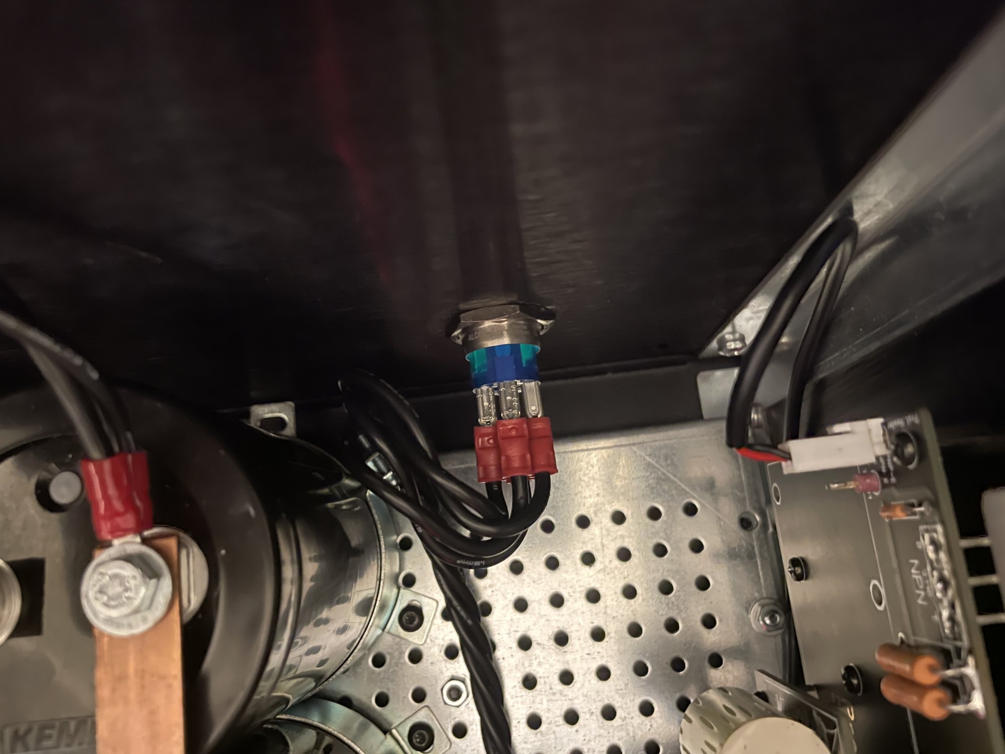

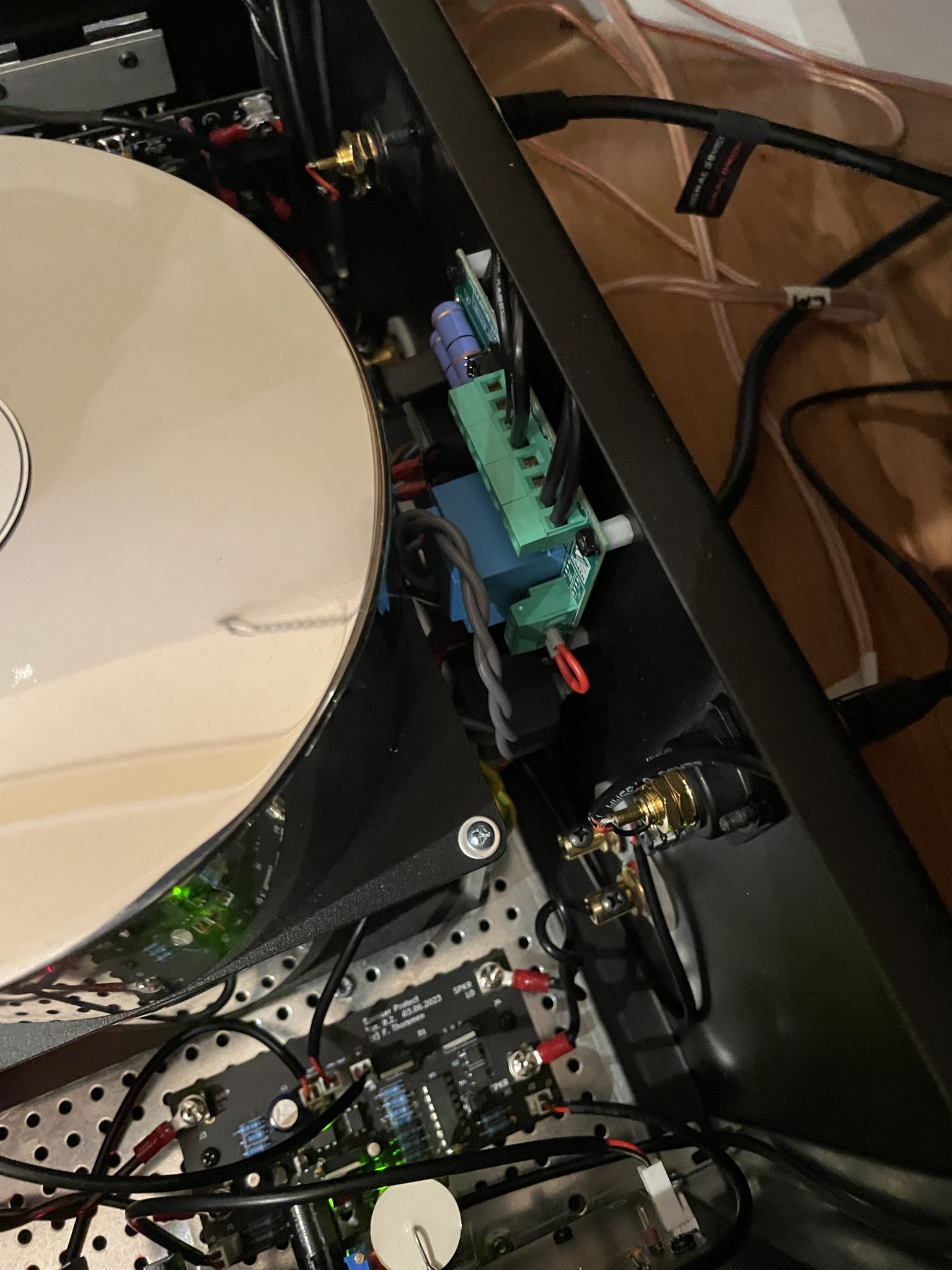

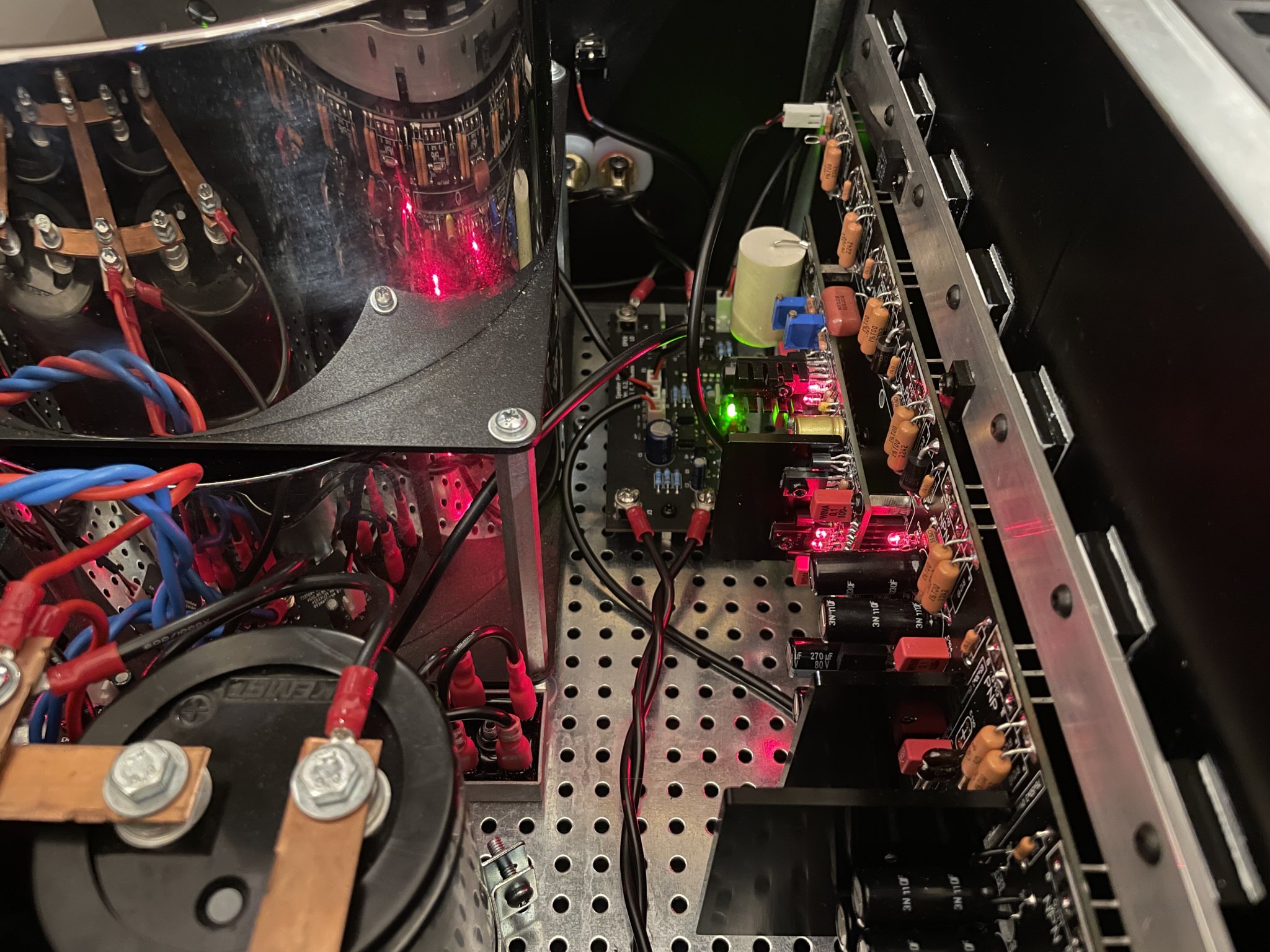

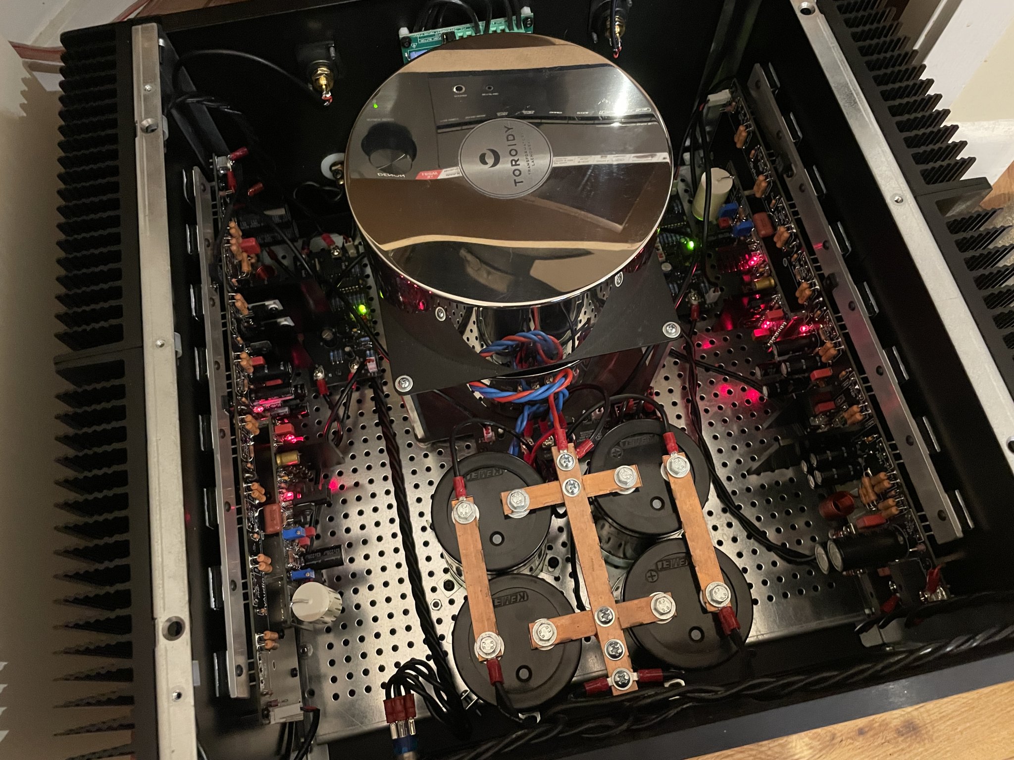

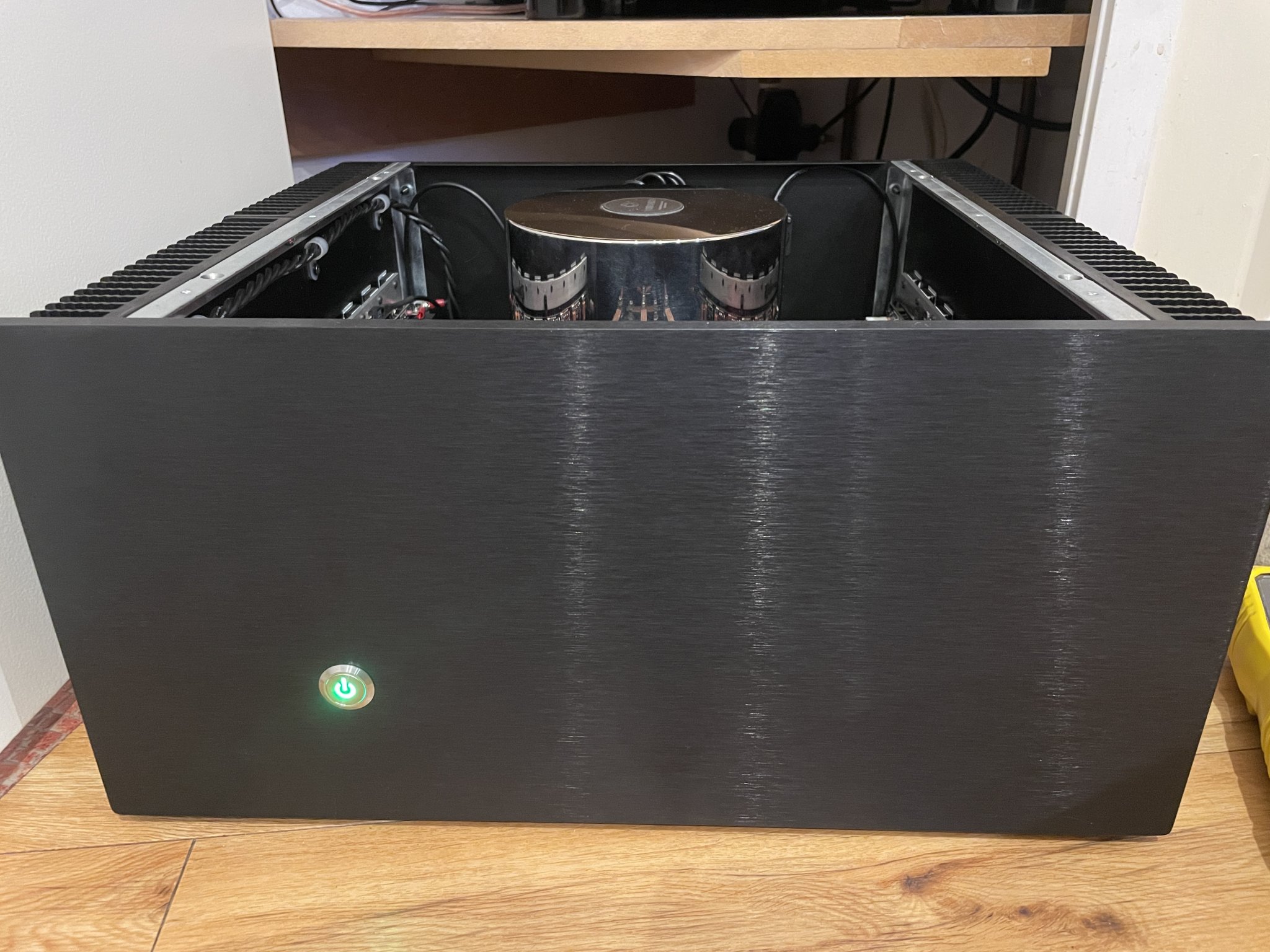

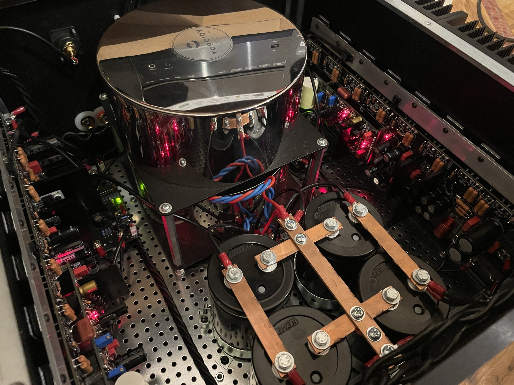

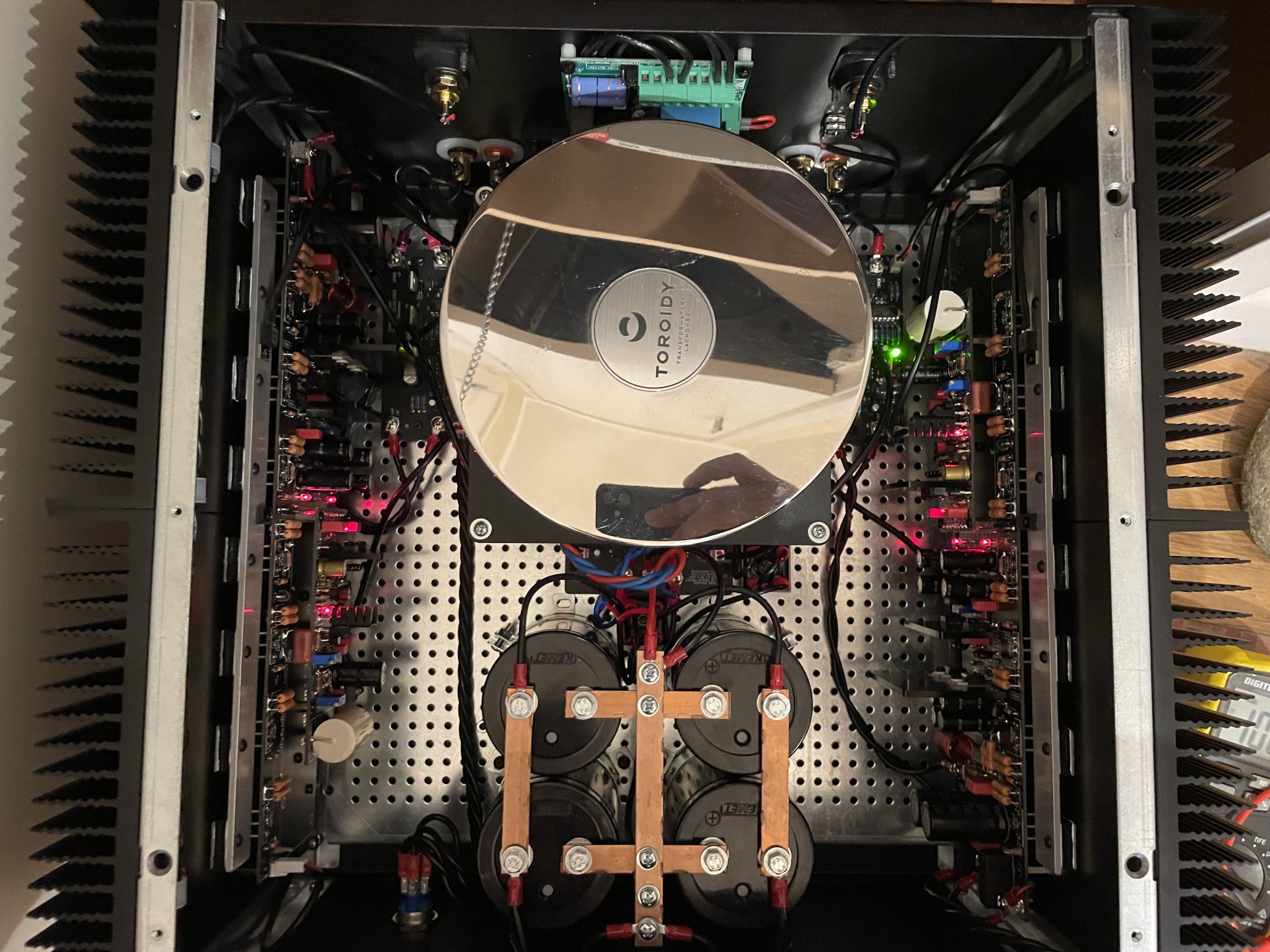

Have my 4th GB boards tested, installed, measured and singing! Including @felix1024 protection boards, which he helped me out with I was able to KiCAD an opto-AC sense PCB for standby control (as they are designed plug-n-play for the cobra SMPS, which I have also used). @fireanimal 's heatsinks are the icing on the cake too.
Using Hypex soft start, configured with a trigger input controlling a NC relay and front panel NC latching switch in series to make front panel switch and trigger input both take the soft start out of standby. Some reason the Hypex requires a NC switch to operate??? Has bidirectional LED out too so front switch is red on standby/green on. I did notice this soft start gets hot if cycled too quickly, unlike the DIYaudio softstart which seems more forgiving to this. A tiny 5W SMPS runs the speaker protects.
Again, big ups to the team.

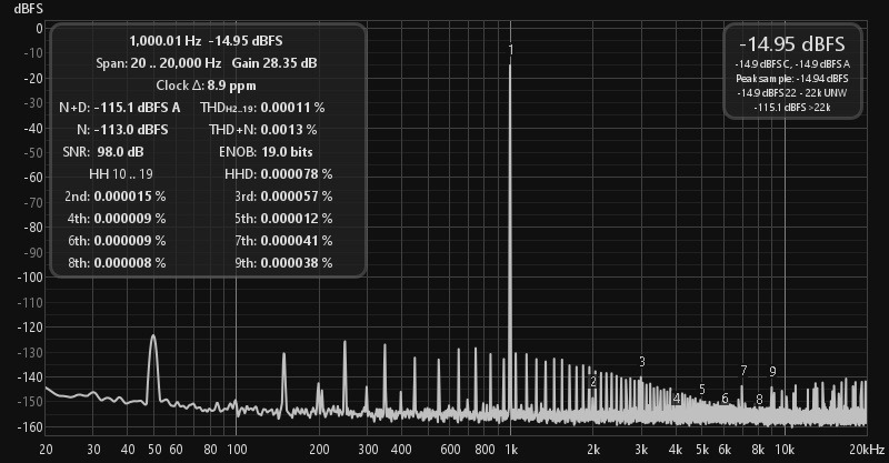

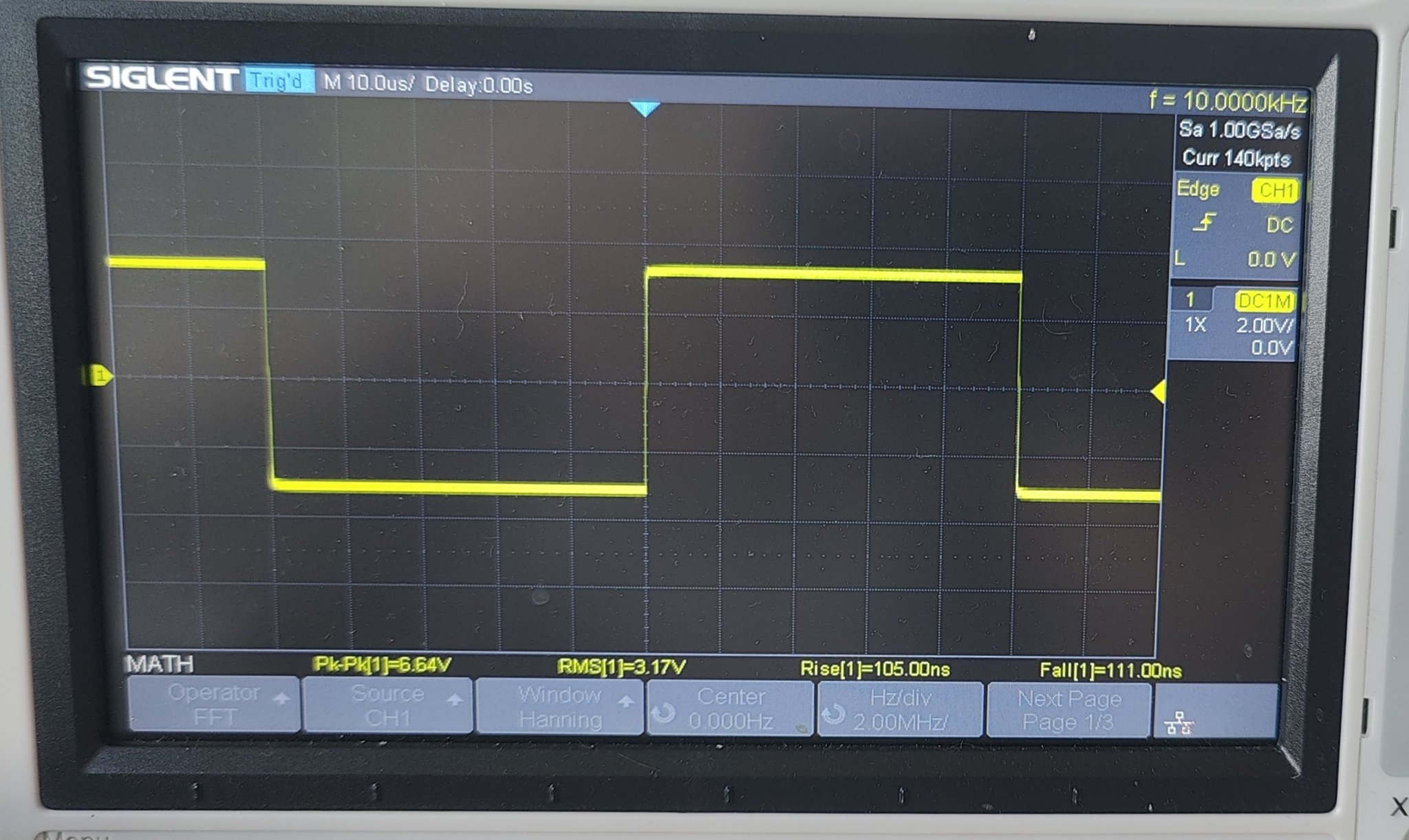

20240727_052410870_iOS.jpg20240727_052421345_iOS.jpgR ch 1k 5w8r.jpgL ch 1k 5w8r.jpg

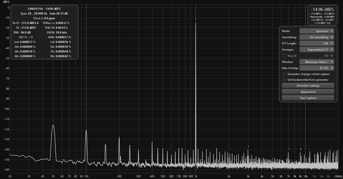

(scaling a bit cooked on the REW captures)
They were i think like 5.9ish volts just real quick to make sure nothing was misbehaving. Along with sweeps. The measurement setup is still lacking. Stuart has given me some nice tips to get noise lower (though I get no noise at speakers anyway). My layout is kind of outside the norm with tx at the back and the IPS's at alternating ends, I encourage anyone starting new to use @danieljw layout he got an excellent virtually zero noise stereo layout (see his youtube wiring vid)

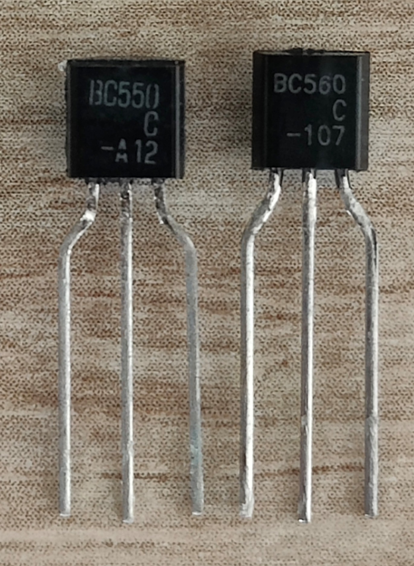

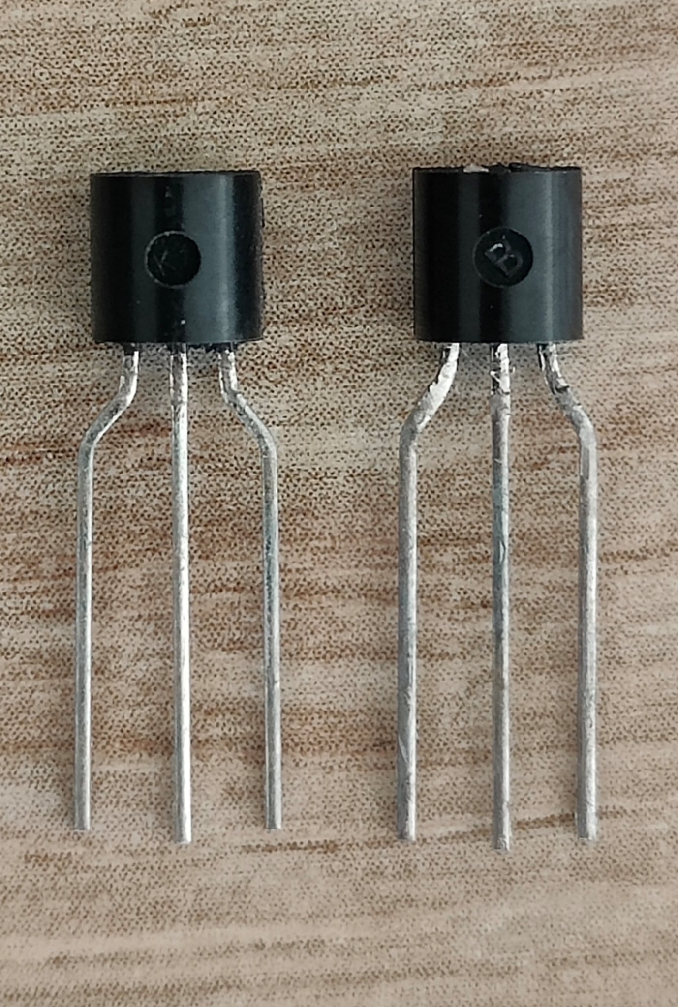

There's at lot of BC550/560 useres here, so I thought this might be the place to aske before using these i my Wolverine build later on.
To the left is an original Fairchild BC550C and to the right "should" be and original Fairchild BC560C, bought from LANGREX on eBay. There's a "B" stamped on the housing on the back of the BC560C... Hfe is around 500-600.
In circuit the BC560 performs good, and I tried swapping to Onsemi BC549C/BC559C and got identical curves from my preamp protobuild.
Can anyone here confirm if the BC560 to the right is original from the picture?

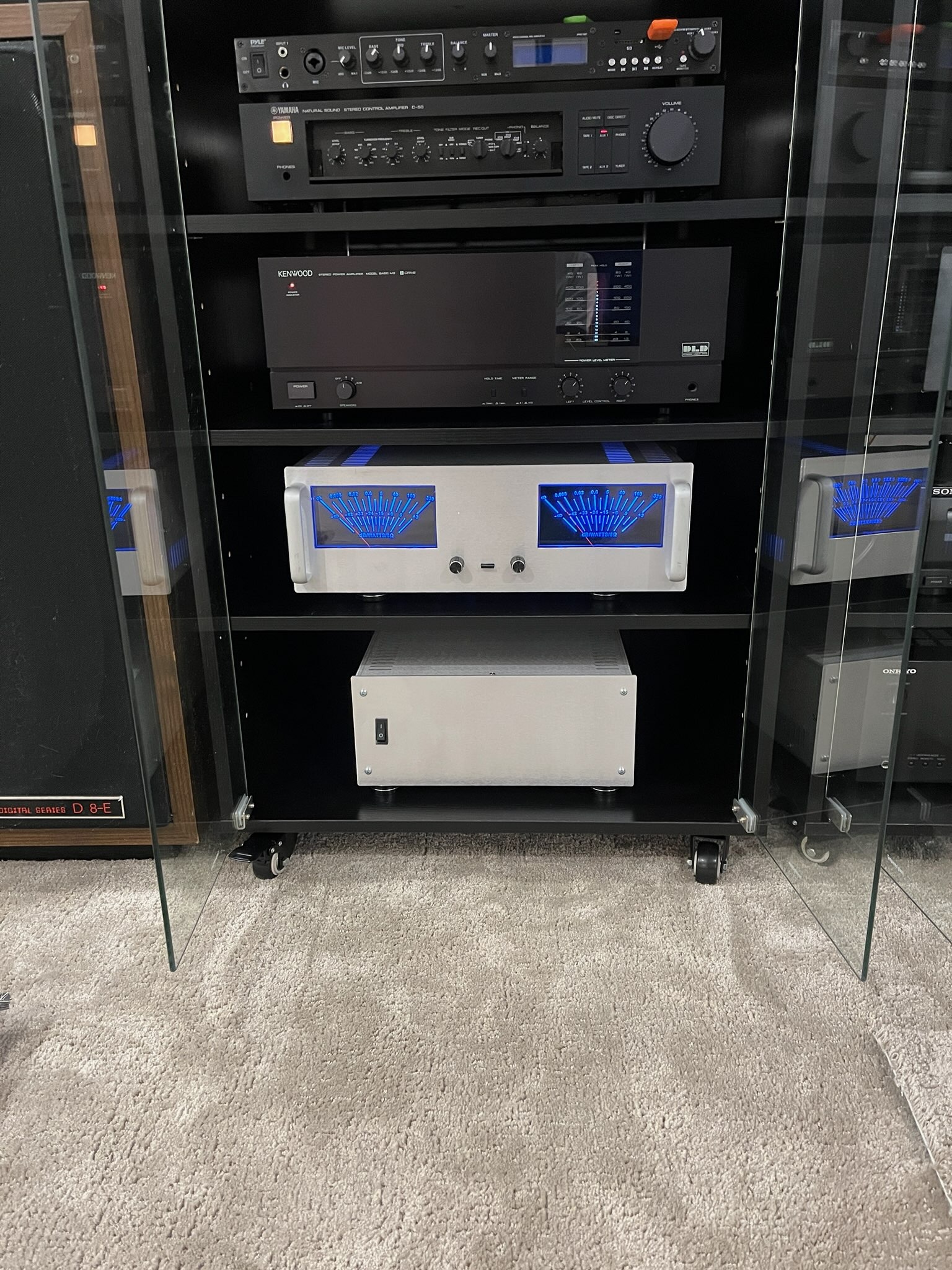

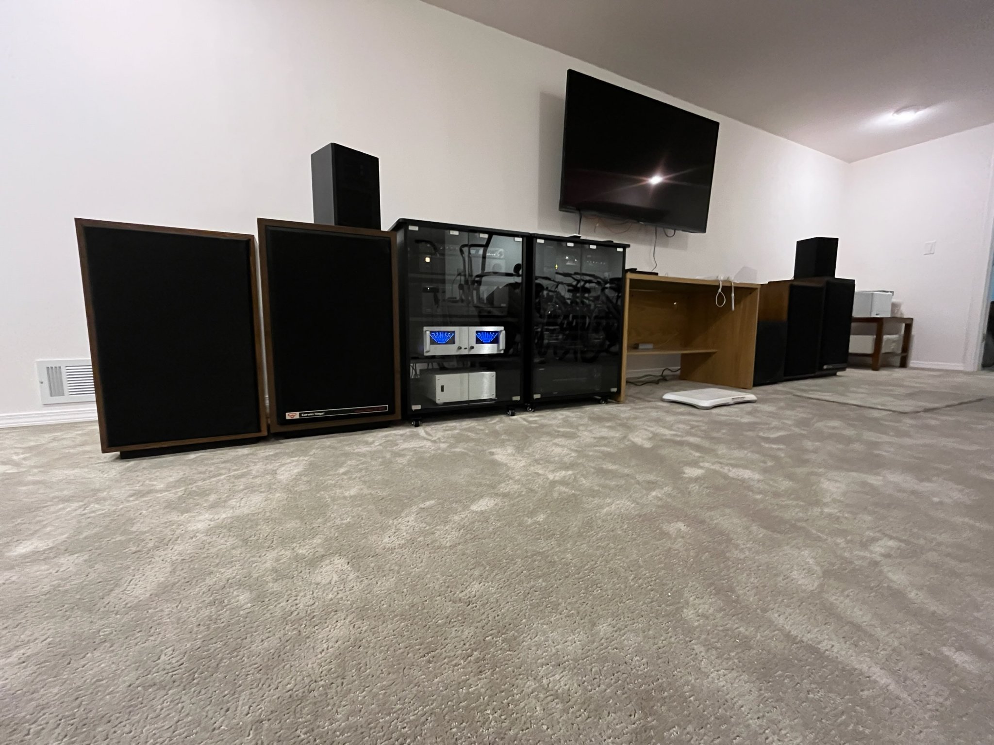

Finally listened to this amp through some Cerwin Vega D8E's... Very, very nice. Only thing I wish is I should have put it in a bigger chassis with much bigger heat sinks. As long as I keep the glass doors open it doesn't get too warm.
Thanks All.
Scott

View attachment 1338539View attachment 1338540View attachment 1338544View attachment 1338545
