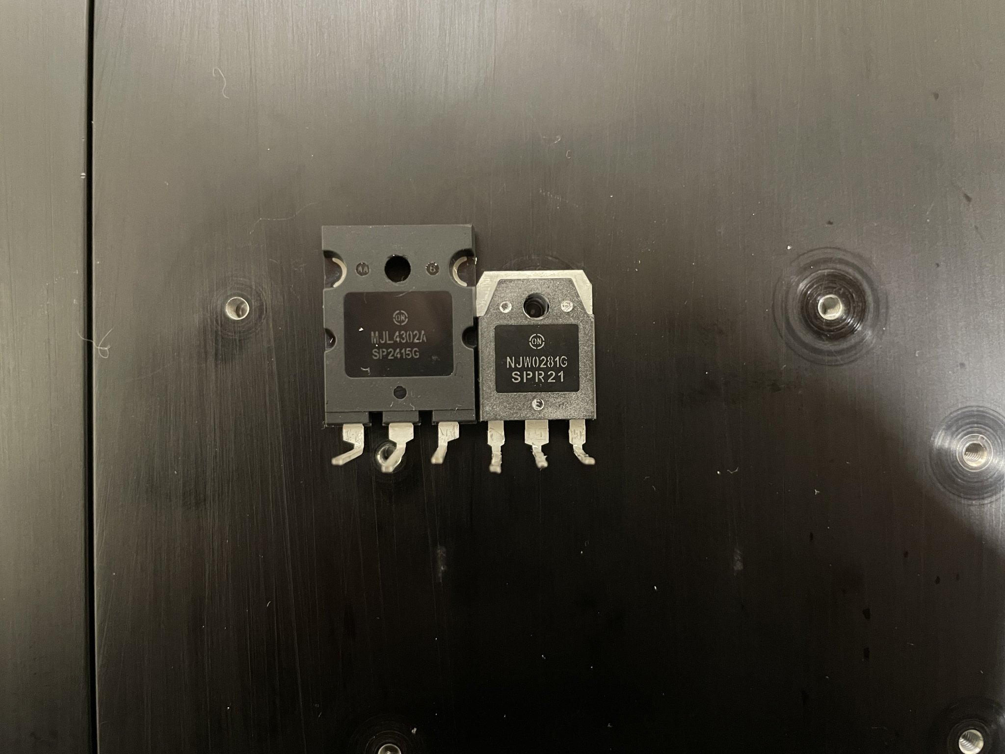

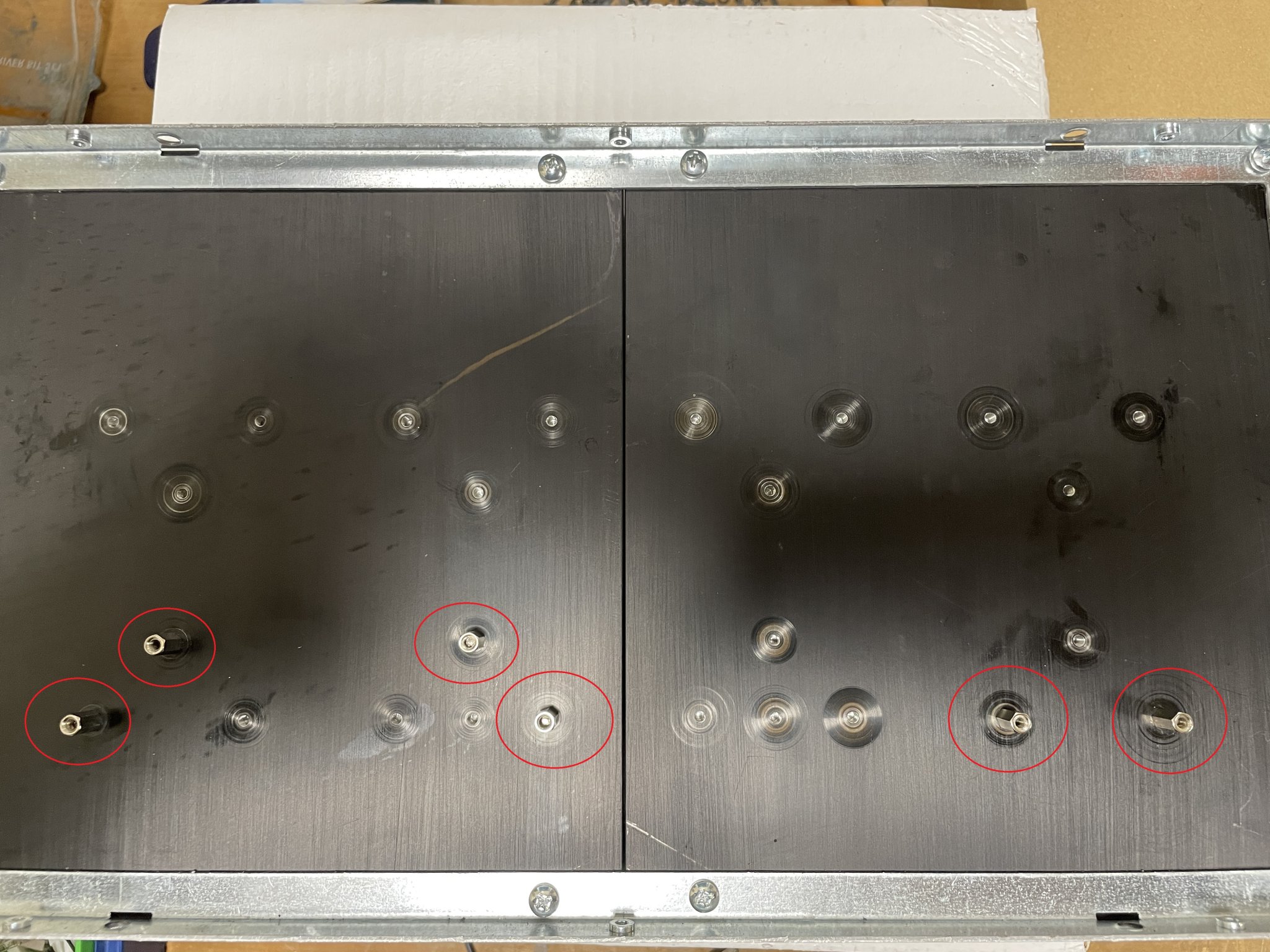

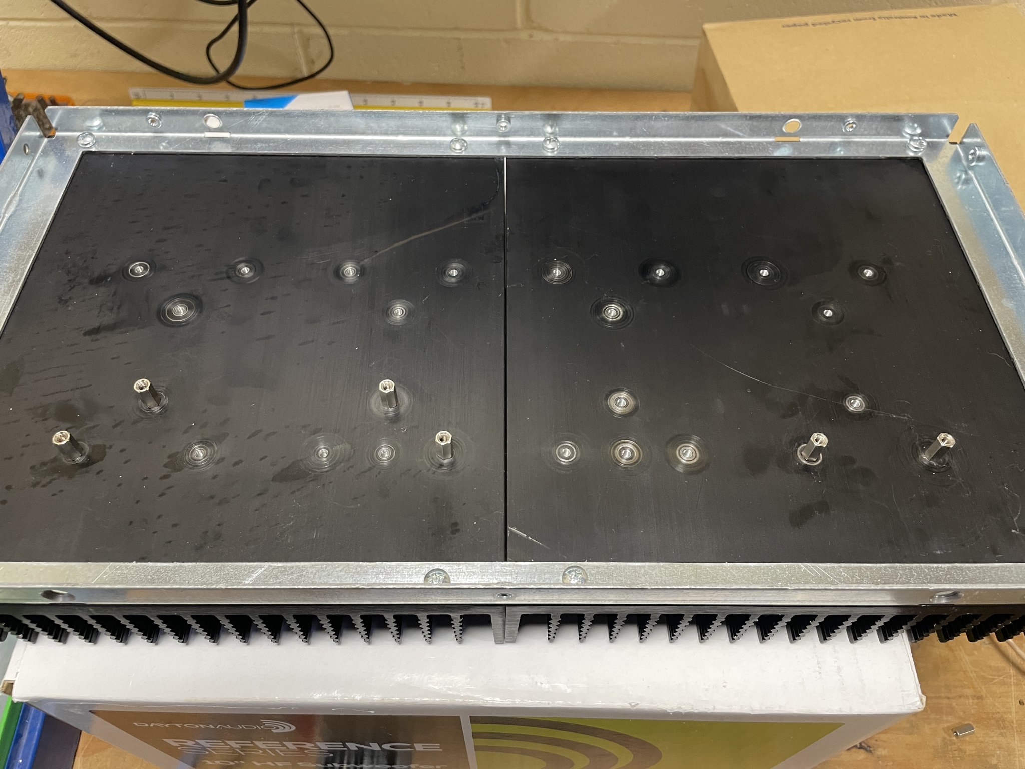

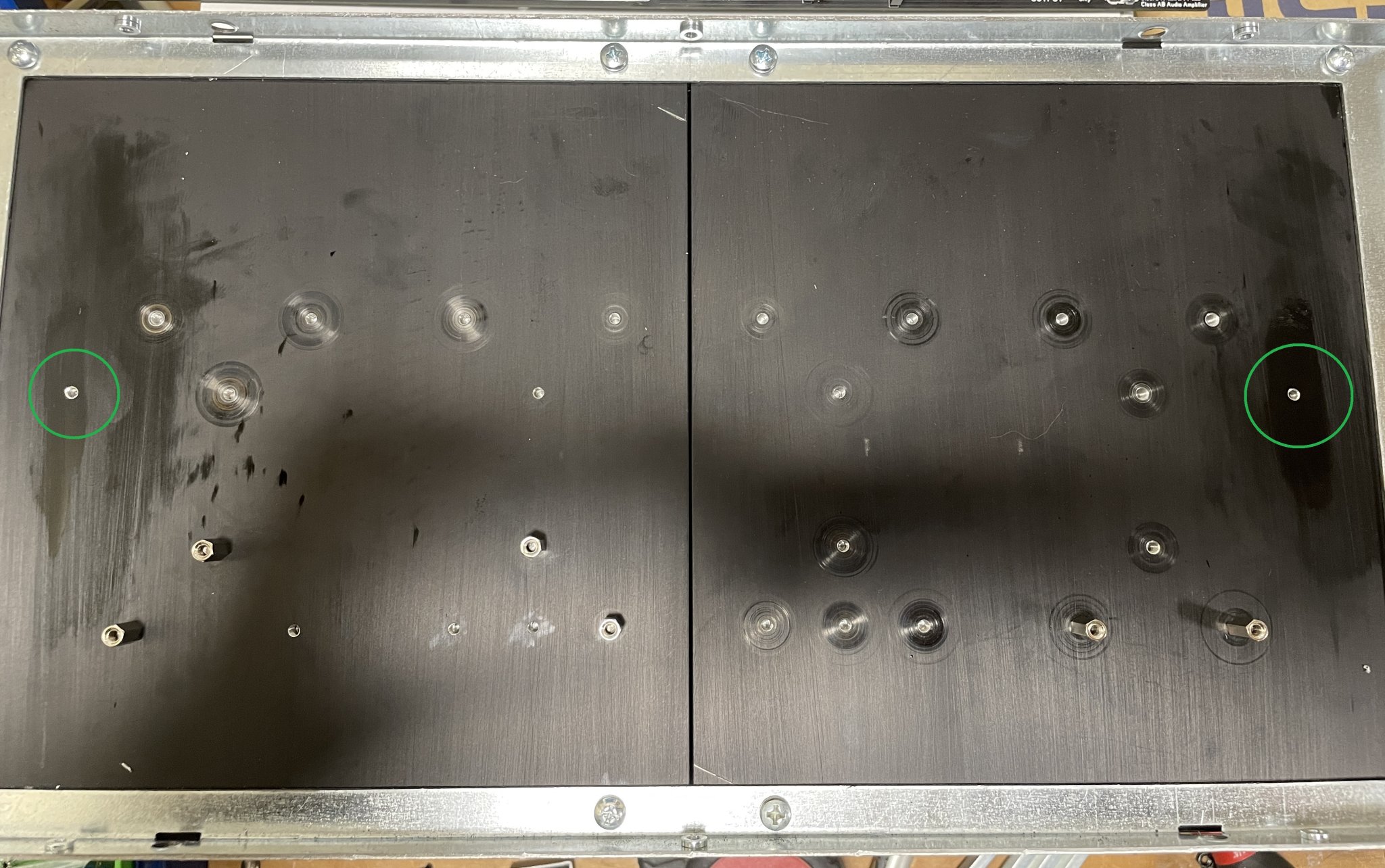

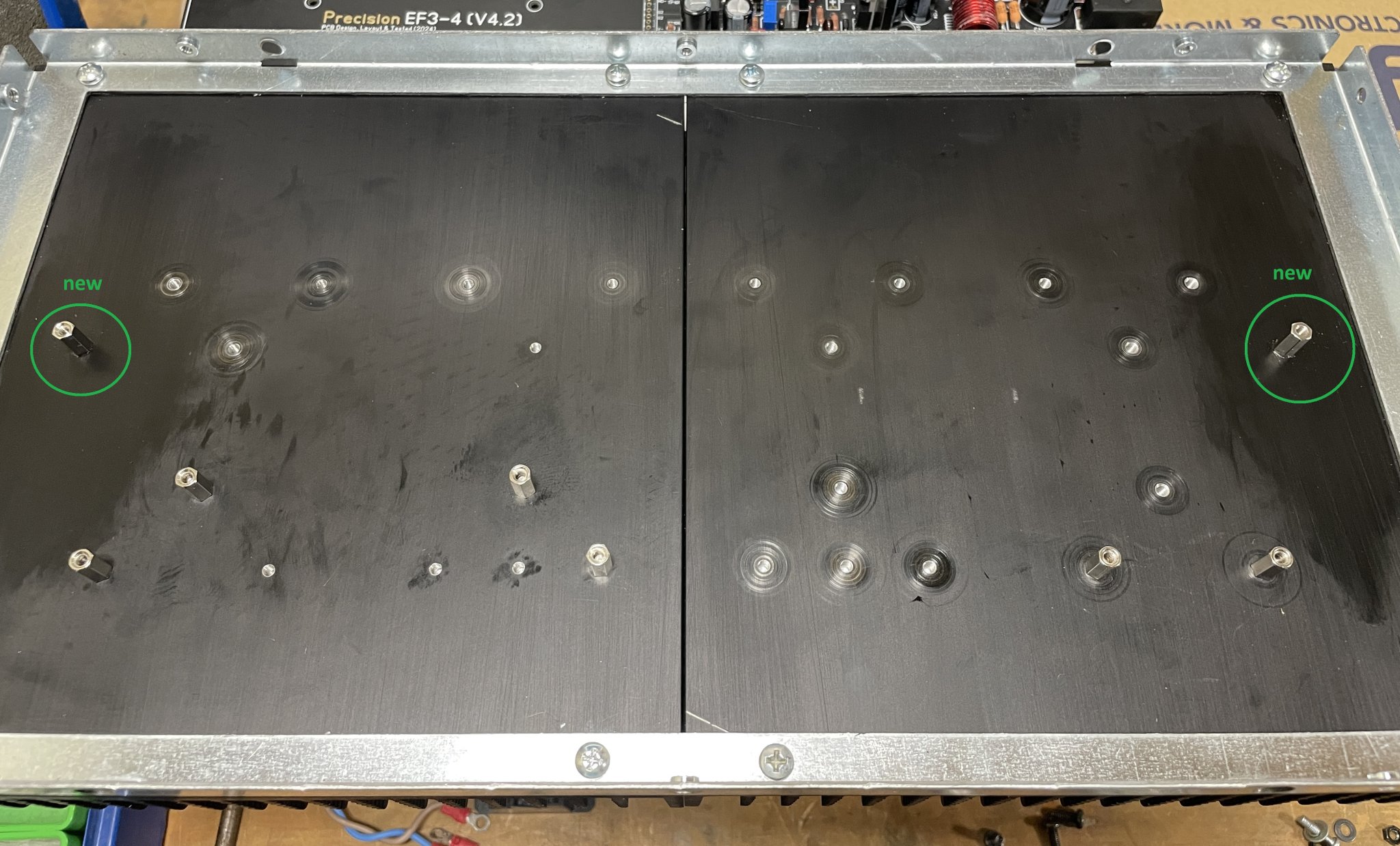

As discussed earlier here are photos showing (for a standard DIY audio deluxe 5u chassis):
1, 2 the UMS holes that an EF3-4 uses
3,4 the 2 extra holes that must be drilled and tapped for the EF3-4 outer edges
5,6 A comparison of a TO3P vs a TO264 package (with the EF3-4 board fully fixed into the above mounting points) showing the TO3P's line up with the UMS holes but the TO264 transistors sit 5mm higher and require a whole new row of 8 holes 5mm above the existing.

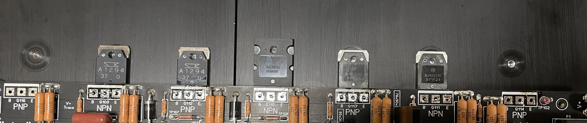

First, I want to thank all the Wolverine Forum members who have answered my questions to date. I do appreciate it.

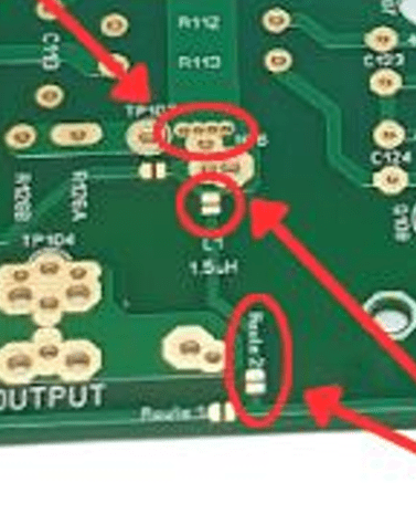

Now I have more questions. I am confused by the bottom photo on page 33 of the Wolverine Build Guide. I have the pcb's that are part of the third group buy, EF3-4 (v.4.0). There are three large holes in the pcb labeled Q107, Q103 and Q108. So it appears that there are at least two ways to mount those transistors.......1) on a fabricated heat sink that has a minimum thickness of 2.5mm or 2) on the main heatsink. The Guide says to mount Q103 on the main heat sink if you are mounting the pcb parallel to the main heat sink (which I am). What about Q107 and Q108? Do you have the option to mount them under the pcb like Q103, or is the preferred option to mount those two resistors on the fabricated heat sink (which is no problem for me as I have sourced 3mm aluminum for this)?
Second question: I am confused about the NFB route. The Guide says that for second group buy pcb's and presumably for those that came after Route 2 is the preferred option. To select Route 2 do you simply bridge the solder pads labeled Route 2 and then also bridge the pads above the marking L1 1.5 UH? What about the pads under TP103? Exactly what do you need to do to complete Route 2?
Also, what is the (relatively) heavy wire shown in that bottom photo on Page 33 of the Guide that connects NFB to some other point that is outside the range of the photo? I think I saw this wire in Daniel's video of the Wolverine build on YouTube too. Where does the other end of that wire connect? I don't think it's mentioned in the Build Guide. Is it an option? If so, what effect does it have on the amplifier?

1. preferred mounting of Q107 and Q108 is on the main heatsink with q103 between them. this requires drilling and tapping 3 more heatsink holes which I haven't pictured above. Daniel has some great youtube videos on this https://www.youtube.com/@danw1million
specifically, this video shows the holes and mounting
- in that same video the Q103 and Q104 transistors are installed with an outdated method which has since been updated in the build guide
2. only solder bridge these 2, as you suggested leave the others unsoldered (don't make a NFB trace ring path)
3. That was a NFB path mod that is optional see here, should be ignored, the gain is only really applicable to 1st GB boards.
https://www.diyaudio.com/community/...he-wolverine-build-thread.385920/post-7361066

Many thanks for answering my questions. The photographs are especially illuminating. I did watch Daniel's entire series of videos several times. I started noticing differences between the video presentations and the Build Guide. Those videos are now 2 years old. So there have been some changes. Thanks again for the explanations and clarification.
John
