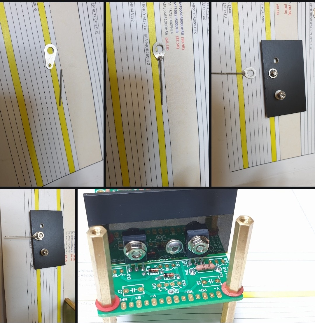

Just so I'm clear: wrap a thin wire around a bolt from the CCS heat sink to G2 and solder to the board?
Take a look at my build album for a possible method as well

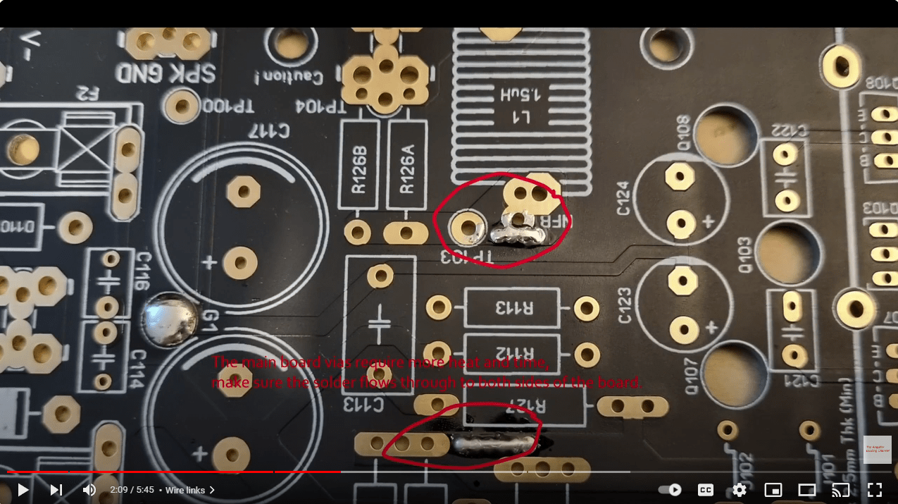

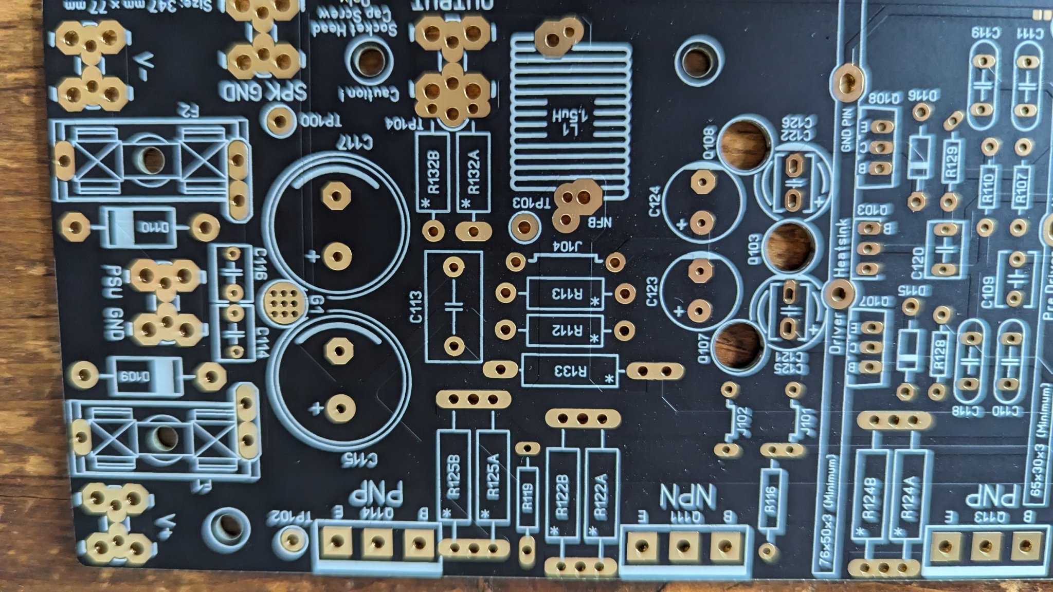

Hi, I have a question. I have the 4th GB EF3-4 boards. I have been studying @danieljw's excellent videos and @stuartmp's build guide. My board differs from the main boards shown there. They all have 3 vias to solder. I can only locate G1 via. The two missing ones are in the enclosed screenshot. It looks to me as if the via next to output coil L1 is replaced with a jumper, J104 (see photo). The via next to R127 seems to be missing altogether. I would be grateful for any help/clarification!

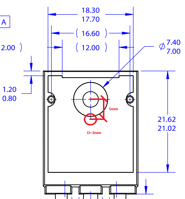

I'm working on my Mouser order for Wolverine parts. The output transistors I selected are the Onsemi 2SC5200OTU and 2SA1943OTU. I need outputs capable of handling approximately 71 Volt rails. I'm also using a standard diyaudio 5U chassis. I noticed that these transistors will require drilling the heat sinks. I have a drill press and M3 drill and tap....so no problem. But I just want to know what I am getting into here. It's a standard TO-264 package. Will none of the 8 transistors on the EF3-4 pcb line up with the UMS holes in the heatsink? Or am I misunderstanding something?

None of the 8 TO-264 transistors will line up with the "UMS holes". See the hole layout pdf in the group dropbox. Only EF3-3 with TO-3P outputs is "plug-n-play no drill/tap" on classis UMS layout. EF3-4 is longer than UMS anyway, so you would be drill/tapping on the outer edges just to mount the boards -some holes do match though. TO-264 parts are larger than TO3-P, therefore the mounting hole for them is further away from the boards by ~5mm.
I just finished my 4th GB boards and tested. I recall some Vias were removed so if you see them in the build guide but not on your boards you can just fill the ones you find and move on. For 4th GB boards you must install a wire jumper on J104 to ground the rail caps.

I used TO264 Onsemi 2SC5200OTU and 2SA1943OTU in my EF3-3 and am content with there performance, they sound very clean. Also the thermal contact area of the TO264 housing is better then TO3p. However I used undrilled heat sinks, and drilled and tapped the needed holes myself. Keep in mind that the base plate of the Modushop heat sinks is 7 mm, you need a drill press with electronic depth gauge and special drill and tap for blind holes. I would not drill extra holes in an UMS heat sink, as the old holes will be underneath the package and have negative impact on the thermal transfer between the package and the heat sink.

I'm stuck with the 5U chassis. Could I fill the existing holes with solder or M3 screws to maintain thermal transfer? What would you suggest? And thank you for responding.
John
Barely. It takes about 6mm2 off the total ~300mm2 contact area available. I wouldn't worry about that in this case.
Not to scale - indicative only.
The FAR bigger risk IMO is someone getting the new hole too close to the existing hole, then your really up the creek. In that case do as RickRay suggests and start over.
Agreed with you on the depth thing however. You don't need an electronic depth gauge fancy press, watch Daniels build videos on how to set a drill press depth to an existing hole.
I'm rough, If the heatsink is too thin I just drill right through the heatsink or limit a standard drill press to ~10mm and tap as far as I can in the instances where a hole might clip a heatsink fin. Using black machine screws you can barely even see it from the outside. It doesn't compromise the heatsink or the fins. Does one sit there listening, looking at the side of your amp?

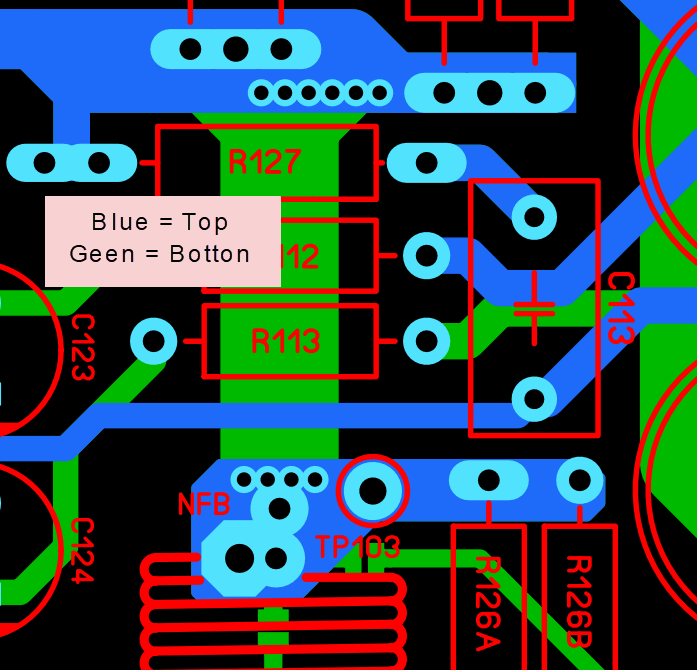

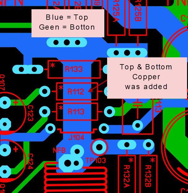

Don't worry, it's fine, top copper was added right through the center section under those resistors from V4.1 on-wards.
Adding the extra copper will help share the current between the top and bottom traces, but what is currently there is more than adequate, so don't worry.
