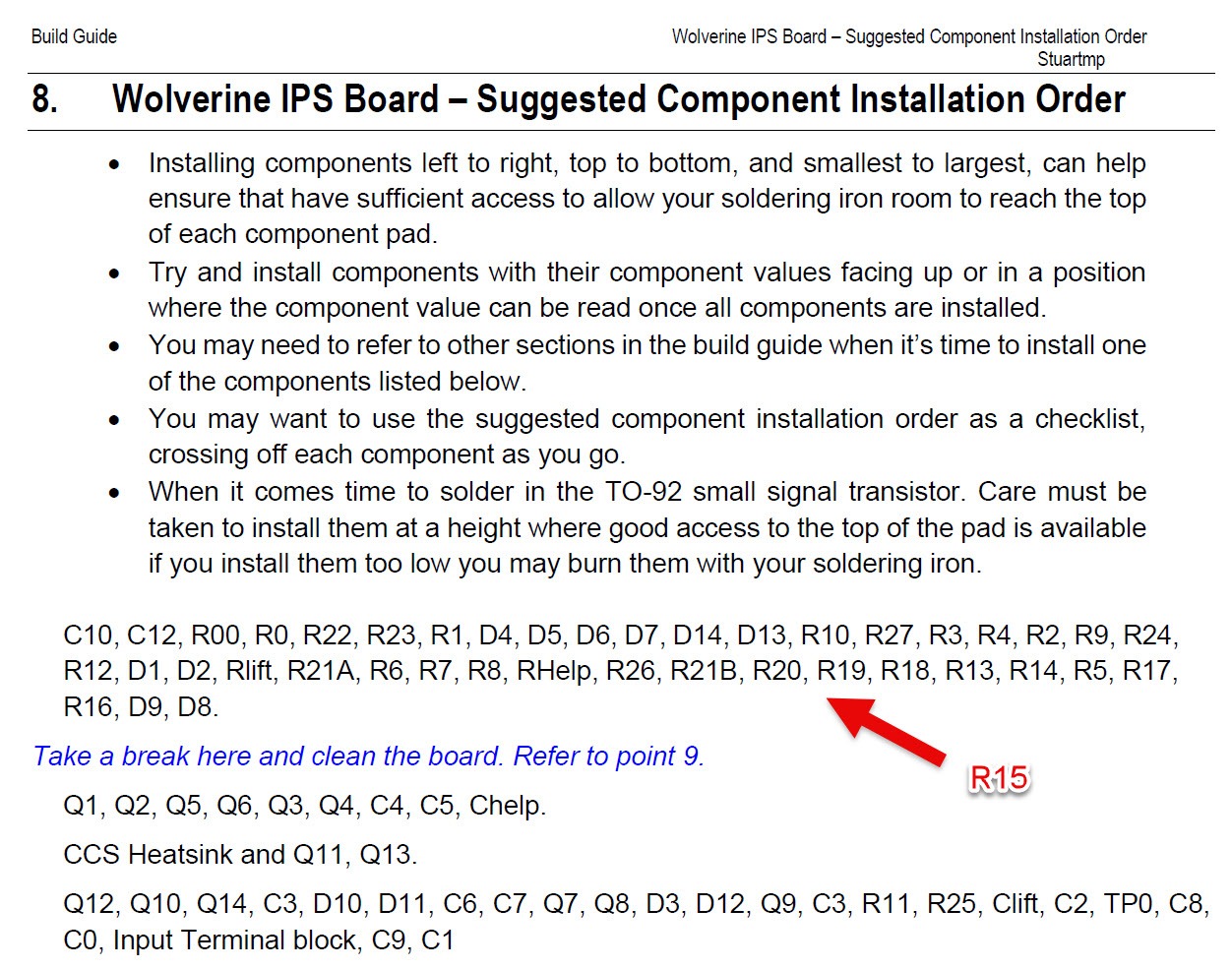

First, thanks for everyone's contributions to the best build guide I've ever used.
Second, did I find something missing, or do I not see where it is? Shouldn't R15 be included on page 24?
Always happy to find a typo, or admit I missed it.

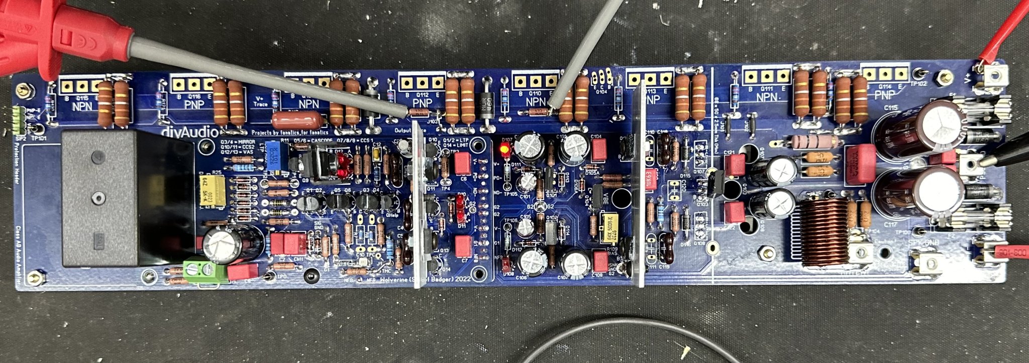

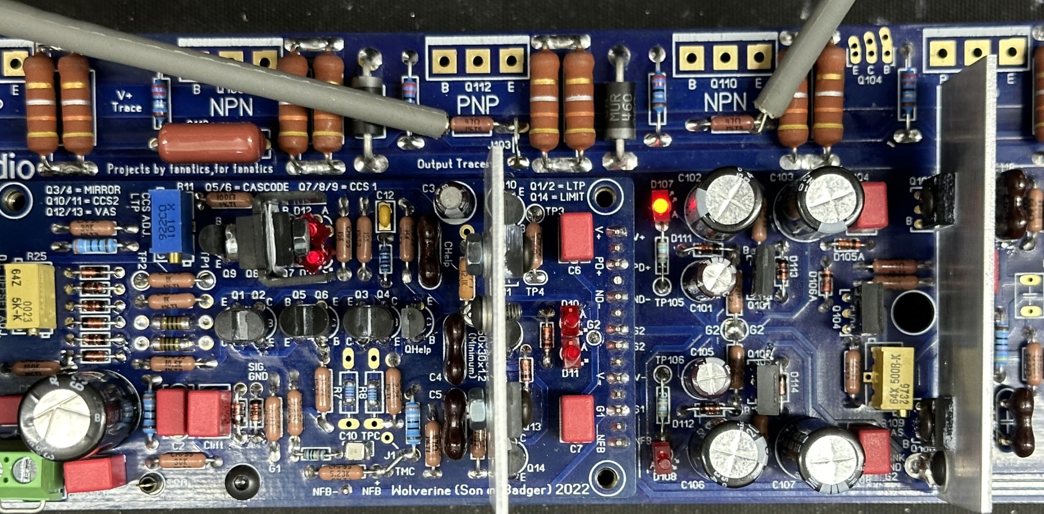

Testing my boards with a 30V bench PSU
D108 does not light, but the other LEDS do light. D10 and D11 do not light, but that's because of the low voltage
The voltage across R111A and R111b is just below 800mv
TP-105 to pos power rail is 1.2V (TP-105 (DMM -) and the positive power rail connection)
TP-106 to neg power rail is 1.2V (TP-106 (DMM +) and the negative probe on the negative rail)
Pre-drivers are 2Sc3503 2sa1381
I have checked the polarity of D108
Q103 is currently mounted above the board. I had it mounted under the board, but had reversed it accidentally. So I desoldered it and temporarily mounted to the top
Q107 (MJE15032) and Q108 (MJE15033) are currently mounted under the board.
Pics attached.
First thing to check, are Q101 and Q102 installed correctly, I.E. facing opposite ways.
Yes, checked those, they are.
D108 lights up when tested in circuit with multimeter diode mode? possible bad LED?
I actually replaced it on one board. and I have tested a few times.
This is happening on both boards. So I don't think it is a bad solder joint or a solder bridge

D108 is just there to indicate negative rail voltage is present on the IPS.
Wrong value resistor for Rled2?
Else measure if there is actually the right voltage between TP106 and G2
Check the LED lights in circuit
Measure RLED 1 and 2 from the back of the PCB to confirm both making contact and are same value.
Check voltage at TP106 to GND is roughly test voltage
I think (possibly, photo a bit grainy) you have no rail voltage at TP106 because Q101 and Q102 appear to be from a different family? Are Q101 and Q104 mixed up? Wrong transistor / pinout?
They're definitely in circuit
I checked them and swapped them out just in case.
This is where the issue is TP106 is about half the voltage of TP105
Different packages, I thought being non-critical this would be okay, but I switched them out for the same package
