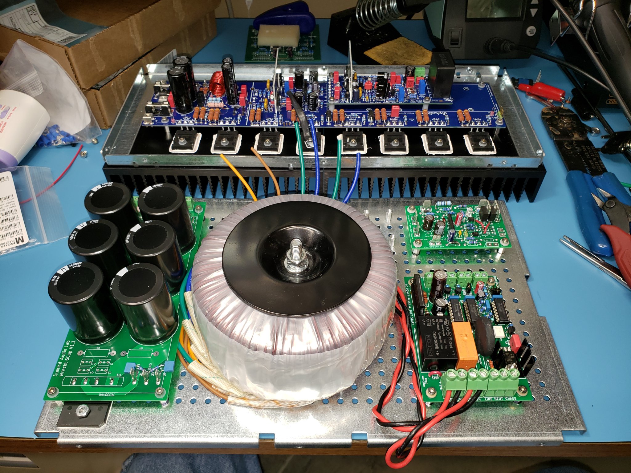

I made an elevated chassis for the PSU to provide enough space underneath the transformer and cap board for the necessary peripherals. As well, I wanted to provide shielding for the transformer and other sources of noise. The attached photos show how this was arranged. which really worked out well. I was concerned about injecting noise with all the close proximity of everything, but the shielding did its job and testing revealed that it's quiet. Distortion testing revealed that the individual boards didn't lose any performance,
Did you test the noise levels with and without the shielding? Just curious how much the shielding is contributing to noise reduction. Not the platform, since that's structural, but the circular can around the transformer.

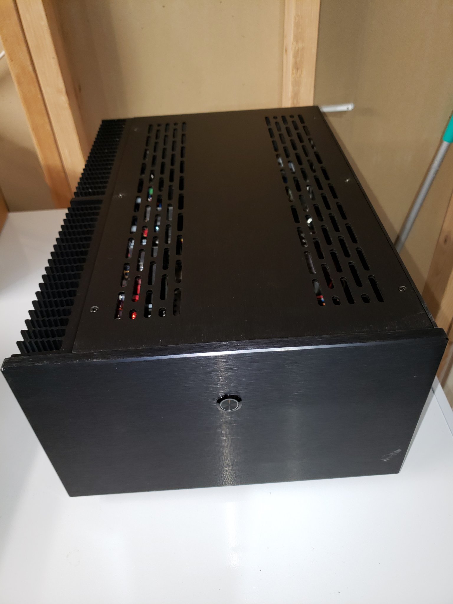

It was a special purchase from the diyAudio Store. I have two of the chassis and built them identical since there is no mirror image board.Nice chassis, please post the details were you got it from
I didn't do any testing to determine the noise levels with and without shielding... I recognized that everything was going to be in close proximity, so I decided to do everything I could to minimize any noise sources. I was concerned about the input and output wiring having to take long paths within the chassis, but it turned out fine.... It's quiet and I can't see anything on the distortion analyzer. The chassis I used is the Deluxe 5U from DIY Audio Store.

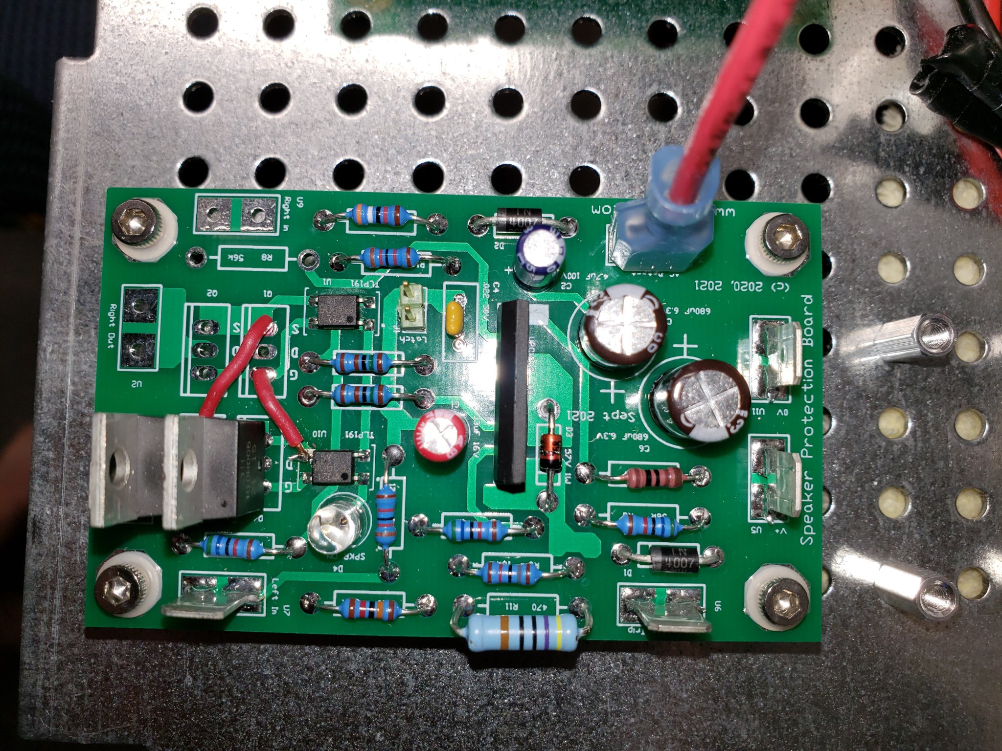

If it isn't a big effort,please can you post the modified pcb?I also modded the Bonsai board to run both opto-couplers in series on one set of FET's, will decrease the switching time. You can see the red wires grafted to the Bonsai board.
I lifted one leg of one opti-coupler, connected to a source lead, and soldered a wire to it and soldered the other end into the gate terminal of the other FET holes. Then soldered another wire in the other FET source hole and soldered the other end to one of the FET source legs. I could do this because I am using a board in each amp only controling one channel each. The actual board itself was not modified, a more correct description would be I modified the wiring of the board. If it was being used for two channels it would be difficult to wire the two opti-couplers in series, probably easier in parallel. Their was some discussion on Bonsai's thread about wether the parallel opti-couplers decreased the switch time. Of course, connecting in series doubles the voltage the opti-couplers put out, parallel connection doubles the current the opti-couplers put out.
Thanks for this RickRay!I lifted one leg of one opti-coupler, connected to a source lead, and soldered a wire to it and soldered the other end into the gate terminal of the other FET holes. Then soldered another wire in the other FET source hole and soldered the other end to one of the FET source legs. I could do this because I am using a board in each amp only controling one channel each. The actual board itself was not modified, a more correct description would be I modified the wiring of the board. If it was being used for two channels it would be difficult to wire the two opti-couplers in series, probably easier in parallel. Their was some discussion on Bonsai's thread about wether the parallel opti-couplers decreased the switch time. Of course, connecting in series doubles the voltage the opti-couplers put out, parallel connection doubles the current the opti-couplers put out.
