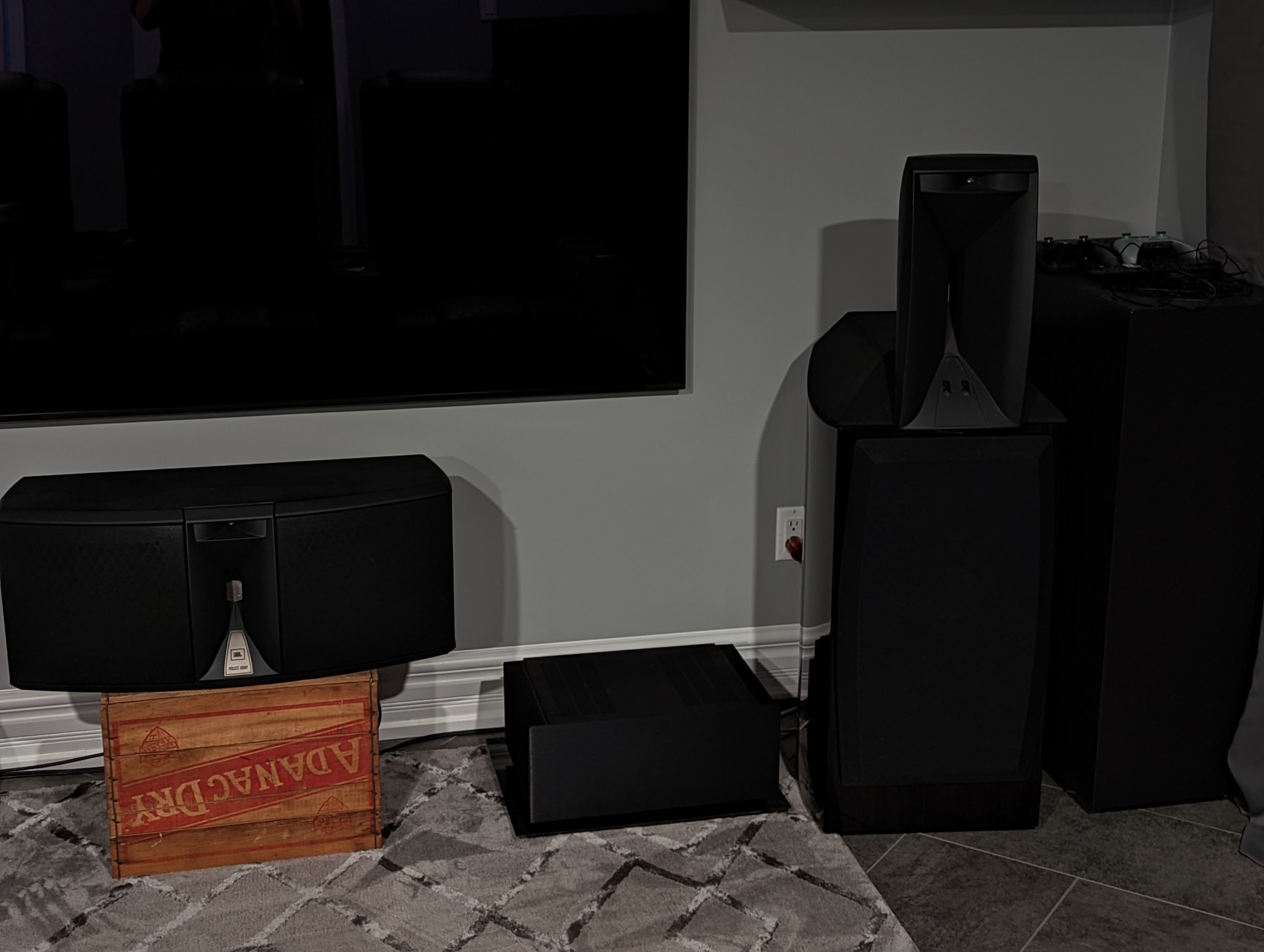

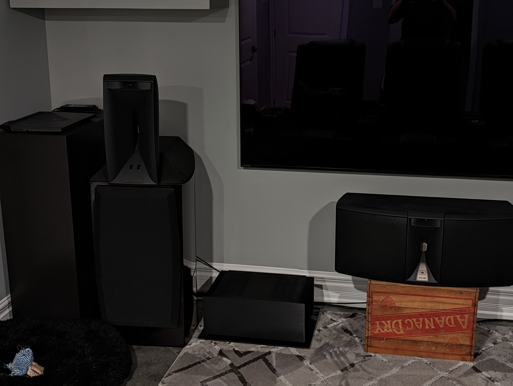

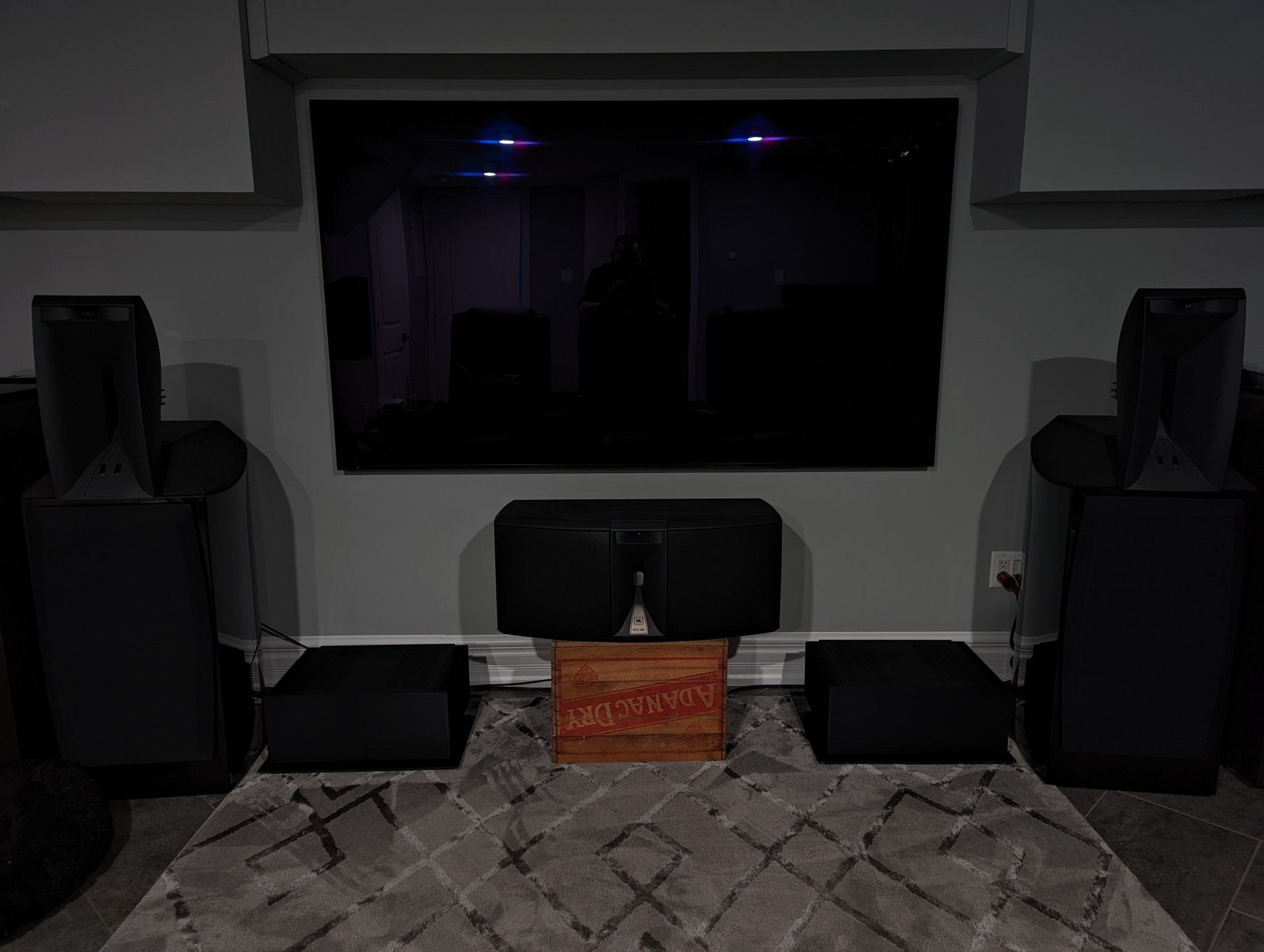

Installed! And all I can say is WOW. These JBLs have never sounded so good. They are actively biamped from a minidsp Flex with the low frequency crossover removed and 4 channels of raw undistorted power from the wolverines. Since hooking them up I have noticed a huge improvement in the depth of the soundstage, dynamic response is unbelievable and the bass hits hard and extremely fast. It feels to me like the woofer starts and stops instantly without decay or reverb. It will be a very long time if ever that I will find a need to upgrade this pair of amps.....well maybe with EF3-4's 🤣

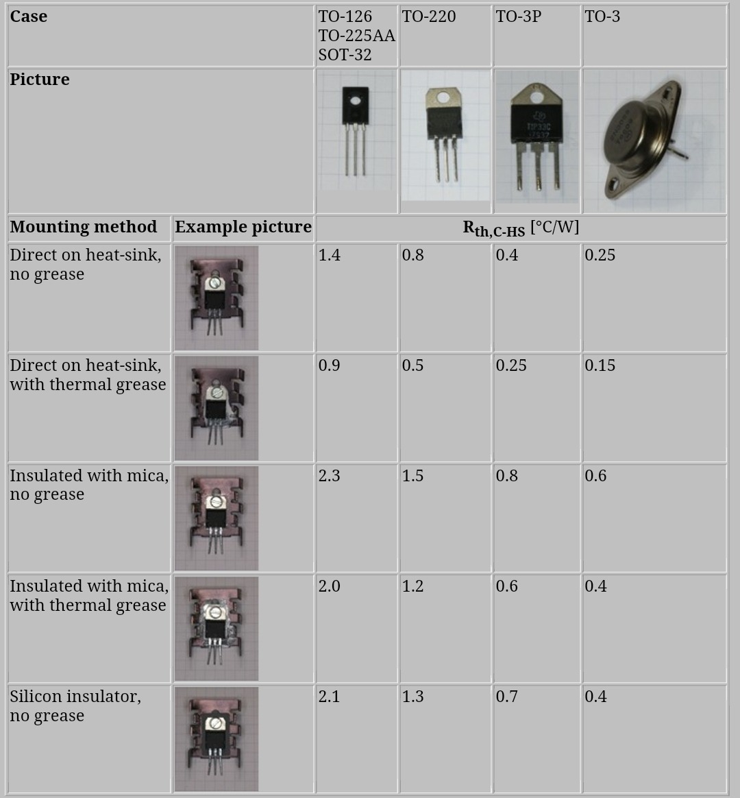

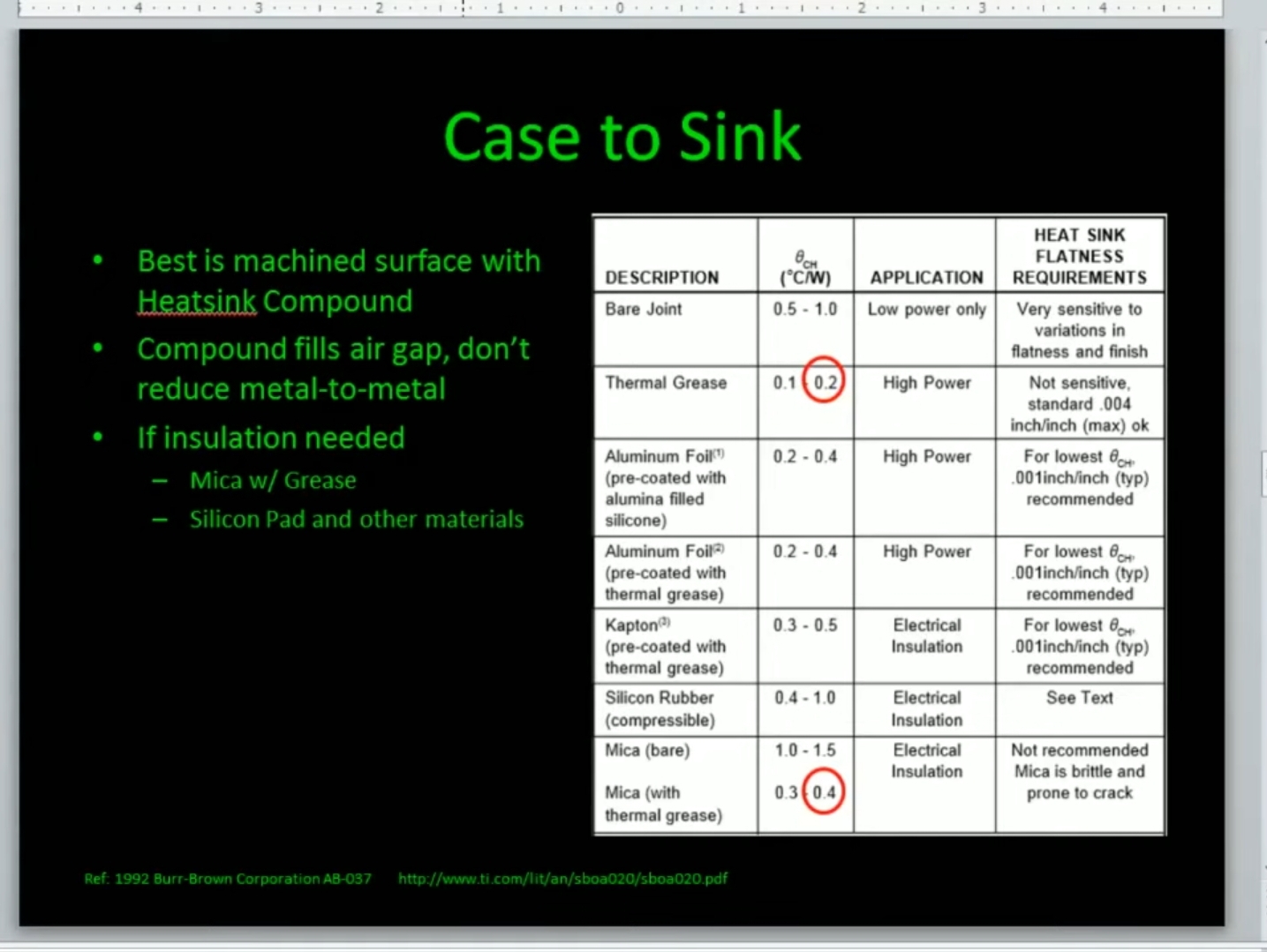

Thank you. The ones in the DIYaudio-store seem somewhat small to my taste tho. I use TO-264 outputs. Also Import from sorces outside EU is problematic where I live.
However I found that Keratherm® 86/82 Red available at a German supplier. It's sold as a sheets 190mm x 190mm for 18 Euro each.
Is this stuff easy to cut with a knive/cutter? Also how to make holes in it?

Very easy to cut and drill this.
Use a pair of scissors for cutting
You can drill this even with the screw itself.
Just place this in position under the transistor and use the screw as an always drilled hole.
