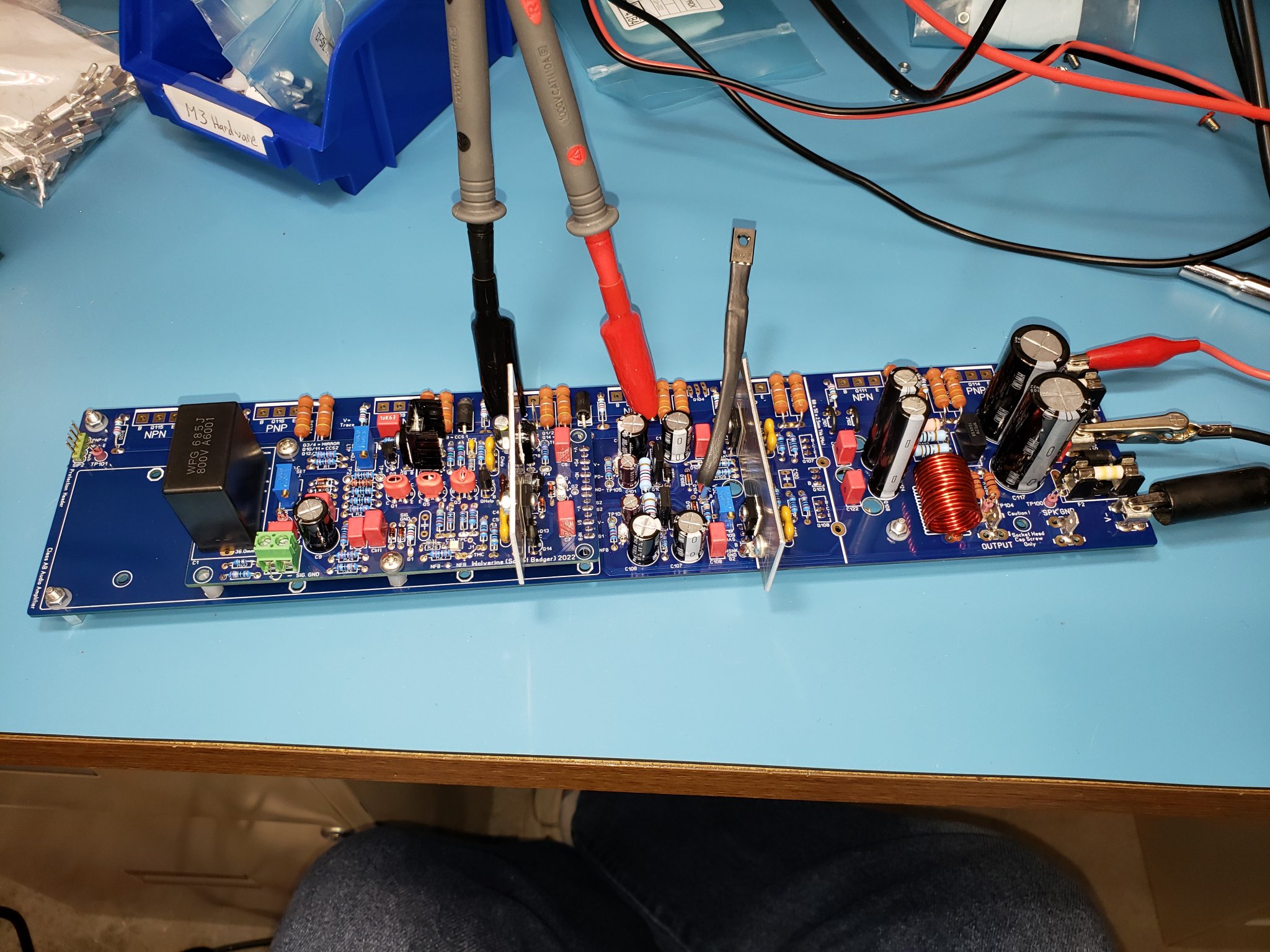

I finally received all the parts needed to finish the boards. I have installed the IPS on the main board and powered up with a +-30VDC bench supply limited to .3amps. When I started it the bias between R111A and R111B jumped to 220mVDC. I had Q104 installed backwards on fly leads. I removed it and tested it and it was fine, so I reinstalled the correct direction, same problem. I swapped out the other IPS board to test if it was main board or IPS, same problem, so went back to original IPS. All diodes except D10 and D11 lit, there was no smoke, nothing overheated, and current draw was .01 amps on positive rail and .02 amps on negative rail. Is it possible I "smoked" Q103 having Q104 installed backwards? Not much else on the main board in the bias circuit that could "smoke" without seeing something.
I fixed the diode issue and it now has 700mVDC across R111A and R111B with both rails powered. When only the negative rail is powered it drops to 0.09mV, when the positive rail only is powered it jumps up to 700mV. I'm suspecting that I "smoked" Q10 or Q11, since with jumpers in positions D105 A and B, I created a dead short to ground. Am I on the right track?
Both Q10 and Q11 checked out and I have 1.9VDC on the base of Q105 and -2.1VDC on the base of Q106.
Hi Richard, I'm out at the moment so I'll have to study your posts and get back to you. Just checking that you have Version 21 of the build guide?Still 700mVDC across R111A and R111B.
I will check that also. I am heading out to see the Drive-By Truckers. I'll be back on tomorrow.
Thanks what I was thinking and based on some of the revisions I did.I did NOT have version 21, looks like my problem is NOT a problem.
Let me know if you've lost your Dropbox link
I still have the dropbox link and have downloaded version 21. Looks like it is working perfect now after fixing my diode issue. I will thoroughly check it out tomorrow. BTW, the Drive-By Trucker concert was awesome, ended it with Angels and Fuselage.
Everything checked out perfect except the reading across TP-105 and TP-106 to rails. TP-105 to the positive rail measured 1.280VDC and TP-106 to the negative rail measured 1.339VDC. I'm using KCS3503E/KSA1381E and powered the rails from a +-32VDC bench supply.
I'm wondering if the lower voltages aren't because I have the rails set-up for 71VDC. Can I safely power one rail at a time with 64VDC and test TP-105 and TP-106? I can series the bench supply and get 64VDC.
Hi Richard, If you have followed the start-up tests listed in the build guide and everything else checks out I would say that the reason you are seeing those slightly lower voltages is your supply voltage is to low.I'm wondering if the lower voltages aren't because I have the rails set-up for 71VDC. Can I safely power one rail at a time with 64VDC and test TP-105 and TP-106? I can series the bench supply and get 64VDC.
It's not a good idea to power up one rail at time, so please don't do that.
