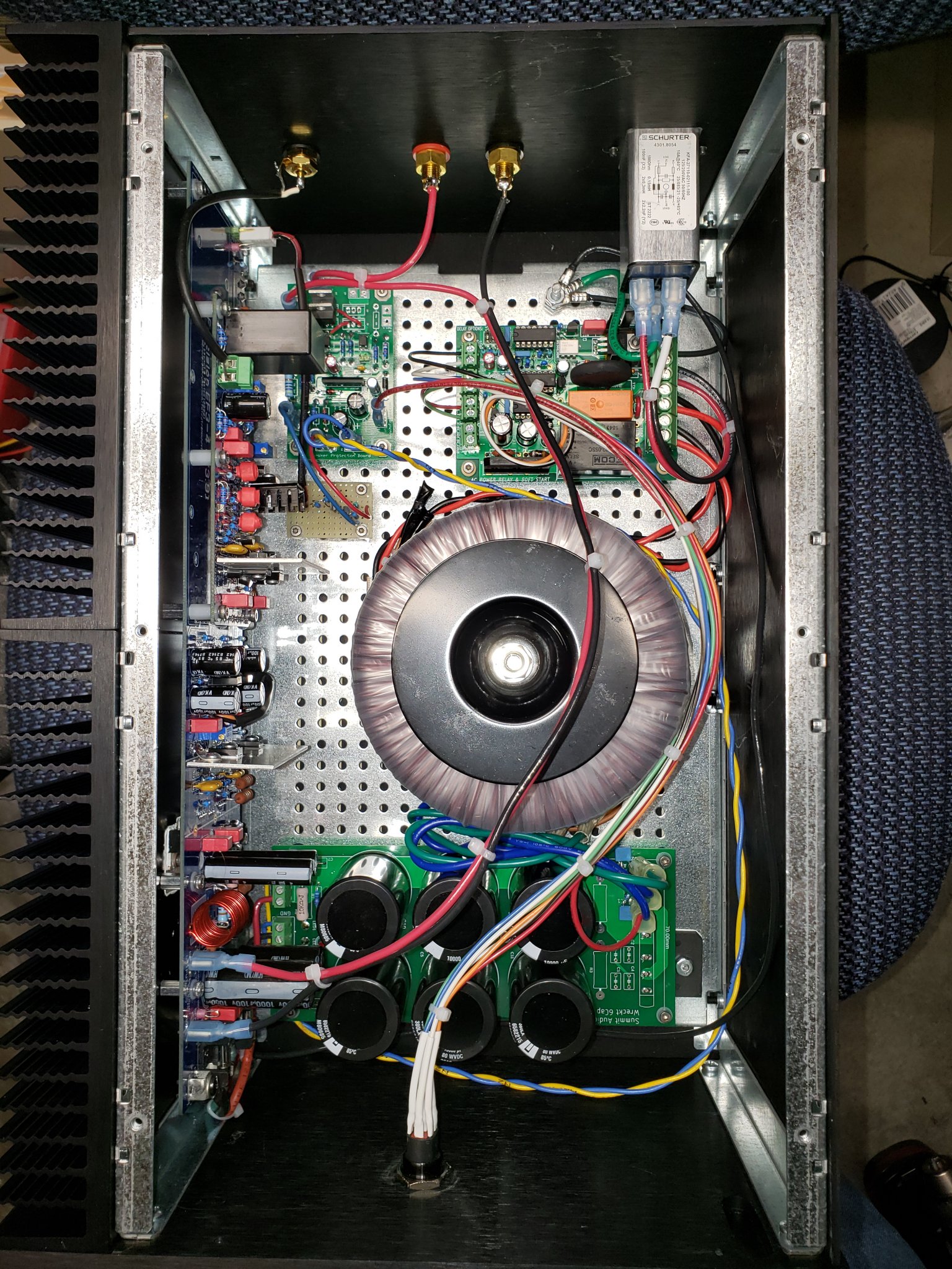

Which illustrates the need to measure. I will post some pictures of my completed amps and look for feedback on what is causing the 60Hz and odd harmonics of that. I'm not that worried about the final Harmonic Distortion on the amp itself, I am sure it is below what I can measure at this point.
Here is a picture of the wiring. Both amps are identical and measure practically identical. I have moved wires around while watching the spectrum analysis and I have seen nothing that has changed the problem with 60Hz and the odd order harmonics. Ideas?
Hi RickRay,
First off, well done so far, its great to see your build is progressing well.
I think you are close to a good result. I particularly like the use of the solid state protection board.
Please don't take the below as criticism because I can see you have put thought and care into your build, I am just going to give you some pointers:
I encourage you to read the ground loop document that Bonsai produced thoroughly, don't skip this step.
After reading the document, apply all of the suggestions to your amplifier build to the best of your ability.
A few of things I noticed immediately which may also help:
Twist you speaker wiring tightly and get it away from the centre of the toroidal transformer.
Run your speaker wiring tightly parallel to the heatsink in the steel bracket along the top or bottom edge, perhaps zip tie it or use small plastic brackets/clips. Neilshop's build has a great example of this. Keep a little clearance so your screws don't foul on the wire.
Do the same with your yellow and blue wires, they are forming a large loop area around the transformer, I would consider trying the yellow and blue wires on both sides of the case to determine which is the lowest noise option.
Do similar with your control / switch wires, they are forming a large loop area.
Consider using an audio ground lift, your mains ground stays solidly as you have it. (per Bonsai's document)
Use star washers on a couple of screws on each panel to ensure the anodising is cut through to ensure each and every panel is earthed solidly, without power connected check this with a digital multimeter at your nice Schurter power inlet module earth pin. Kudos for using a nice power inlet module.
If after all this you still have hum, try changing the orientation of your transformer output leads in 1/4 turn intervals (with the amp safely powered down when you work on it of course) Twist the toroid's primary and secondary leads tightly.
That is it for now.
It would be great if you could let us know if this reduces the noise on your FFT capture with the same settings.
Hope this helps

I talked to Stuart tonight and he mentioned almost all the changes you suggest, but you have a couple very nice suggestions he didn't mention. I am moving most of the pieces around in the chassis after talking to Stuart. i'll share the mock-up picture on here when I do that, maybe it will help someone else.
I agree, hopefully, I'll be able to measure after correcting a lot of issues and see a nice improvement!

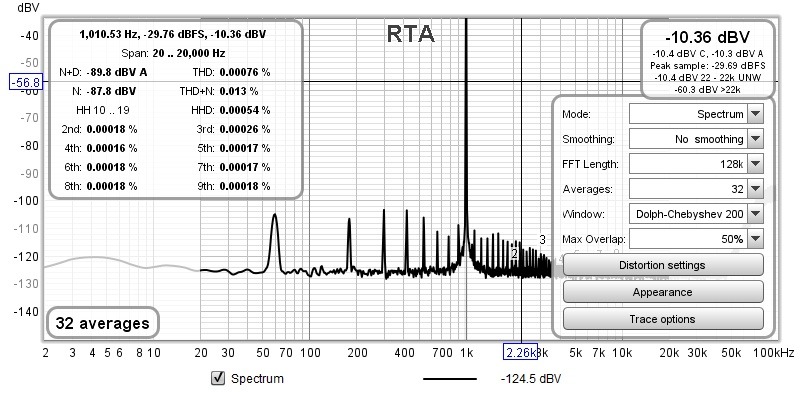

Nice work danieljw,eliminating the 50 Hz harmonics in measuring procedure is a very difficult job.
That doesn't mean really gnd loops in amplifier itself.
Make shure that you have power your p.c from a different socket than your amplifier under test.
Use a long power cord to connect one of this to a different room socket.
Test once and then reverse amplifier's power socket and test again.

Hi Thimios,Nice work danieljw,eliminating the 50 Hz harmonics in measuring procedure is a very difficult job.
That is a clever test you mentioned.

@danieljw You used a harmonic amplifier to decrease your noise floor, that is one very nice piece of equipment. Question, would an active notch filter before the audio interface also allow you to decrease the noise floor? Not suggesting you do that. I don't want to invest in building a distortion amplifier for the amount of measurements I do, howerver I can buy a COSMOS APU for a very nice price that would give me +30dB at 1kHz and 10kHz.
Excellent video!!!! Double check if the noise figures are accurate while using coherent averaging, pretty sure they are not, that's why they are colored differently.
