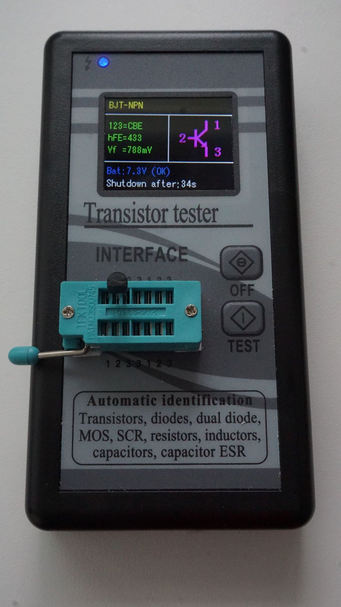

I´m the guy 😊
My BC327/337 are all high hfe grade 40 types. They are left over from a Paradise phono amp build.
Pretty cheap as I bought them. If you have the appropriate measuring and testing capabilities I can send you some for free. It is enough if you pay me the postage. Or somebody can do a spice sim? I am curious what comes out of it...
Some specialists here on diyaudio prefer the BC3327/337 over BC550/560 when it comes to low noise application.
I measured all of them with a tester at room temperature three times within one minute and sorted them accordingly (see photo, the numbers are the hfe values). My work table is antistatic and grounded. I used tweezers to change the transistors so as not to heat them up with my fingers.
I don´t know how precise the tester is. But it´s more about same values in different position as the absolut value.

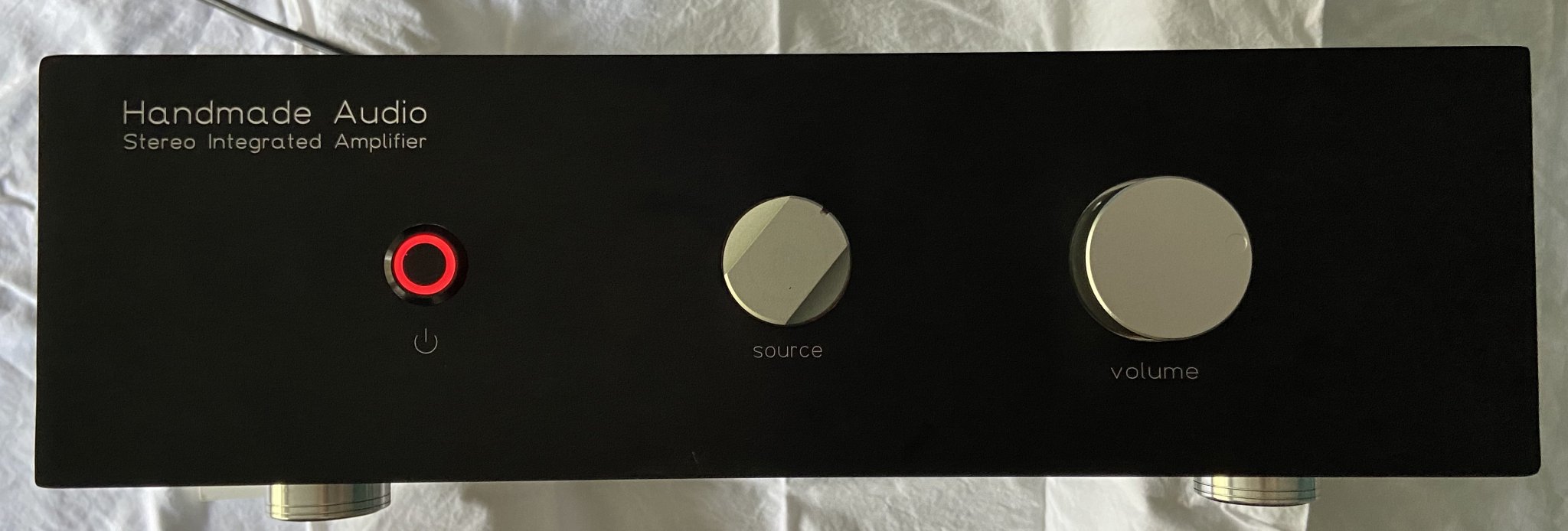

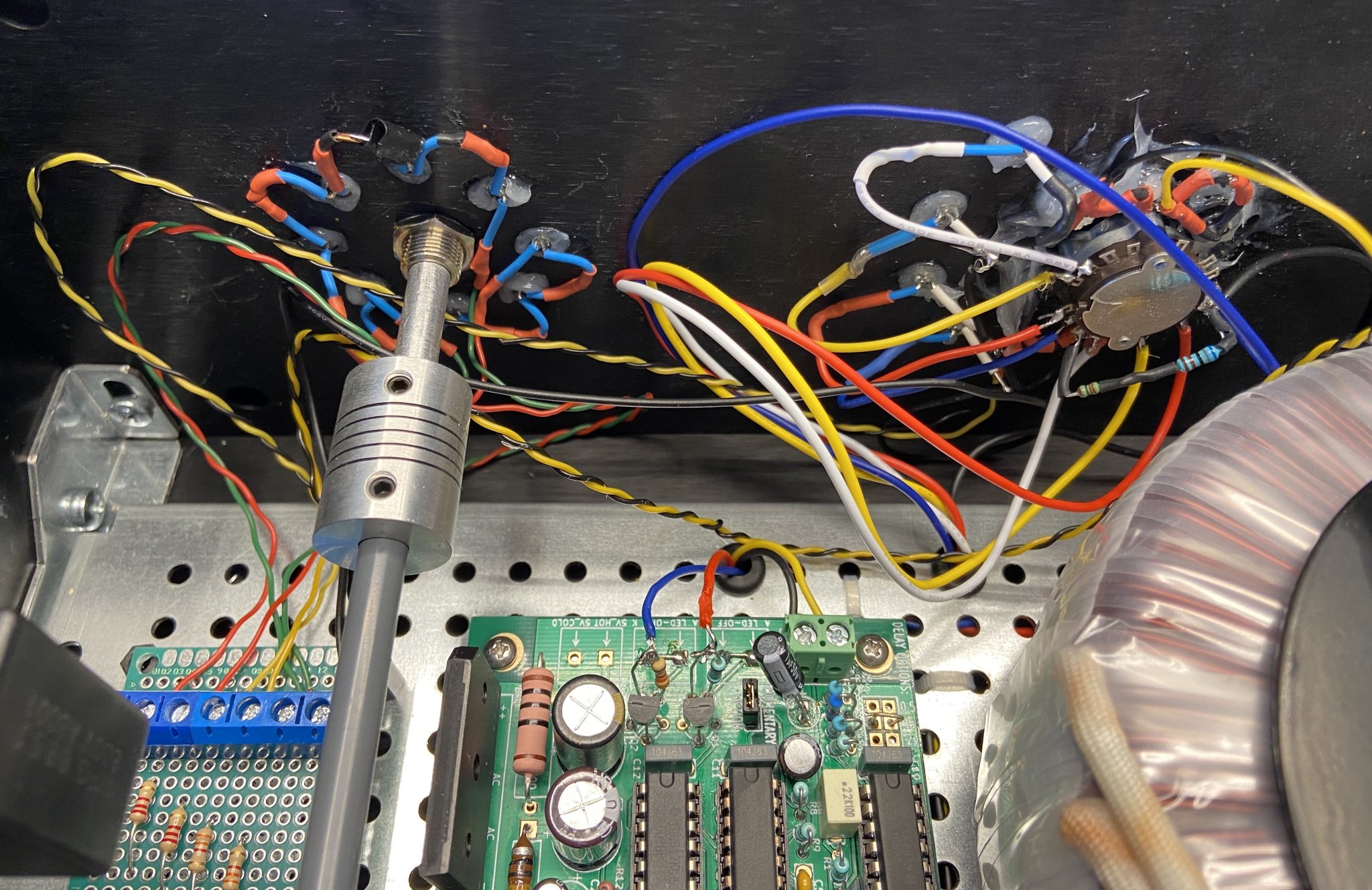

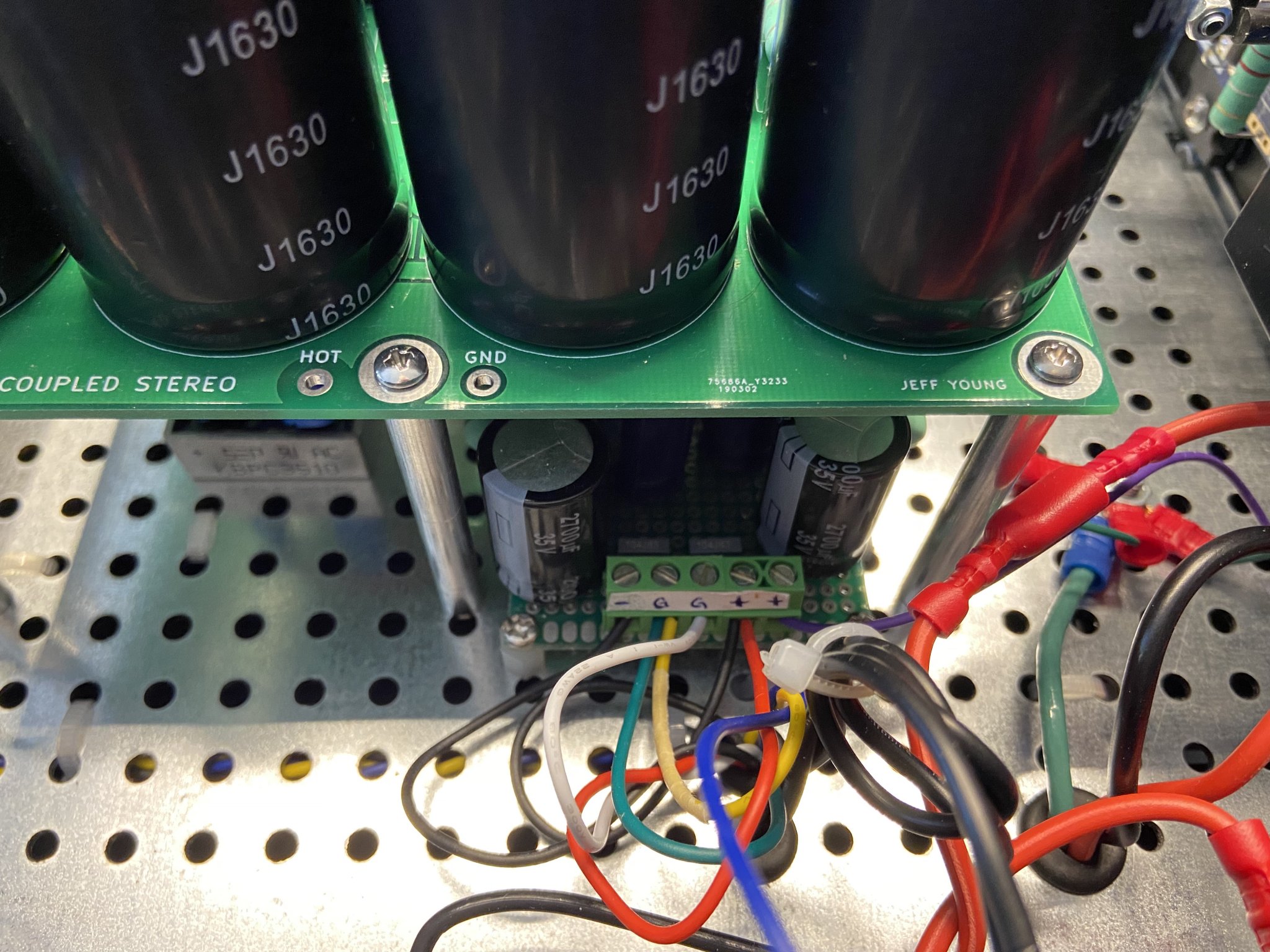

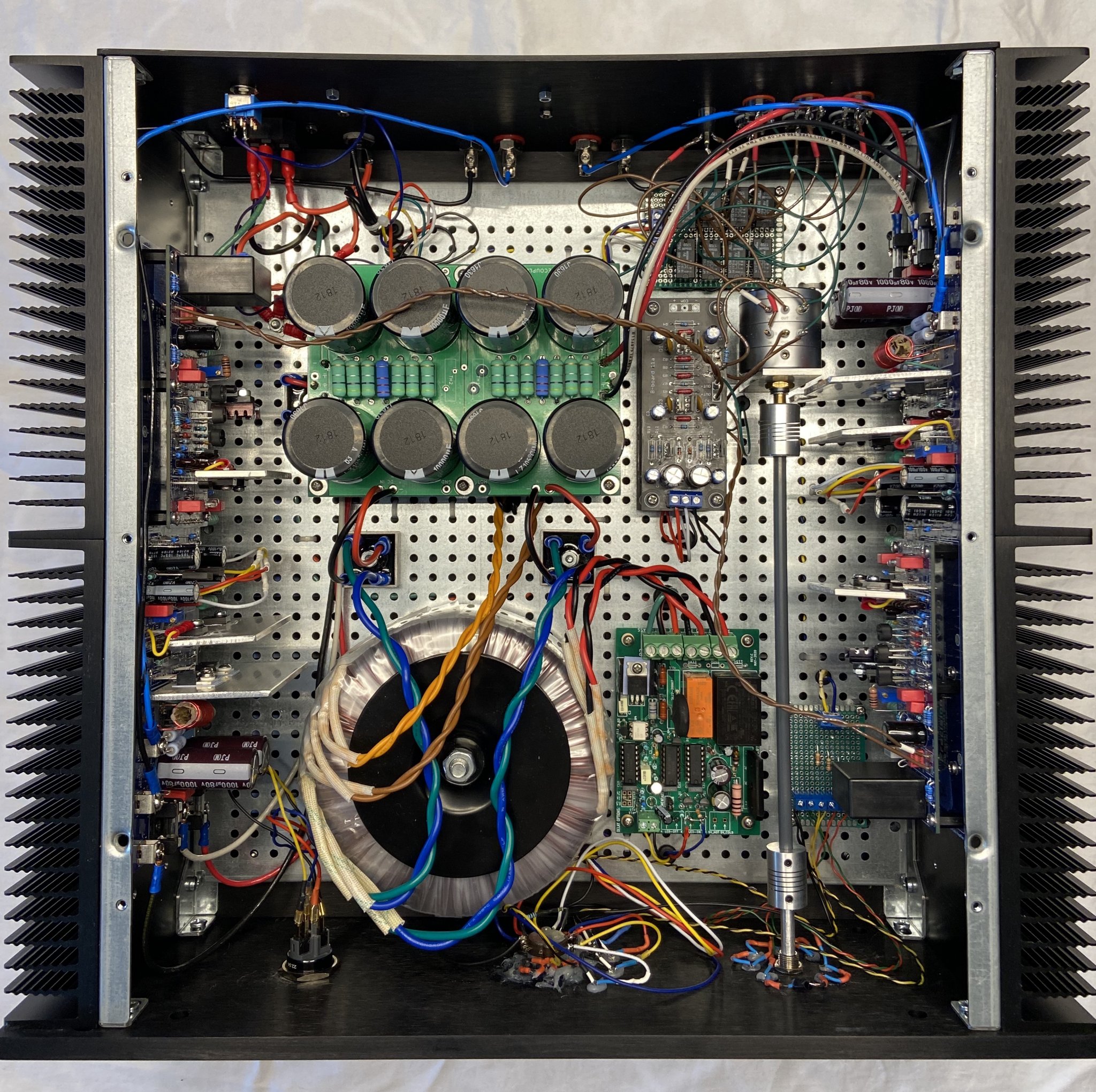

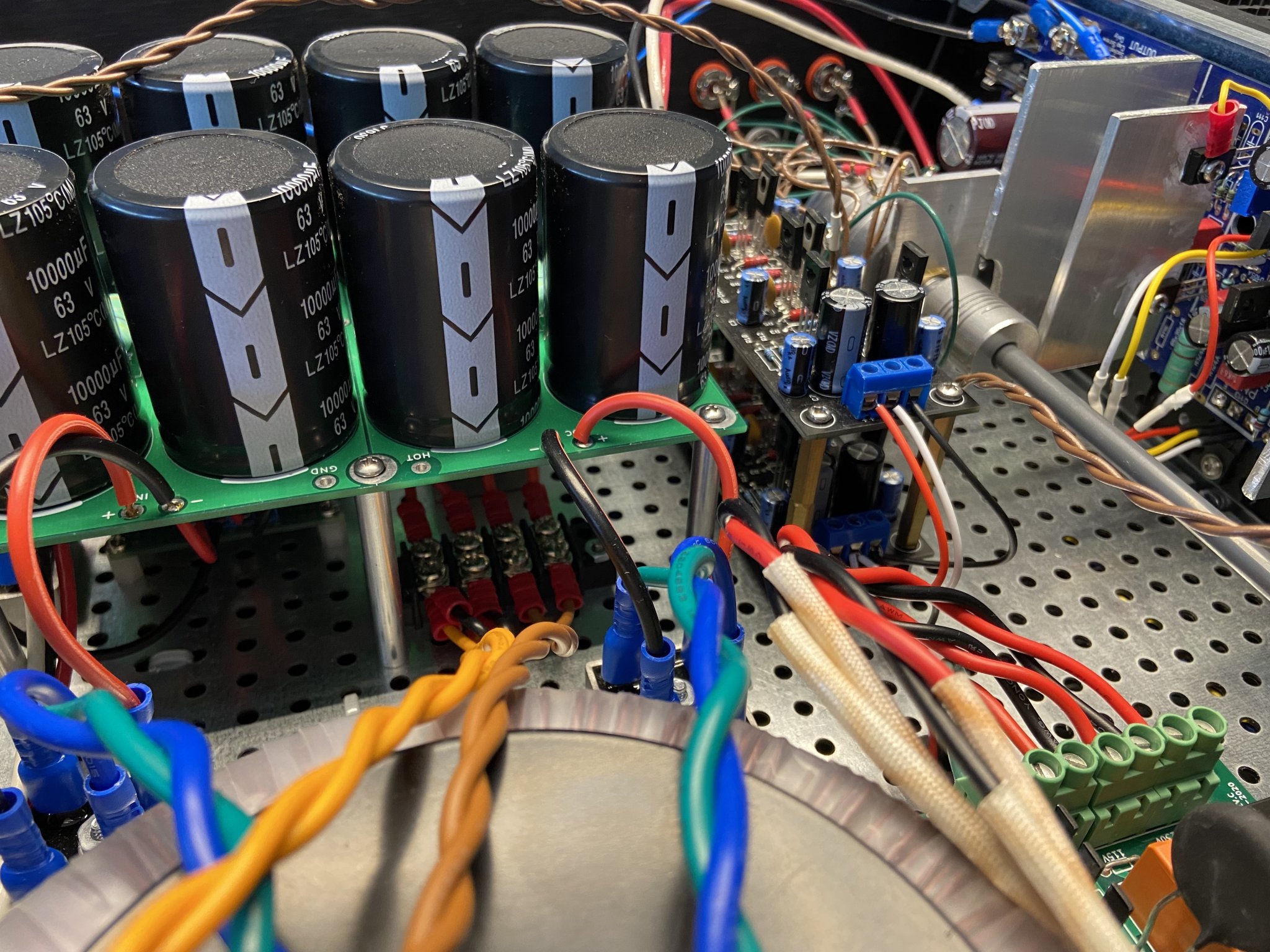

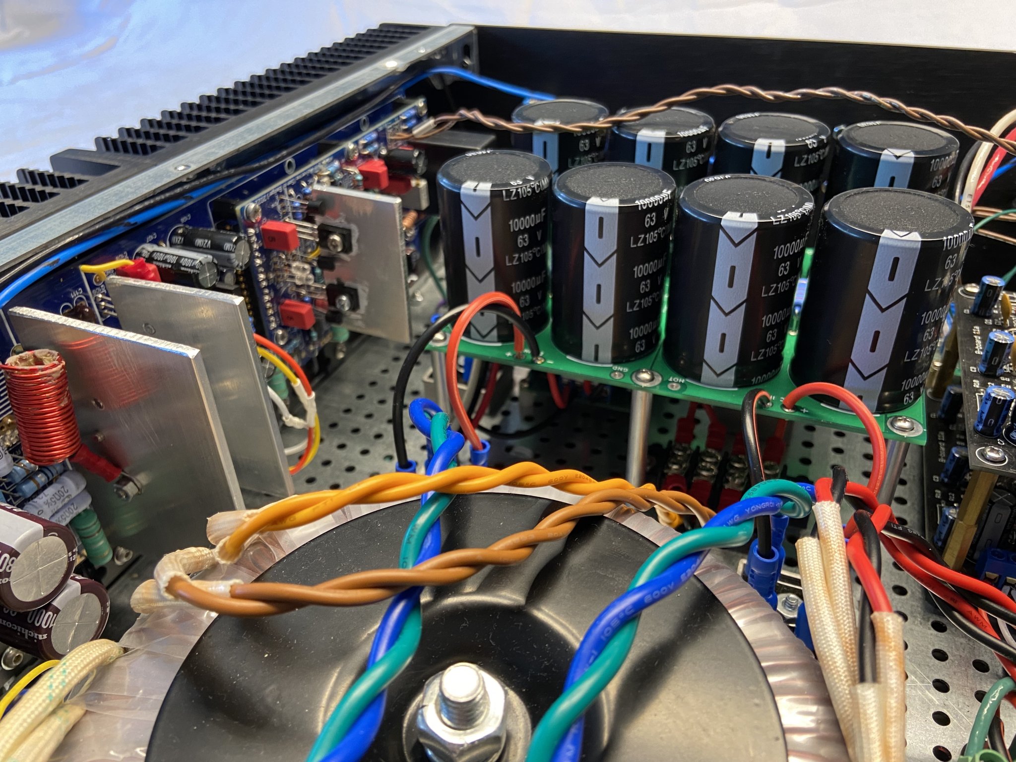

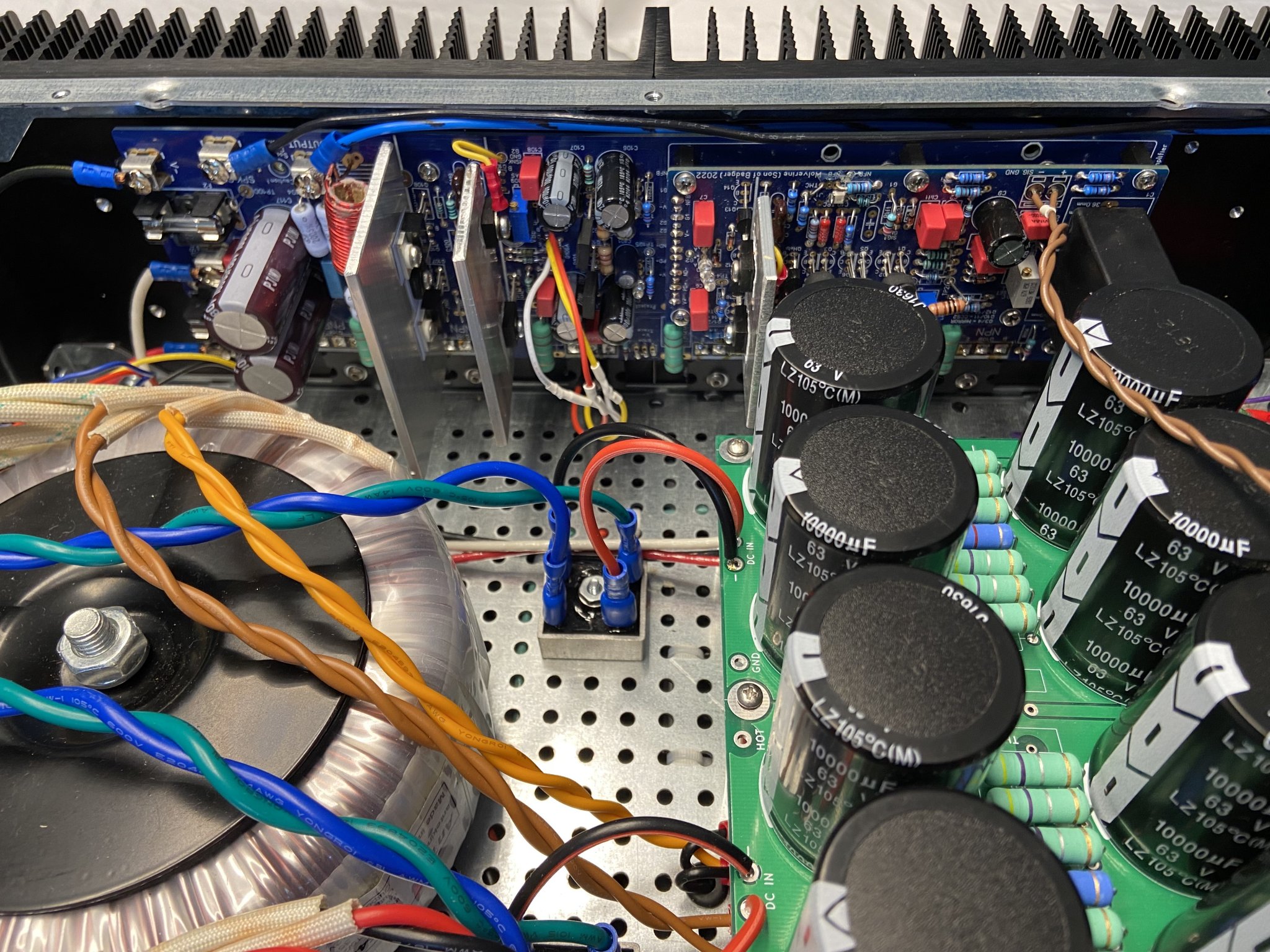

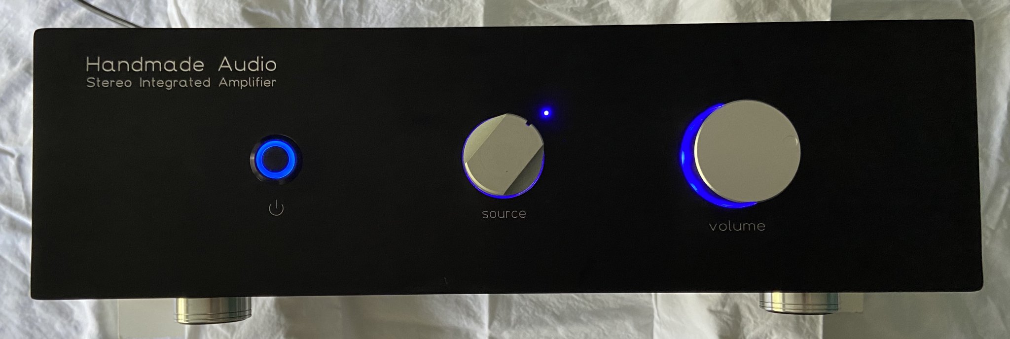

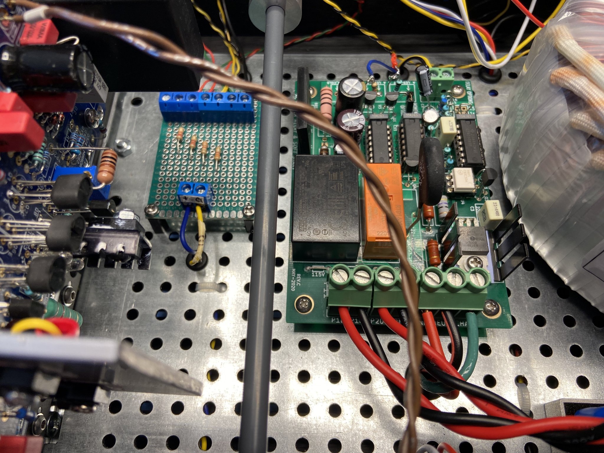

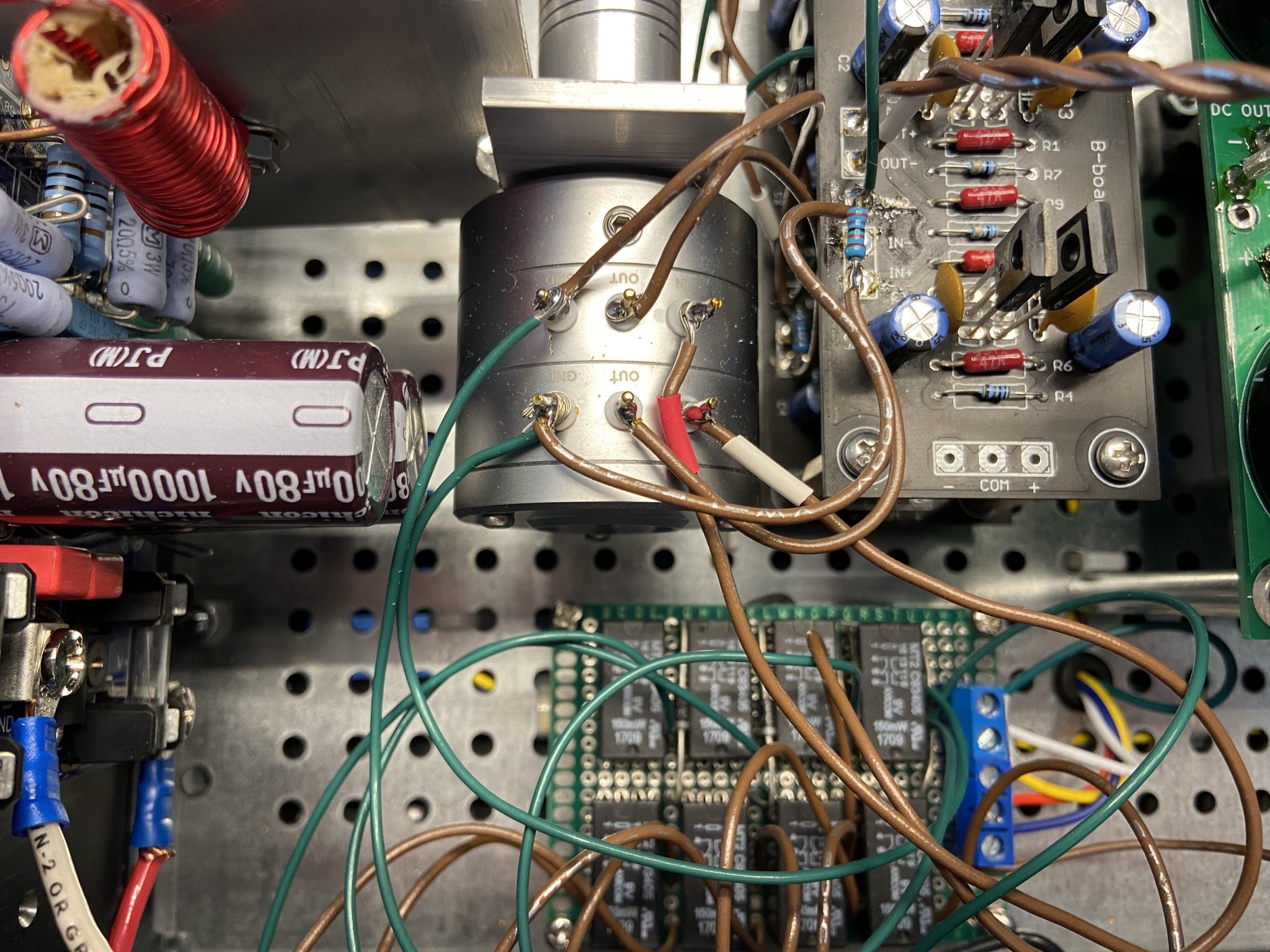

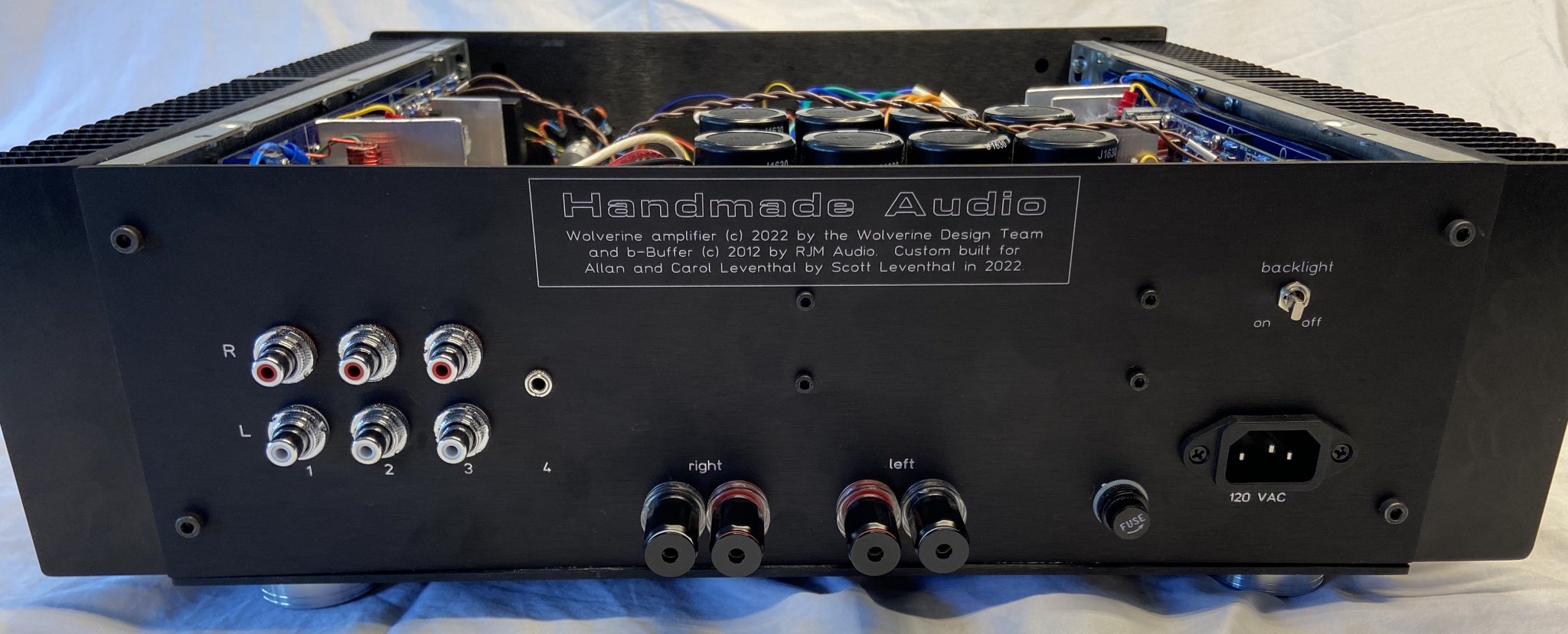

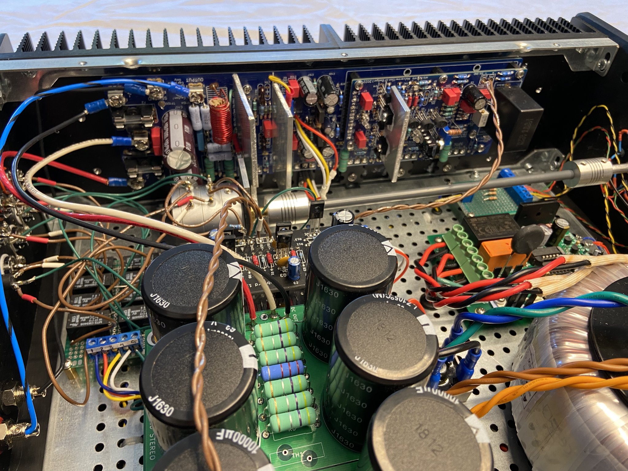

Folks:
My integrated amplifier project is finished. It consists of a Wolverine amp (EF3-3 pcbs) and a set of RJM Audio buffer boards built in a HiFi2000 3U Dissipante chassis. The Wolverines are powered by a Jeff Young-designed "Decoupled Stereo" power supply (stereo for the first stage and then dual mono for the second). The buffers, source relays and front panel LEDs are powered by a small bipolar power supply hidden beneath the bigger supply. I modified the H9KPXG soft start board to work with a bicolor power switch and I mounted LEDs behind the attenuator and source select knobs to provide a nice knob backlight ring effect (something I've been doing for about 15 years now). This project is a gift for my parents, who listen to music all day long, and will replace a Gainclone I built for them in 2005. This will be a huge step up for them.
It takes a village to build an amp. Okay, that's not exactly true: it takes a village to help me build an amp. Although I've been building audio components for a while, my engineering knowledge is extremely limited. As a result, my projects invariably require expert support. This project was no exception, and I am enormously grateful to the Wolverine design team (especially stuartmp and jjs) for developing their amplifier, providing the Build Guide and supporting documents and then promptly and very helpfully responding to my inane questions. Honestly, this dope couldn't have done it without their help. That said, this project was incredibly fun and there wasn't a moment when I thought it couldn't be completed -- there are a lot of steps, but if you take 'em one at a time you eventually get to a successful end. And if I can do it, anyone can.
So how does it sound? After finalizing the adjustments to the amplifier (DC offset on each channel is in the 0.1 to 0.3 mV range), it was burned in for 3 days using my modified FryBaby3 burn-in device and then installed in my main system for listening tests. The speakers are Mk.6 Elsinores which have been tricked out in several ways; they're very revealing and, with good amplification, throw a broad, deep and high soundstage with exceptional resolution and neutrality. The Wolverine amp sounds fantastic: neutral, well-balanced and a very good soundstage. There is an engaging clarity with this amplifier -- eyes closed, the presentation sounds real. I could listen to this thing for hours. Unfortunately, the only way that's going to happen is if I visit Mom and Dad (I'm kidding, they're lovely people).
Kudos to the Wolverine design team!
Scott

Hi Scott,
I'm so happy that you have successfully completed your build. Your case and the details you've added to it look amazing. I can see the effort you've gone to for sure.
Your front speakers.... wow..... they are something very special...
I know this amplifier is going to your parents, but it must be like giving up your first born... But gifting this to your parents says alot about how special they are to you. Please post some feedback from them after they have listened to it for awhile.
I hope that your going to build yourself one or more Wolverine amplifiers in the future.

Hi Scott,you have done a very good job here although something is missing.
Please connect a speaker protection circuit!
I guess you don't like a burned speaker....
thimios:
My design includes mounting holes on the rear panel for a speaker protection board (I have a couple of diyAudio's version (V2) on hand). It was initially installed but not working as well as I would have liked, so I removed it. If I can correct whatever problem it has, it'll be reinstalled. I'm not terribly worried about my parents' current speakers, which are not very good, but if I can get a long-planned Hamlet loudspeaker project off the ground my parents will be receiving a new set of loudspeakers, in which case the speaker protection board problem will have to be corrected.
Good eye!
Scott
Good eye!
Scott
