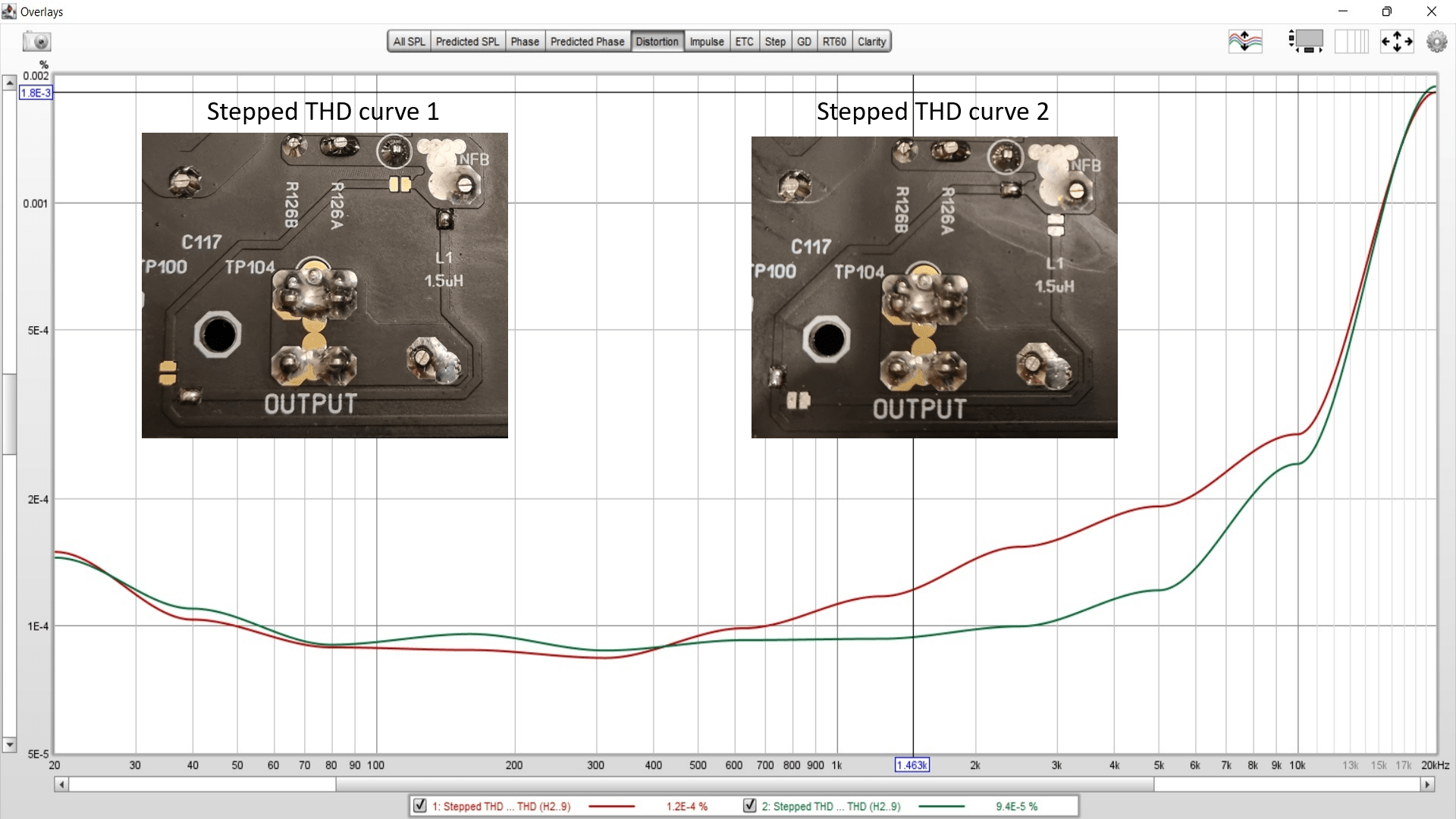

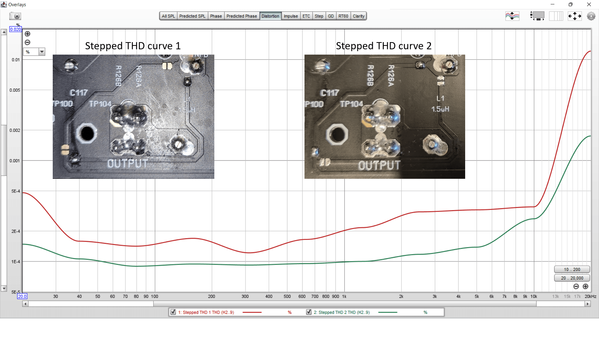

Hi all,
I was asked by the Wolverine team to measure the two feedback trace options and see if they made a difference to THD.
Please see results below, note these measurements were not magnified:

Did you try a cable with minimum lenght, instead of the printed traces ?
Hi Theodosis,
I have only compared the two track options at this stage
- Dan
If you did this you would need to tape the wire to the PCB. I don't think its wise to have a wire floating in mid air.
Part of the reason the second option may have preformed better is due the fact that it runs closer to the ground return trace sooner and exposes less loop area so radiated fields are not picked up as easily.
