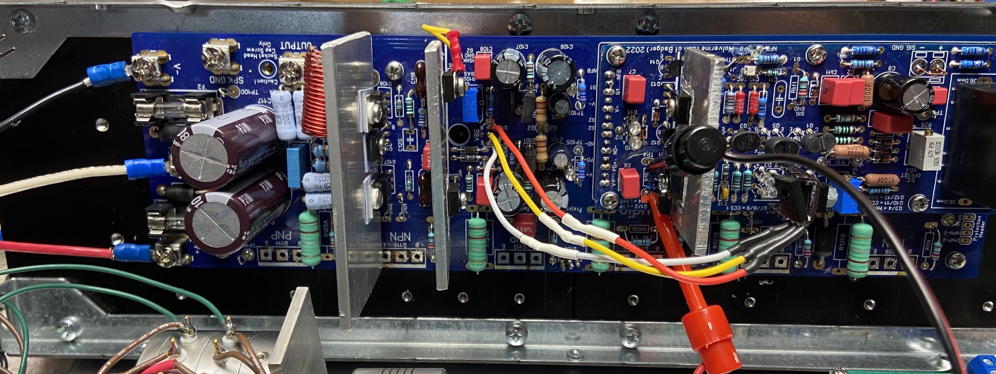

As I have checked everything I discovered that I had the two capacitors in my snubbers switched. I am continuing to rearrange parts to reduce loop areas and proximities, but more than likely the switched caps are why I have so much 60Hz and odd harmonics.

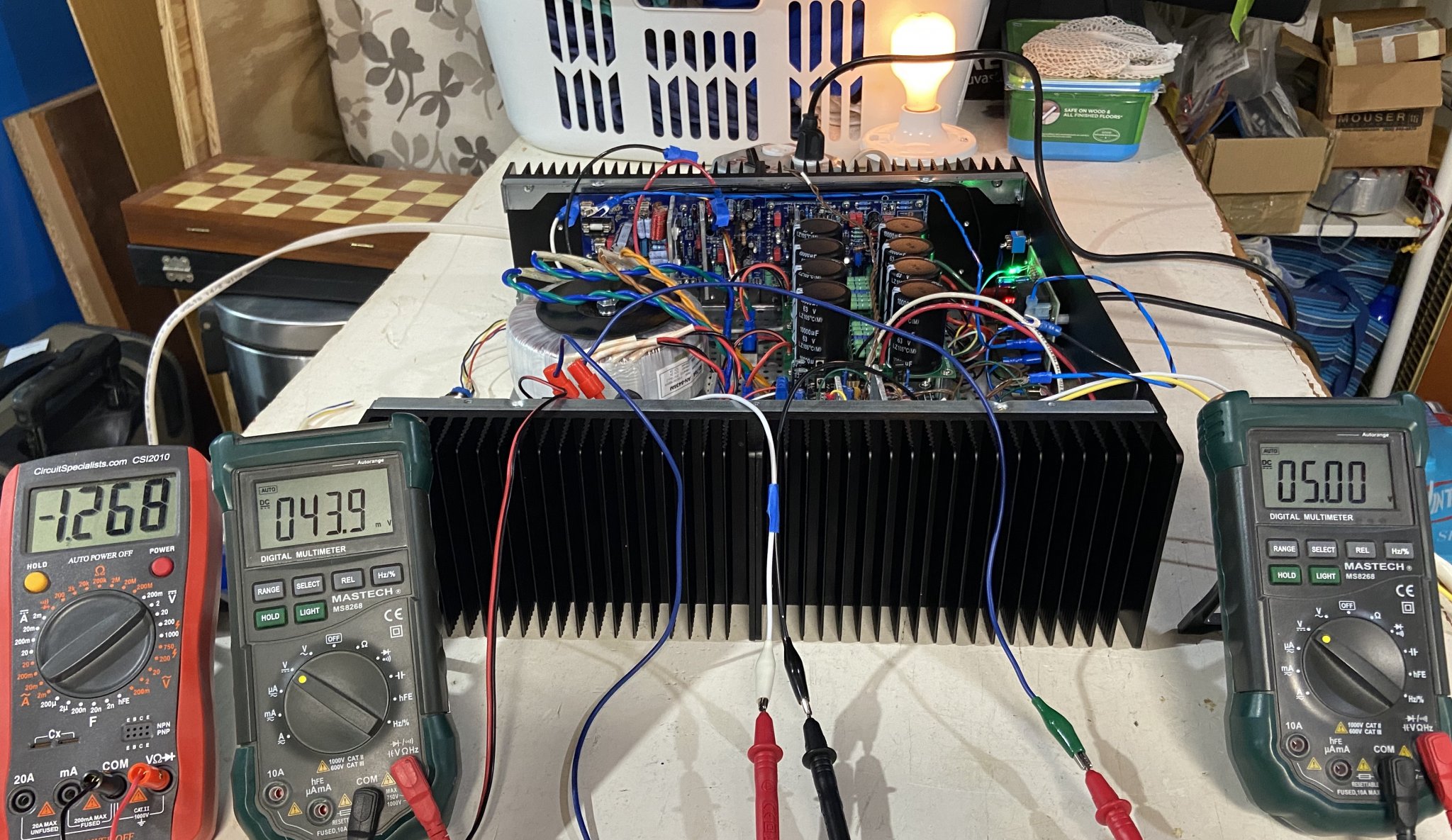

Jeremy, stuartmp & Co.:
In an overabundance of caution, I'd appreciate your feedback on my testing of the right channel.
The left-most DMM is reading across R111A and R111B,
the center DMM is reading across TP101 and TP102, and
the right-most DMM is reading across TP1 and TP2.
I only have 3 meters. In case it's relevant, DC offset is currently in the 0.1 to 0.3 mV range.
In the background (yes, in my laundry room), the 60 watt light bulb in my dim bulb tester remains lit. The fact that it isn't dimming is the reason for my concern.
Do I have reason to be concerned (go ahead, take your best shot)?

I will let one of the other more knowledgeable guys give you the correct answer. But I'm pretty sure you are drawing at least 600mA with the bias adjusted correctly and more like 1.2 amps with both channels running.
1) Turn the bias down (R109) to 10mV across TP101 and TP102 on both channels.Jeremy, stuartmp & Co.:
Thank you,
Scott
2) See if the bulb goes out
3) If the bulb is not lit any more then power down and remove the light bulb current limiter
4) Power up again
5) Set bias using R109 with 44mV across TP101 and TP102 on both Left and Right amp/channels
If the light doesn't go out on Step 2) then something is wrong
Jeremy

I assume that you are now at step 18.I ?
What is your rail voltage?
Assuming its 57v and your drawing ~650mA then you are drawing ~37W per channel. So the bulb maybe somewhat lit.
Assuming you are only testing one channel and the left channel is not connected. The easiest thing to do is start turning R109 to its maximum resistance settings as you do the bulb should go out.
If it doesn't then there's something you've missed. If it goes out reset R109 and while measuring across TP101 and TP102 to 40mV. Yes 40mV it's intentionally a little lower than the ideal 44 mV due to the current restrictions of the light bulb.
I will need to update the build guide again as I forgot about this point yesterday when I changed it from 40mV to 44mV.
Once current limiting is removed 18.J it its then set to its final value in the burn in procedure.
