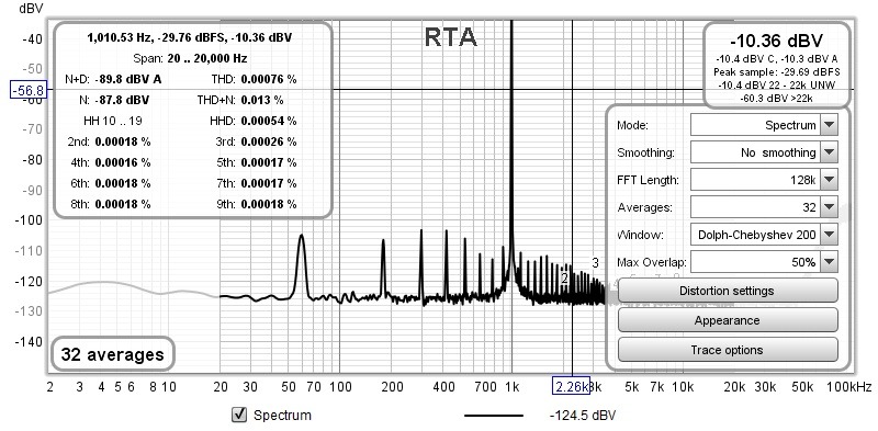

Thank you RickRay.
Providing I understand the matter right.
Distorsion below noise @ 1 kHz, 1 W.
Is it possible to measure some difficult signals, like 220 Hz + 1 kHz @ 100 W ?
Maybe if I get my measurement system sorted out. As you can see the 60Hz line is emphasised and all the odd harmonics to go with it. I'm 99% positive this is not the amp, it is my measurment system. I need to fix that before I post anything on here. Compare my harmonic numbers and distribution with fireanimals review in post #1 and they are very close, but he has none of the 60Hz with odd fundamnetals.
Anyone. I have the negative rail floating right now. Is it possible that the 60Hz and odd harmonics are a result of that zero volt rail floating? I will test myself when I get time running a wire from the zero rail to earth ground.
