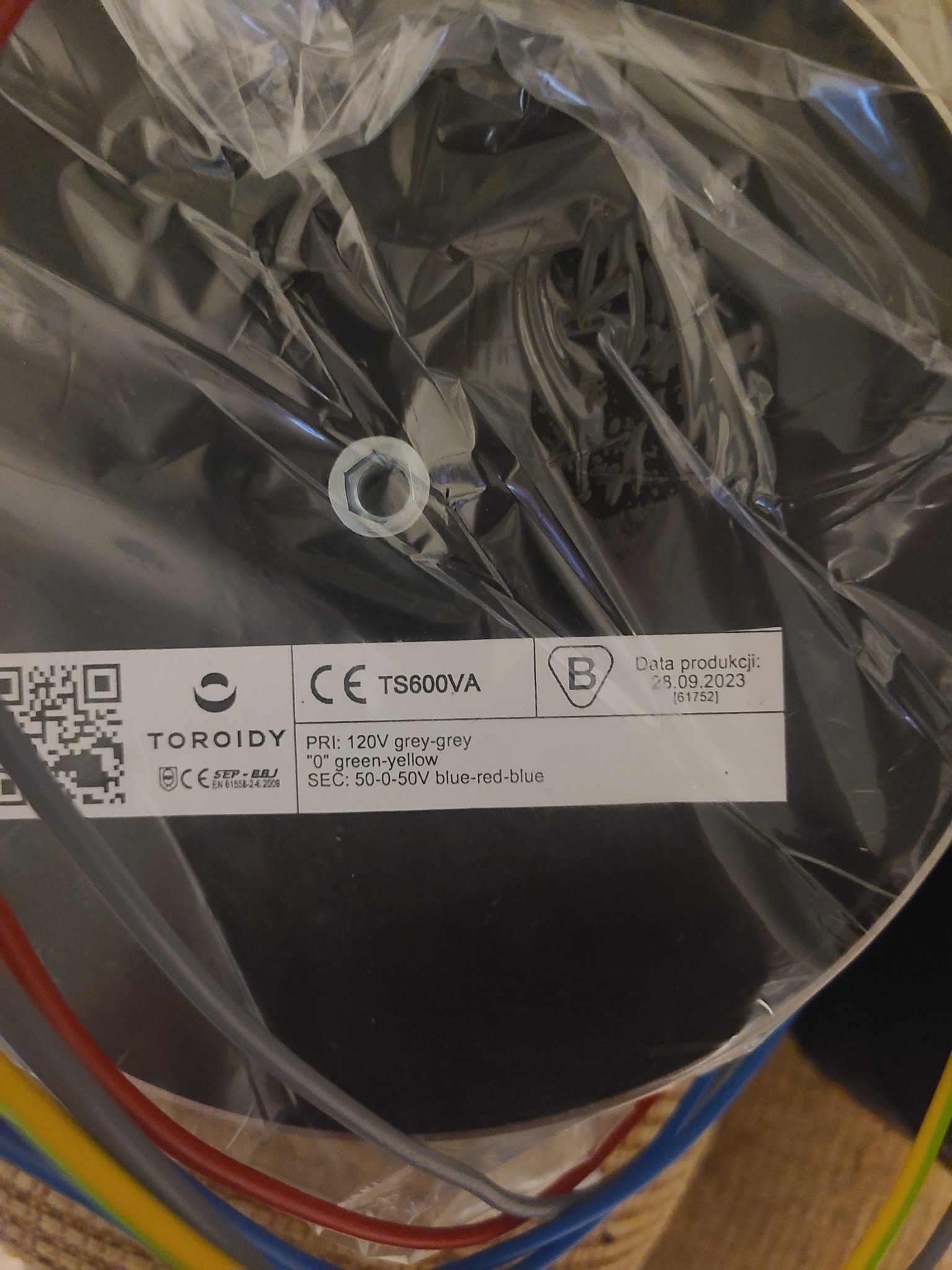

yes you would use the red, black, green wires on the output
44.6 - 0 - 44.6 will give you approximately 63 - 0 - 63 volts dc rails.
The orange and blue would be to high 56 x sqrt. 2 = ~79v
Thank you. Love it when its straight off from you. I will check for the group order link. So I should select - EF3-4 (4 Pairs of Output Transistors) - V4.0 (2nd Group Buy)?
Am not able to quote mhuth1776. Will look into it. I am planning to use two transformers as I have two of them. Should I still consider the different wiring.

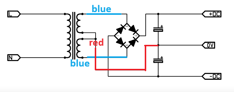

@kiran1103 Do keep in mind that your transformer appears to have a single secondary that is center tapped. That means a bit different wiring for the power supply with a single bridge rectifier at double the PIV spec.
Agreed, that's a centre tap isn't the most optimal but if you already have them then you can consider your options. Sorry I should have mentioned it. I assumed that you just wanted to know if you could make them work. Thanks @mhuth1776 for adding to my post 🙏

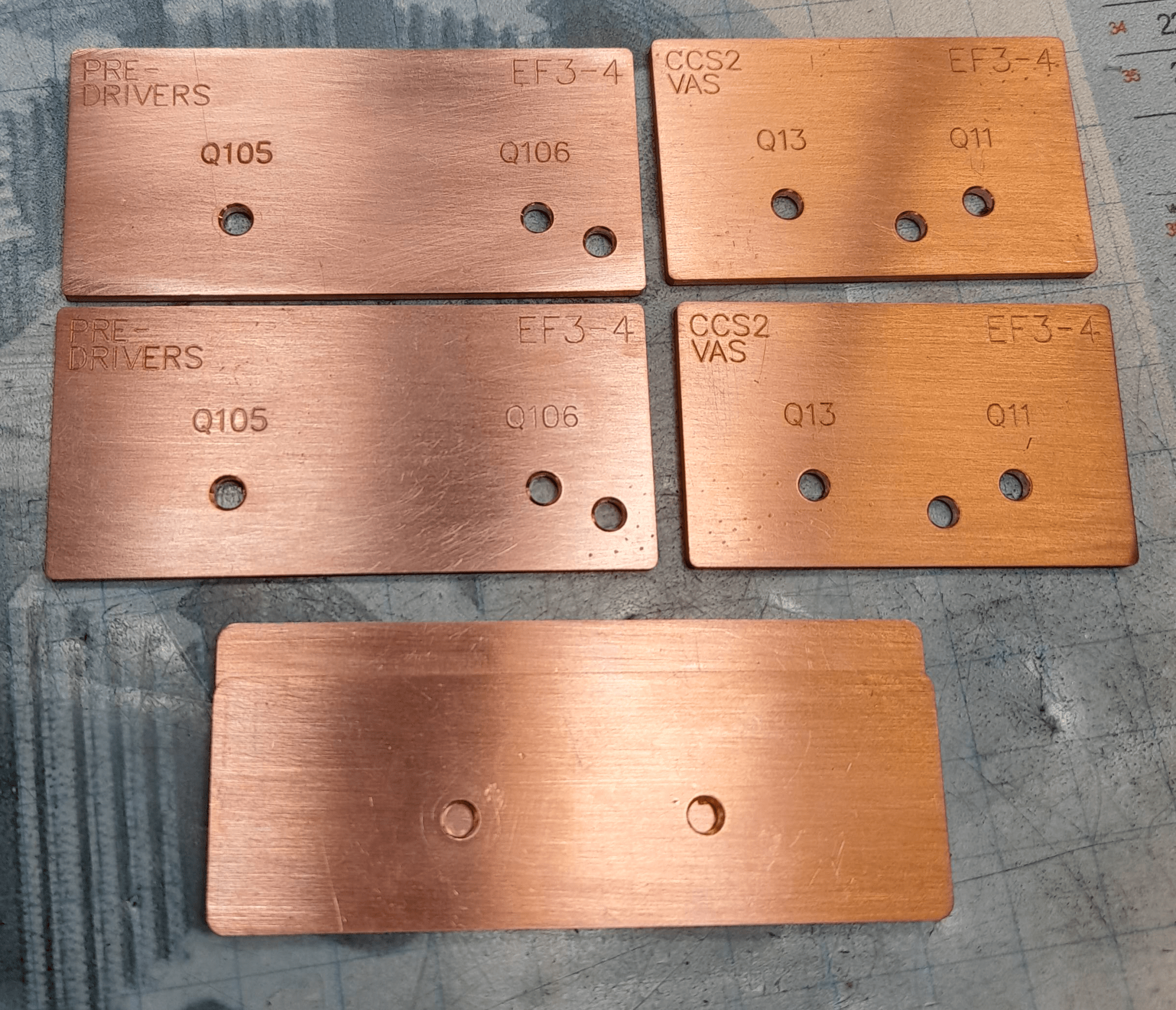

I made some copper heat sinks for the Wolverine today. Also two for the Honey badger. They are cut with a wire edm from a copper sheet and then drilled and engraved in the mill. Just need to spend some time on the surface finish.

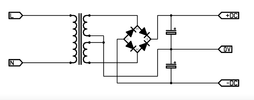

yeah, not end of the world, you need to use this power supply topology with a centre tapped secondary.

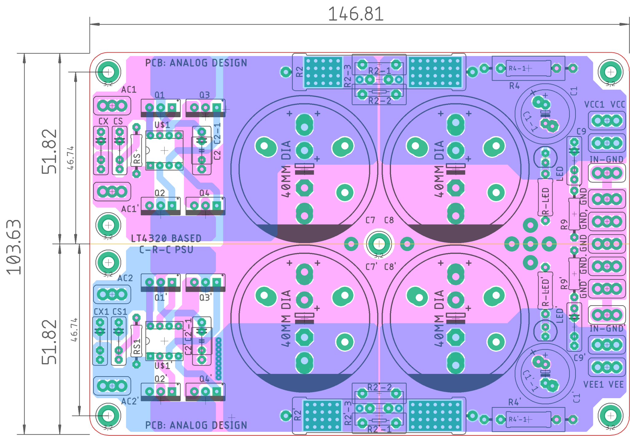

You'll need a 35A bridge rectifier, PTP wired from the tx secondaries. Not sure what Smoothing Cap PCB there are available for single bridge PSU topology, any recommendations guys?
