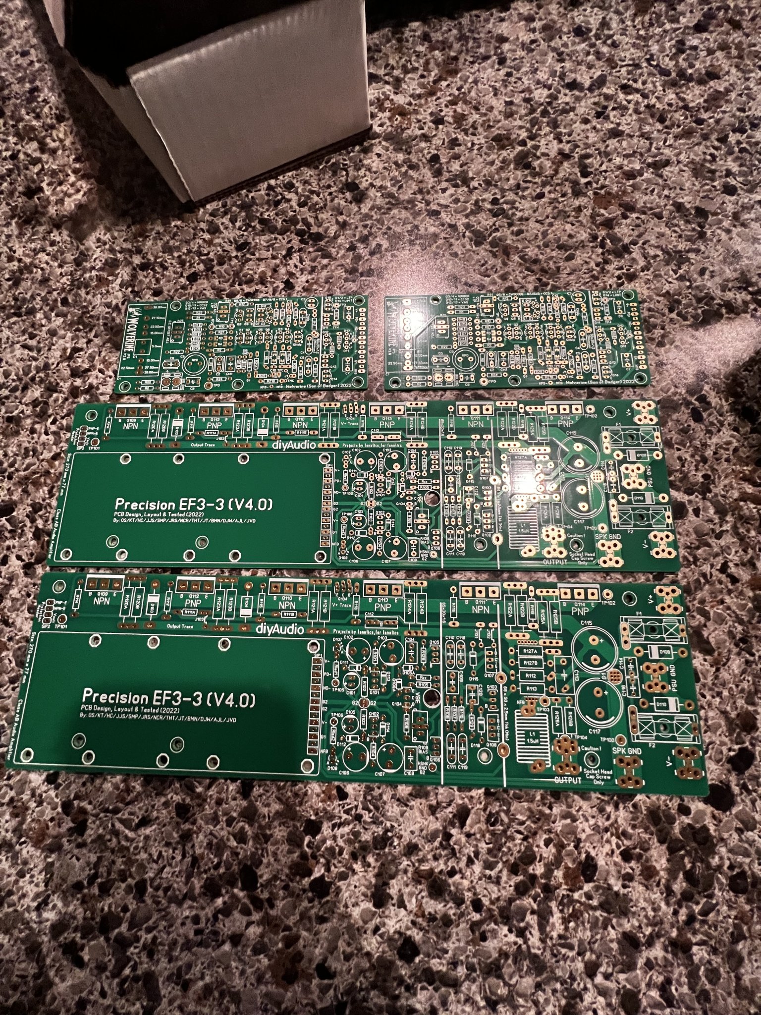

Got these bad boys today! They look awesome!
Thanks to @ostripper @stuartmp @fireanimal
Not gonna lie. I am extremely intimidated by these boards. I have some homework to get the BOM just right on these. Thanks again!

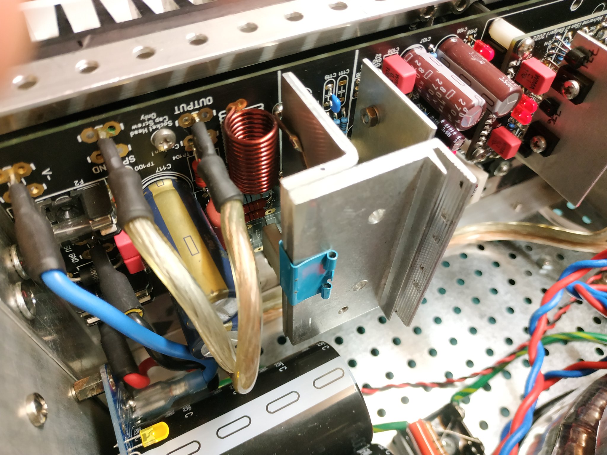

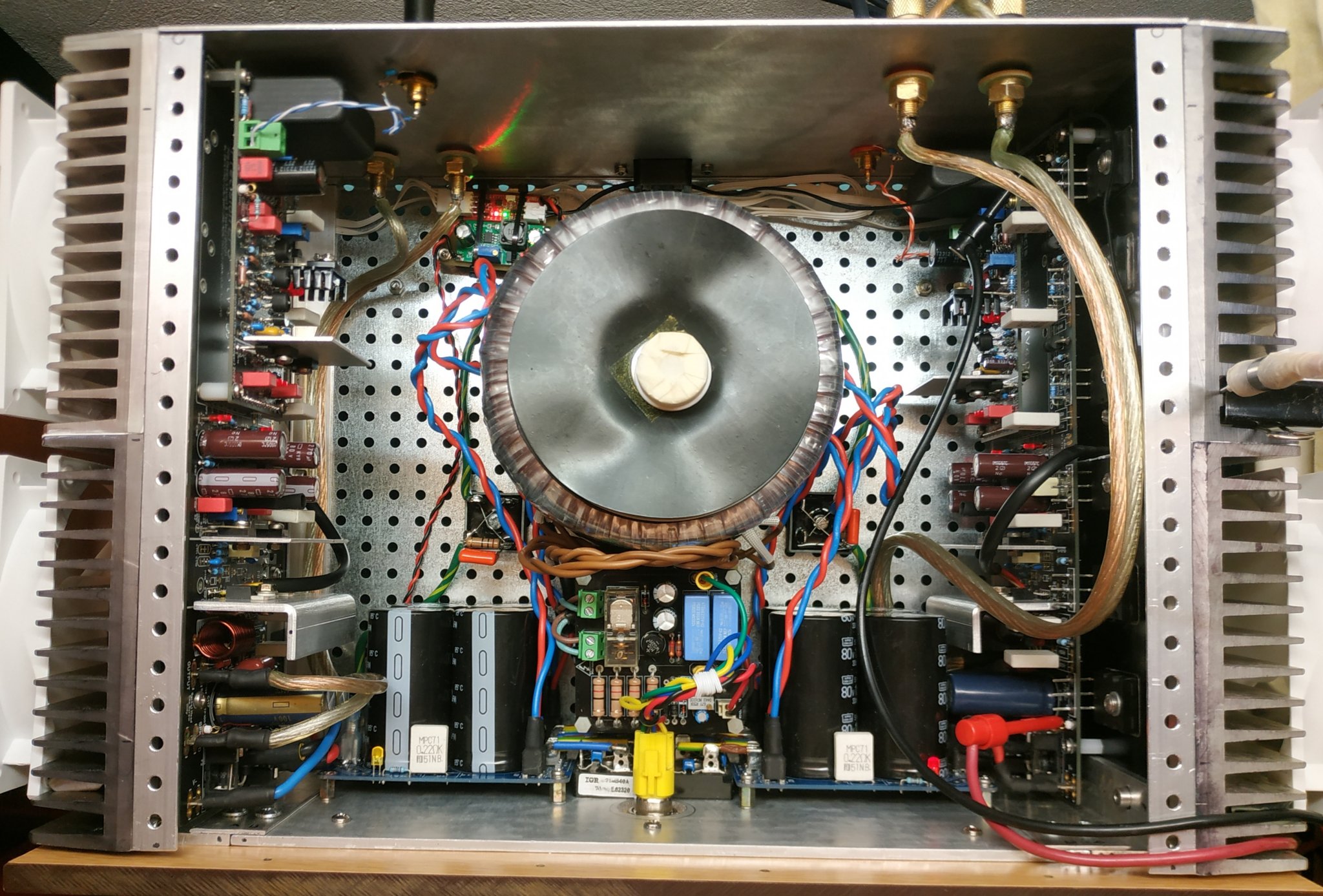

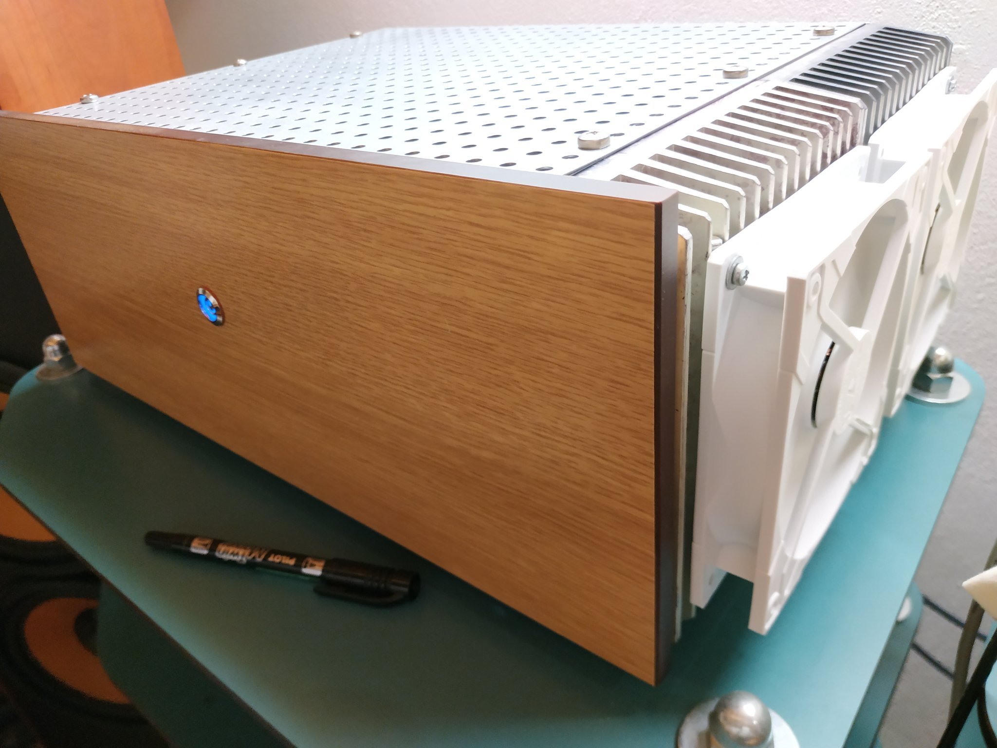

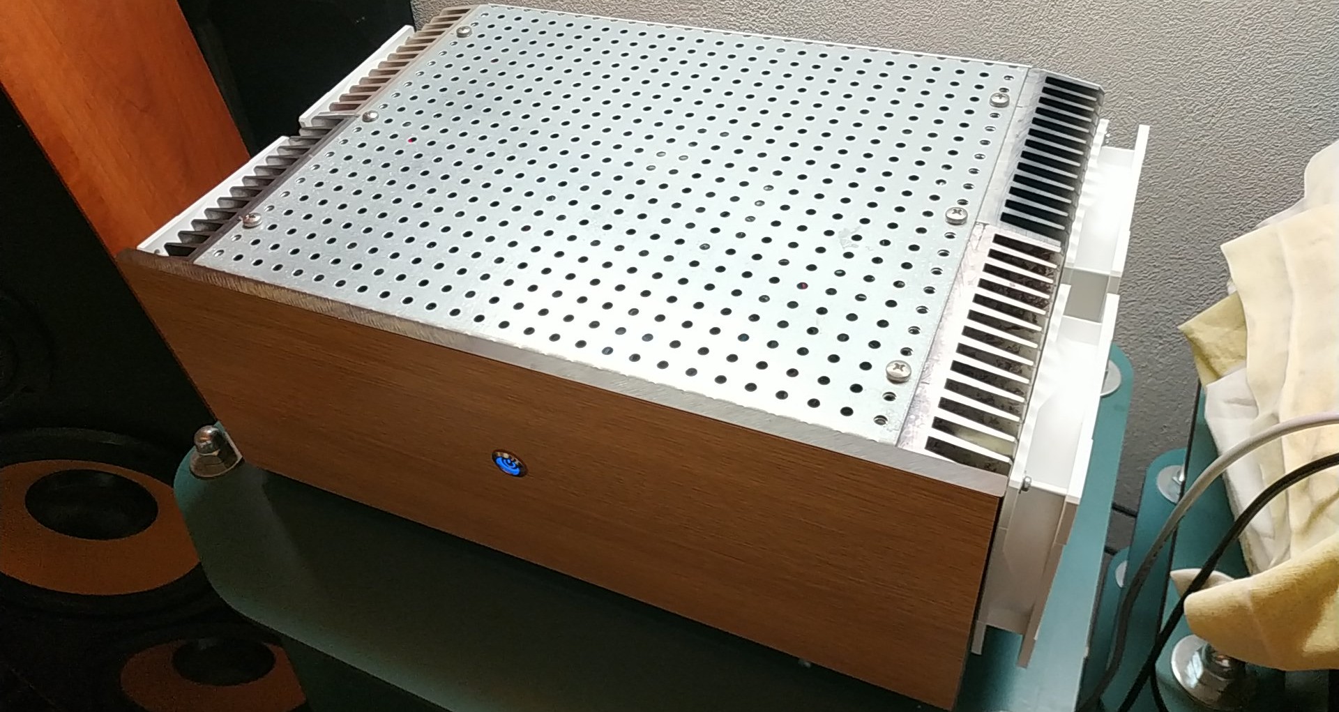

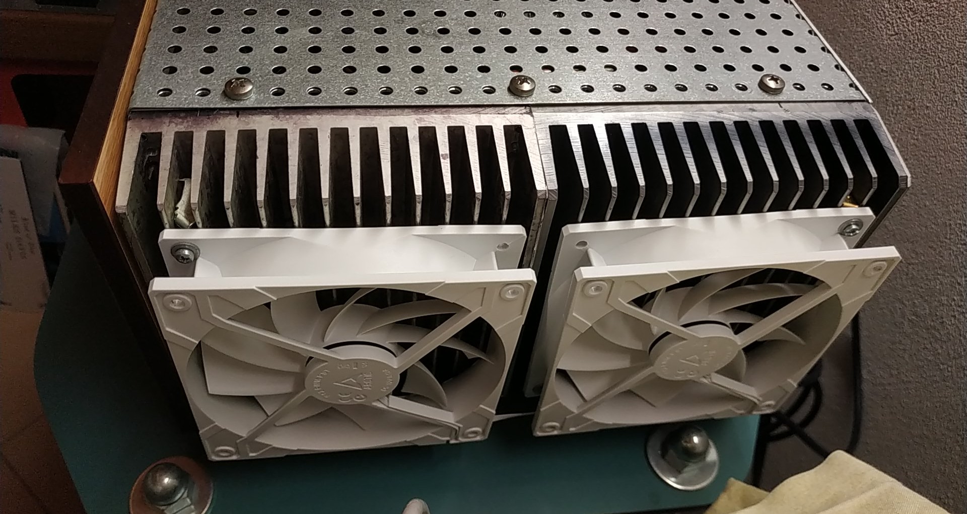

Amplifier drone hahaha ...like he said my friend Thimios
The third image is out of the amplifier's manufacturing specifications ( extra heatsink)......it is from my measurements....
Τhe amplifier every day now plays music very loud without protections (I take my risks) But his measurements have made me trust him from the beginning.
