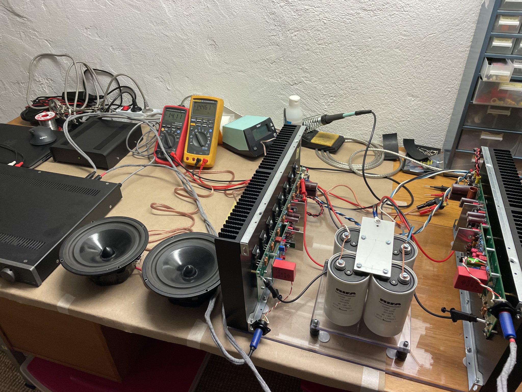

It’s alive😁🎶
Thanks for all your excellent support🙏

@deerhunt congrats with the build. And now that we been talking about e.caps a few posts back I must say that those RIFA's are about as good as it gets. Just sold two last week I had in my leftovers, exactly the same value as yours. Very high quality(!), not to mention the pricetag on those now sold as KEMET PEH200!!!!! Auchh 😀
Reactions: deerhunt
@deerhunt Congrats! Might I recommend some Noalox with the connections to the aluminum plate (I assume it's aluminum). Aluminum oxidizes, and the oxide is not a good conductor. Many a mobile home has met its demise from aluminum conductors and screw terminals. The connections to the plates can carry high currents.
I think copper plate would be a better choice.
@hcpower Yes, those Rifa are nice. Actually leftover from earlier projects where they didn’t fit in the box. Looking at production year I think they are from 2007. Not so expensive then😊
Started them softly and they seem to format, keeping voltage very good now!
@mhuth1776 I agree, should use pure copper instead. Noticed that the aluminium was not conducting well. Perhaps oxidation or a thin layer of lacquer. I have to give it some sanding before use.
Reactions: hcpower
