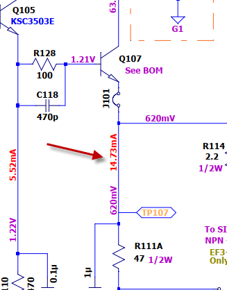

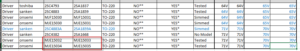

Is there any advantage using the 15032/33 instead of the 15034/35 in the Wolverine?
The 2nd sheet of the BOM should guide you well in Driver selection.
If your trying to fine tune your selection you can look at the following points.
Things like the maximum Collector−Emitter Voltages (VCEO) have been worked out for you. So don't worry to much about that.

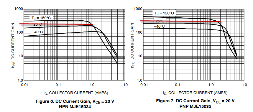

HFE or current gain plots.
Try and select the transistor with the flattest gain in the region in which it will operate.

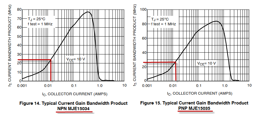

Unfortunately there are no plots for fT Vs Ic or Cob graphs for the MJE15032/MJE15033 devices.
We did test successfully them along with the MJE15034/MJE15035 devices which do have fT Vs Ic plot.
In general the higher the FT frequency the better the device will preform as it will be faster. Just check the FT isn't to low at your given bias.
this can lead to instability.
In general, a lower COB is desirable because it leads to a more efficient, quicker responding transistor. A lower COB allows the transistor to switch faster. Capacitance causes a delay in the switching response due to the time it takes to charge and discharge. COB is the capacitance between the collector and base of the transistor. Having a lower COB increases the bandwidth of the transistor. which is a good thing 🙂
The Ft parameter stands for the unity-gain frequency or transition frequency. It is a key specification that indicates the maximum frequency at which the transistor can amplify signals without significant distortion. The Ft value represents the frequency at which the current gain of the transistor starts to decrease. At frequencies above Ft, the current gain decreases, leading to reduced performance. So in general the higher Ft parameter the better. If we look at the Bias current for the Drivers you will see ~15mA

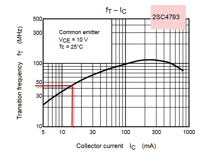

Now compare the above MJE15032/MJE15033 devices to the 2SC4793. As you can see the 2SC4793 has a higher Ft frequency.
The Ft parameter indirectly impacts the phase and gain margins of the amplifier through its influence on the frequency
response of the transistors. Here is a brief video explanation if you haven't heard the terms phase and gain margins.

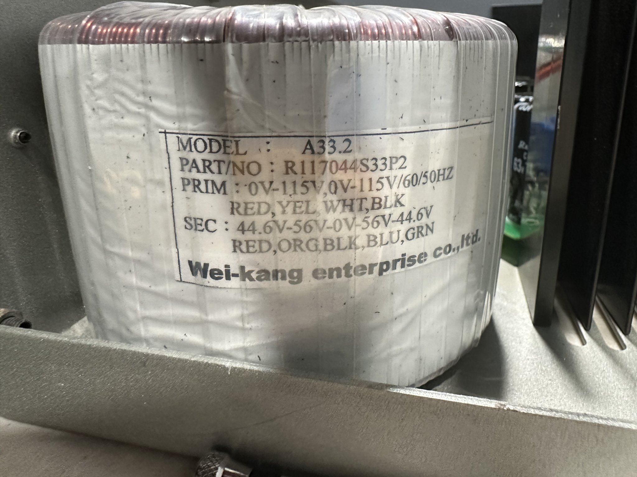

I am wondering if this transformer would be ideal for a dual mono amp.I have two of them. If you can then suggest which version of boards to use. The Primare A33.2 broken so I can reuse the case and transformers.
