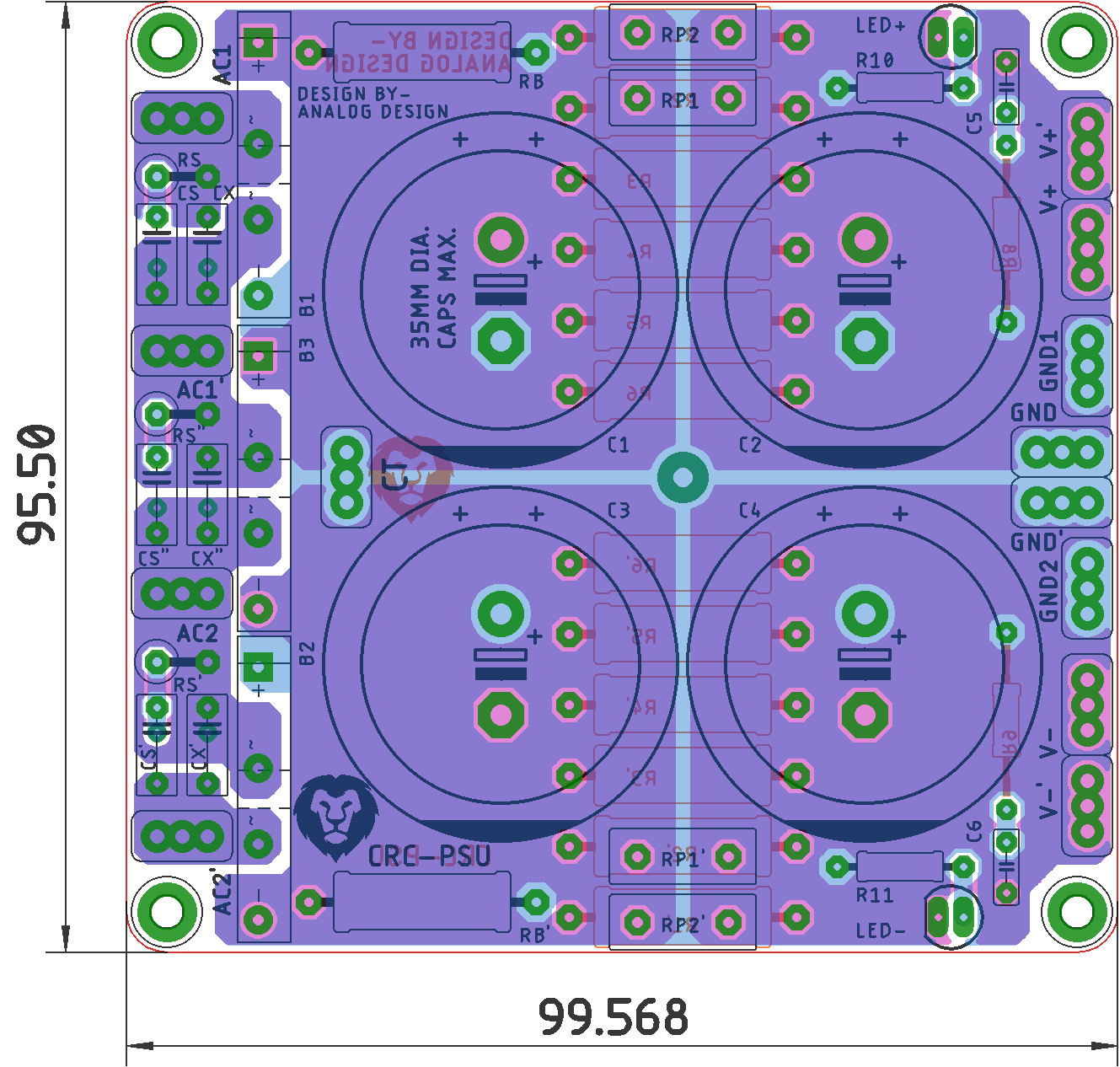

I have this board, or you can find it in the 100W amp thread on this forum. It allows you to use Dual or Center-tapped secondaries. I have a few left from a previous order, if you want one to try out, PM me.
Am not able to quote mhuth1776. Will look into it. I am planning to use two transformers as I have two of them. Should I still consider the different wiring.
I assume that you will use one transformer per channel, in which case both of the rectifier circuits will be of the single rectifier, center tap ground type. Sorry this took a while to get back to you. I've been having cataract surgery and can just today see the computer well.

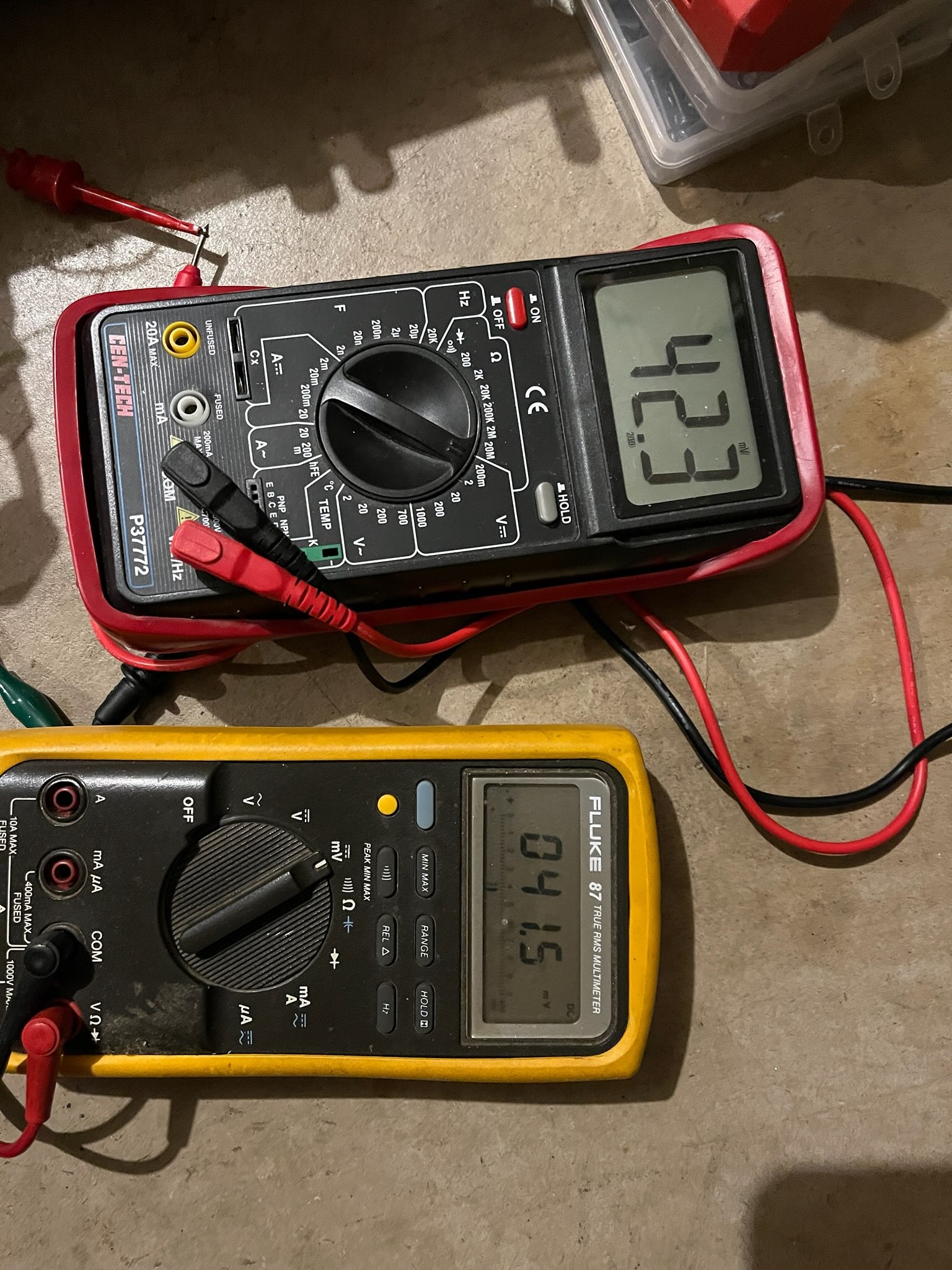

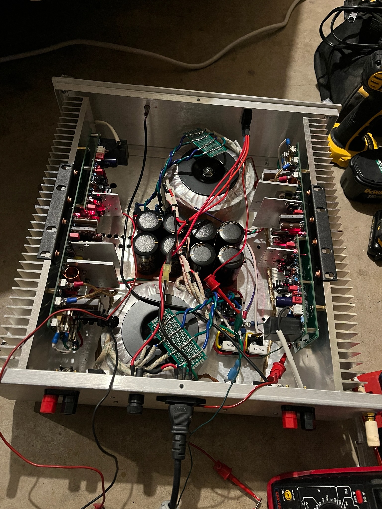

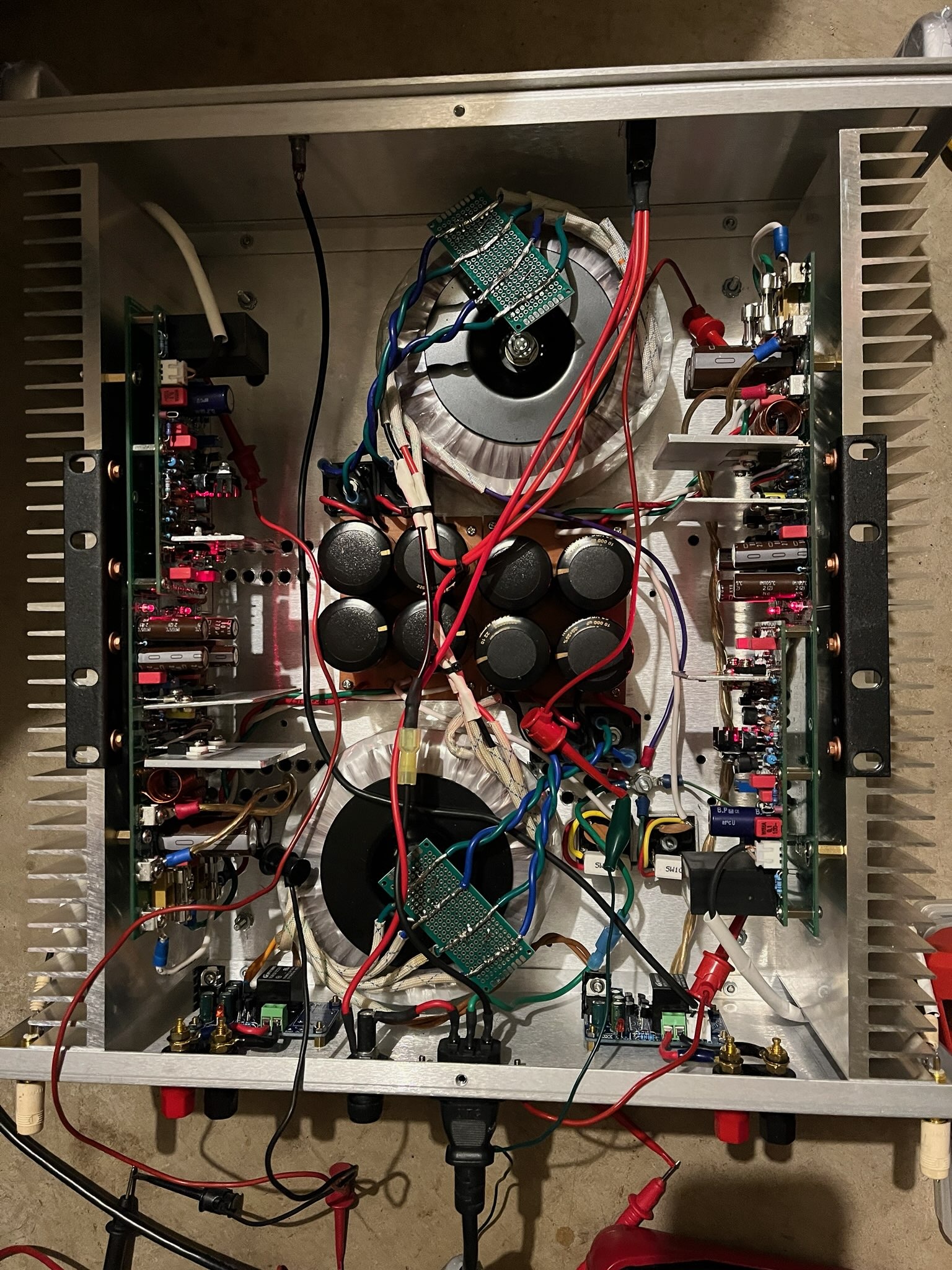

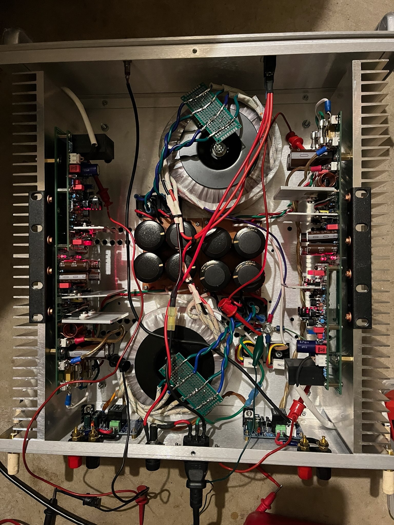

Finished Amp... It is very quiet and sound great.
I used MJL1302AG/3281AG for the finals...
I installed larger heatsinks... 4.75 in x 14.56 in.
DC offset = 0.00
ripple on speaker outputs = 1mv
TP1 TP2 = 5.00v
After letting sit at idle (over an hour) with bias set to about 40 to 45mV, the heatsinks temps were about 80 deg F.
When I put the cover on the chassis, the bias voltage went down to about 30mV.
So if I understand correctly, with the cover on, I adjusted bias back to 44mV.
With it set like this and I remove the cover, the bias starts going up to about 55 to 60mV.
Is this OK?
