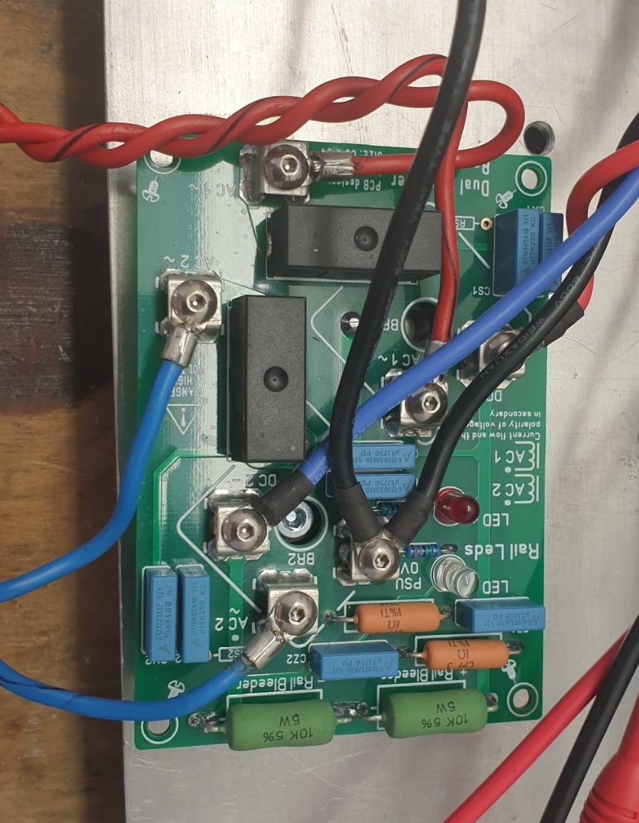

Just a tip regarding the green pcbs on top of the transformers,
It might be worth replacing them with insulated terminal blocks which are mounted to the chassis
Just for safety reasons. Or join>solder>heatshrink them
Just don't want you to inadvertently get a shock
- Dan

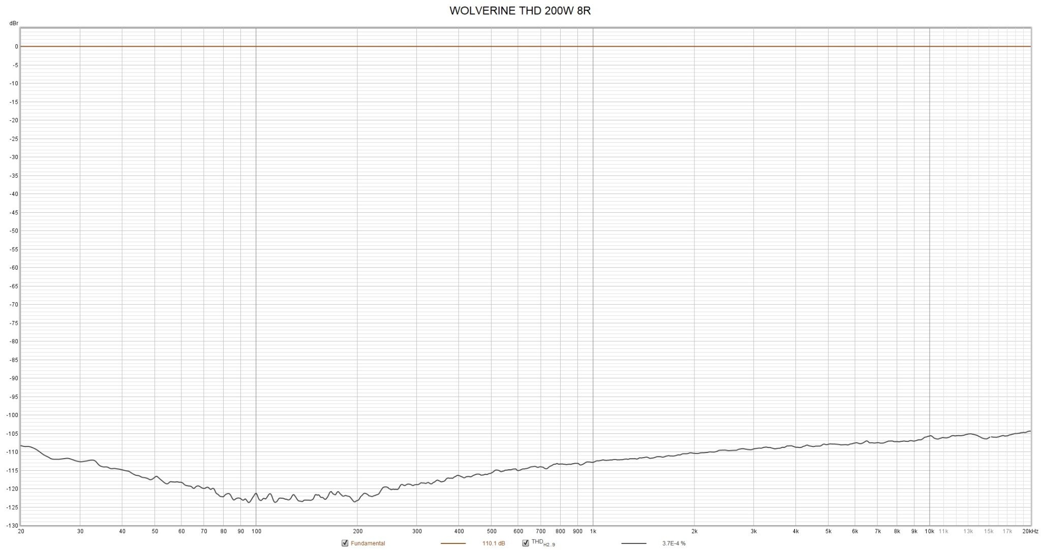

Here's a high-power sweep if anyone's interested. Again measurement setup laptop - E30 - wolverine - E1DA ADC
Q101, 102, 105, 106 - KSC D-grade straight from the BOM / KSA 'E' grade
Drivers - 4883A/1859A
Outputs - 2SC2292/2SC1216
Rails - 71V
Below is at 200W/40V into 8R. Again - nothing matched, not even close, except Q1/2/3/4, as per the build guide.
Crazy. Onset of clipping measured at 43.8V.
- Dan
THX Dan... Those are the snubber circuits. I read that it's best to get them as close to the secondary windings as possible and the wire going to the boards are very stiff at this point. They do not move. It's only 40-0-40 ac and fused so it won't hurt to bad!!
Reactions: jdoorn
That whole thing is a house fire waiting to happen, do yourself and your family a favor and clean it up, including the non rated speaker wire you used. All chassis wiring should be voltage rated. The amp is just plain and simple not safe.
Ok, I will cover the snubber boards, I agree... I'm using 14g oxygen free copper speaker wire, what should I be using? And all the wiring used for the power supplies are from the toroid's excess wire. So I'm not sure what you mean about voltage rated.

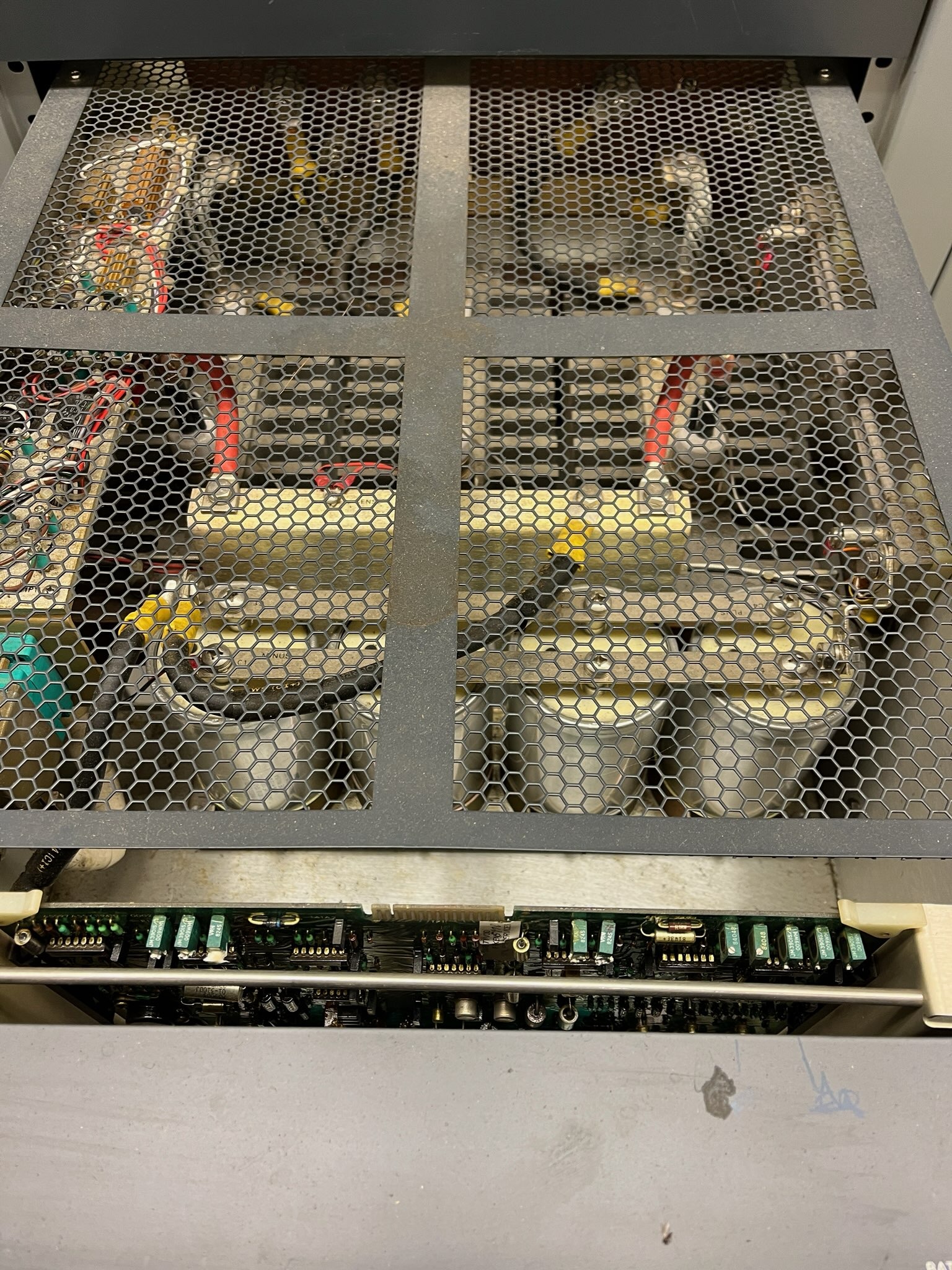

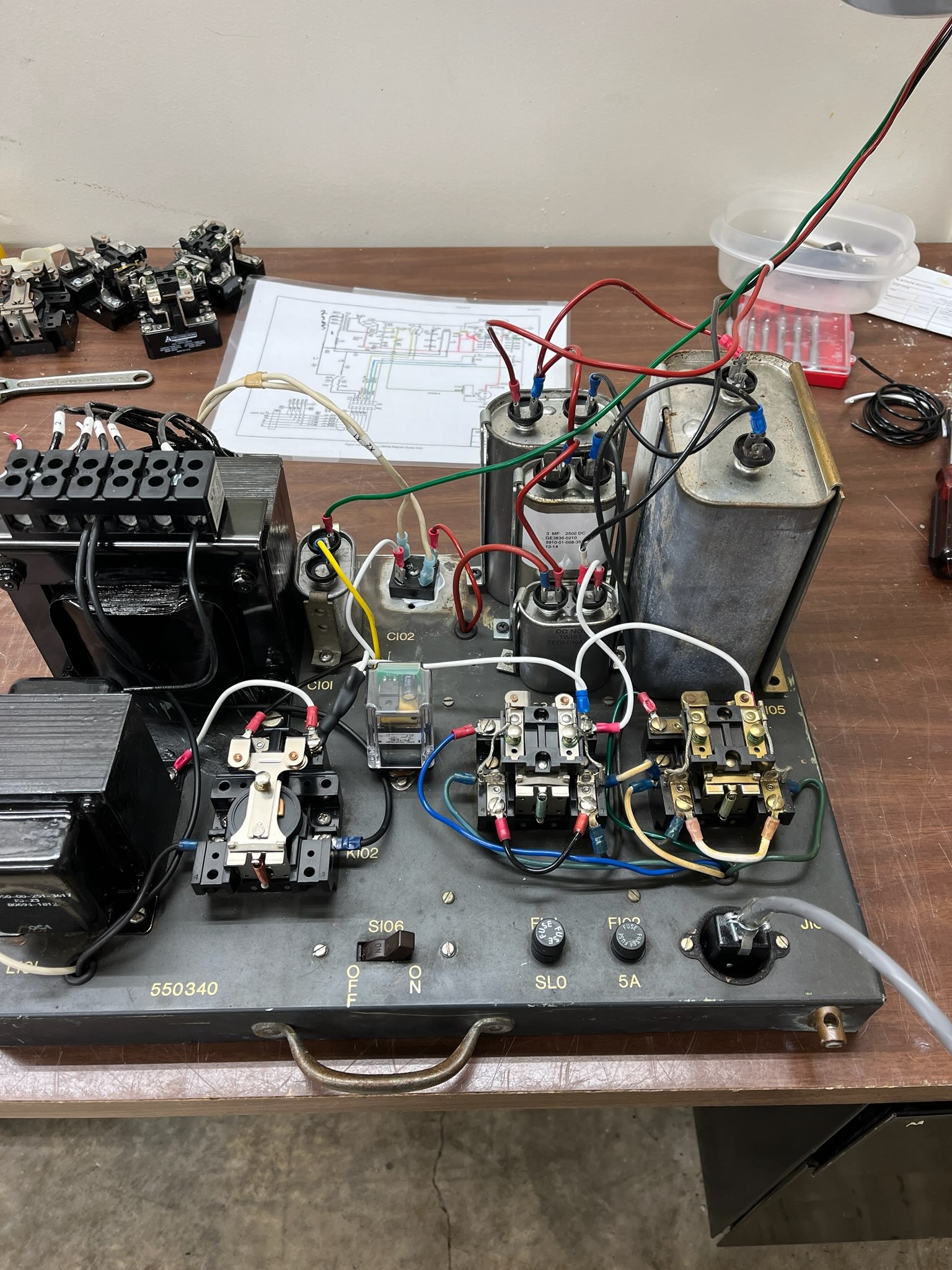

I do know a little about high current/voltage power supplies as I maintain a lot of equipment at my job so please explain.

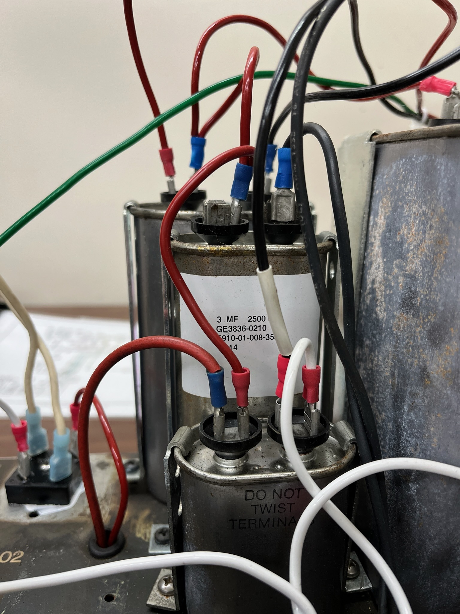

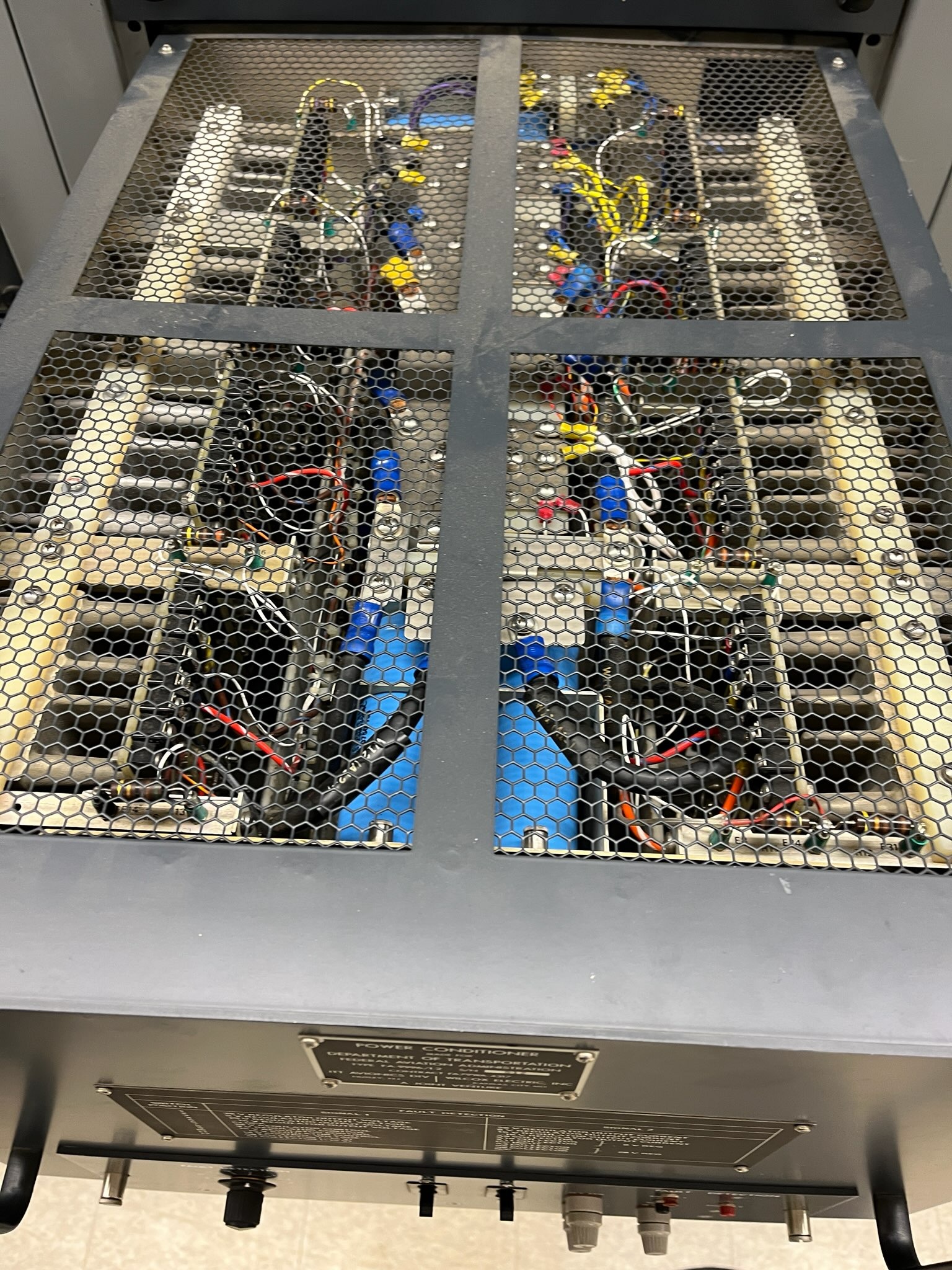

Some pics attached on some stuff I work on...
Scott
The insulator that covers the wire needs to be made out of an approved material to prevent or be highly resistant to fire.
One suggestion is good quality silicone wire. Its also way more flexible then toroidal transformer wire, which is usually quite stiff.
Please consider this for all your non rated wire. Amp wire
I've used it many times and its very good quality.
Please watch again the YouTube video on how to wire your amplifier there are may tips there. Wiring your amplifier.
That wiring that you have on the Perf board is not suitable for high voltage the outer rings of the pads are two close together to be save. You could get the voltage jumping across those pads. Maybe not now but in future as dust and other contaminants build up. Also those pcbs are certainly not design for the currents that are flowing through them.
We all want each other to be safe and what you have isn't, please don't take this as criticism think of it as an opportunity to improve and develop a better method to wire your amplifier.

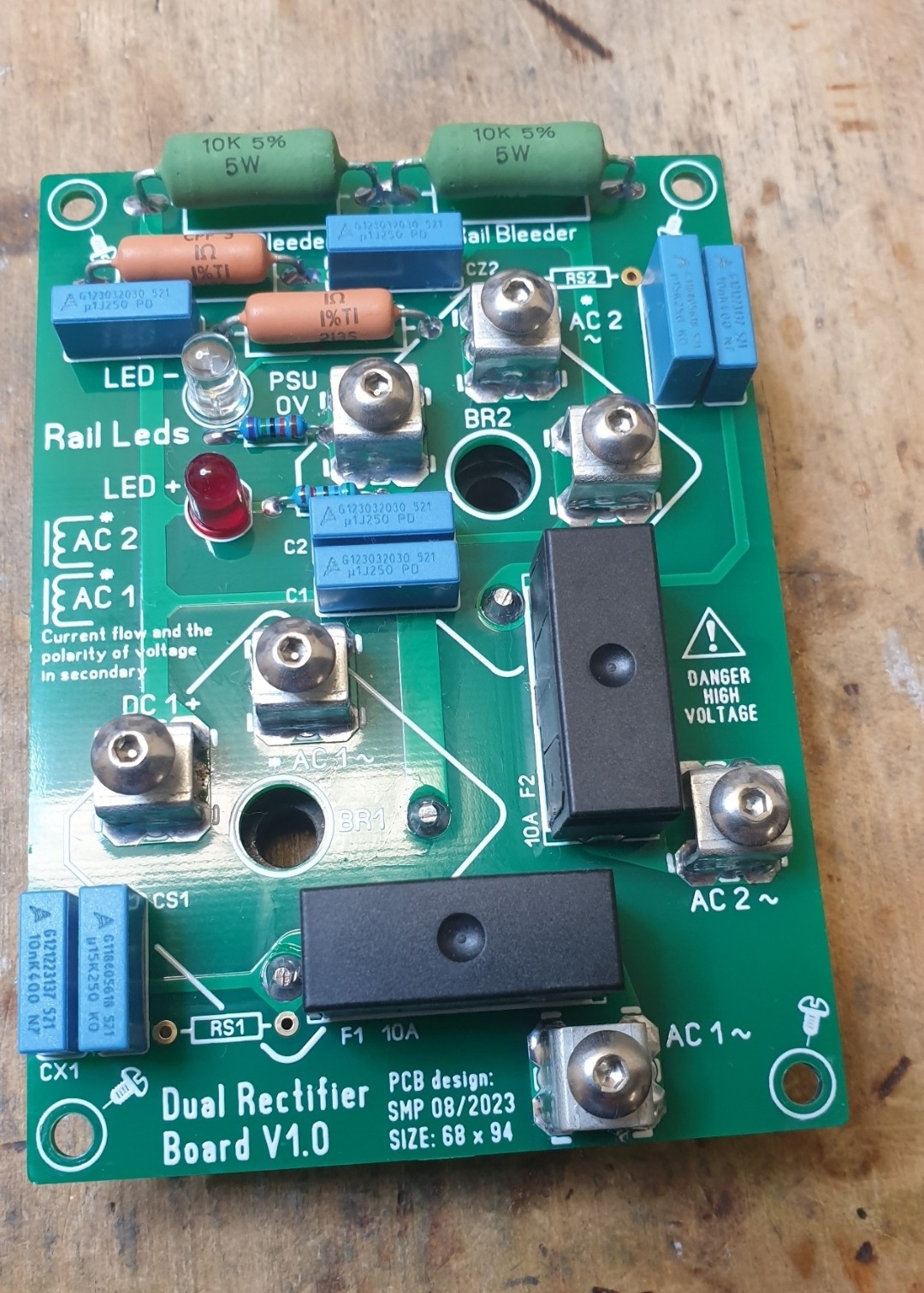

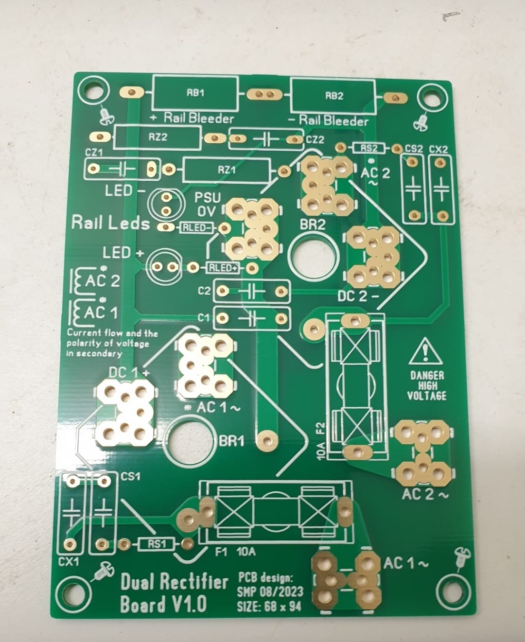

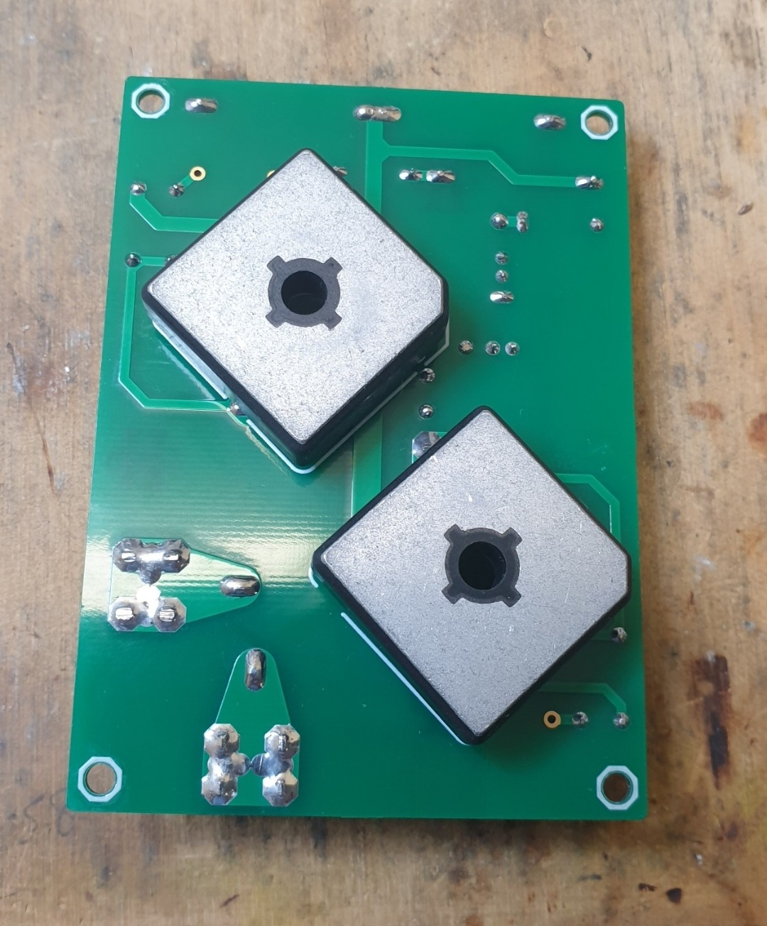

Should I remove the snubbers all together
If you're talking about the components used in the quasimodo
Rs, Cs & Cp they can get solder directly to your bridge rectifier or to whatever rectifier pcb your using.
From memory I believe @danieljw may have shown this in his video.
Or you can make up a basic pcb that the components solder to and mounts the rectifier.
I'll attach an example of the one I did.
