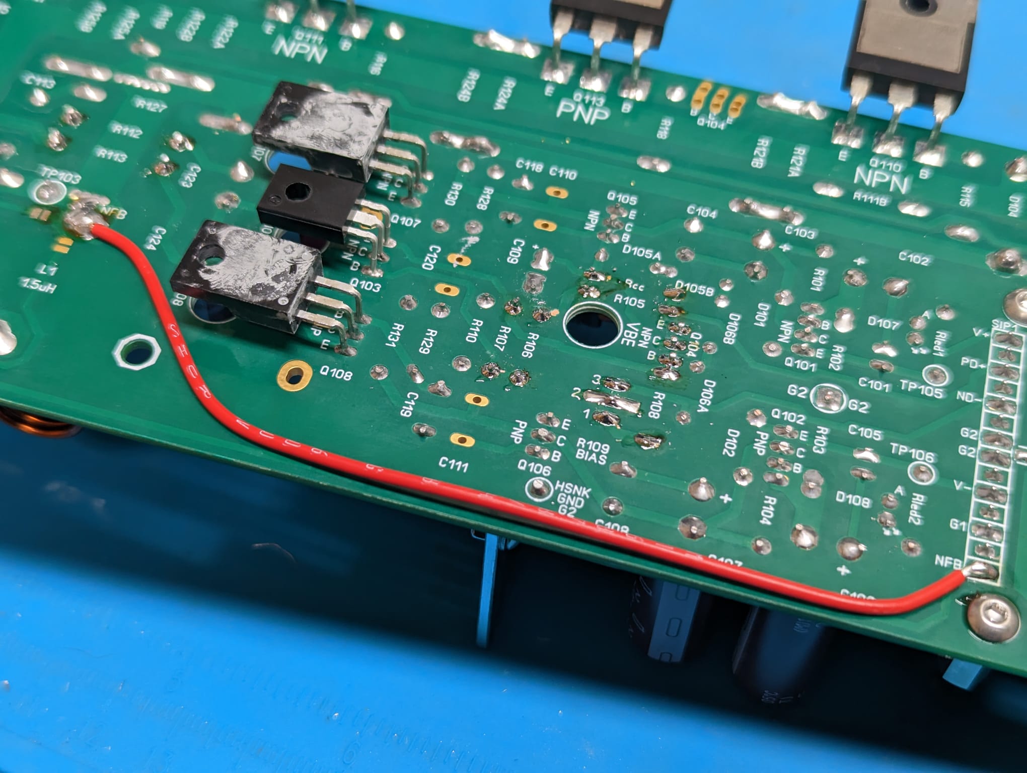

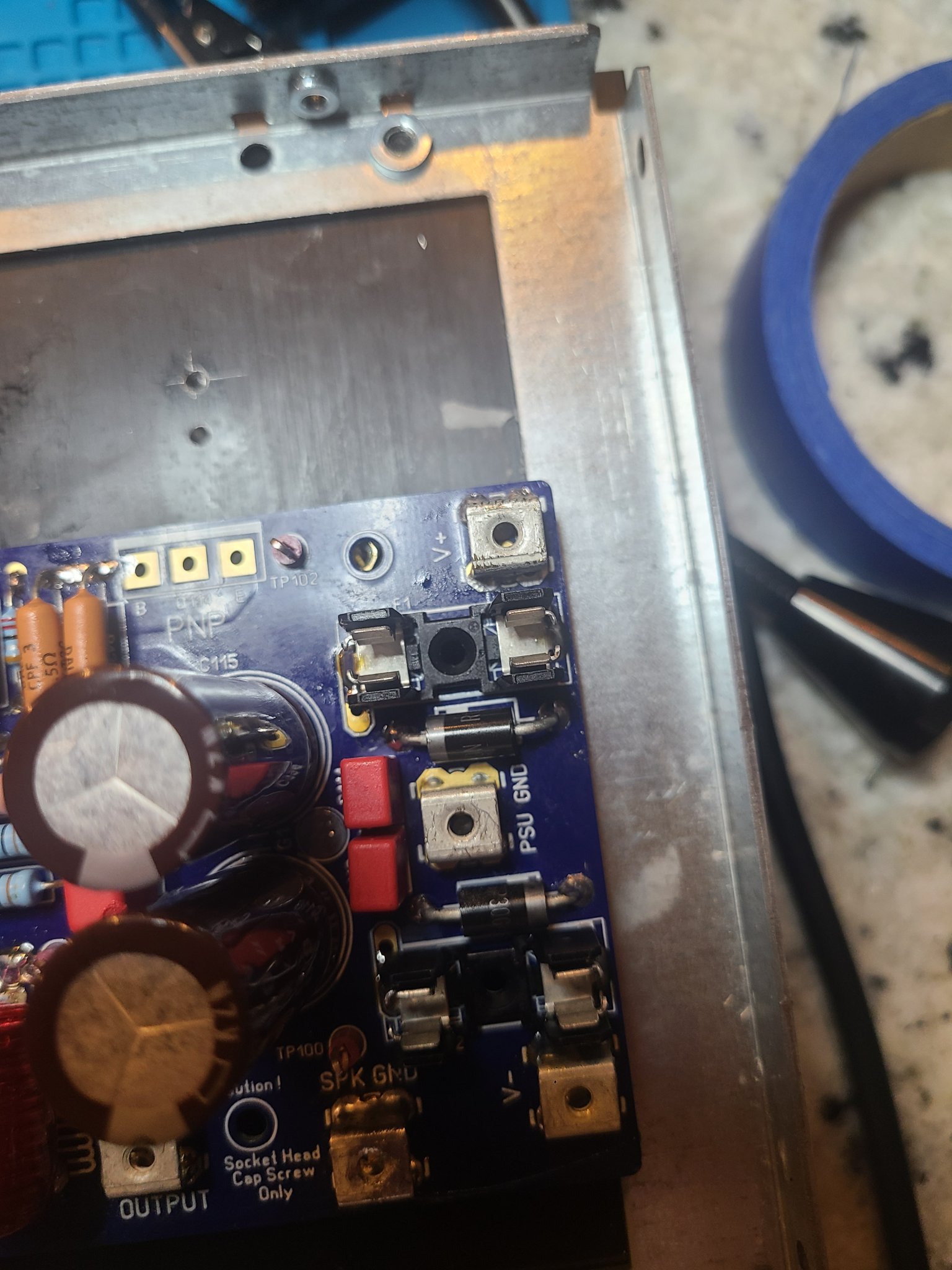

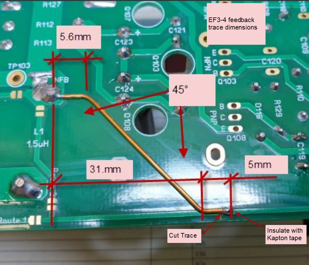

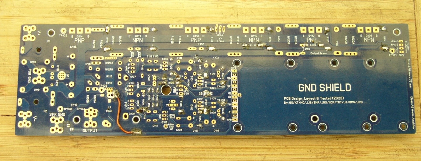

1. following one of the suggestions mentioned in this thread I created the shortcut as shown on the attached photo (it's FF3-3 ver 3.9 board). It links IPS nfb with the input of the OUTPUT coil. Is there anything else I should also do?

1. This is not a shortcut, It was tested to be a the lowest distortion path. It links the output trace (pre inductor) to the inverting input of the differential pair in the input stage via the feedback network. It is not the "input of the OUTPUT coil". You may want to go a bit easier with the solder and the flux or you may develop creepage issues around your transistor legs.1. following one of the suggestions mentioned in this thread I created the shortcut as shown on the attached photo (it's FF3-3 ver 3.9 board). It links IPS nfb with the input of the OUTPUT coil. Is there anything else I should also do?

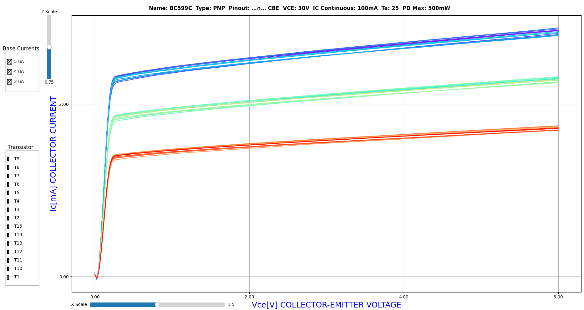

4. For Q1-Q2 I believe 559C is the recommended component. Other transistors were tested and are listed in the BOM as well. We did test a number of other transistors, and not all were included in the BOM for various reasons. Some of the other guys in the Wolverine team may have a better memory than me on this matter and may comment later on this point. There maybe other transistors that will work suitable well but the ones we show in the BOM were shown to be the most compatible across all voltages. They were also listed as highly readily available components.
For what its worth they tested very well. See attached. Some transistor trade noise for gain, so the noise figures may look really good but the gain has dropped off significantly to achieve this.

What I meant was "the shortest path", which it is so one could expect it to be the lowest distortion path. I'll follow your advice and use silver solder here. I use it for soldering semiconductors. Makes a difference.

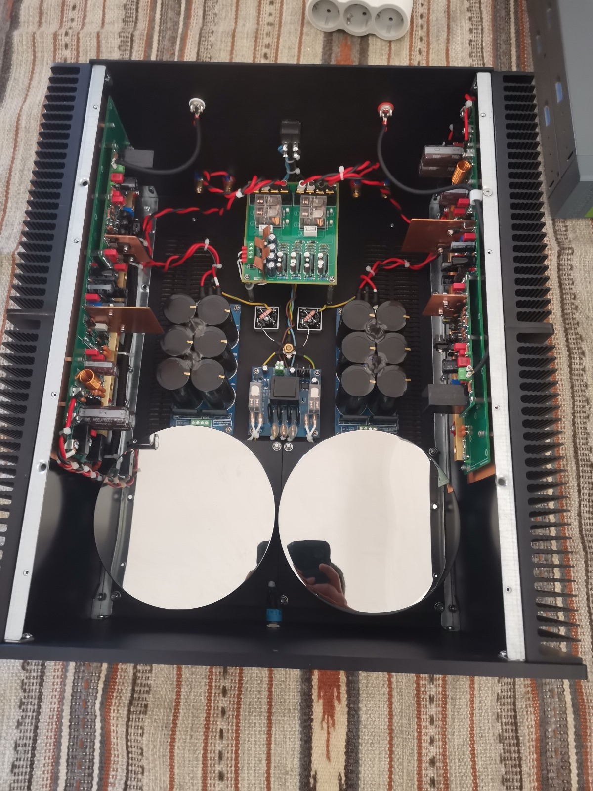

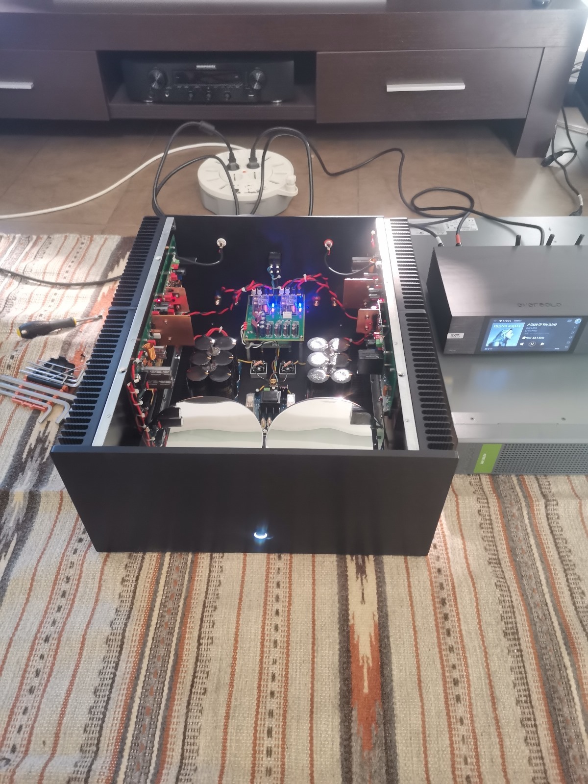

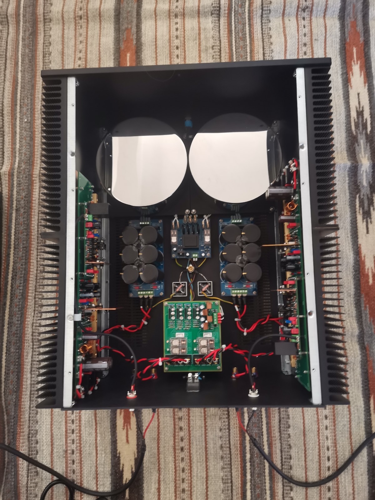

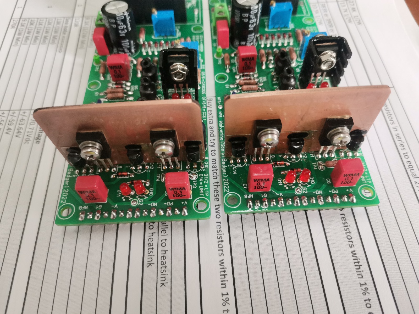

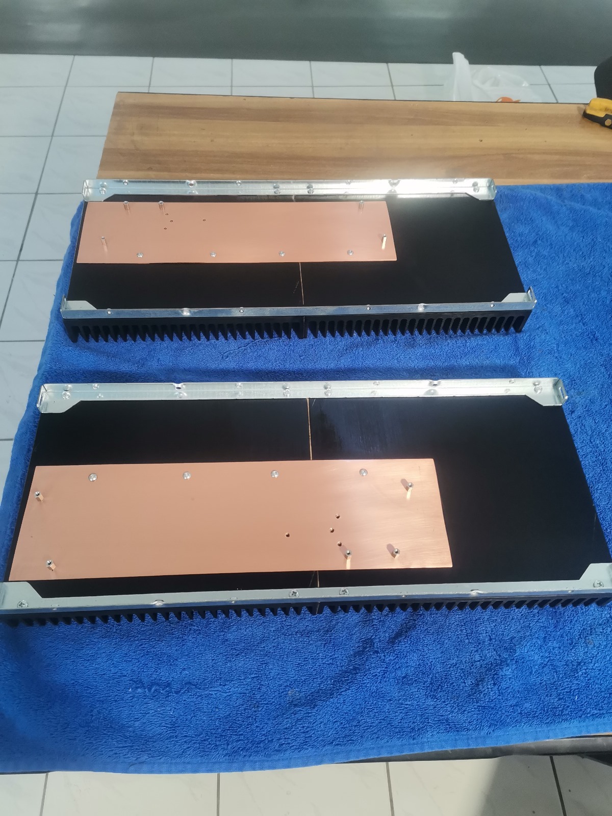

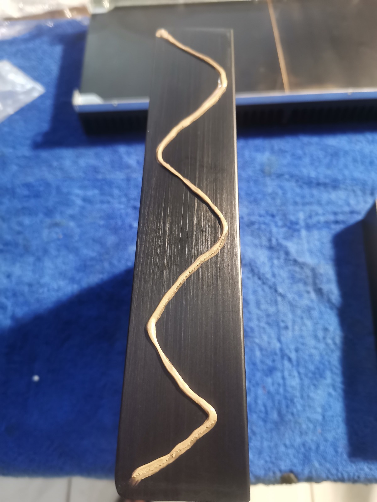

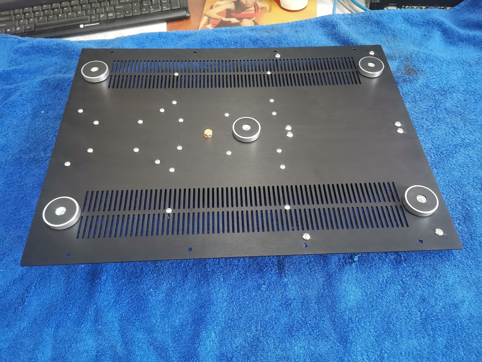

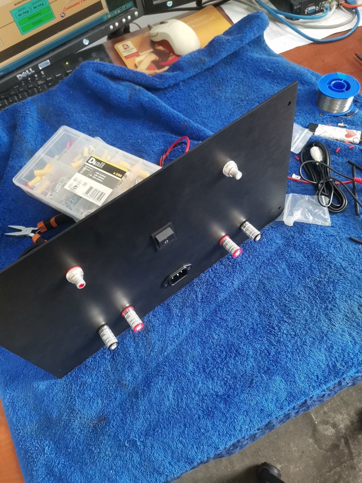

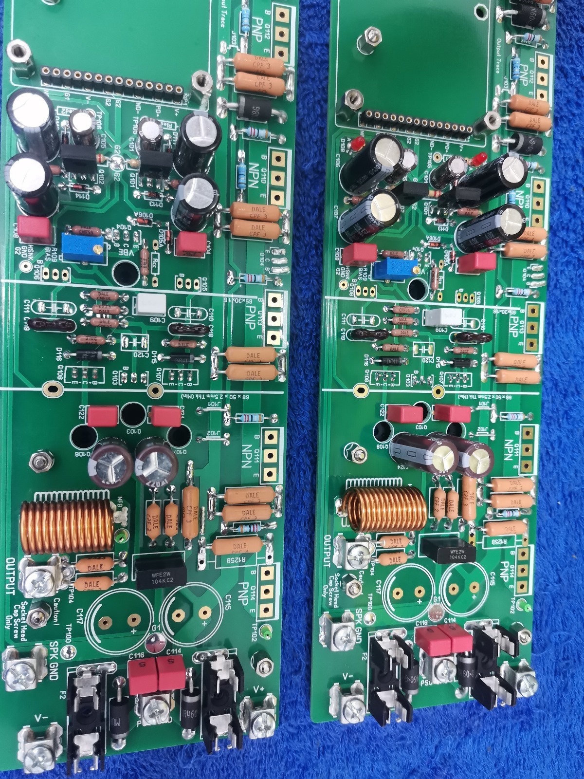

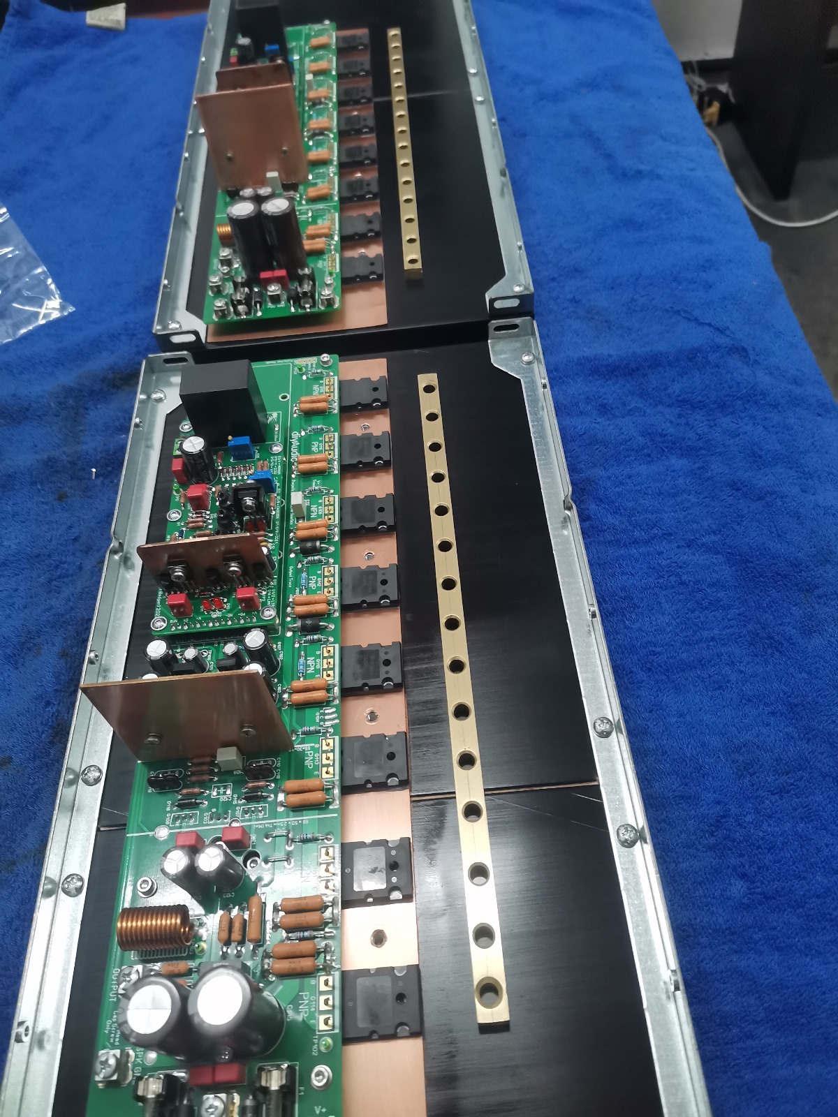

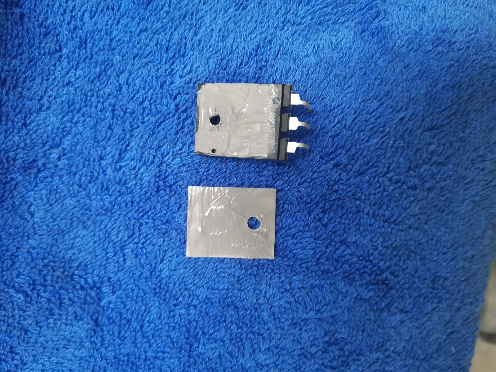

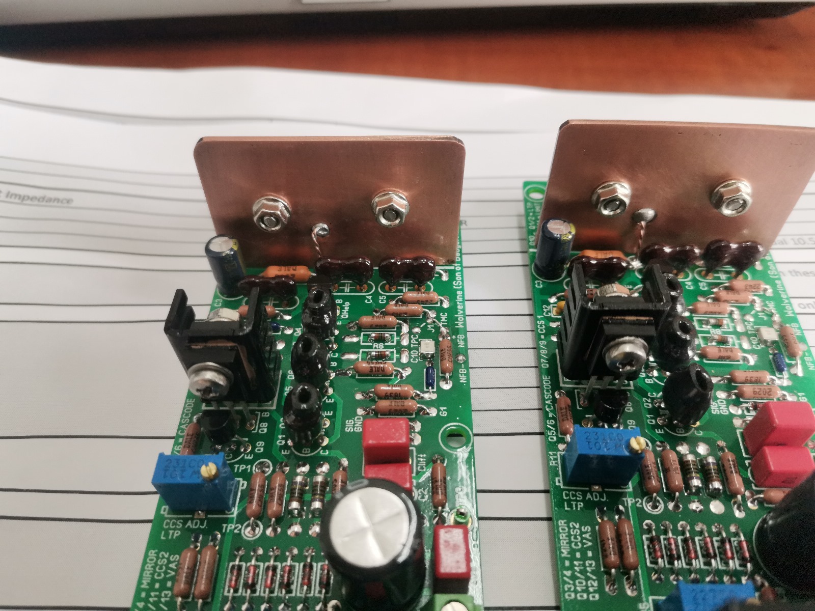

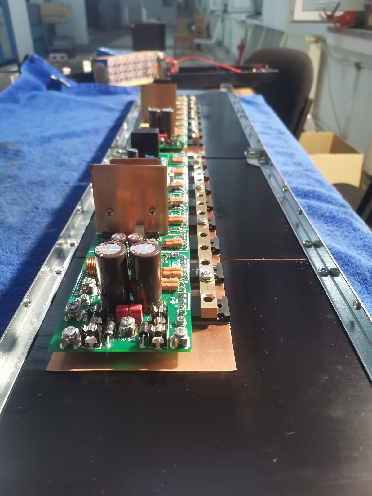

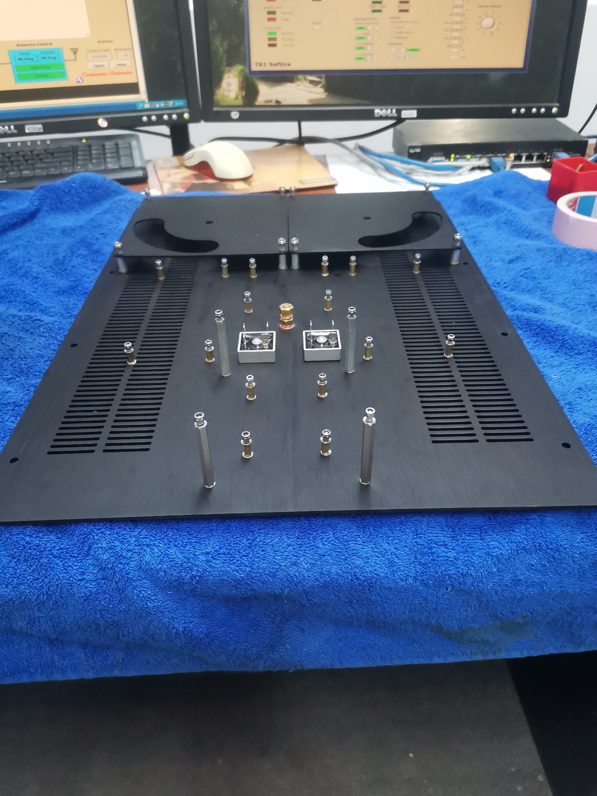

Hello all, after 2 months of work i have finished this project, it whas a lot of work. In the end it whas well worth it, verry nice sound and good performance. Thanks wolverine team.

Is #1, the not short cut, needed on the newer boards(gb2) ?1. This is not a shortcut, It was tested to be a the lowest distortion path. It links the output trace (pre inductor) to the inverting input of the differential pair in the input stage via the feedback network. It is not the "input of the OUTPUT coil". You may want to go a bit easier with the solder and the flux or you may develop creepage issues around your transistor legs.
2. From our testing a wide range of values are acceptable with no clear optimal component so if you have 2.2 or 4.7ohm resistors use them. Basically please just refer to the BOM.
3. The table in the BOM shows the minimum values of C4 & C5 and which transistors need to be modified to run them. Once again, with our testing what we show on the BOM is the recommended minimum values. C4 & C5 among other things control the UGCF (unity gain cross over frequency) of the amplifier. It is possible, and we did test lower values for C4 & C5 which increased the UGCF but to maintain the rest of the stability tests which we developed for the sim & real life testing of the Wolverine this would have required other components to be changed and you sort of end up where you started. So there is nothing to gain by seeking lower compensation values.
5. Nothing has changed your probably comparing different results. One with C4 & C5 at 68pF & 470pf and the other at 56pF & 300pf
6. Please refer to the BOM and build guide for guidance on the maximum acceptable distance between IPS board and the main board. It all depends on the male and female SIP headers you ordered and have installed.
It's not strictly required, but if installed on the 1st or 2nd group buy boards it will improve the already low distortion results.Is #1, the not short cut, needed on the newer boards(gb2) ?

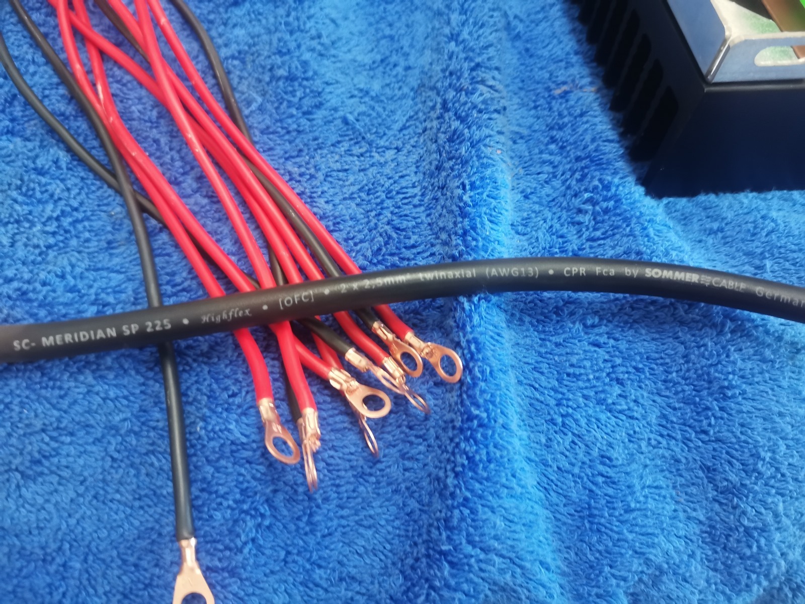

Or make sure all the other scews are loose and then try to line it up. Any time you have a number of screws or bolts holding something together it is best to start all the screws before tightening any.
Thanks.. I've got a solid core 0.8mm wire that would do perfect for the long run, so I'll stick to second option👍Within 1-2dB either way, the wire is just easier and you don't have to cut the trace
