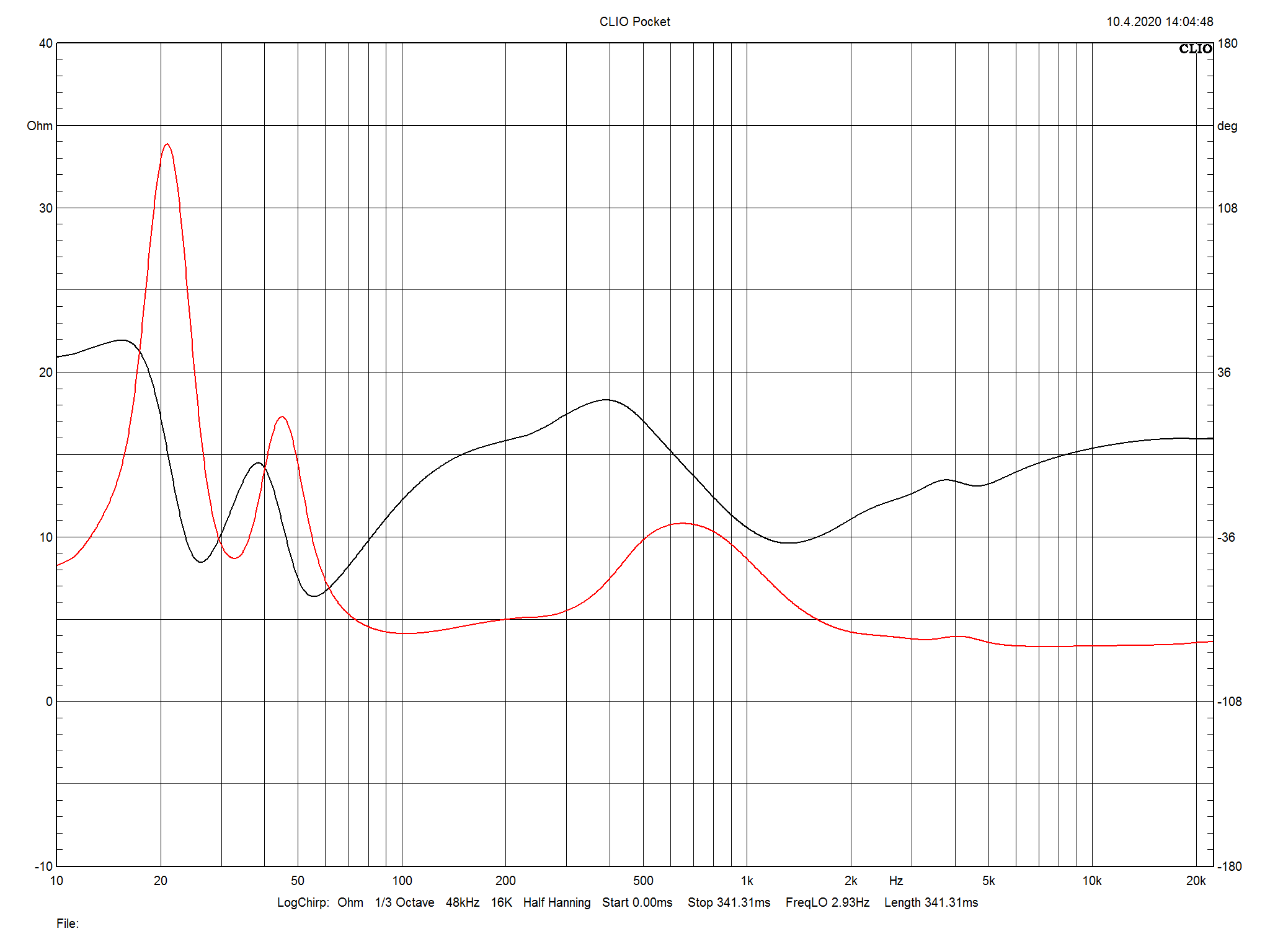

I do have a pair of Wolverine EF3-3 boards sourced from @fireanimal. I would like to pair the Wolverine with my Polk speakers which are rated at 4 Ohms(3.3 Ohms minimum) and 86db sensitivity. The Polk dealer suggested to pair the speakers with a high current 2 Ohms capable amplifier. Would I be able to use the EF3-3 here without any issues? OR should I wait for EF3-4 boards(I understand that EF3-4 boards are not in stock)? Please advise.
Transformer: 45-0-45 500VA per channel
Output transistors: OnSemi 2sc5200/2sa1943 or OnSemi MJL3281/MJL1302
Sha
Courtesy of HiFi-Voice Poland
Look like a rather well-behaved speaker. Lots of good media coverage on the lower tiered reserve series. There's a 300hz peak that needs taming in that measurement - but that's not an anechoic measurement so can't rule out room effects being the cause. Interestingly, the low impedance is mostly all in the tweeter. The overall power dissipation in that reigon in music should be lower, but I'll leave it to more experinced members to comment on how the wolverine might behave with that.

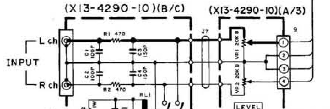

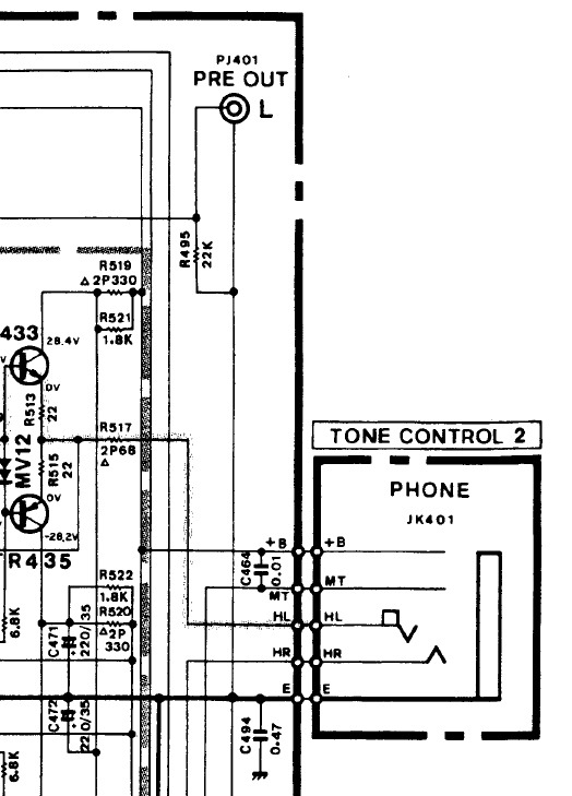

I've installed an ANTEK 800va 40-0-40 toroid along with an ANTEK softstart, used all the correct wiring and layout you guys recommended. DC offset to 0.00, R11 to achieve 5.0 V, BIAS to 44ish mV. Everything stays cool, good so far. Connect speakers and turned on, perfect, zero noise.
Now when I hook up a preamp, does not matter which one, Yamaha C-50 or one I built from Elliott Sound Products, I get a very quiet 60hz hum.
I've done all the testing for ground loops and everything is correct. I even took the cover off and hooked up a totally separate set of input RCA's directly to the amp boards and laid them out side of the chassis, completely away from power wires, nothing changed.

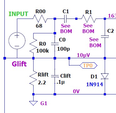

I noticed on the schematic that the input ground has Rlift and Clift between the input shield and 0 volt line. I haven't tried to bypass this ground lift yet but This is the only thing I can think of to do.
Looking at the outputs of my preamps and other amplified inputs, none have a ground lift, so If I'm hooking up the Wolverine to a preamp that has its output shield tied directly to the 0 volt, could this be causing the slight hum, ground loop?

I used the 2.2 ohm resistors for Rlift. Would using the 4.7 ohm change anything or would it make it worse?
You could try 4.7R but from our testing there was no change.

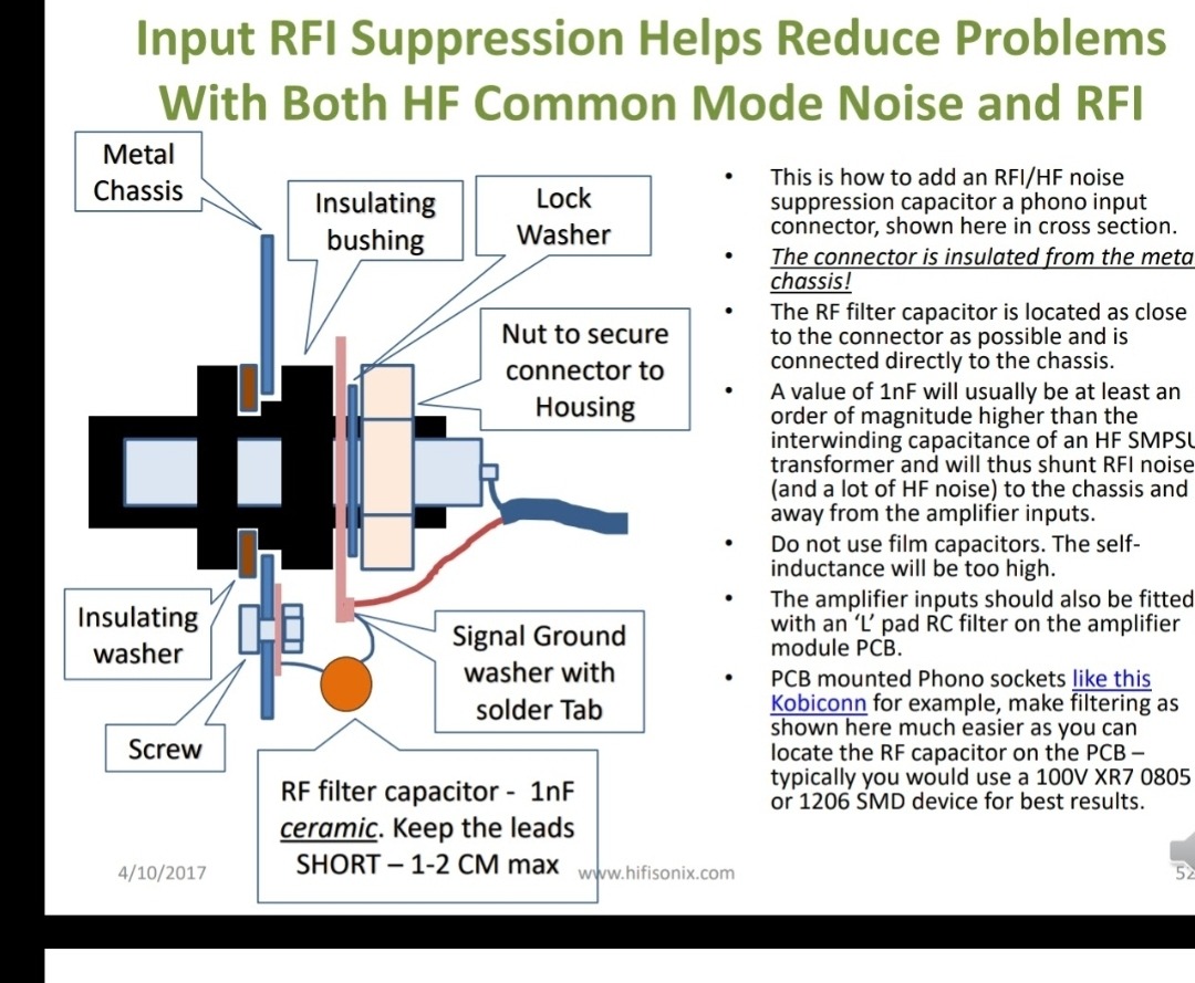

Did you follow the suggestion in the wiring guide for the cap to chassis?
Other than that, its a bit of a tricky one the wolverine will amplifier whatever it sees on the input by approximately 27 times so if your pre amp has 1mV of noise on its output then its going to be amplified by 27 times on the Wolverine's output.
Do you have a scope or a good quality DMM that you can measure the idle AC output of your pre amplifiers.
Maybe take a look at those.
