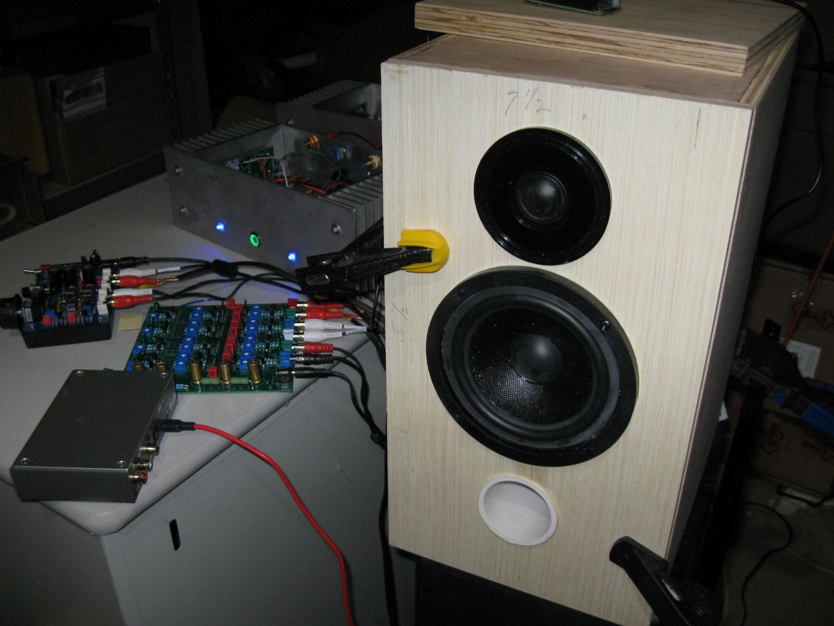

Measuring the crossover question
So I built one board to experiment with, but did not have a speaker that could be bi-amped easily. So I used some Jamo drivers sourced over ten years ago. Cobbled up a baffle for a test cabinet I had of about 0.58 cu ft. Two screws in the woofer, tweeter just press-fit and the port snugged up with masking tape. The baffle is just held to the box with wood clamps.
The XO was built with 3.3nF caps for 2121Hz @ 12dB. Two ACA's for power and a Peter Millet Nu-tube preamp for control.
The sound is wonderful.This just confuses me to no end. 3D soundstage and the speaker boxes seem to disappear.
How can this be? It just took a few adjustments to get what seems like a balanced set up. So what measurements can help me understand what is really happening and allow me to fine tune the crossover to the speakers?
I have a umik mike and REW. What sort of test would help me understand what is the crossover point and show phase relationships. Will simply measuring the speaker responses give me the information needed to repeat this with other drivers and or other crossover points.
Thank you in advance.

Lucky boy. Most of the time it takes a lot of effort to get that effect,
and success is not guaranteed.
I suggest you measure the frequency response on axis and take a
look at that. If it's flat, I would call it a day and enjoy the speakers.
:snail:
Reactions: sam08861
Thank you Nelson
Indeed I have felt lucky with this outcome and I am cautious that too much fiddling about will move me away from this state of grace. I have three more boards and more speakers to build. Just looking for some stepping stones through the woods of self doubt to this state I have stumbled upon.
Thanks again for these great designs that sometimes seem like magic to me.🙂

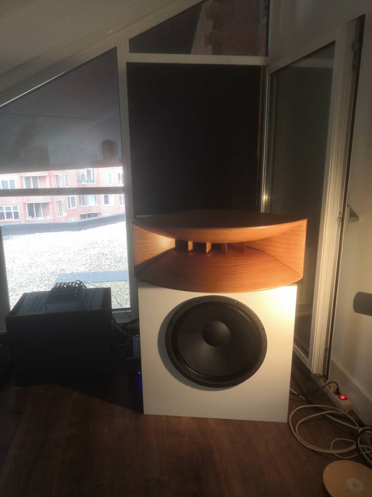

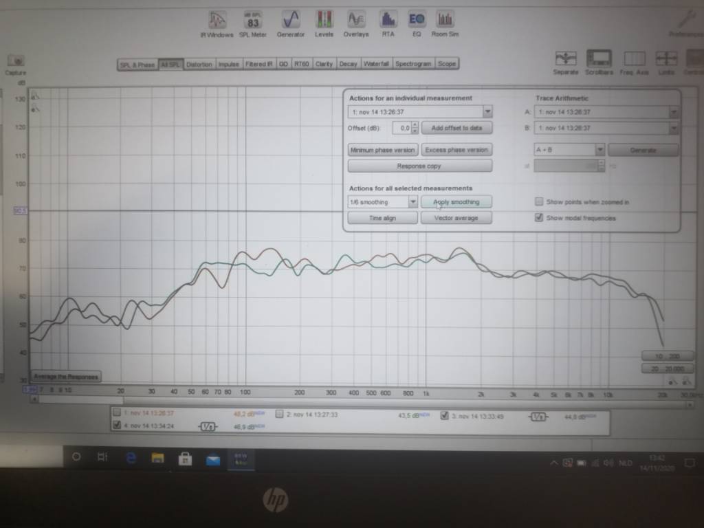

Quick update om 6-24db crossover explorations:
Faital 15pr400 15 inch woofers arrived last Monday. I slabbed them on a piece of leftover kitchen cabinet and put the horn on top as a test setup. Besides some noise in both the F6 and Pass ACA which these efficient drivers now reveal, the setup sounds quite alright!
I think the crossover region (x'ed at 500 hz 24db)is not too bad for my first try..😉
I really love the sounds the horn produces. Open baffle woofers not so much yet, at least not in this small, really small room.
Frequency response down low looks alright, but my ears tell me there is still some output missing.
Next steps are building enclosures for the woofer and ultimately figuring out what is the quasi optimal crossover for both smooth phase and time alignment taking into account the driver offset of 20 to 30 cm.
Maybe 24db with polarity reversed to account for driver offset?...
