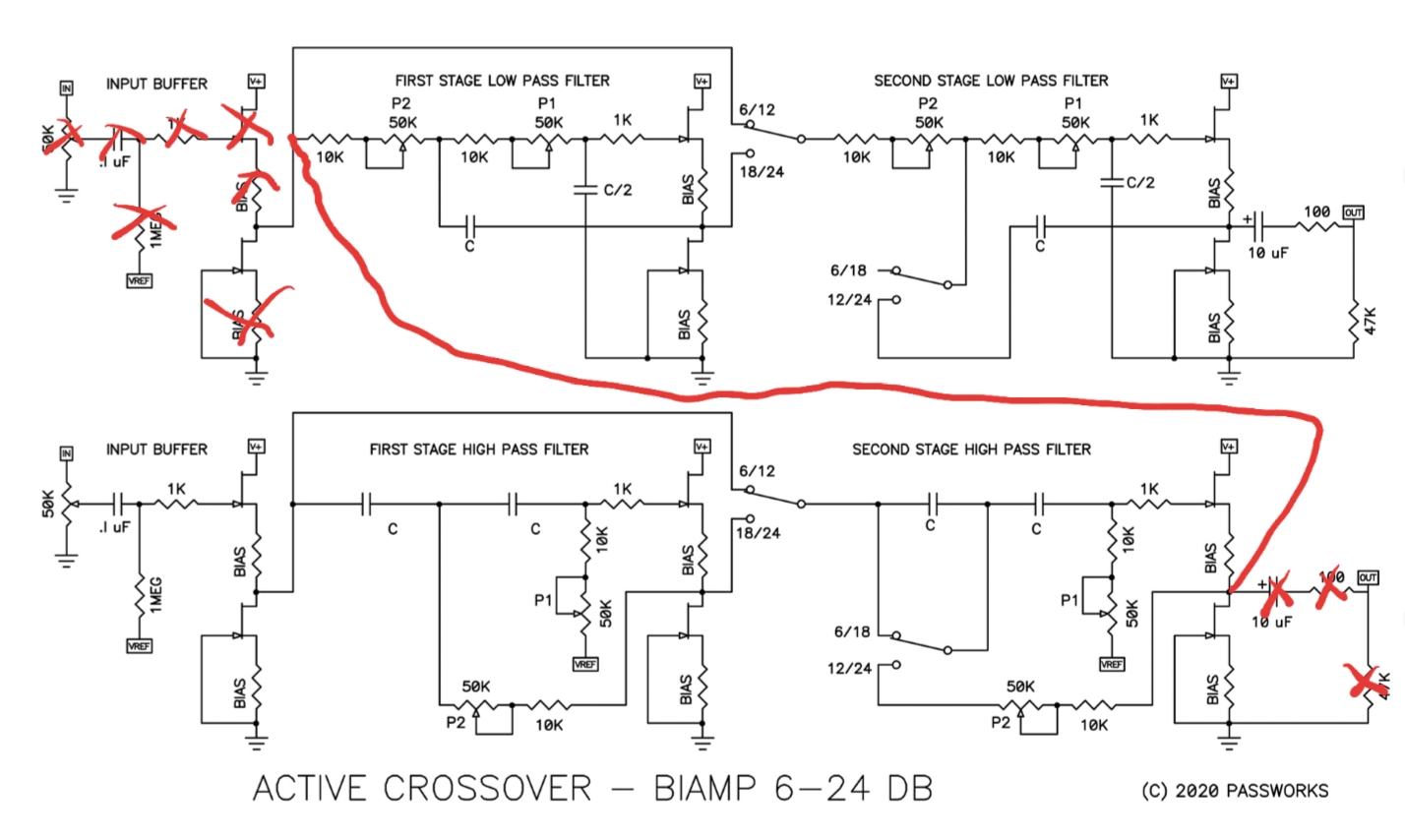

I finally received the four Biamp 6-24 boards, shipping was quick, but not me ordering. I want to use them for a 3-way speaker with active sub in addition. Sub has its own crossover, so I will just give it a full signal. I need two bandpasses, 4th order @ 80-450Hz and 450-2000Hz. Then a highpass 4th order @ 2000 Hz and up to 20kHz.

Ideally you want to treat each stereo bi amp pcb as a functional block so you have two stereo bandpass pcb and a stereo high pass pcb. You don't need the low pass for the sub as you have your active crossover.
I have had look at my pcbs which I have not stuffed yet. This is really something Nelson should describe as its his pcb design.
However, the input signal is common to both the Low and High input level trim pots. What this means is that to configure the pcb as a stereo bandpass filter you need to loop the high pass filter output back to the input of the low pass filter.
But the inputs needs to be isolated.
To configure the pcb the signal enters the input designation on the PCB IN. The output of the high pass filter designated HIGH on the pc is looped back with a length of hookup wire to the track that links the -ve input of the 10uF coupling cap next to the LOW level input trim pot. Do not install the LOW level trim pot.
This will cascade the low pass filter from the output of the high pass filter. The output of the low pass signal is taken from the pcb designation Low to your power amp.
The same applies to the other bandpass filter. No alterations are required for the high pass filter.
Set the crossover RC components for the frequencies you require.
The inputs of all three crossover pcbs should be joined to the common signal input from the source.
I think this is correct.

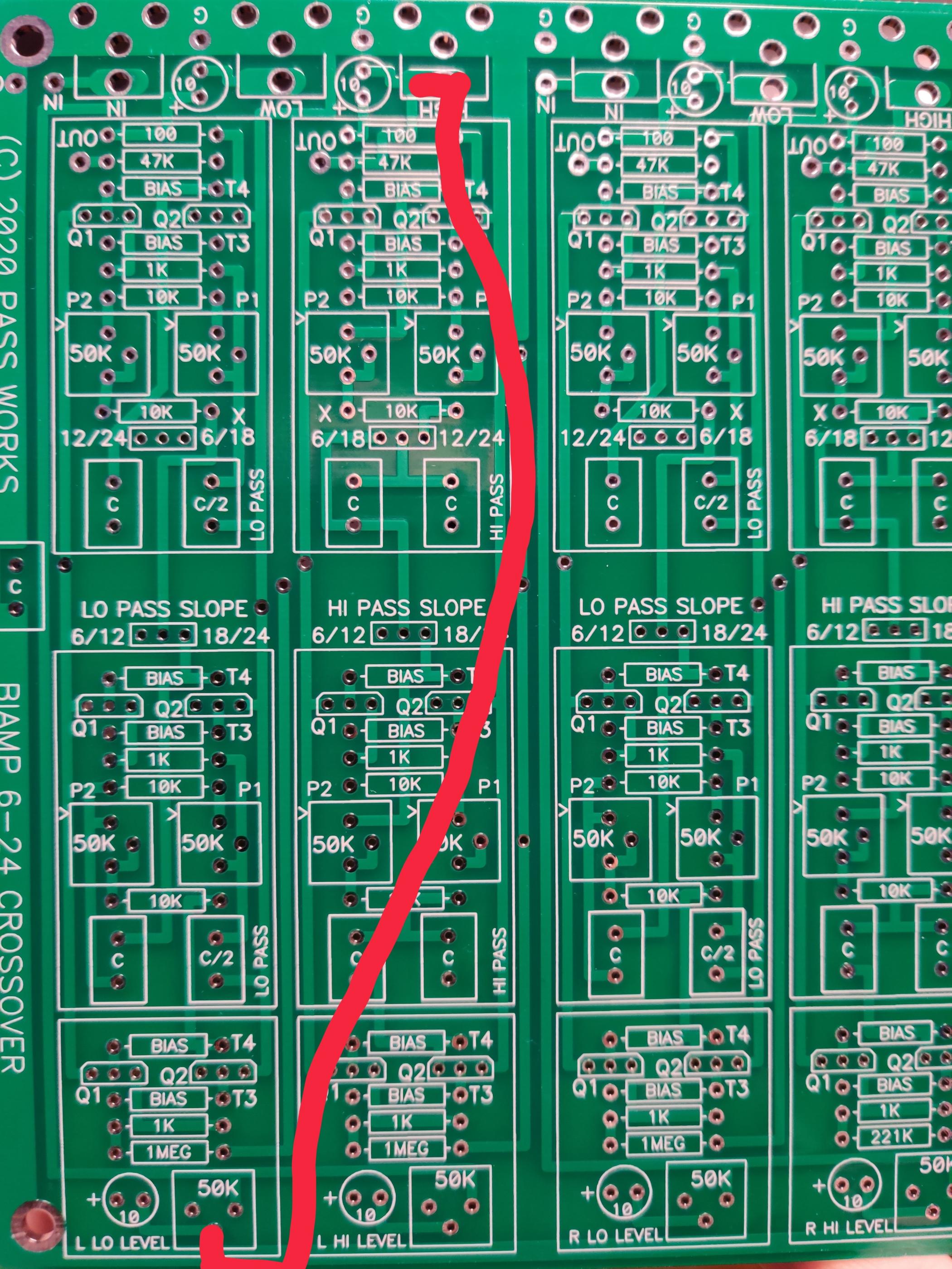

Thanks, you saved my project. Is there no need for a plus and a minus wire when cascading high pass and low pass channels?
You wrote that RCA input should be isolated. Do you mean to just remember to use the plastic spacers to isolate the input connectors from the chassis?
Not quite. My post referenced the electrical de-linking of the low pass filter input from the pcb source input track to the low pass trim pot.
The source inputs are in the far left and centre of your image designated IN & G for the left and right channels. As the signal is connected to ground no additional ground wire is required.
My comments are referring to the isolation of the +ve input signal from the low pass trim pot. This is implemented by not installing the trim pot on the low pass filter. You can use isolated spacers if you wish. The low pass filter is cascaded from the high pass filter so you don’t want the input signal going to the low pass filter.
Your marked up pcb image is correct. You only need the one hook
up wire. For optimal noise the signal ground may need to be connected to your chassis ground.

Macca, why is HP output cap AND LP input cap both needed when used as bandpass filter? At worst, wouldn't you just need one or the other, at best, neither (as you're just cascading 2 or 4 filter blocks after the previous 2 or 4)? Does DC get in via each filter block? I din't know enough theory!
If those making changes are unfamiliar with the circuits then the least invasive changes are the better off you are in terms it board working first time.
If you look at the schematic these coupling caps are these to isolate from the outside world. You can bypass them or if you are clever bypass the low pass volume buffer. I would leave as is until you get it going.

If we eliminate the hipass output cap and tie the drain of the CCS to the 10K resistor of the low pass filter. We have bypassed a set of coupling caps and an input buffer. Dont populate the input buffer. The dc potential on this link will be 1/2 of VCC which is right where we want to be. Fewer parts for the signal to go through.
