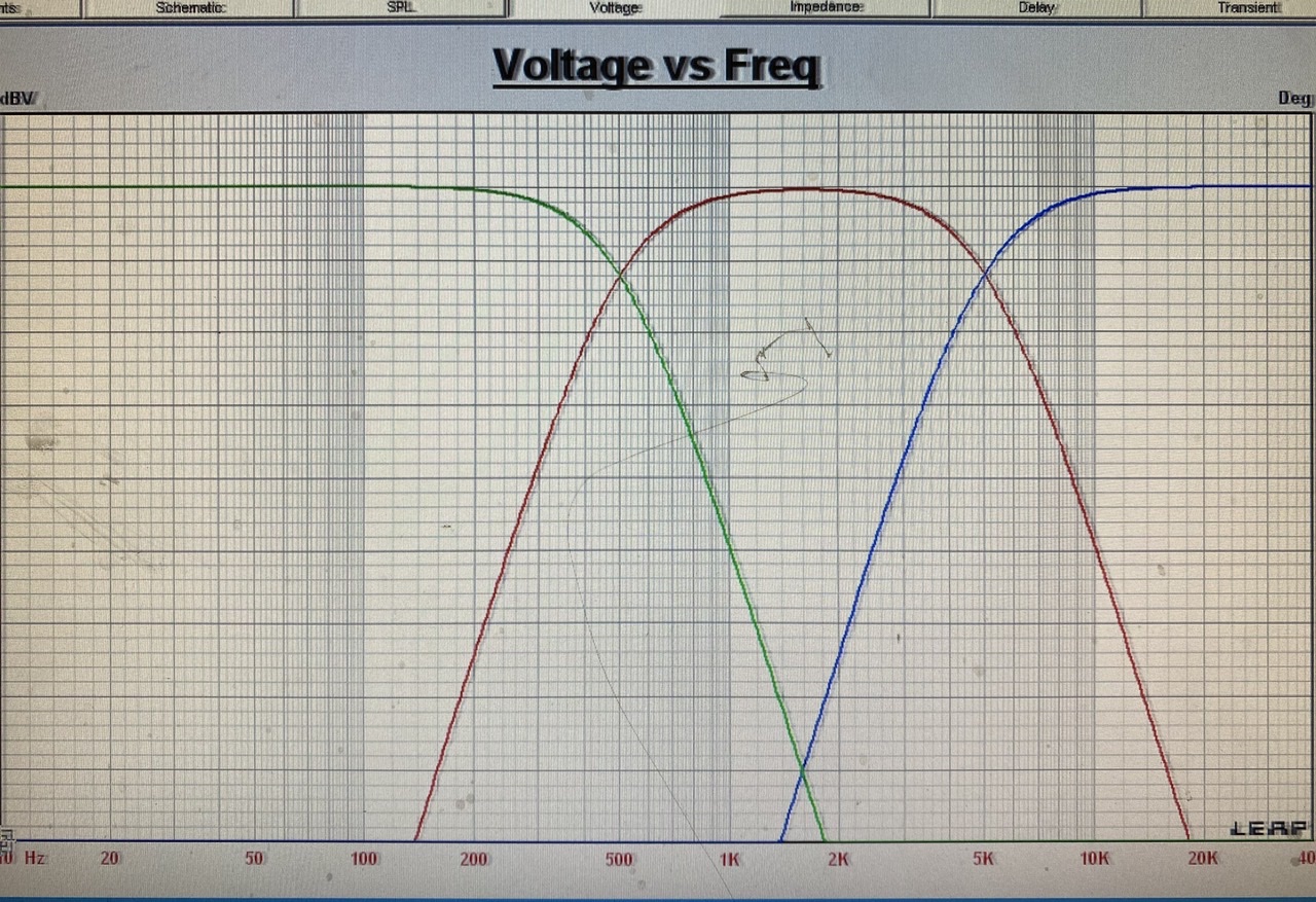

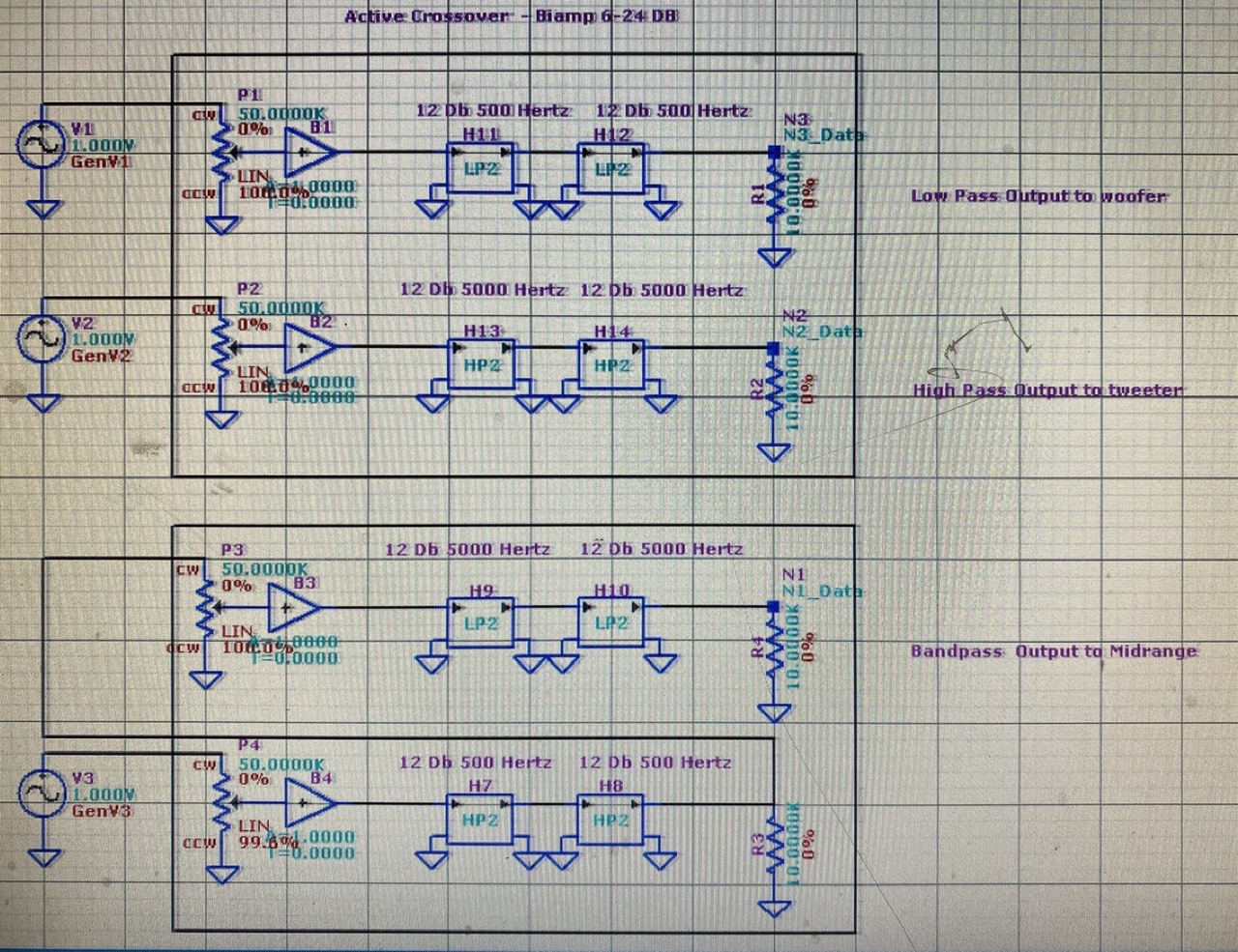

3. Then next step may appear to be attempting to fit one of the kits hardware to your plan for 1 or 2. However, the best place to start is always the start and that means collecting from useful data by way of measurements for 1. The system voltage drives. 2 Acoustic response measurements of your drivers mounted in the proposed enclosure.
This can readily be done at low cost with REW and a Mini dsp USB microphone.
It’s not difficult and you will be well rewarded later.
Once you have the measurements you have a basis for making some informed decisions around what filter slope and crossover frequency are best to use in your project. As Nelson points out it will take some experimentation to come up with a crossover function that measures well and is subjectively acceptable.
The thing to understand is there is a huge amount of knowledge in designing and successfully building your own loudspeaker. Things like baffle step compensation, driver EQ and response optimisation for a specific room locals come into play if your goal is to attempt something better then you can afford to buy.
4. Once 3 has been looked into you can then start the process of calculating the RC values.

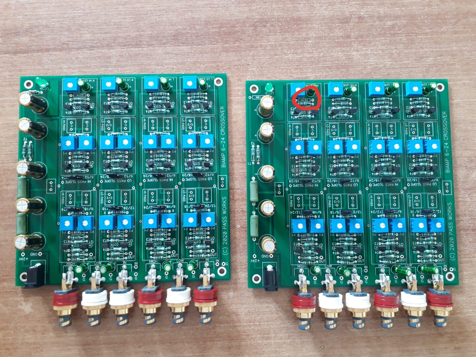

Finished except for the C and C/2's.
221k resistors are not on BOM so I am missing them as well...
I think there was earlier discussion that the 221k resistors are a silk screen error, and those should be 1M instead.
Thanks, and yes the other three channels are 1 meg, so it is logical. I have no electronics knowledge, that is why I asked. I am soldering 1 megs right now!
