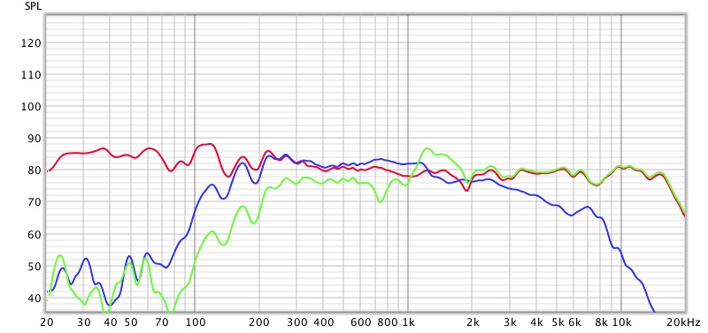

The whole 100hz-500hz range? I measured 1m from speaker in a small room with a low, sloping ceiling..
To validate take the enclosure and lay it on its side in your driveway and place the mic 2 metres from the enclosure baffle.
Then measure again. This is referred to as a ground plane measurement and is a lot more reliable for measurements of the actual loudspeaker below 300 hertz.
If that is not convenient lay the enclosure on its back and take measurement 1 metre above on axis with the tweeter. This will remove most of the room reflections at lower frequencies.
With measurements if the data is not reliable your limited with their true value.
I never measure my JBL studio monitor projects inside.

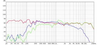

Here is my summed response with minidsp with asymmetrical filters of 2nd order 1200 for mids and 3rd order 1600hz for tweeter. You can also see phase response. This will be a starting point for me, what do you think should be measuring better, which parts should be bettered?
