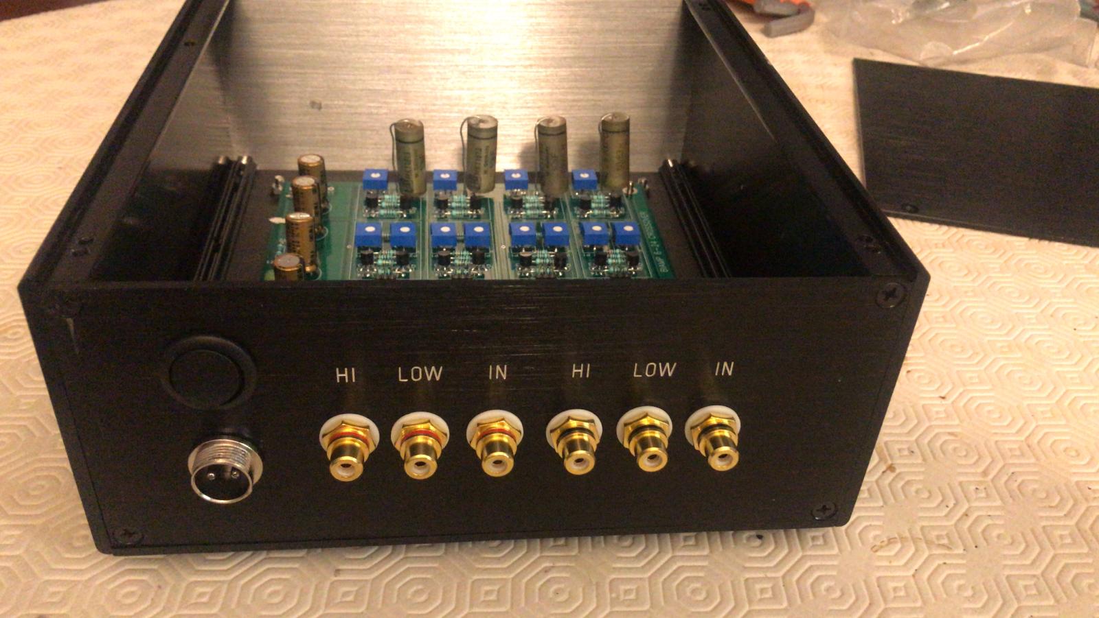

Thanks Macka for the response.
Better quality 25k linear trimpots might be useful, but I think I've got the response to the stage of using fixed Rs.
I've matched inputs/outputs for HP & LP stages on both boards using sine waves at various frequencies & a 2-channel oscilloscope.
Then confirmed into & out of both channels of all 3 amps.
Final confirmation was measurement sweeps with REW at 1cm from woofers, 50cm from each mid & tweet on axis. Final measurement at listening pos with sweeps & pink noise.
Confirmed with iPhone App that shows spectrum of actual music (new phone's mic is calibrated to the app).
Drivers are very closely matched for my NS1000s, variations are all due to room nodes/reflections.
Unbalanced is working fine with no hum or noise.
I make my own interconnects & know how to shield & terminate correctly (Rane Technical Note 100, i think, is my reference).
Phase measurement & matching is an aspect I'm still learning; I've been using REW for 5+ years & there are still "Ahah!" moments when something clicks.
The 6-24XO has replaced a fancy DSP-based XO (which is LR4 slopes, which don't sound as good as LR2), & sound quality (musicality) is superior, less "tiring".
So, apart from 50k trimpots, pretty happy.

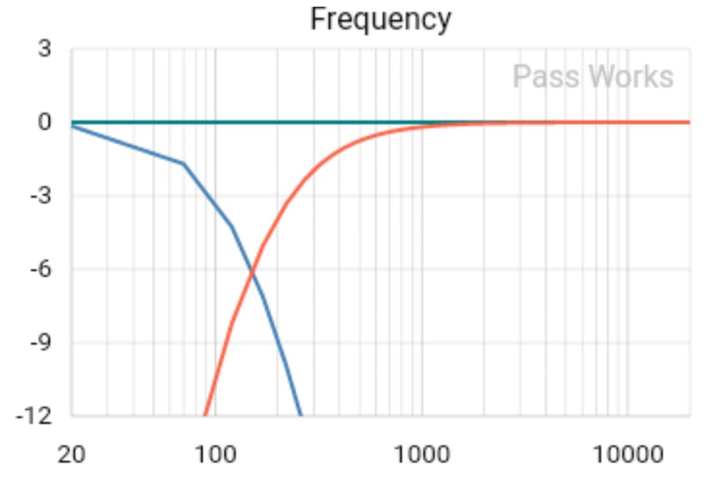

PASS XO CALC
Plug in 33nF or 47nF with all Rs of 22500 for 12dB/octave.
Play with values, you'll work it out.
