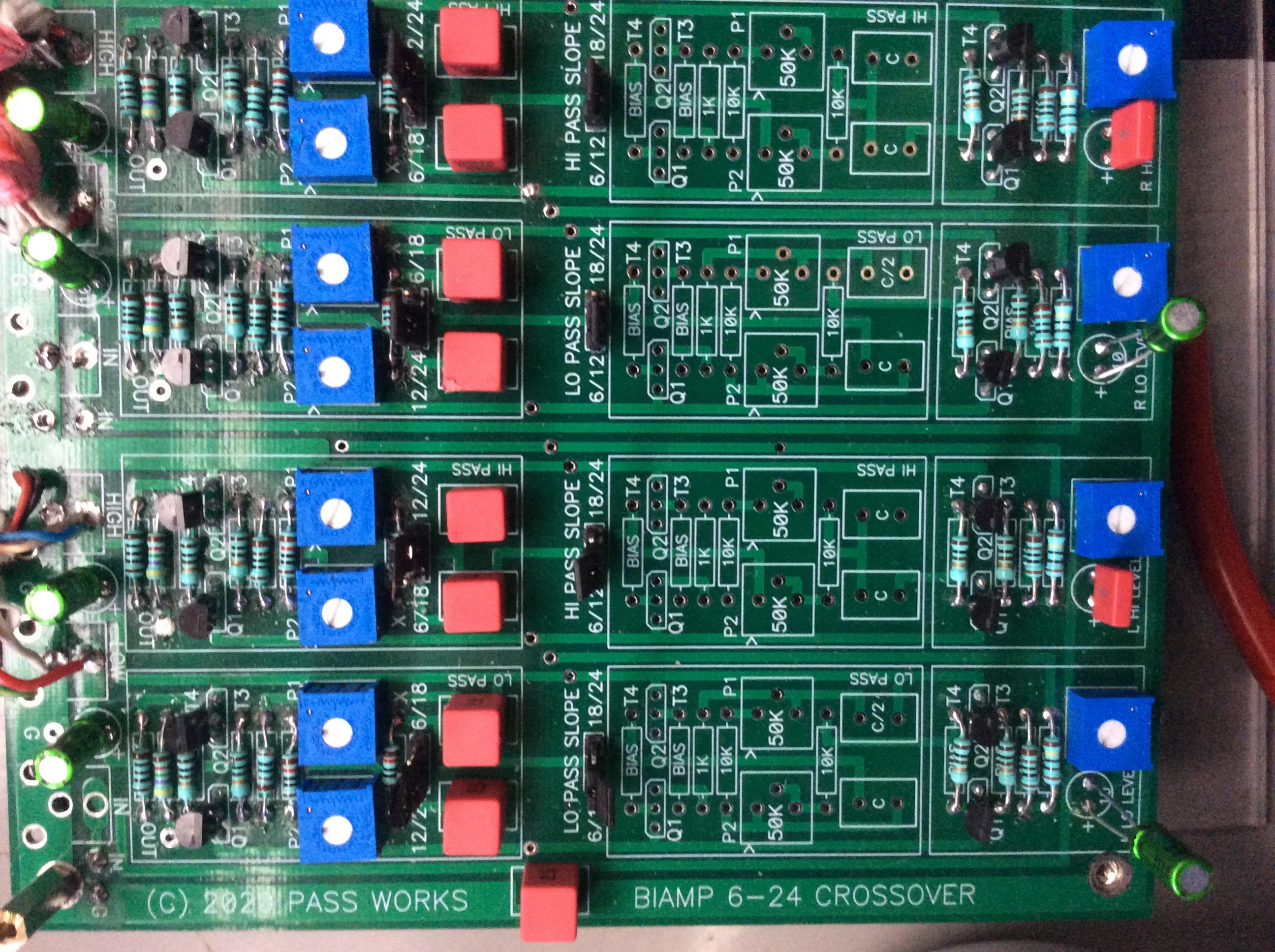

I have been running my two way monitors (b&w cm5) with the analog crossover (2 pole) since the weekend and I must say I am very pleased with the result! First thing i noticed is that fading sounds like recording room echos and instruments seem far longer audible!
Measured frequency response is similar to the passive crossover (first order). However, 10k to 20k is rolled off compared to the passive crossover. Any clues on what might cause that?
Up next is trying 4 pole at a lower xover point.

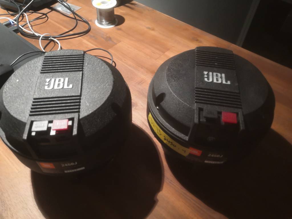

Al this fiddling is in preparation of my first 2 way speaker project with Jbl2450 on yuichi horn (on order) and faital 15pr400[emoji16] View attachment 884373

This board is 12dB@500Hz.
Trimpot adjustments were done with oscilloscope & sine waves to match L/R levels electrically, then REW sweeps of each driver to match XO frequency & levels with mic nearfield.
Final fine tuning from listening position (room reflections make difficult to see slope/XO-integration, though).
Then check P1/P2 trimpots to match R values as best possible.
Re-measure, listen, enjoy!
(ignore fact I use different input caps & different values of C on LP vs HP; I'm experimenting. This is my prototyping board).

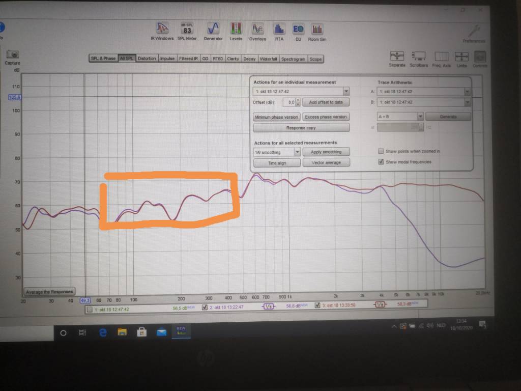

24db gave me best results at 5khz (I could go lower) crossover on my two way monitors, see attached measurements with purple being the midwoofer and red is midwoofer plus tweeter combined.
However, the highlighted region of the midwoofer bothers me! It is there directly coming from preamp as well so xover has nothing to do with it. Unfortunately I do not have measurements of the passive crossover, so dont know if it was there already in the first place.
Any suggestions on how to solve this are welcome..

The whole 100hz-500hz range? I measured 1m from speaker in a small room with a low, sloping ceiling..If your measuring in room it could just be that
