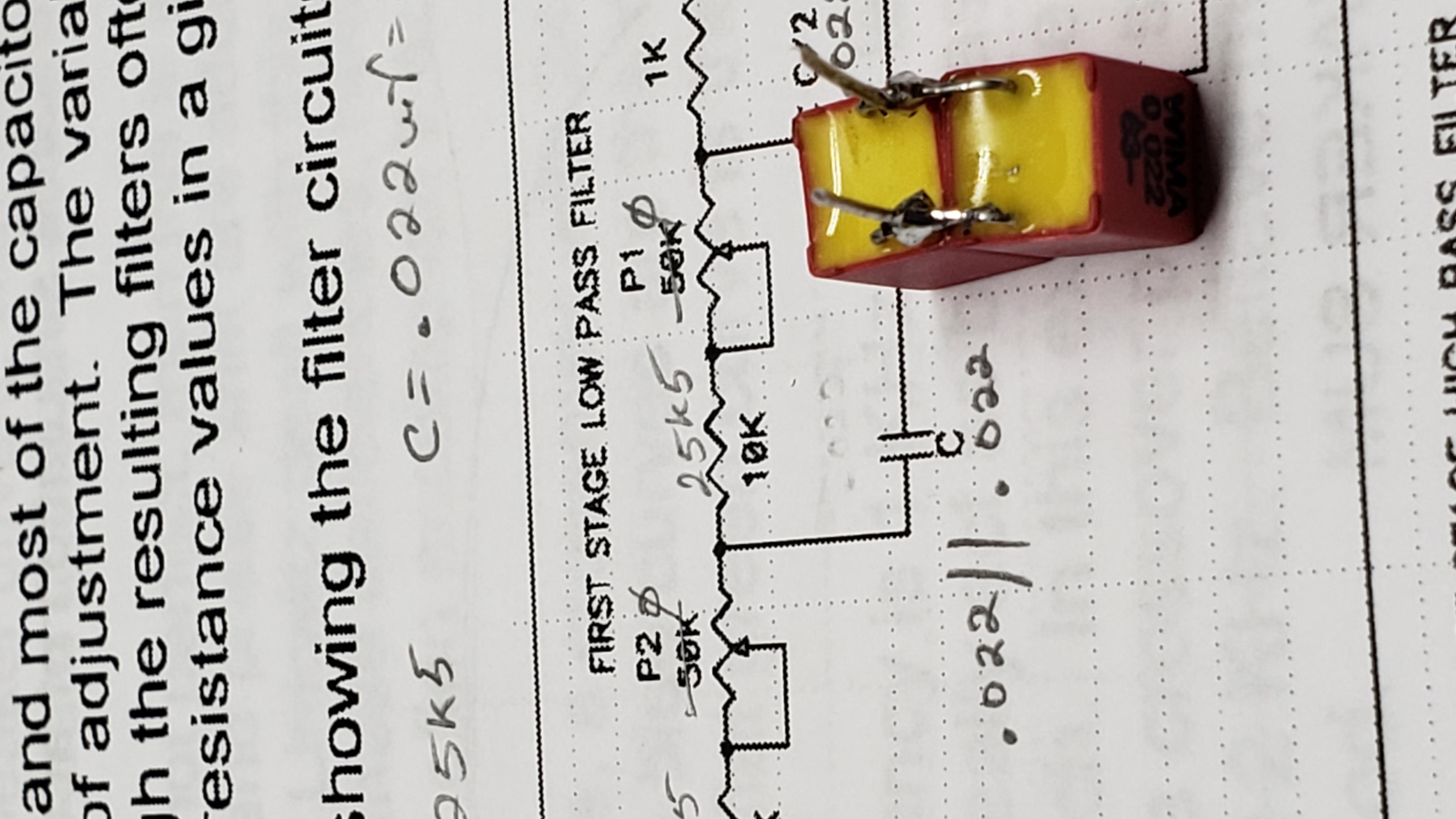

Do check your freq responses; even though I used the XO Calculator, I found my R values weren't giving me the expected XO freq. Still a great & appreciated resource, but proof is in the measurements & the listening!
FYI: 12dB 6k XO should have worked with 2200pF caps & R 12k, but got me in reality an XO ~4kHz. Reduced R to 10k, better. Still measuring/listening. May try 1500pF or 1000pF caps to see if any difference (did buy a selection of different values in board-sets just to try, & 6 boards).

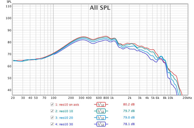

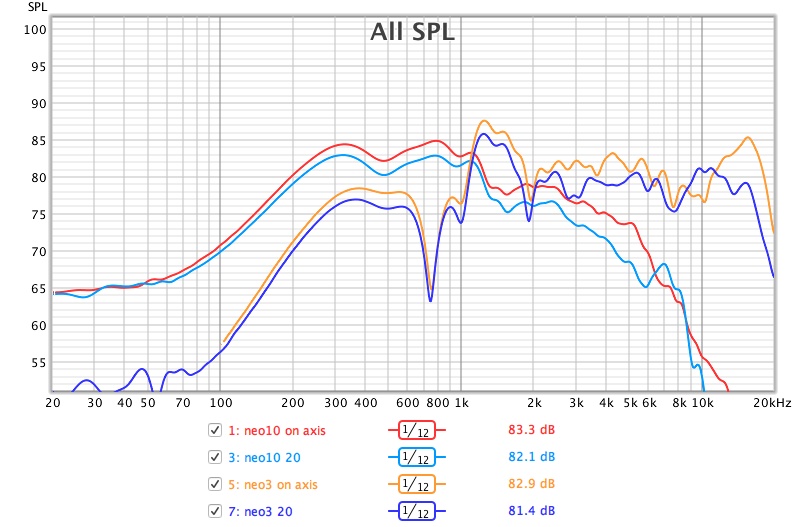

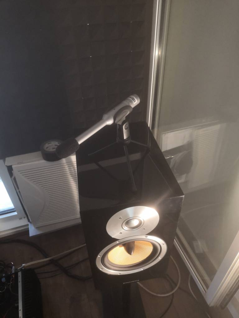

I thought I needed 2 boards for what I needed to do for a pair of speakers. Now, I see, I needed 2 boards per speaker! However having the second board just to have 200hz high-pass seems excessive. The drivers are in horns and have a natural roll-off at 200hz, so it is more protection. Here are the measurements I did with minidsp. A pair of BG neo 10's (bw12 at 100hz and lr12 at 4800hz, no eq) a single modified neo3 (lr12 at 200hz, no eq)
I attach neo 10 on axis and 10, 20, 30 off axis measurements. I also attach neo10 and neo3 drivers superimposed on top of each other. On axis and 20 degrees off axis

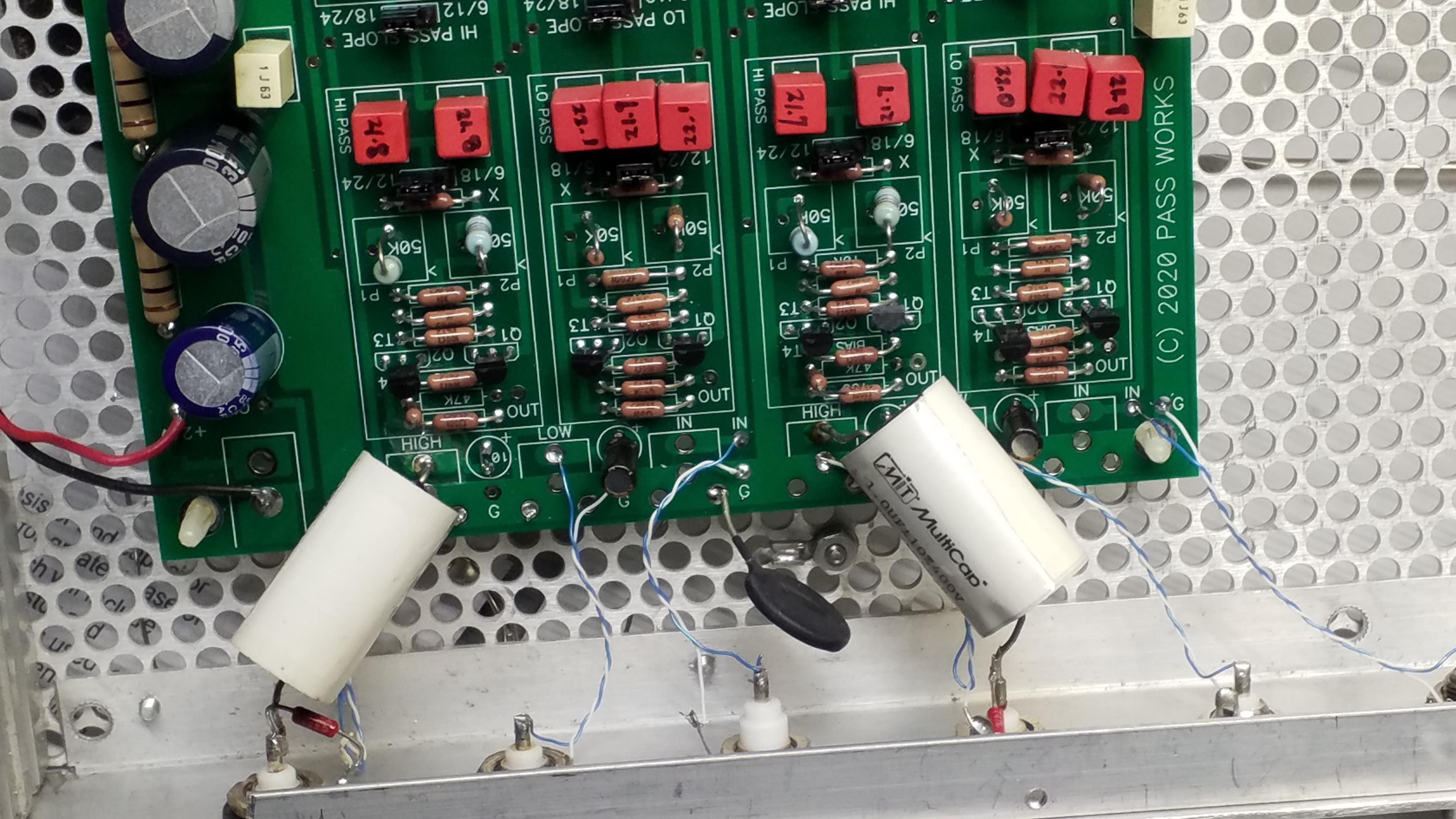

What a difference a coupling capacitor makes
I used a mystery 4.7uf output coupling capacitor on the hi-pass and it sounded rather bright for my taste. Today I removed the cap and bypassed it with a piece
Scrap wire, and lifted the 47K resistor . From the output pad on the board I placed a 1Uf MIT multicap to the output jack. Then I placed a 47K resistor across the jack. It made huge difference in sound, gone are those steely bright highs. I am loving the sound. The crossover point is set for 200 HZ so the low frequency roll off set by the output cap and the load is no problem.

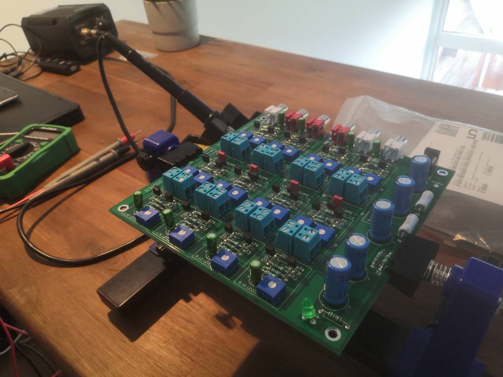

Preface: my proto boards are built & working, LR2 XOs@500Hz & (close to) 6kO.
Music sweet, but trimpots need to go (drift with temp/vibration)!
Next iteration is to replace trimpots with fixed Rs & match components as needed.

Try 25 K single gang linear pots.
If you bought the kit L+R jfet matching is unnecessary.
L+R level matching of low and high output is more critical. Use REW software and match the levels at 1 metre as closely as possibly for L&R with a Minidsp calibrated microphone.
Check the phase tracking of the woofer and tweeter by reversing the phase of the drivers. A dip of 20-25 dB should appear within one octave pink noise at the crossover point if the a acoustic phase relationship is correct between the drivers.
