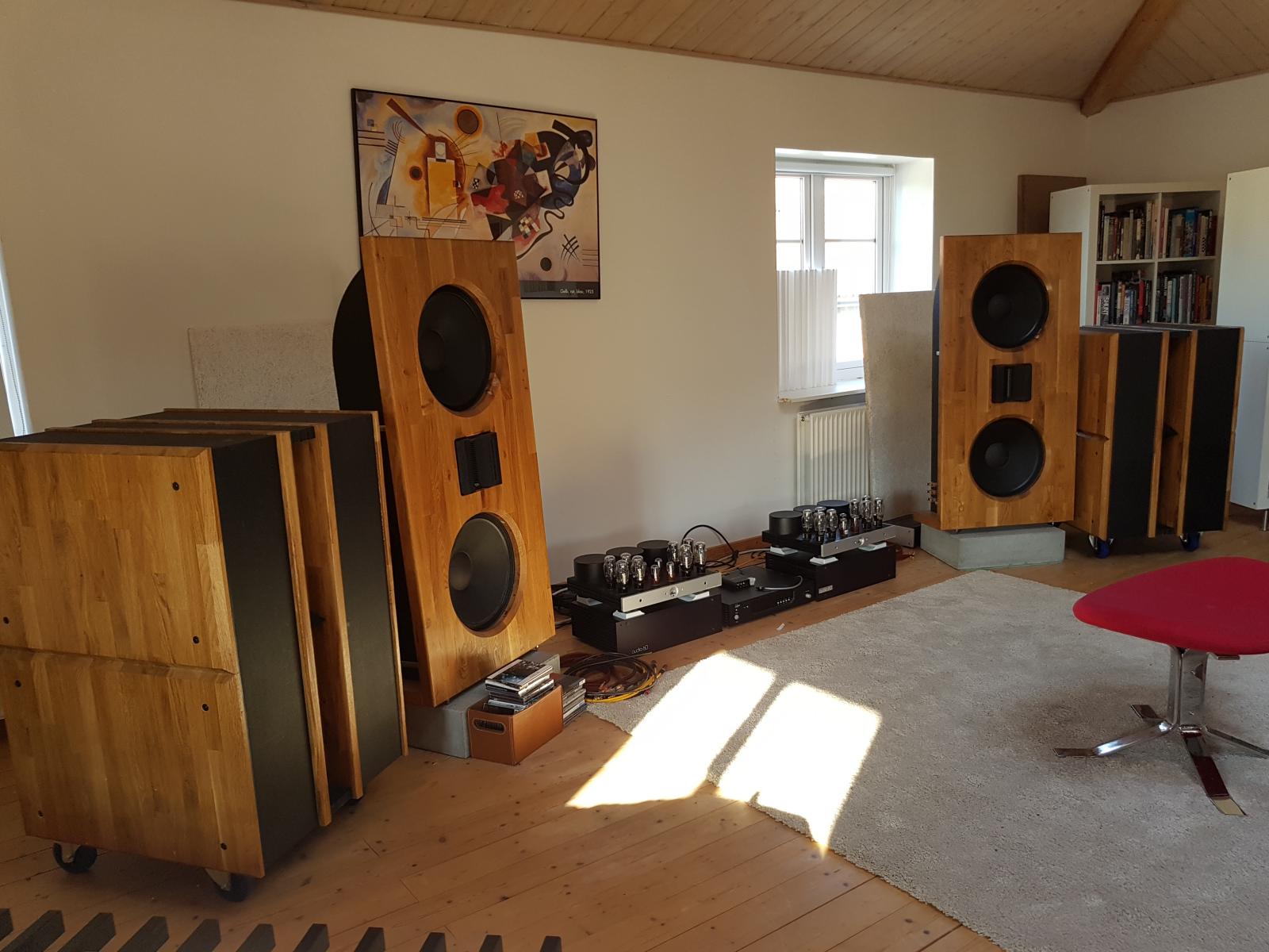

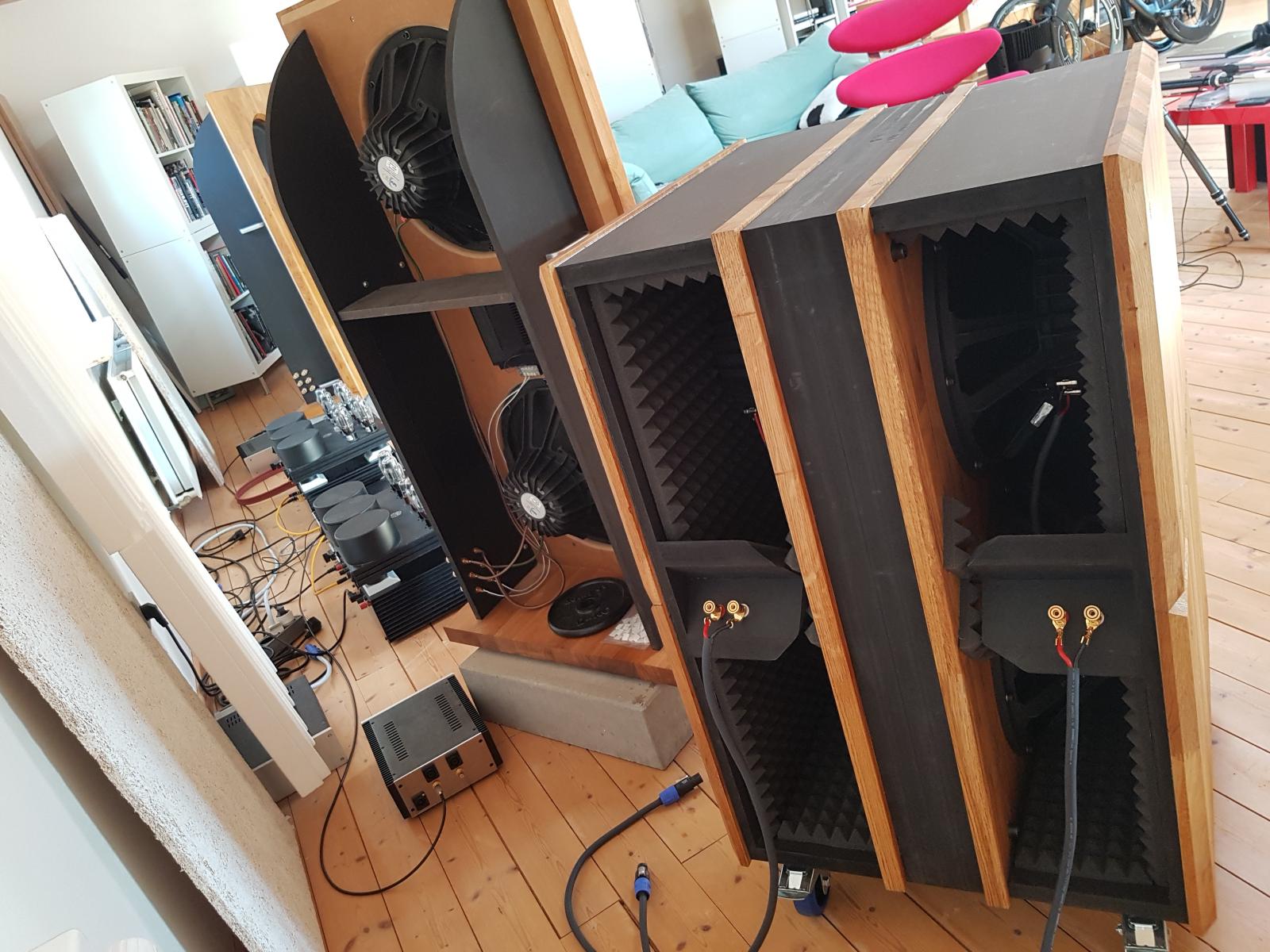

2 boards, 3-way LR2 (12dB) @500Hz & 6kHz, into Yamaha NS1000Ms withPass XA100, Redgum RG135, Firstwatt J2. Power from an old Mac iBook power supply. Rough adjustments of input levels to match what I had previously using DSP-based LR4 XO. Pretty happy so far(sorry for upside-down photo).

Wasn't to happy about adding the wheels - but it has been a true relief, as they are 104kg each. Would have been 128kg if it wasn't for the Neo magnets.

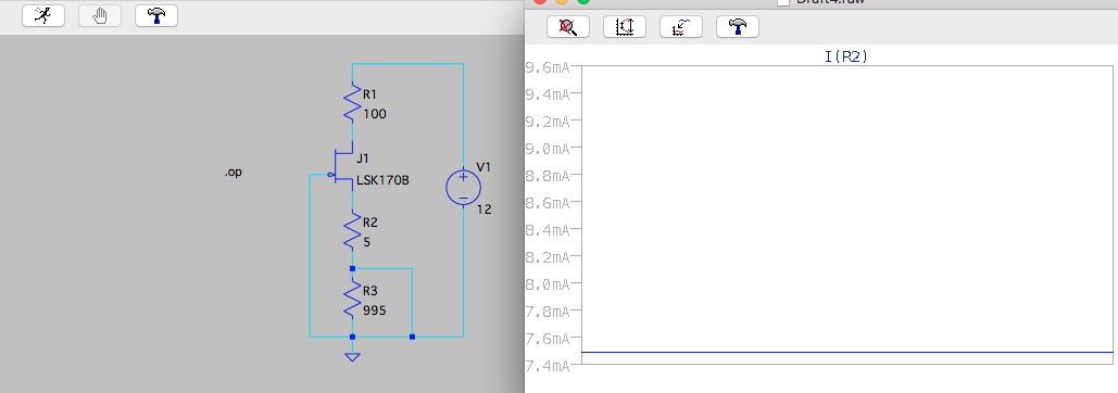

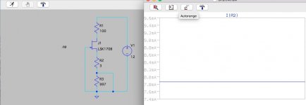

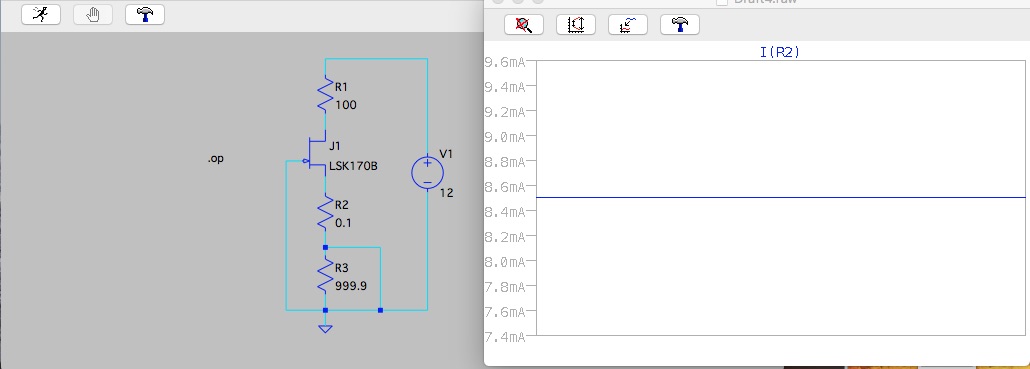

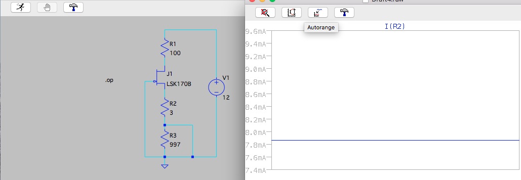

Being almost entirely tube oriented I haven't done more than follow the leader stuff with a couple of jFets in the past. Now, having read Mr. Pass' mention of using a better -sk170 I figured to try a few of the store's LSK170B's.
Set up on a breadboard as shown with a 12V wall wart , pot under the source and 100Ω above the drain , the bias resistor has to get down to 3.5 Ohms for 6.6mA, a pretty big change from the provided j113's 100Ω for 8mA. (Even with the pot set for 0Ω the max current is only 6.8mA.).
The Linear Systems data sheet puts the B's operating current range from 6 to 10mA , which made me think that 8mA would be pretty much ideal. But even in the posted simulations they only get to 8mA with almost no bias . Or is my thought to compare one with the other wrong?
Am I on the right track with any of this?
Thanks for your help.

I like your system! Some blocks of concrete below the speakers?
(I had blocks of concrete below my vinyl-players :D)
They are there to prevent seasickness! Raises the speaker (tweeter) to an appropriate height and keeps the floor somewhat under control :p
