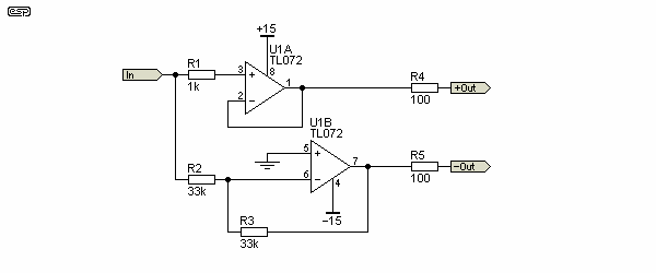

There are different possibilities to convert an unbalanced signal into a balanced one
active - by the use of OPAmps (like you linked to the ESP-site)
-THAT1646 could be worth a think
passive - with an output transformer?
The PA-people use DI-boxes (active or passive).....?

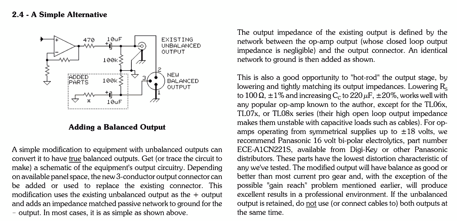

I have couple of amps that use balanced inputs only. Preamp has both unbalanced (RCA) and balanced (XLR). So, at least, I need to convert unbalanced output of 6-24 Crossover to balanced. Will something like this work without disrupting the audio quality?

I have used the method shown in figure 4.
Nelson suggested about 75 ohm in addition to the output resistor to compensate for the output impedance of the jfet.

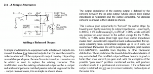

You can connect a non-balanced signal to a differential input. You can also follow Jensen's idea of adding a balanced output. You will need to use a suitable resistor for "X". It should match the output impedance of the crossover. I think it is about 200 Ohms. Balanced means the impedance of the two paths in the cable are the same.
